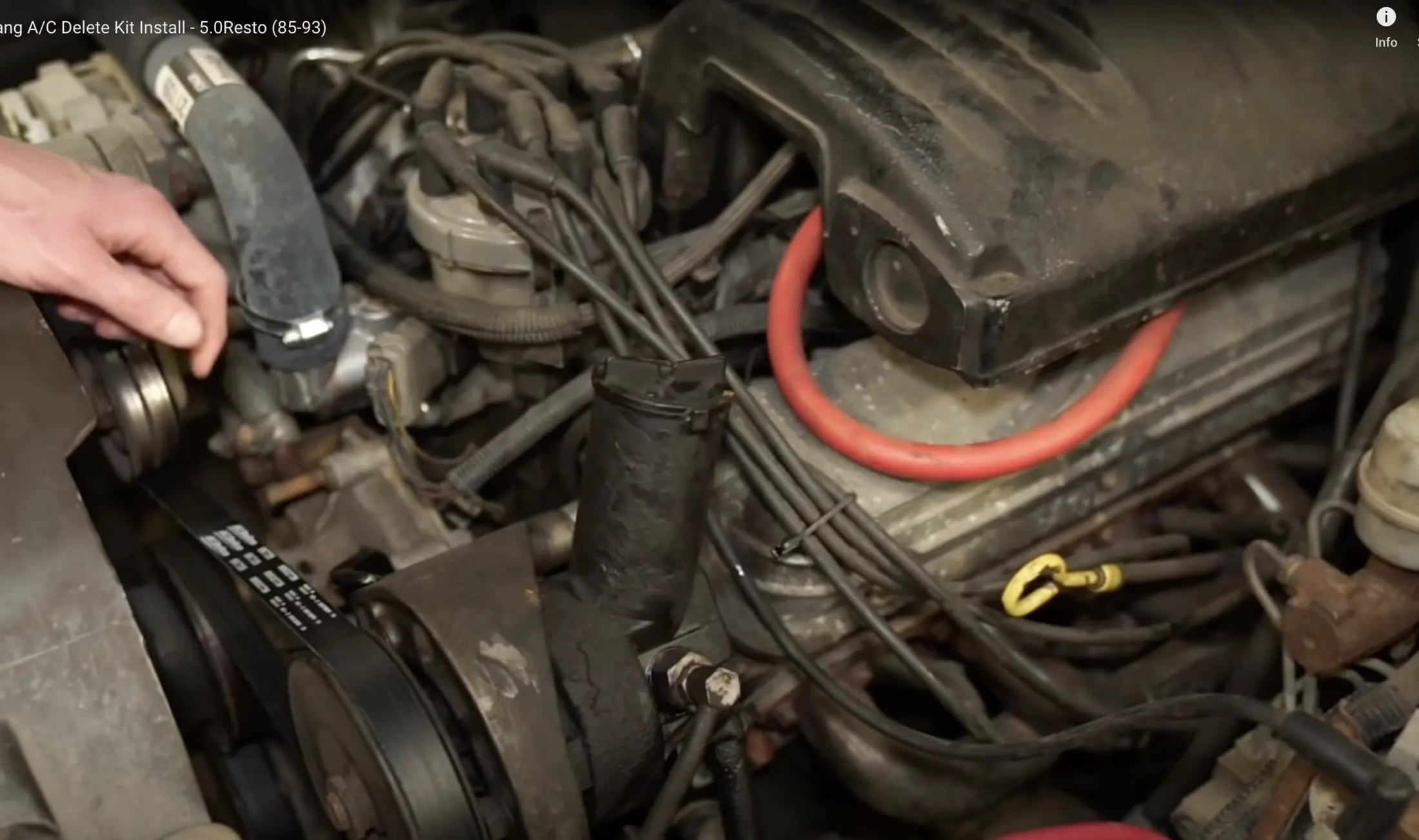

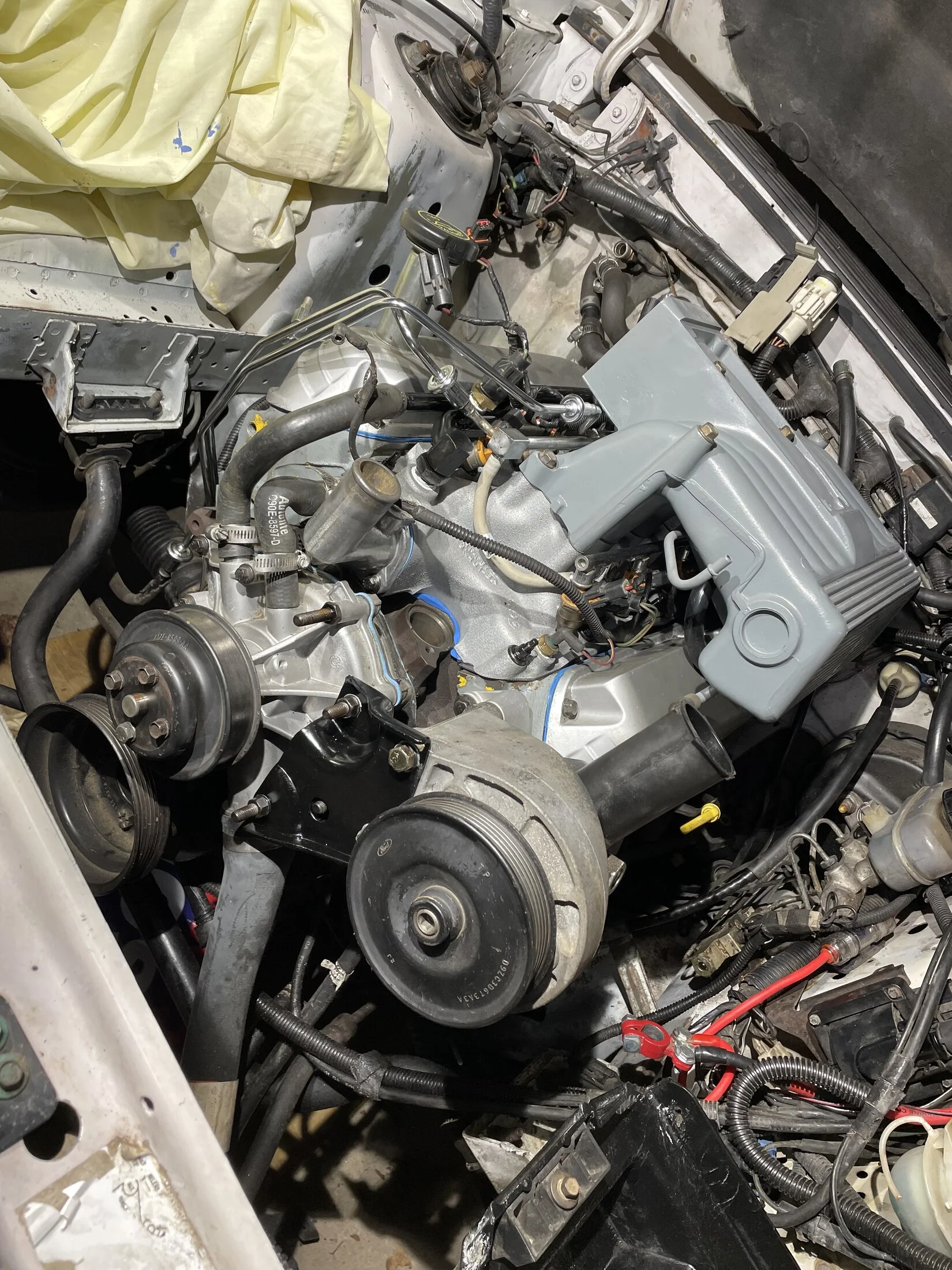

I finished 2nd in my age group in the local sprint triathlon today. Nothing better than finishing first loser. Slow start to the work.

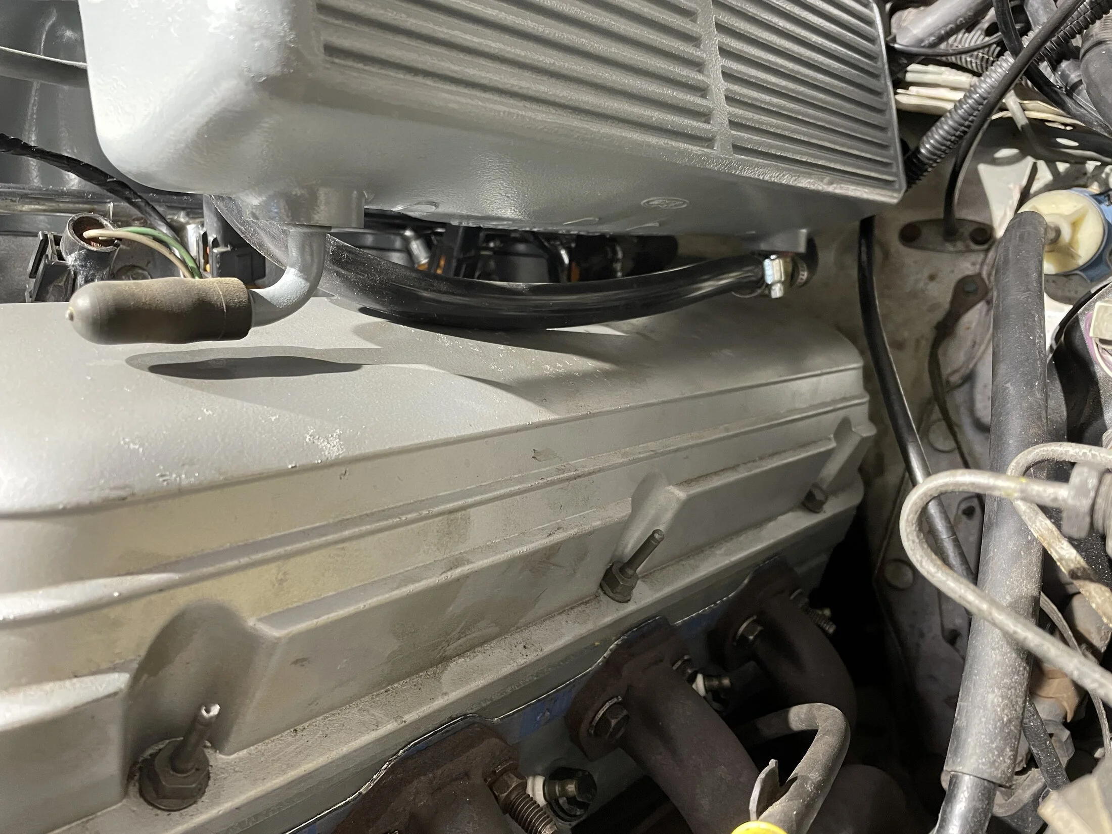

I am test fitting the intake on, bolts are in but just ended for the test fit.
The new silicone tube I added looks like it could be a bit more snug. It’s currently resting on the valve covers. Do I need to get that a perfect fit so it doesn’t rub at all?
Watching a random LMR video and noticed this below. Im going to fix mine, but jeez ...

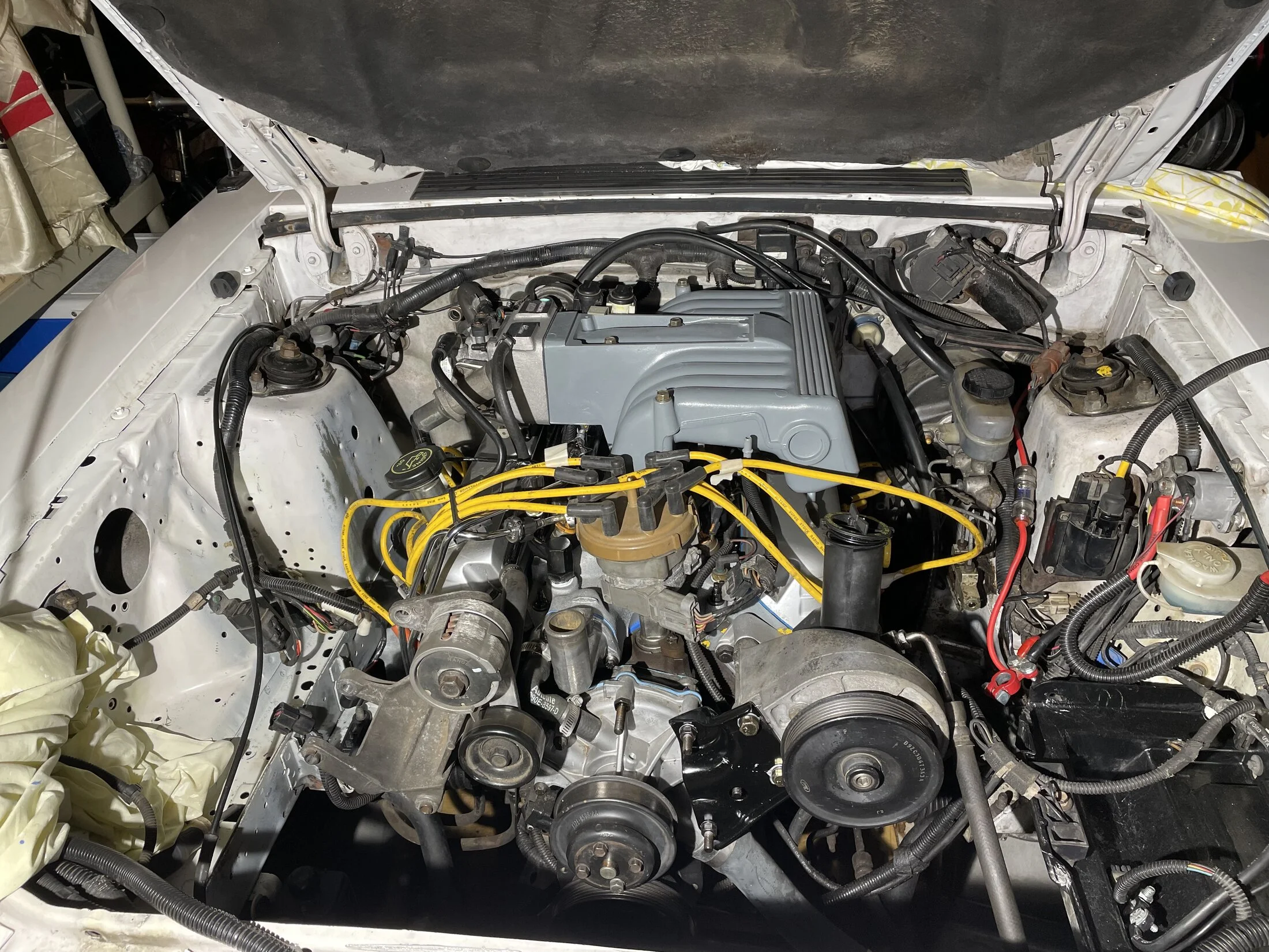

Ac delete

JAA said:
I thought I created a list here of next steps, but I cant seem to find the post. Ill retype, I believe this is whats left in which order
  1. The lower intake coolant, et al fittings.
  2. Exhaust headers and down pipe
  3. Heat pipe
  4. Valve covers
  5. Fuel rail / injectors / lines
  6. Upper intake
  7. EGR spacer
  8. TB
  9. Remaining Vacuum connections
  10. Distributor / plug wires
  11. Radiator / Electric Fan
  12. Accessories / AC delete / PS Pump and lines
  13. Battery
Any comments on scope or ordering?

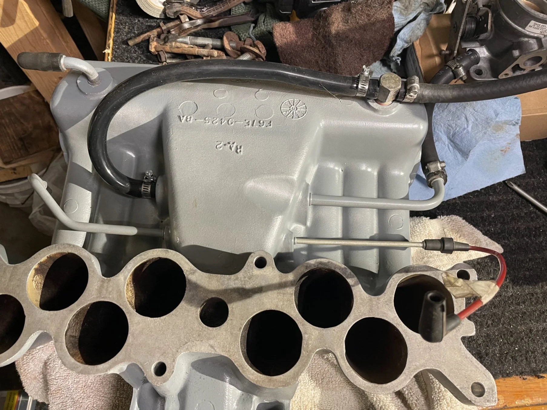

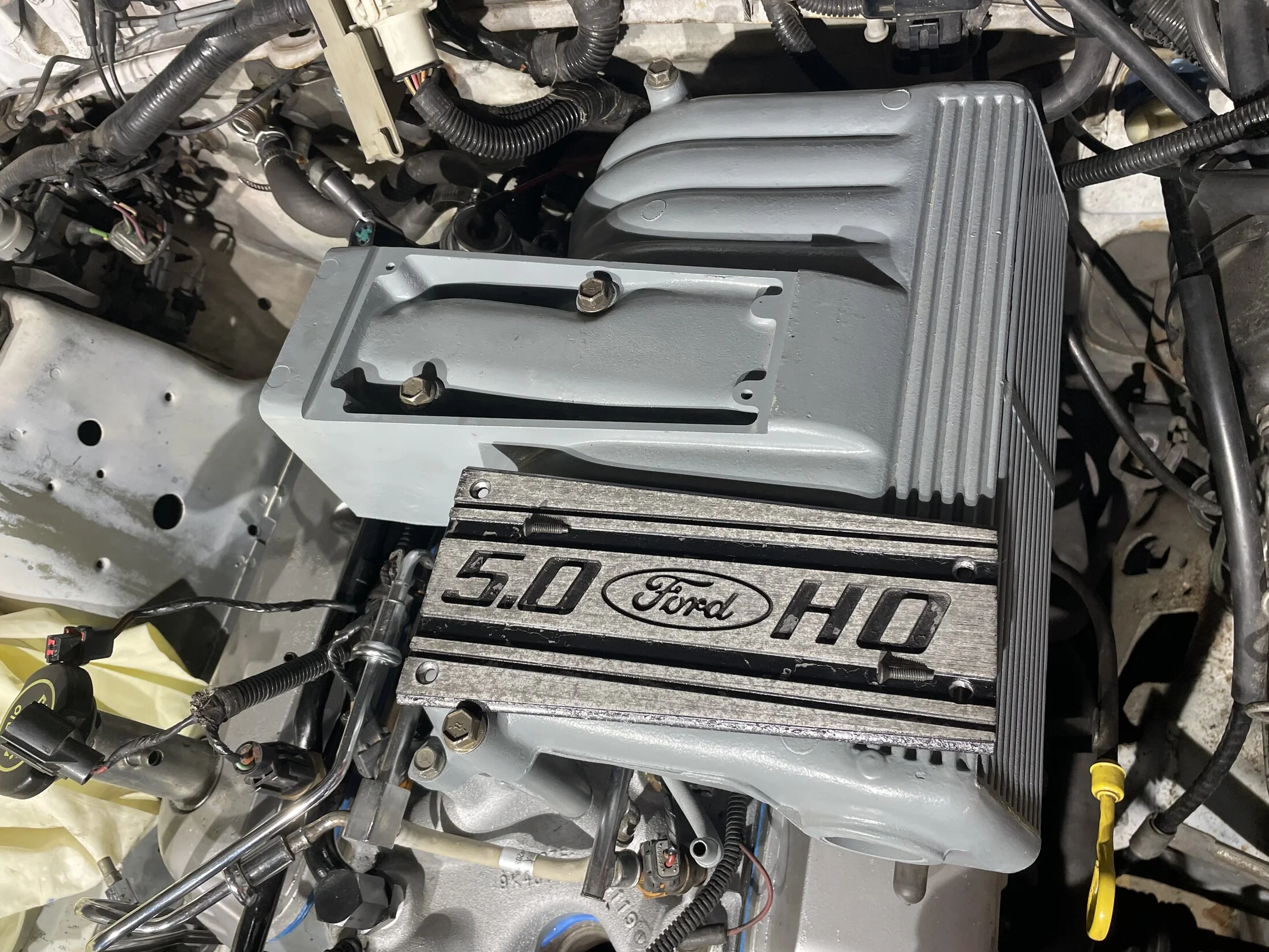

Well that’s interesting
My old HO plate has 4 screws and holes. New upper intake only 2.
Lol

Just drill and tap some threads...

This came up sometime back, I would cut the heads off two screws that match and glue them in place of the missing holes, who's gonna know?

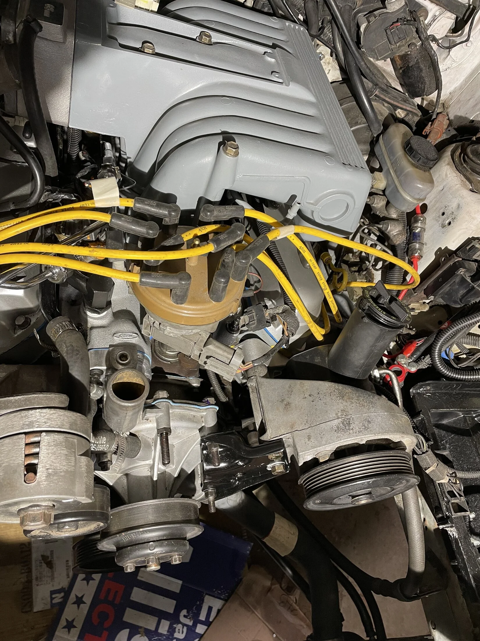

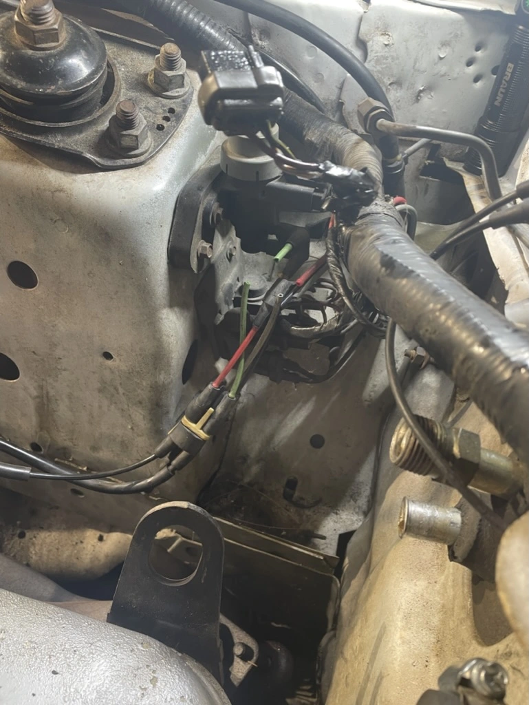

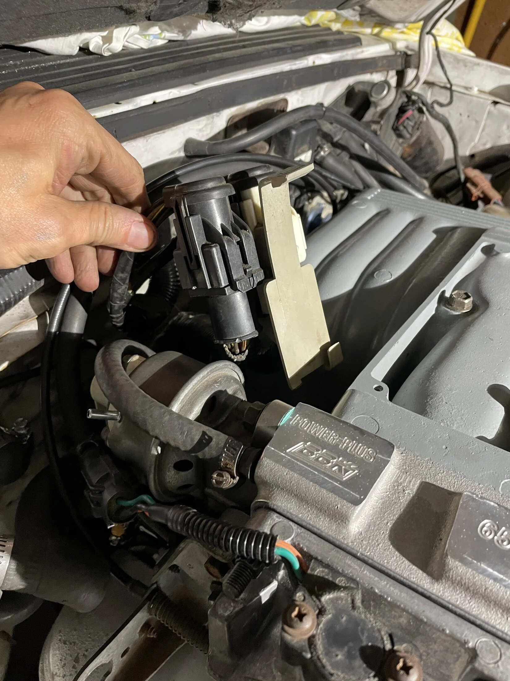

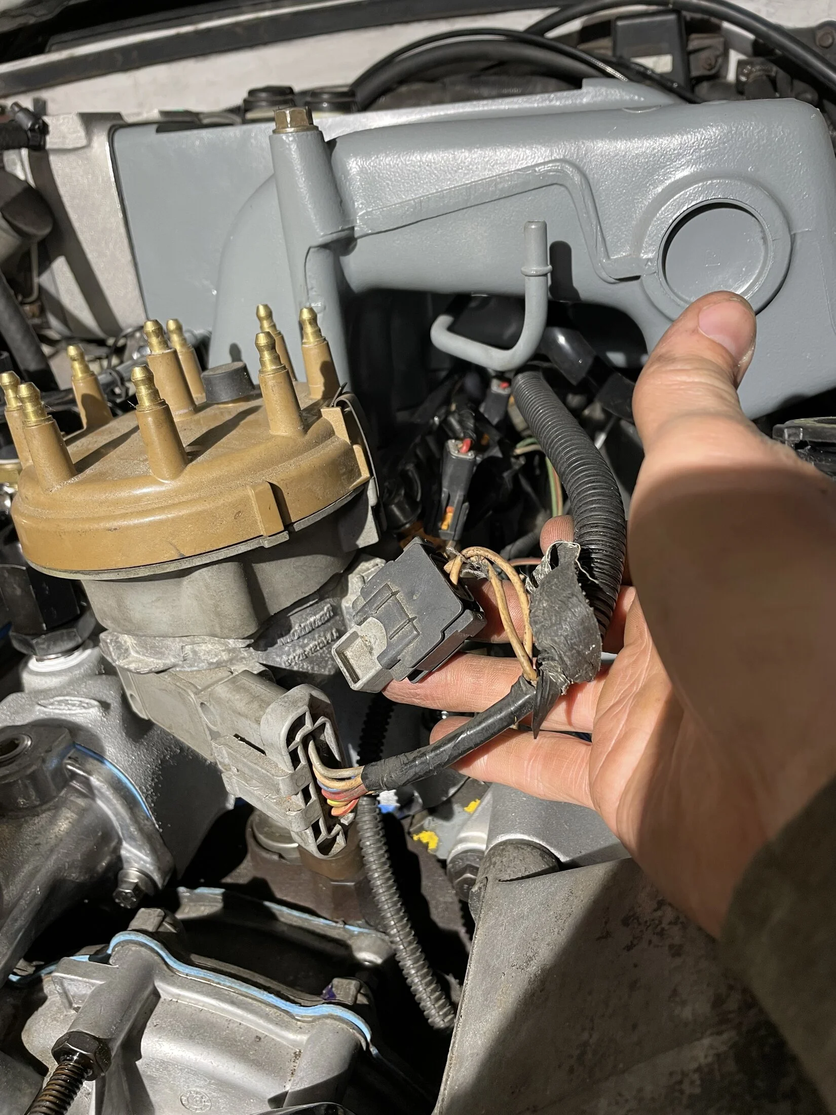

Do I do anything with this part of the TFI module? Videos just show it dangling?

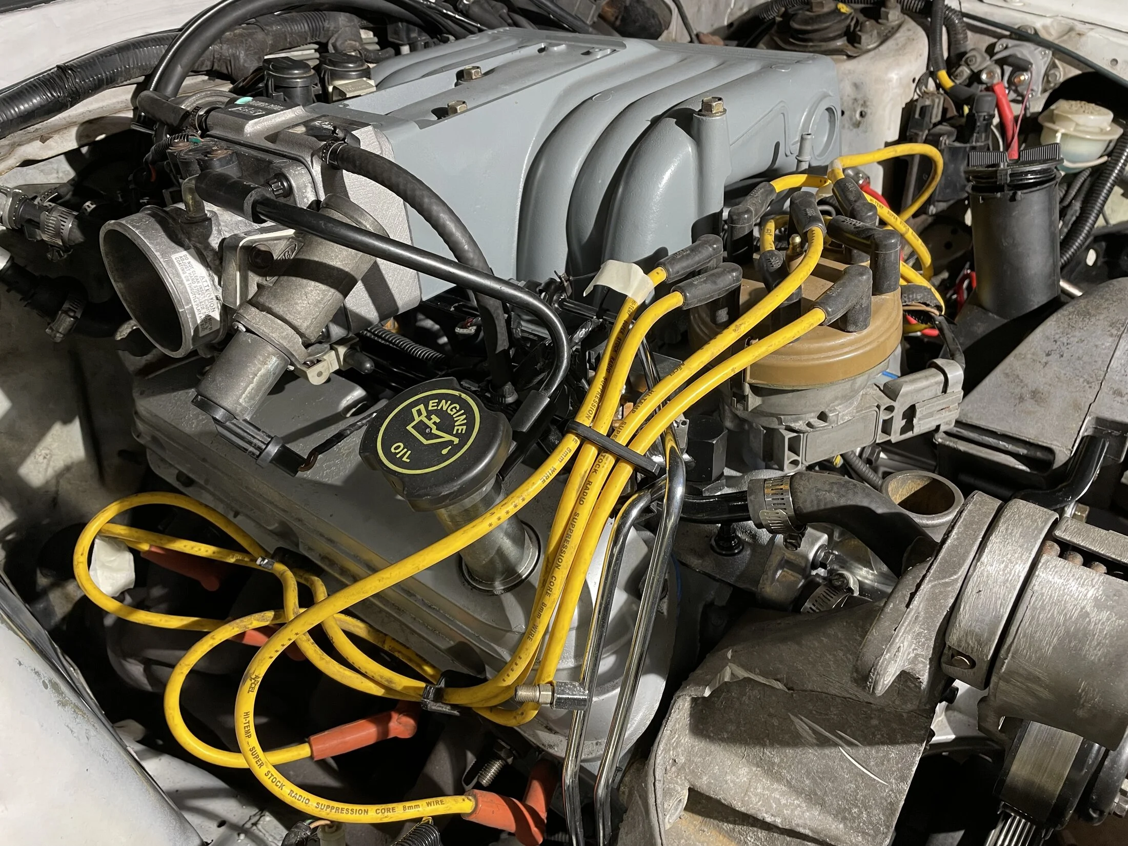

I will be triple checking the plug orientation. However, this is what I gathered from original pictures.

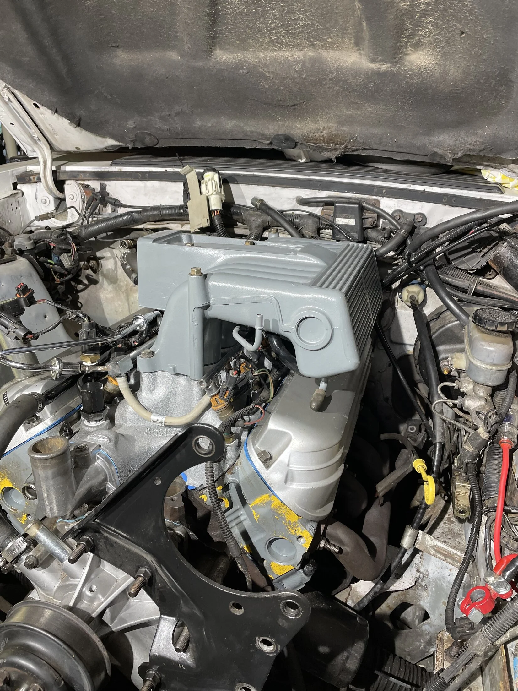

It’s closer

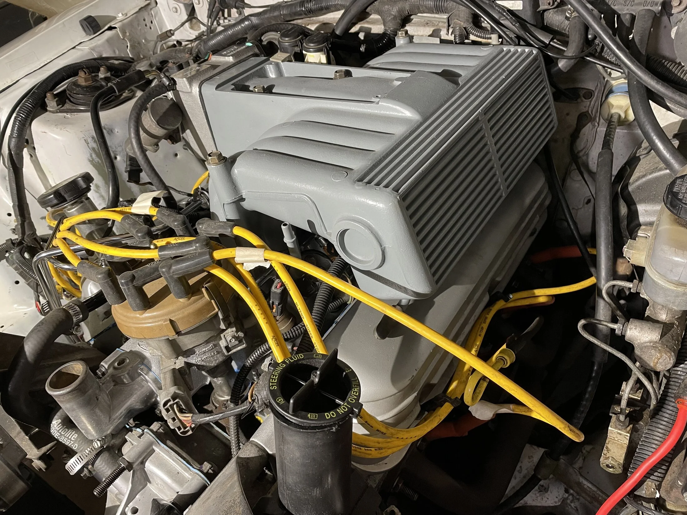

Am I missing something? Where is this supposed to go? Maybe it fit with the old upper intake?

That hung on the side of the intake on that ledge, hooked on the bottom too, it's been a long time since I've seen one mounted, fuzzy memory.
Yea - old upper has a notch in the top outside of that passage. I could create one, do nothing or mount it elsewhere.

I let the connections hang back there, I looked at a couple ways to secure them but you know how it goes.

"this part of the TFI module" is the spout connector and it just hangs out like that. You remove it to set your base timing and then plug it back in (after you shut the ignition off) so the ECU can control the timing from there.

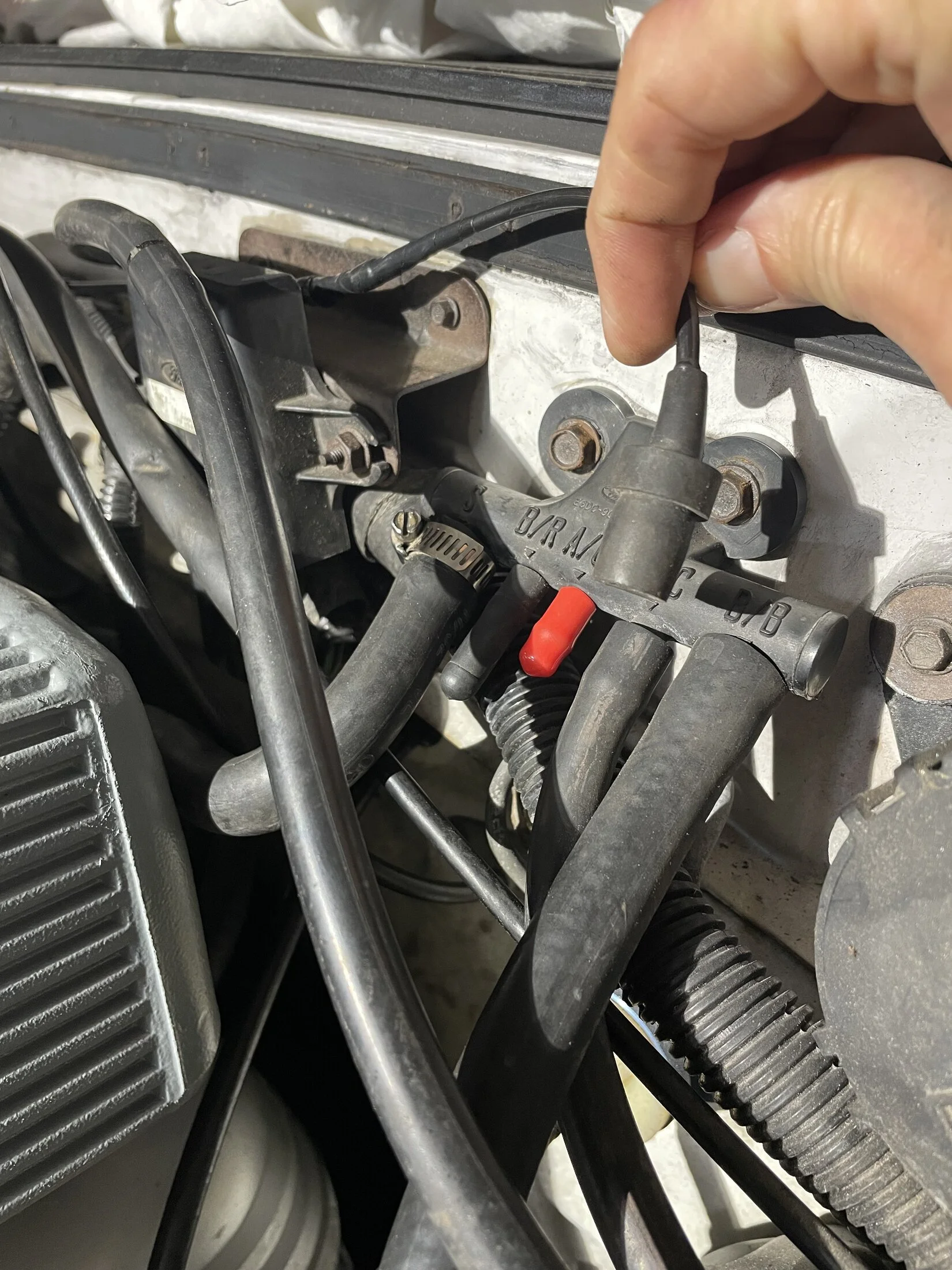

Step 1, close off AC vacuum at the tree. That should render all downstream AC hoses fine.

This is a good thread on vapor canister routing: https://stangnet.com/mustang-forums/threads/pictures-of-charcoal-canister-routing.893413/
So this isnt for just AC, but all HVAC controls on the dash? Why call it A/C?
Good video:
JAA
5 Year Member
Oct 2, 2018
674
110
63
Central MA
Jun 9, 2023
#740
  • Jun 9, 2023
  • #740
Vacuum. See attached pic.
Red line goes to fuel rail thing. North of the red black tube goes to the vacuum tree labeled 'S'.
That leaves those 2 front ports available. I still need vacuum spots for:
  1. Charcoal canister
    1. This is a natural fit for the capped one. I could snake the charcoal line behind the alternator, then distributor, then into that port.
  2. Master red vacuum line. Attached in second pic. The green line in that pic is EGR. Red is the one Im focused on
    1. This one could be routed to the remaining open vacuum line which pops up over the intake.
    2. Is this a good approach? Should I tee a different line and cap the open one instead?
