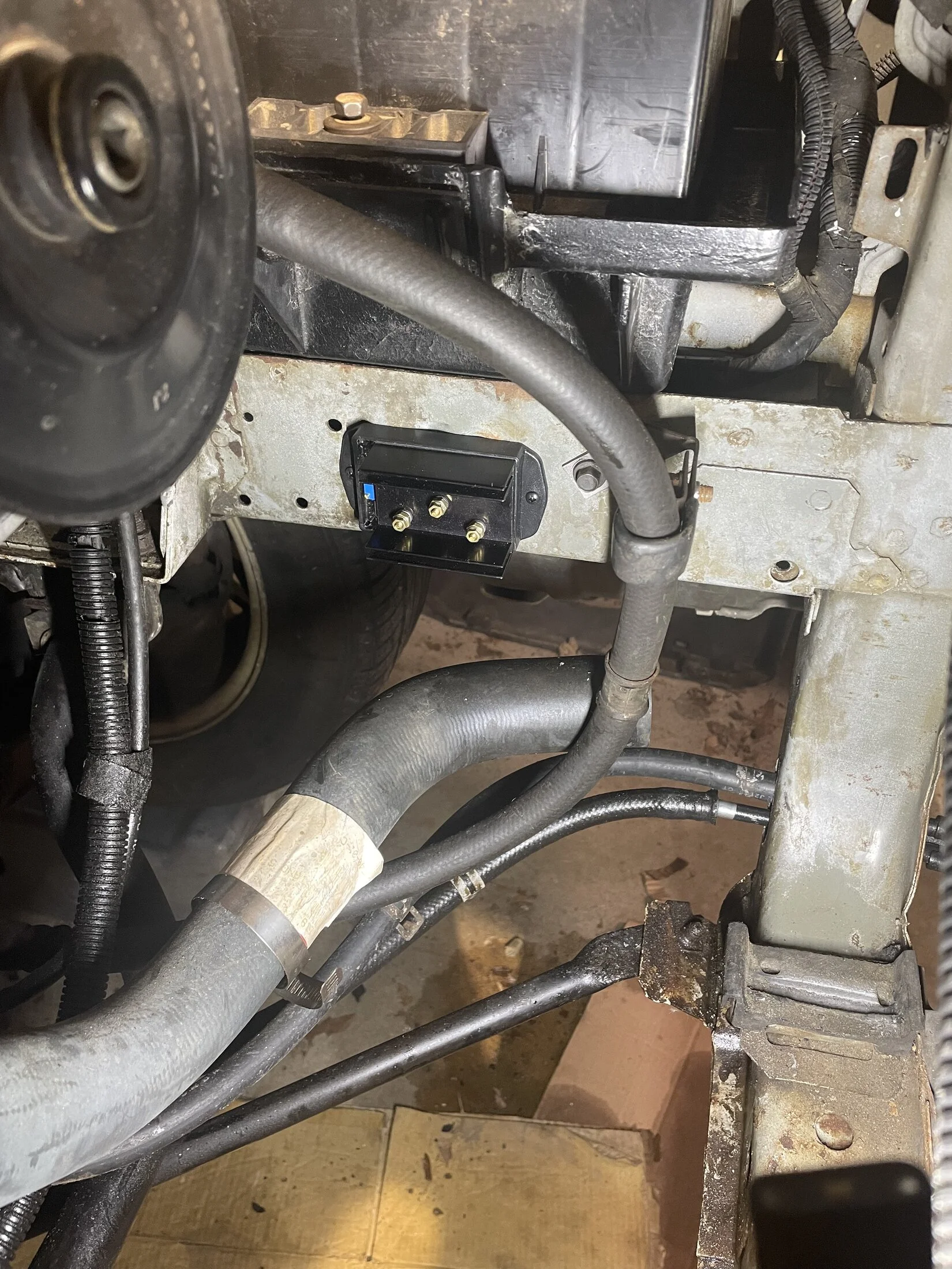

You may want to put the fan controller in the inner fender area so as to minimize water splash on it. I believe the unit itself is okay with water but the wire connections over time may not be. My other concern would be with the blue potentiometer that you can adjust for the set temperature for turning the fan on being the set screw may not be 100% water tight.
I dont drive in water

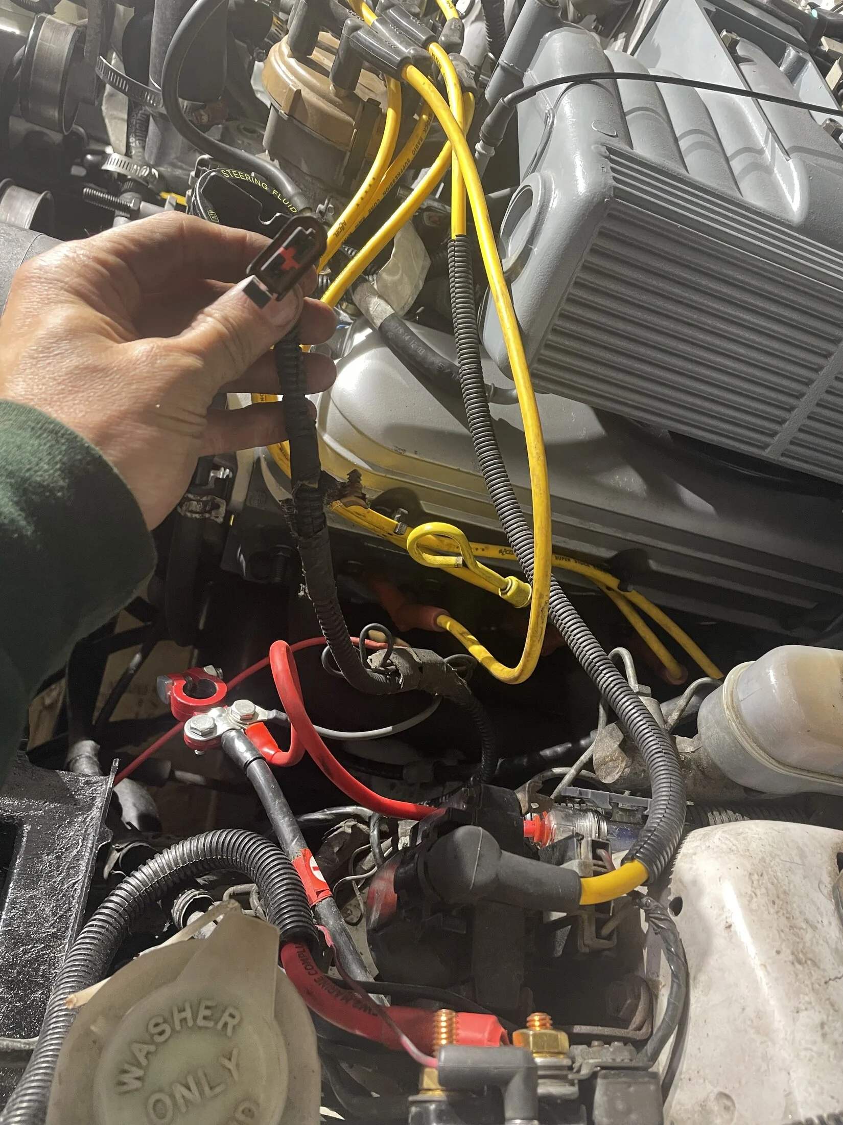

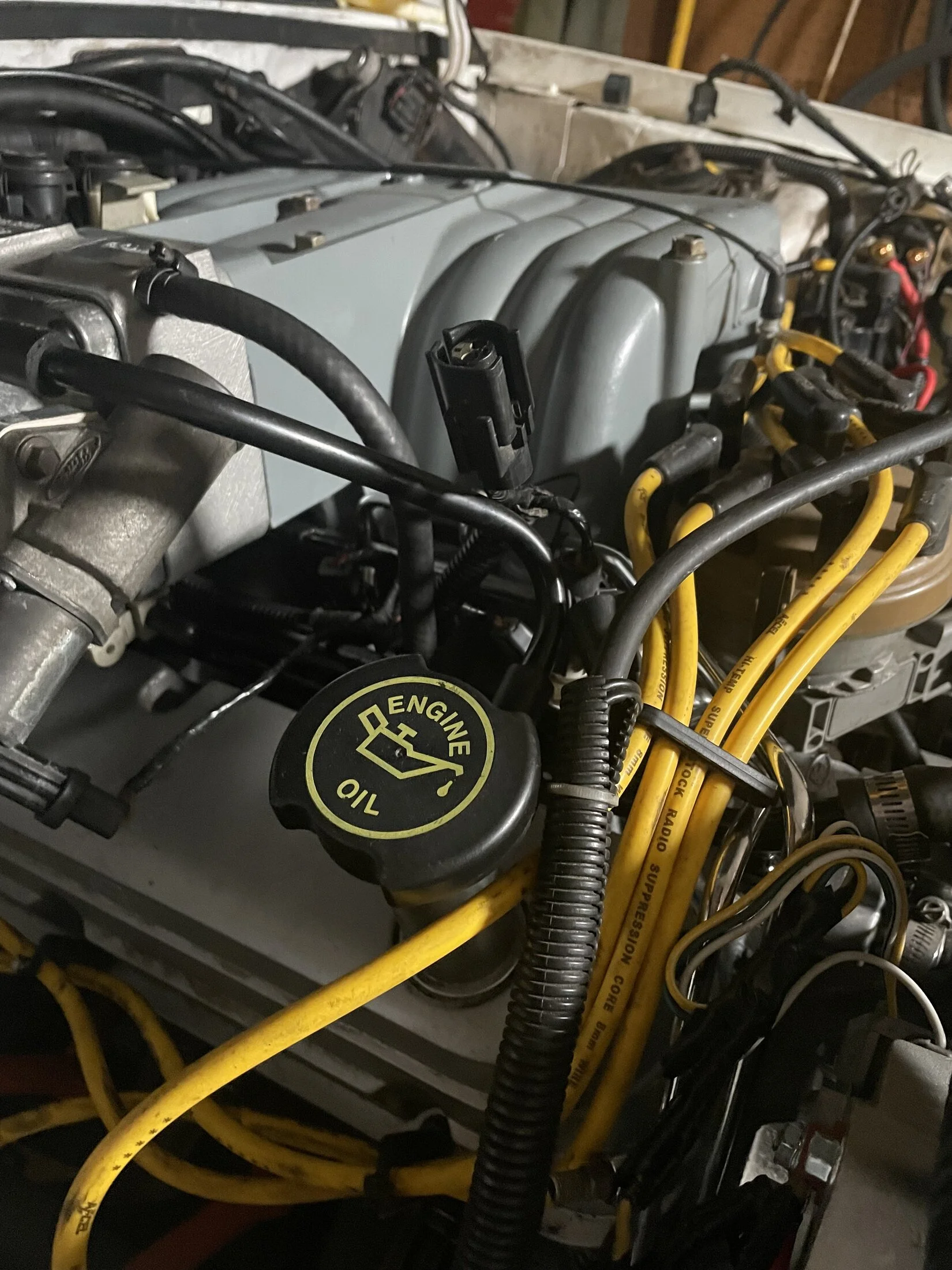

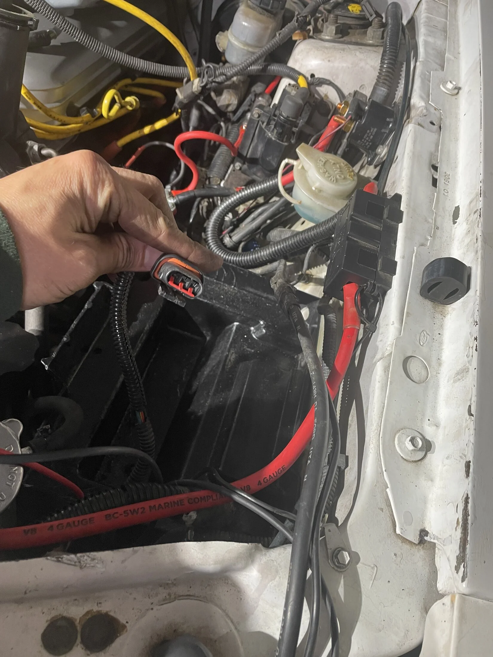

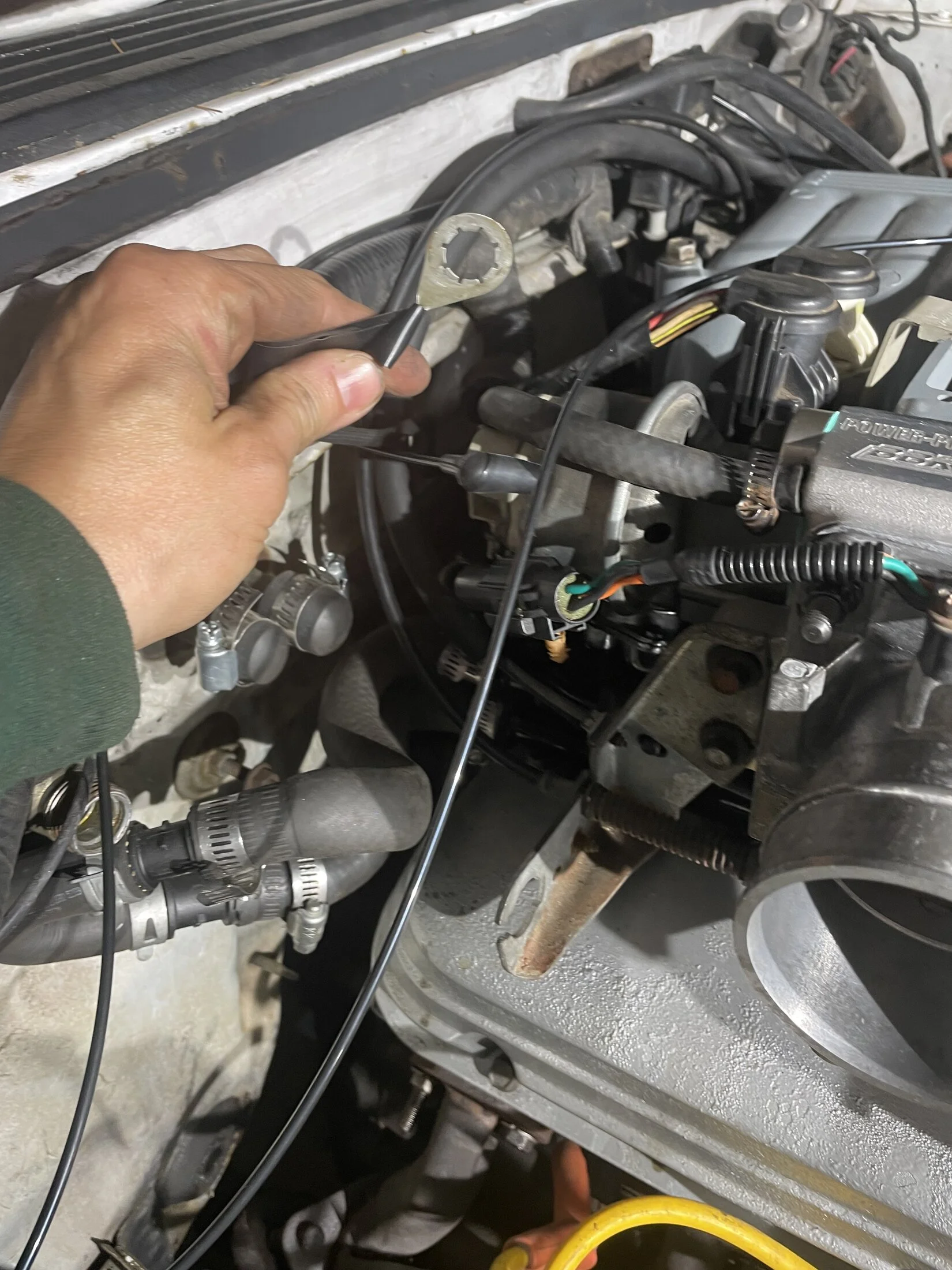

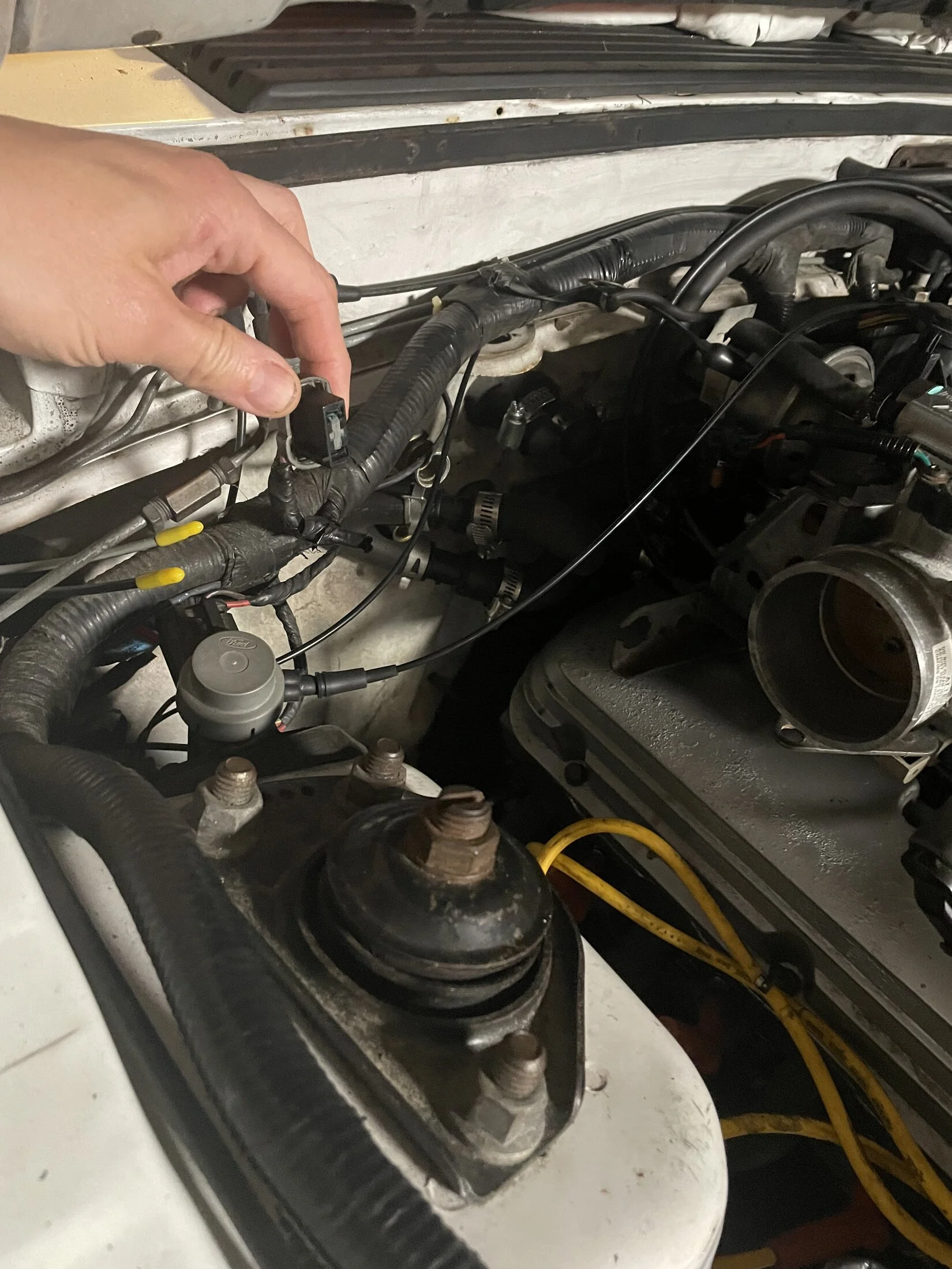

Who wants to play …
IDENTIFY THE MISSING ELECTRICAL CONNECTION!
First up I believe is the AC connector. I deleted AC, any advice here?
Next is a ground from the rear of the stock lower intake IIRC. Can I ground this anywhere? Advice?
This one is like next to the AC, near the lights and battery tray. Any idea?
This one is back engine bay passenger side. Right next to the vacuum connections there.
This one looks like it is part of the fuel injector power. A there a sensor or something that I missed?

JAA
5 Year Member
Oct 2, 2018
674
110
63
Central MA
Jun 10, 2023
#750
  • Jun 10, 2023
  • #750
Is the one by the batter tray maybe a low fluid sensor connection for the radiator overflow? I went contour electrical fan with the LMR overflow and I do not believe that has a sensor with it. Do I need to do anything other than let it dangle?

So the rear one, by the vacuum lines ... could that be the A/C low pressure switch? Link: https://lmr.com/item/LRS-19561/82-93-Mustang-Air-Conditioner-A-C-Clutch-Cycling-Switch

So its definitely the canister purge solenoid as its R GY/Y. I thought that was the connection closer to the canister itself. What is connected up there at the fuel rail?

Well that was silly. It was the canister purge solenoid. I just needed to find the male end of the connector to plug into the female. Once I moved a couple things there it was.
Last remaining is the ground from the rear of the stock lower intake. It maybe it was on the original heads?
