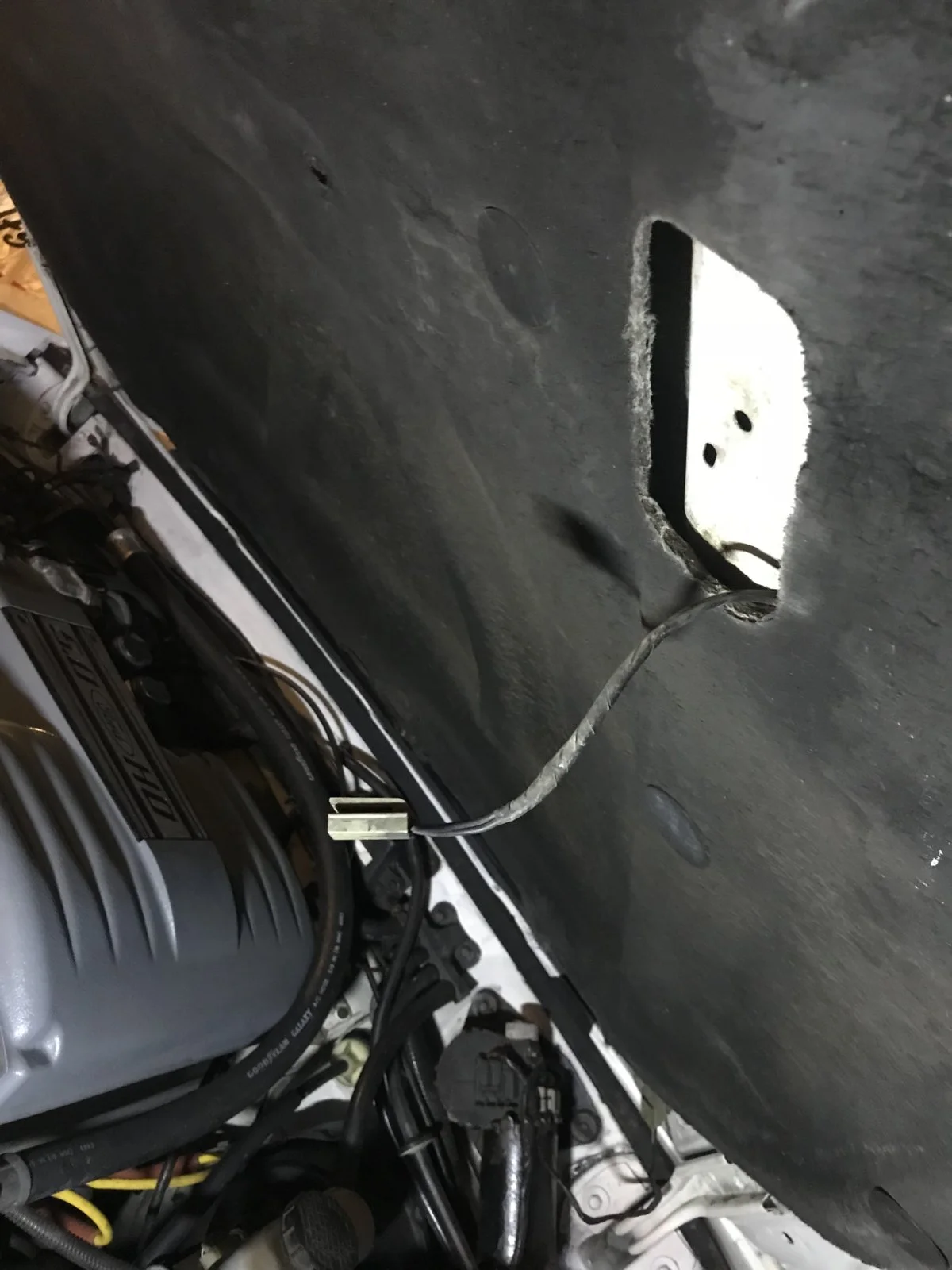

Anyone know what this is? I know it goes behind the instrument console and attaches via screw. I don’t know where the open end goes.

That looks like the support bar for the cluster surround.... let right corner. ( I think )

I cant find a diagram on it in any documentation. How does it get positioned?

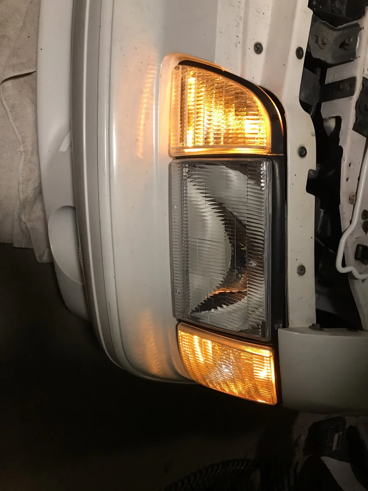

Parking lights are on

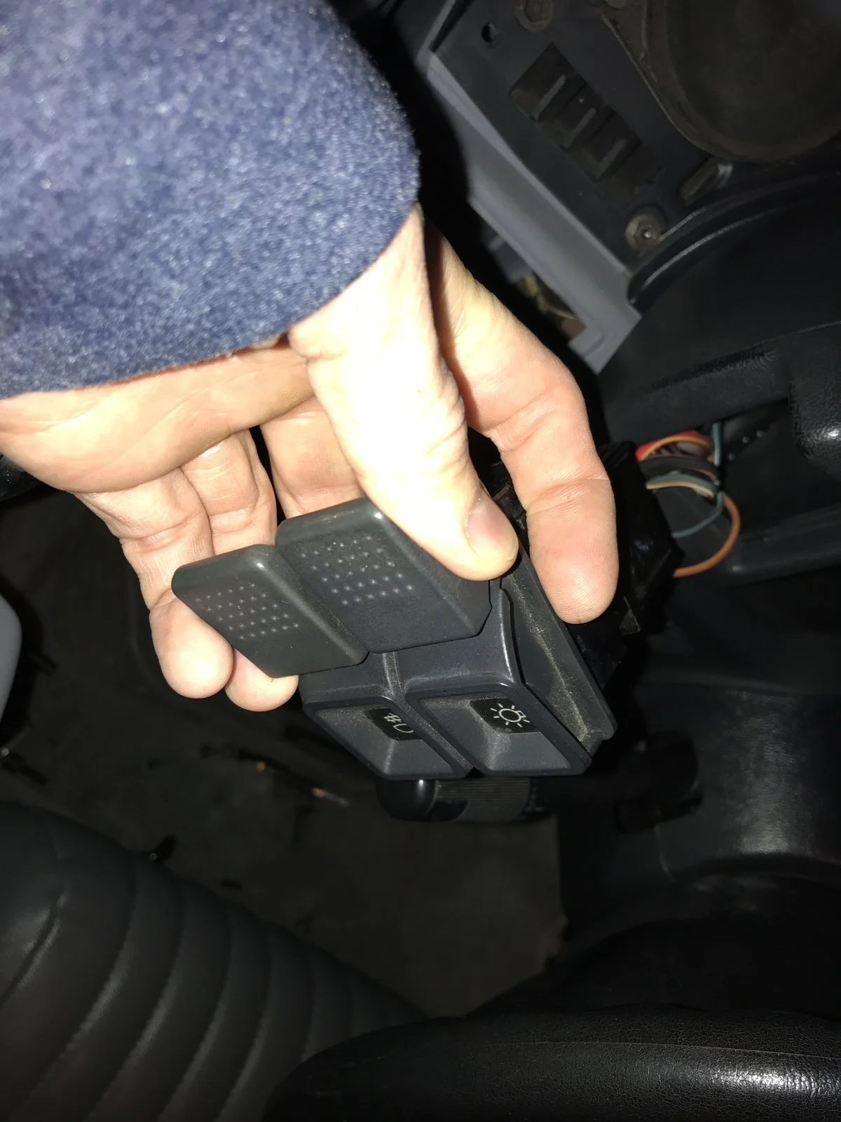

Looks like I may have busted the light switch. It seems not flush with the fog light switch. Thoughts?

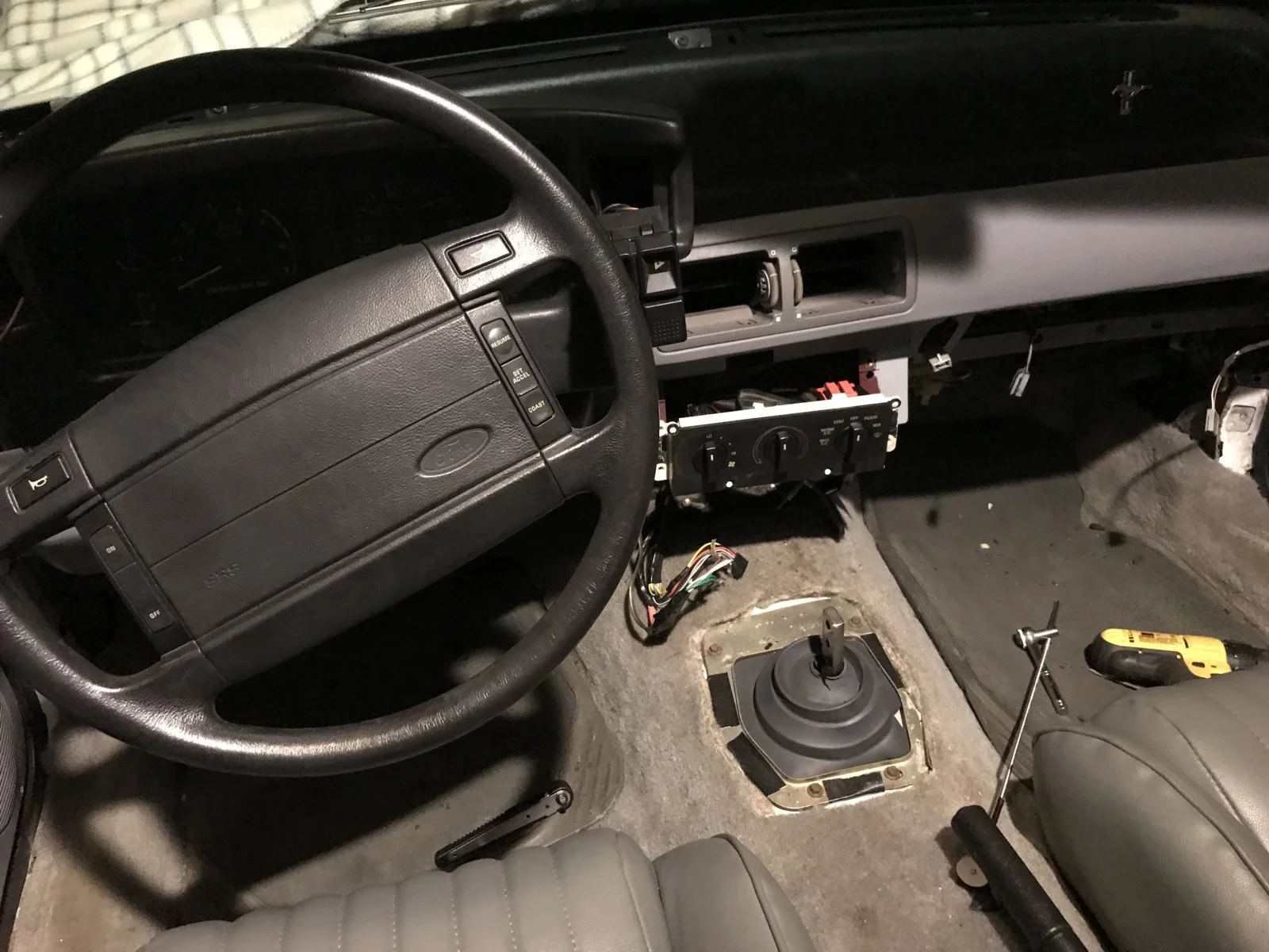

When were you guys going to tell me it took a full 10 minutes for the fan to really start pushing air? I thought I screwed it all up as no air was moving through the vents. All of a sudden the air started kicking.
Ok, you still got a problem then.
Assuming your fan resistor is good, you still have varying stages of speed on your fan, right? If so, the resistor is fine.
If you do, then your vacuum actuators are probably sticking and not changing the ducts around like they should. That or you have some obstruction inside the air box preventing the various doors from opening and closing smoothly.
The actuators either go all the way bad by a torn diaphragm in them, or the start sticking. They can be lubed, I did it with my airbox when I tore it completely down. Then you can test them with a simple hand vacuum pump.
I hate to think about it, but when one of my sons was little he knocked a coke over on the dash and all of that sticky goodness poured down into the defrost vents. Guess what I had to do?
So, does your fan have the different speeds?

Thanks for this
I must have jostled something when I was testing. I put the HVAC console back into place and started it up. Fan speed came straight away.
