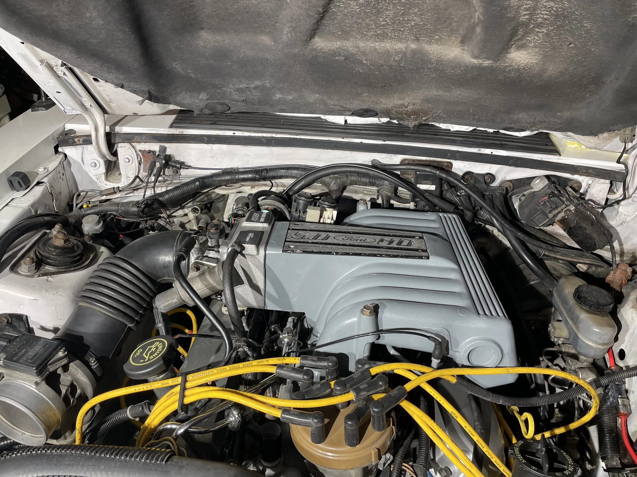

Rerouted the vacuum hoses. That front one for the master EGR ‘red’ line still looks ugly (pic).
Need to cable clamp fan wiring. Wire up fan temp probe and all done.
One last though is the top mount of the PS radiator loop. I forgot to do the top bolt, lol. Is annoying to get to especially without AC radiator.
