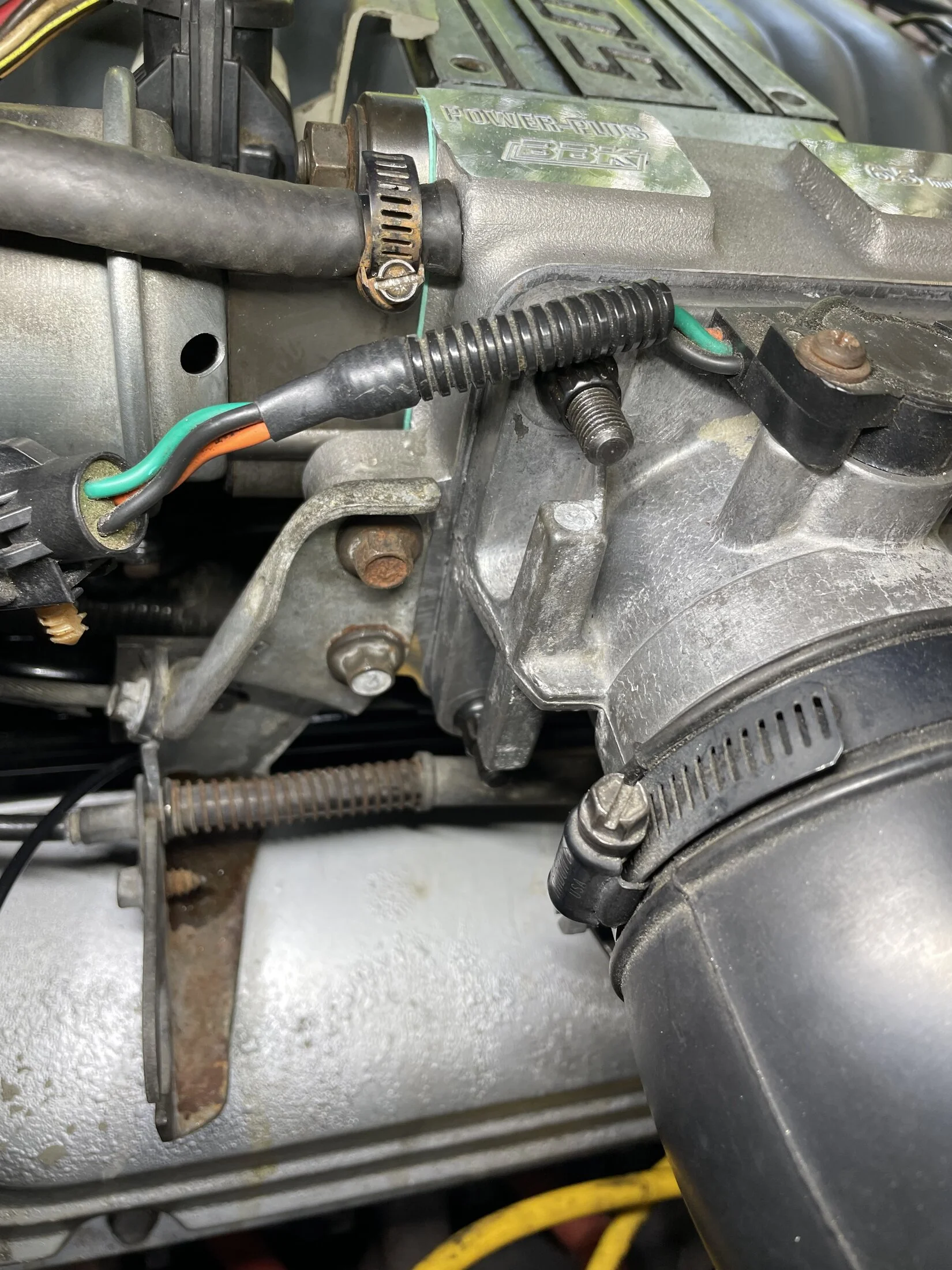

Adjusted the position of the temp sensor ... WE HAVE FANS!!

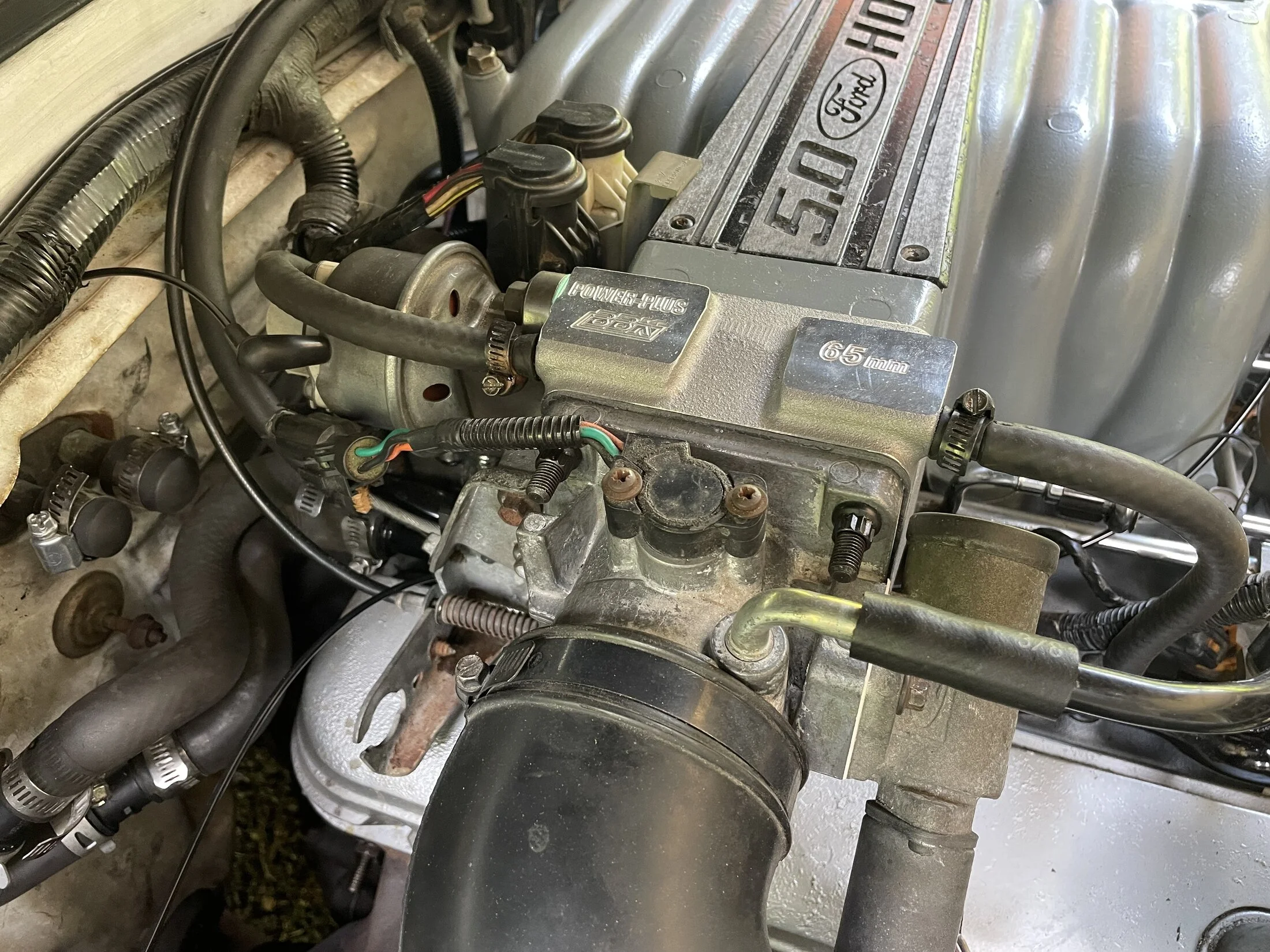

Let in run for a while. Wanted to make sure the fans cooled it adequately.

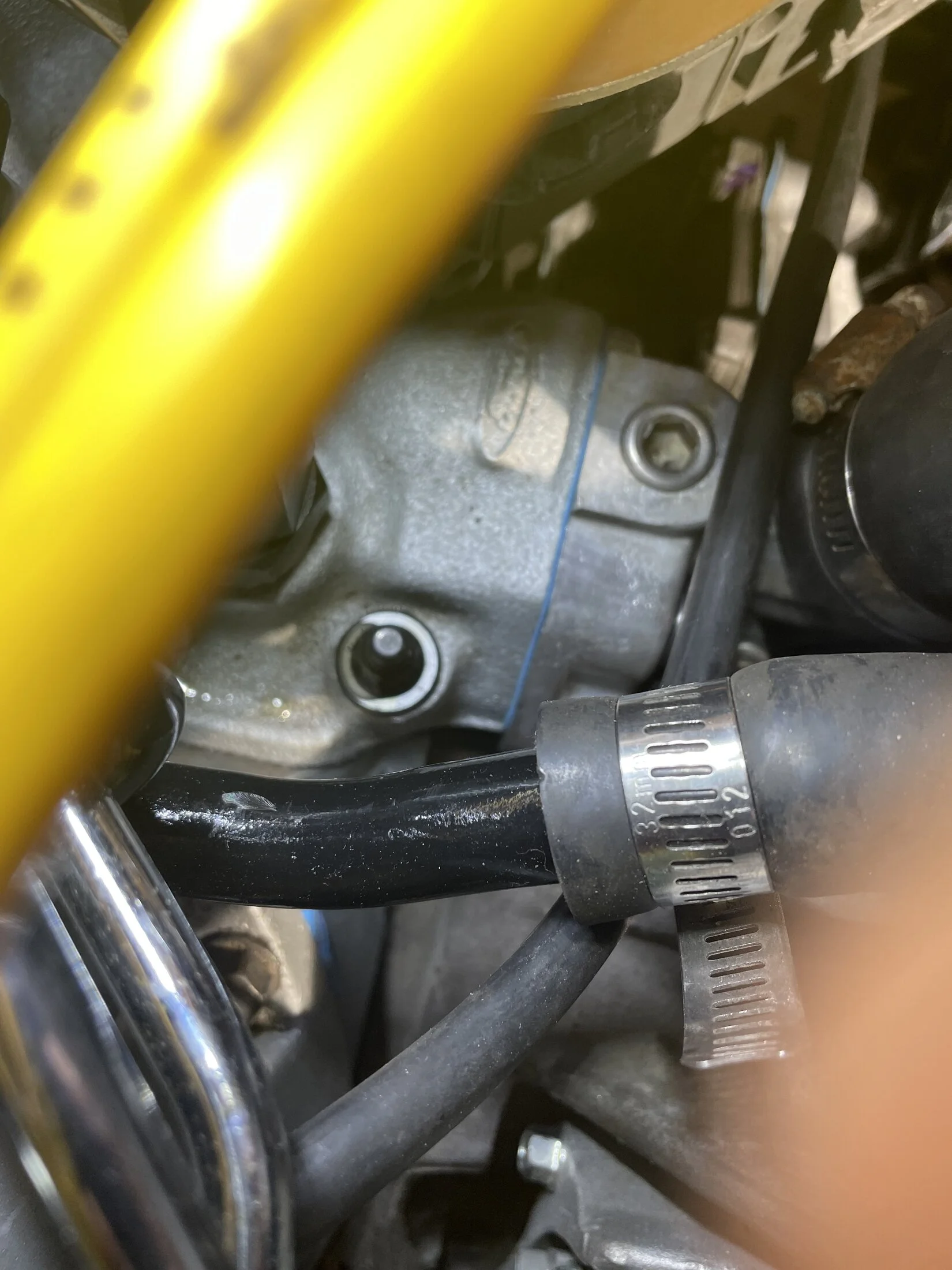

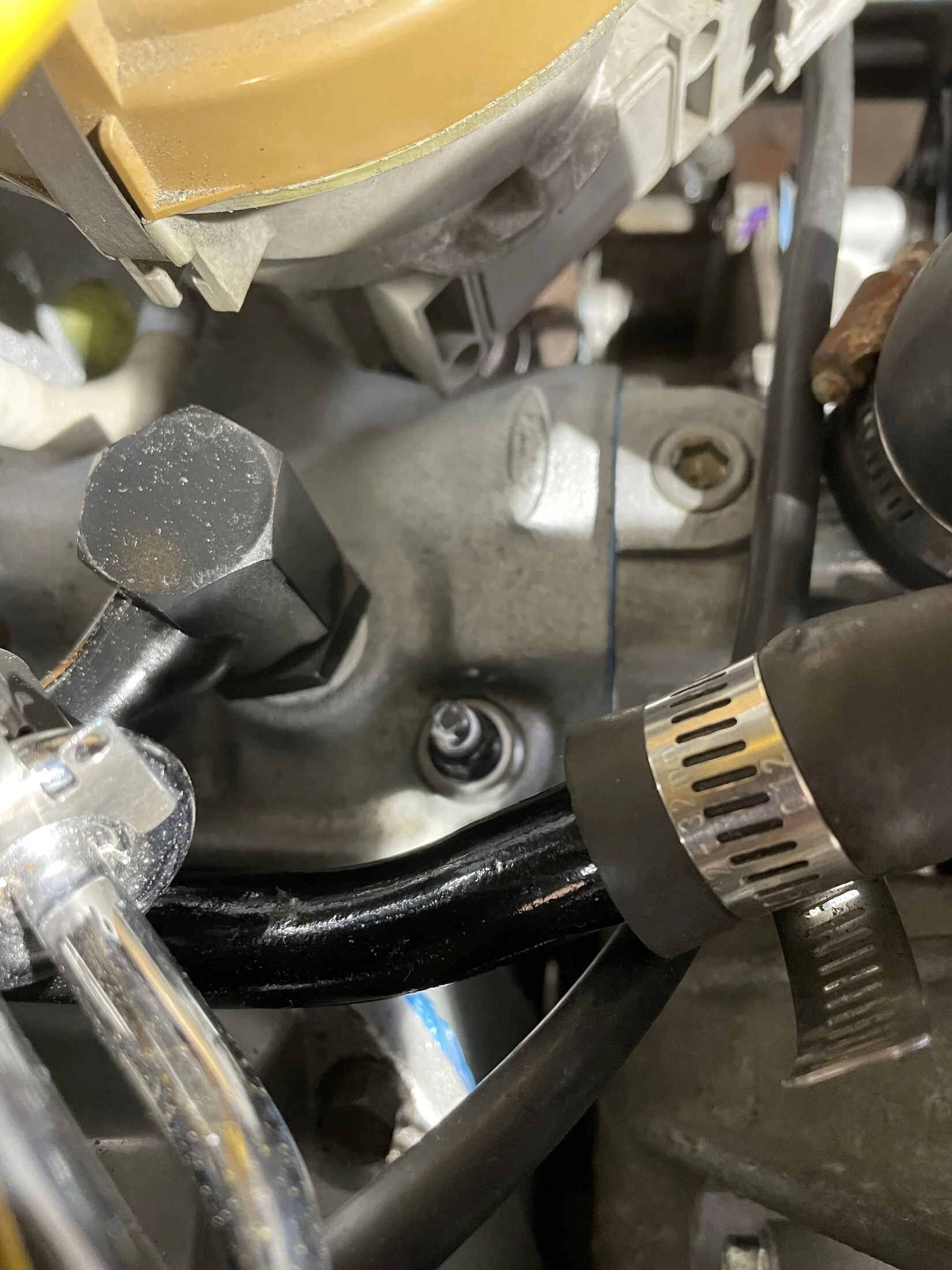

I see a slight coolant drip out of this front lower intake stud. Is this something I just teighten down, or do I need to do much more work? I dont think I used thread sealer on any of the lower intake studs.

LMR video didnt use sealant

So Im assuming the play here is to let the car cool, maybe tomorrow undue that nut. Redo it with thread sealant and torque it down. Yes?
Reactions: AeroCoupe

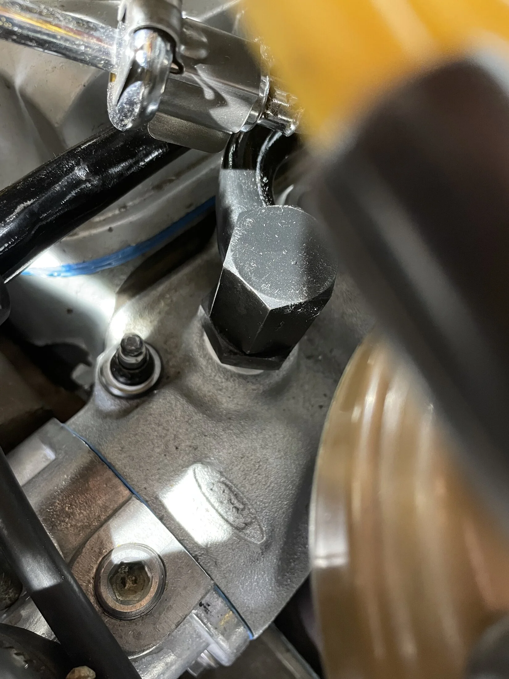

Just redid that jacket stud/nut with thread sealant. Even torqued in 3 steps for luck. How long to let the thread sealant seal, 24 hours?
Step 1 8 ft/lbs
Step 2 16 ft/lbs
Step 3 23-25 ft/lbs

Should be good on the morning.

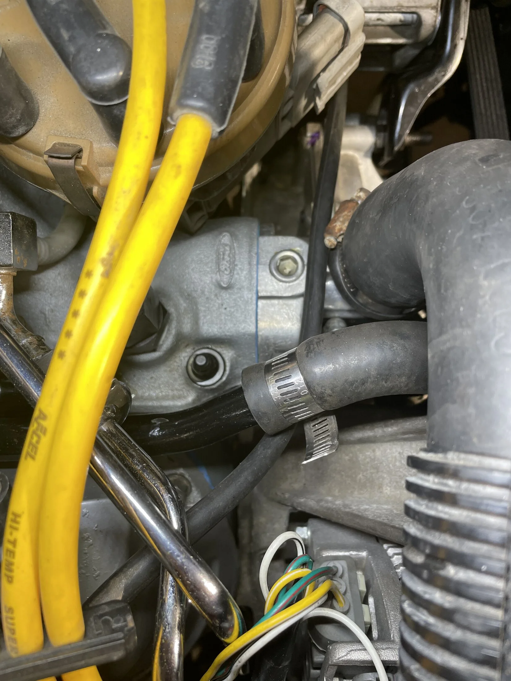

Minor leaks on both front and back of EGR coolant hoses. I keep tightening hose clamps. What’s up with that?

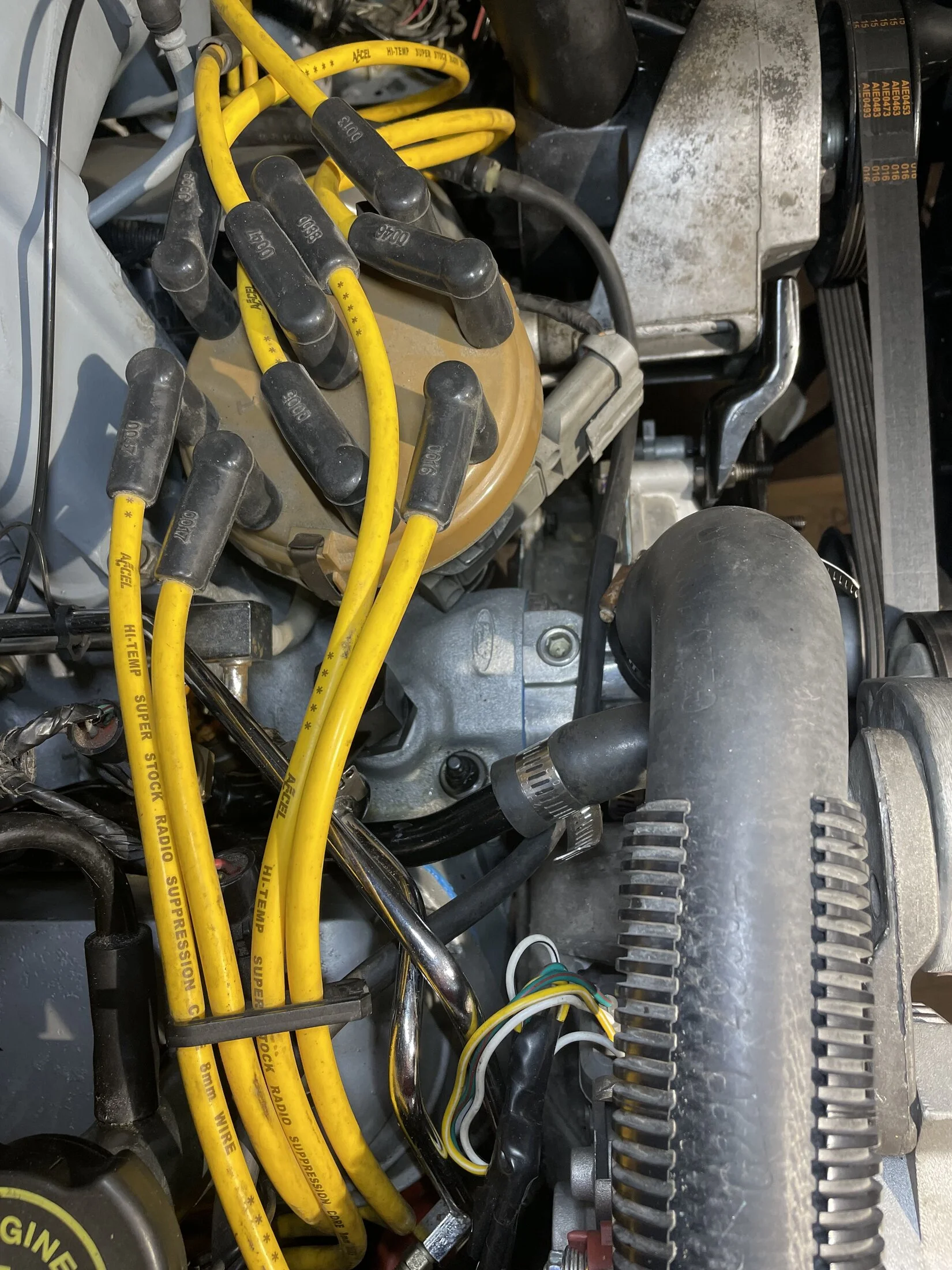

Oh, and more more slight intake coolant leaks. Yay. One on the front sensor fitting driver side and the other on the hose clamp going into the intake from the EGR rear of passenger.
