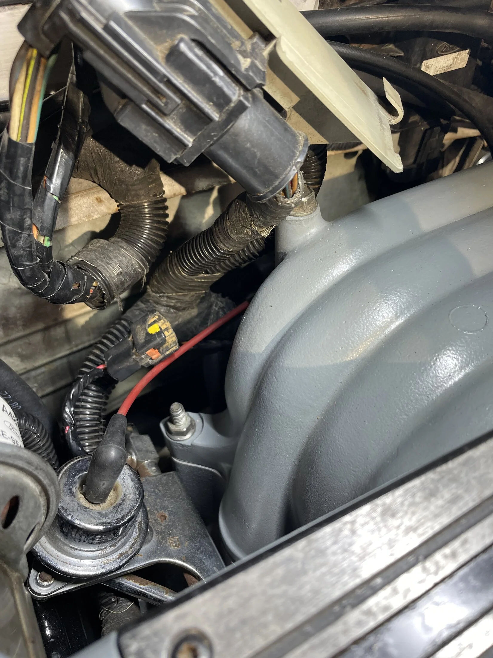

So I found another un-used harness. It is on the rear of the fuel line harness. It is a 2-pin connector with colors Red, Black/Blue. Its right next to EGR Position Sensor and the Throttle Position. Any ideas what it could be?
Here is a link to the diagram: https://stangnet.com/mustang-forums/threads/lower-intake-manifold-sensors.734820/#post-7301523

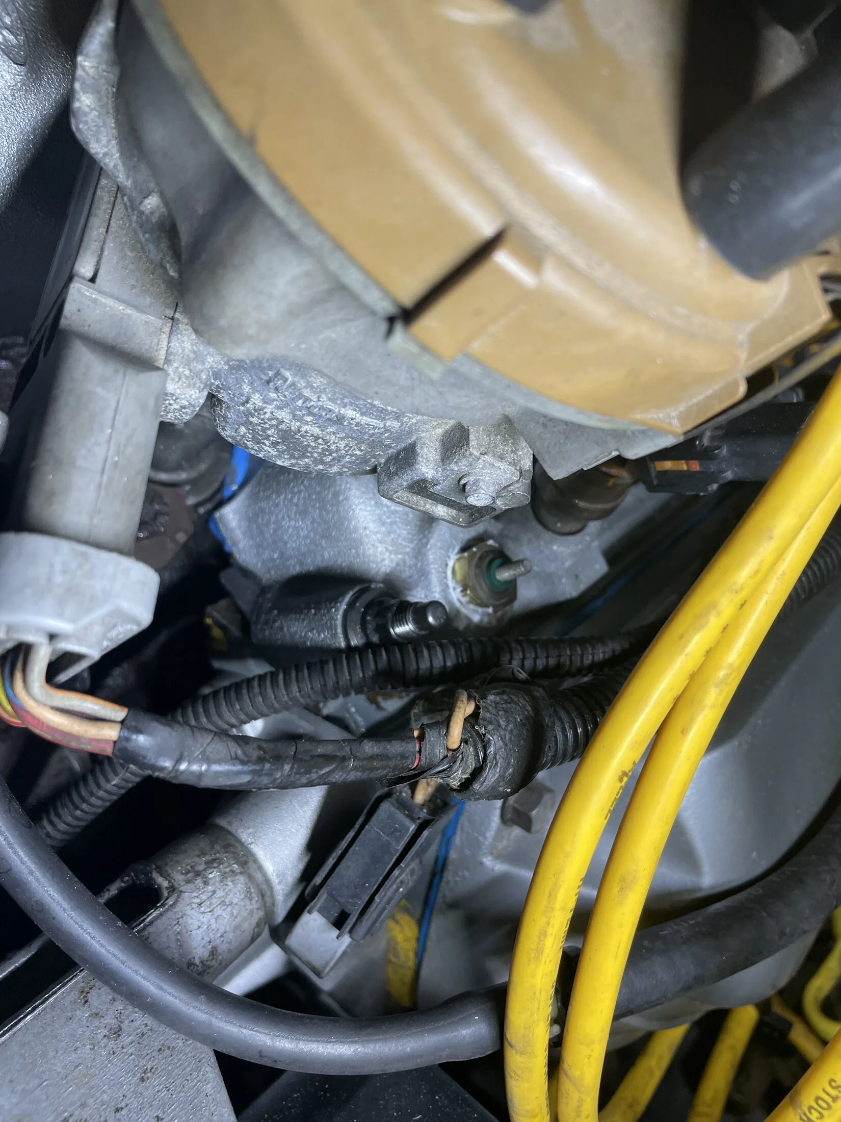

My temp sending unit keeps leaking (front of lower intake by thermostat housing somewhat under distributor). I had been using thread sealant. Is that not good enough? Should I be using plumbers tape instead? Any other tricks?

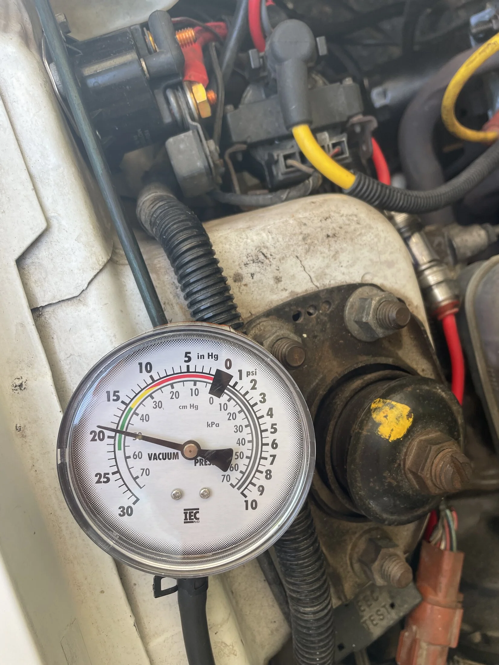

Don't know whey I didn't try this earlier, but I hooked up a vacuum gauge to the tree (the capped B/R port). I started the car and got a 19 reading (see below). I didn't see any flutter away from 19. When I would hit the gas it would go down and them come back up, even over 19 and then right back to 19 and stay solid. Is this expected?
Reactions: General karthief

PS - I saw a minor leak coming from my plumbers special on the temperature sending unit. WTF - is the right play here just to not start the car so I dont have any problems?
Ill take it for a ride today to see how bad it gets. I also ordered some of the loctite 565.
In all seriousness, Im wondering if Im not letting the sealant cure enough. It should be done in like 24 hours, but Im wondering if it would be helpful to give it more time. Id like to stop by the Friday afternoon car show again. As long as the leak is minimal ill prolly do that Friday night and then redo it with the 565 sealant liberally over the weekend and give it a number of days to settle.
If that doesn't work all I got is to tap a larger port and use a reducer, though that's a bit of scary territory.

19 psi of vacuum is right in the ball park with a stock cam.
Reactions: JAA
