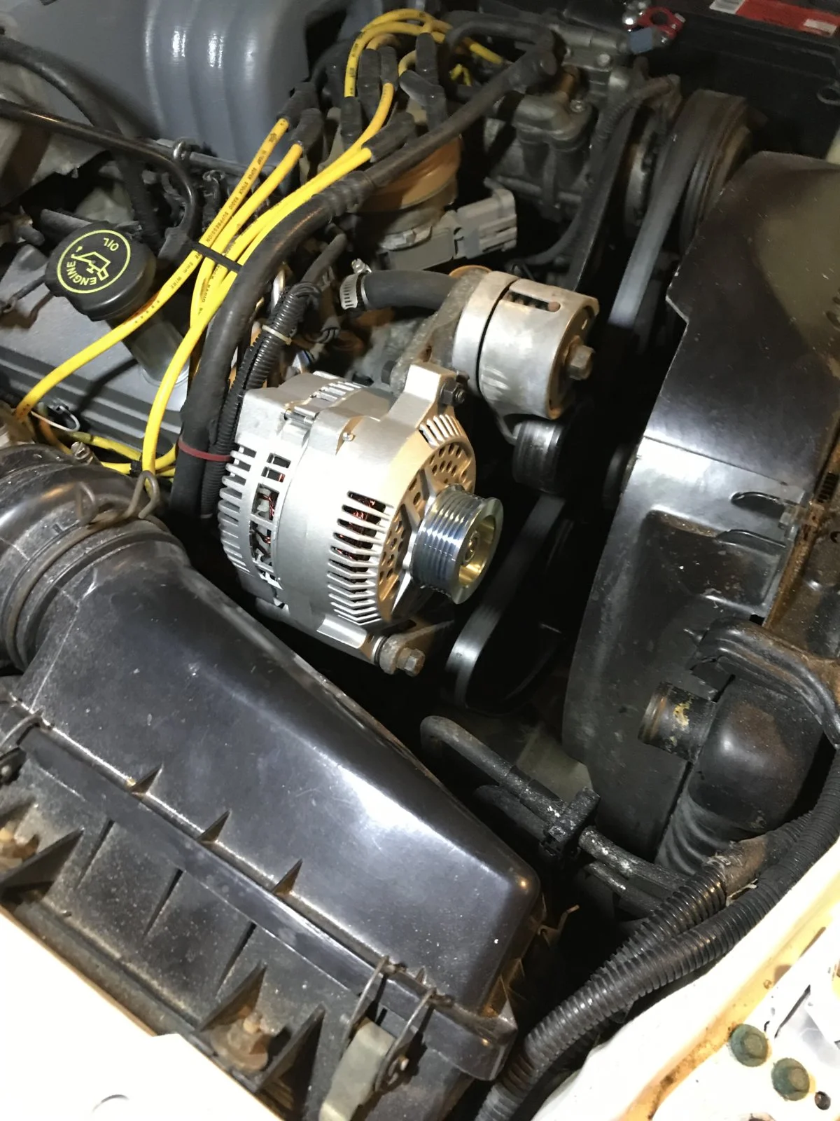

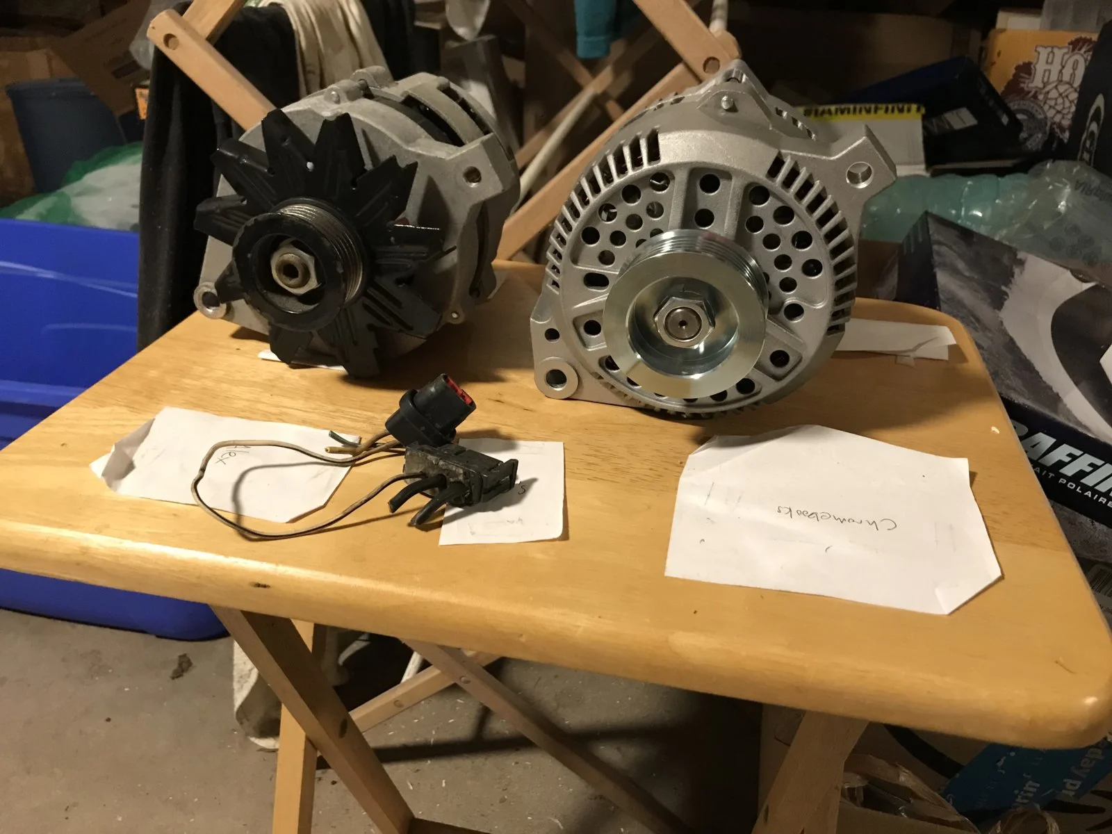

Just got around to calling the local junkyard. None of these for me to snatch an alternator:
  • Mustang 3.8L (94, 95, 96, 97, 98, 99, 00)
  • Mustang 5.0L (94, 95)
  • Taurus/Sable 3.0L (93, 94, 95, 96, 97, 98, 99) except sho
  • Thunderbird/Cougar 3.8L (94, 95, 96, 97) non sc
They did have an 01 mustang. Ill have to go back to the junkyard thread to see what I can pick.

I got lazy and ordered the LMR 130 upgrade kit. I know lots of folks don’t like the quality of their parts, but for me I like their kits and videos. It just makes it easier for me to be lazy.
Some before and after:

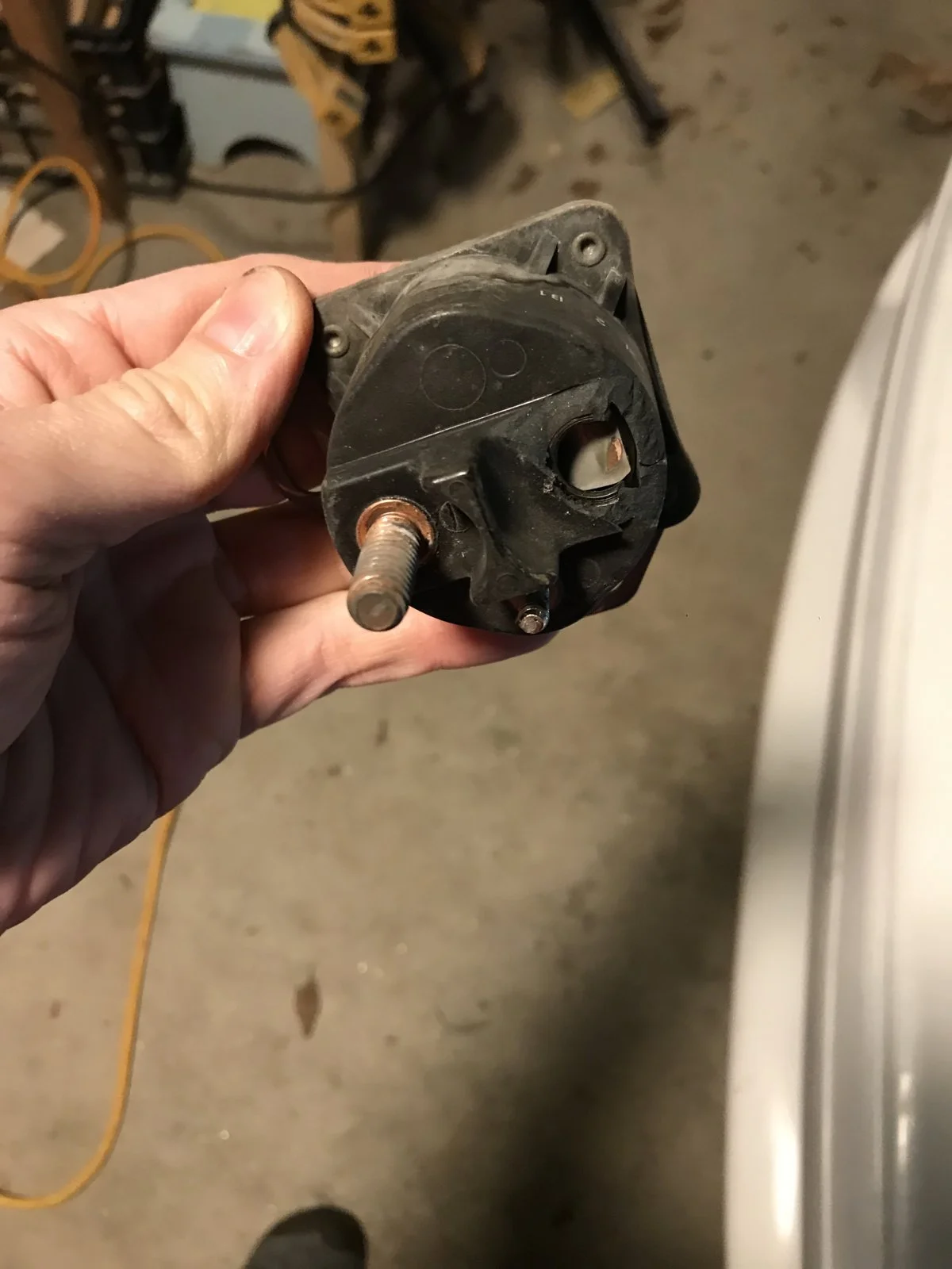

Now onto my question
I over torqued my starter solenoid
All the replacements I found at parts stores the posts were much shorter. I can barely get on the retaining nut.
Is there a preferred solenoid which has long posts?
Order a Motorcraft replacement from Rock Auto if you have the time to wait for it. Otherwise I would have the local parts store order one for you.

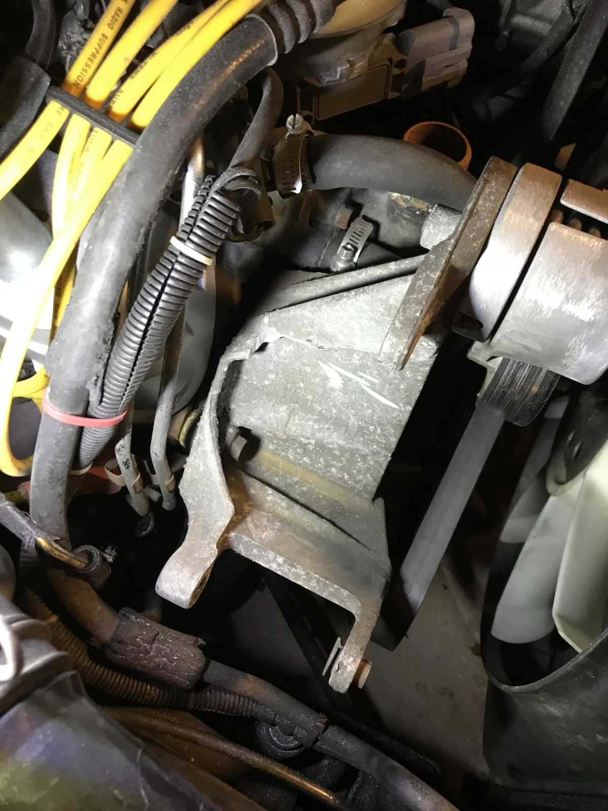

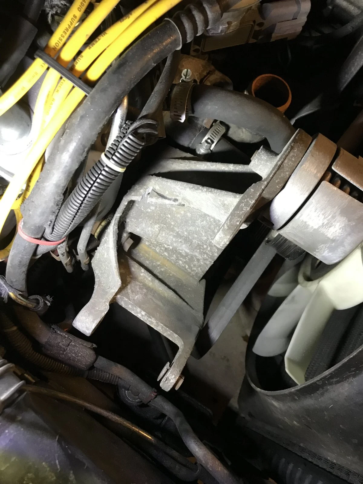

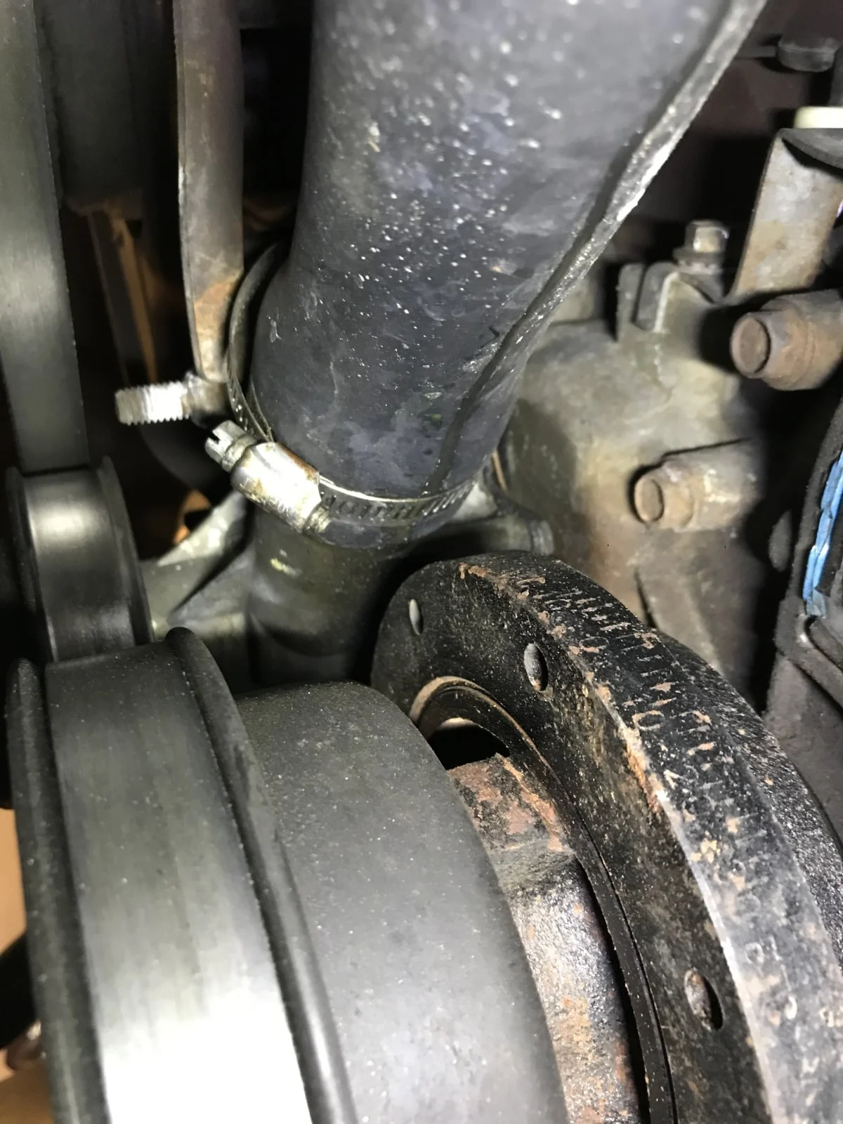

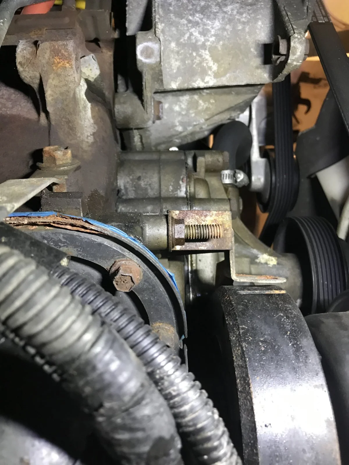

2 coolant leaks. One looks easy, the other doesn’t
Tighten a hose should be simple enough
And, this looks like a gasket:

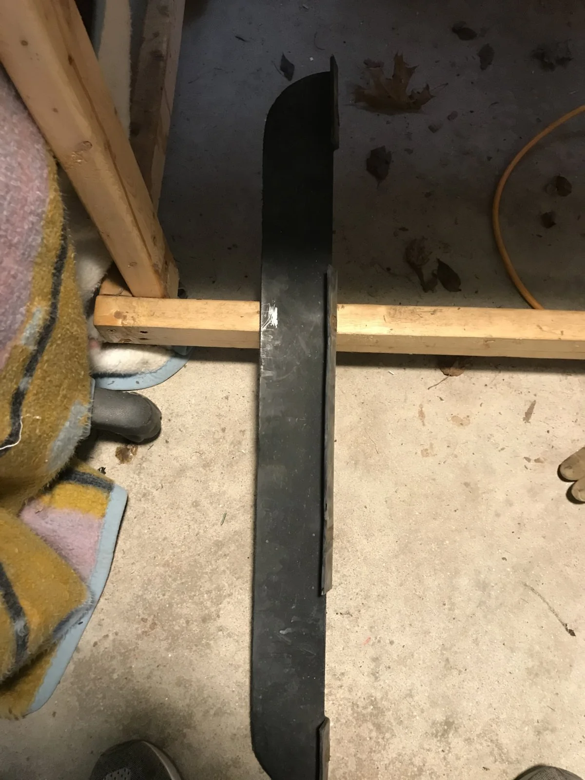

Also, what does one do with the under carriage guard? Do these get kept on or replaced? Upgraded?
That’s the lower air deflector. You want to keep the on. It’s there for cooling purposes. If that won’t go back on or it’s damaged, get a new one.

Looks like a timing cover /water pump leak, be careful removing the bolts that secure them to the block, electrolysis tends to seize them up in the block.
Reactions: JAA
Thanks. I’m thinking it’s the water pump area. I’m looking for better pictures of the system.
If it is the water pump, do I just replace the gasket/seal or do I replace all the hardware while in there?
I would do it all while your in there. Hoses, thermostat, coolant. How’s the radiator?

You likely will have to replace the bolts, slather them up with anti seize, makes things easier when it has to be worked on again.

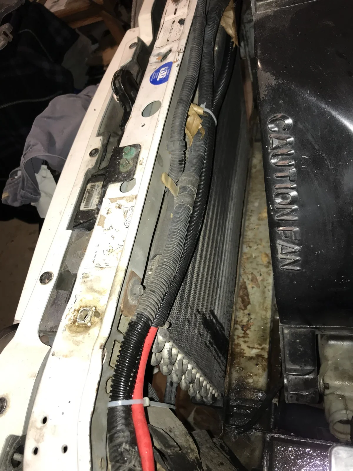

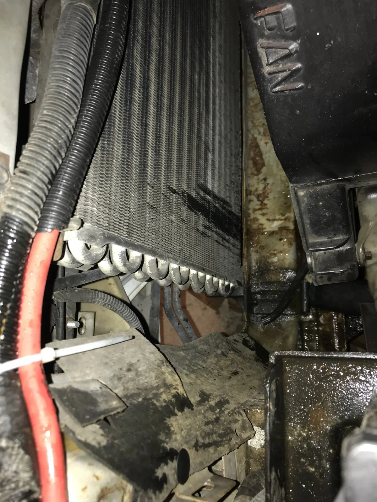

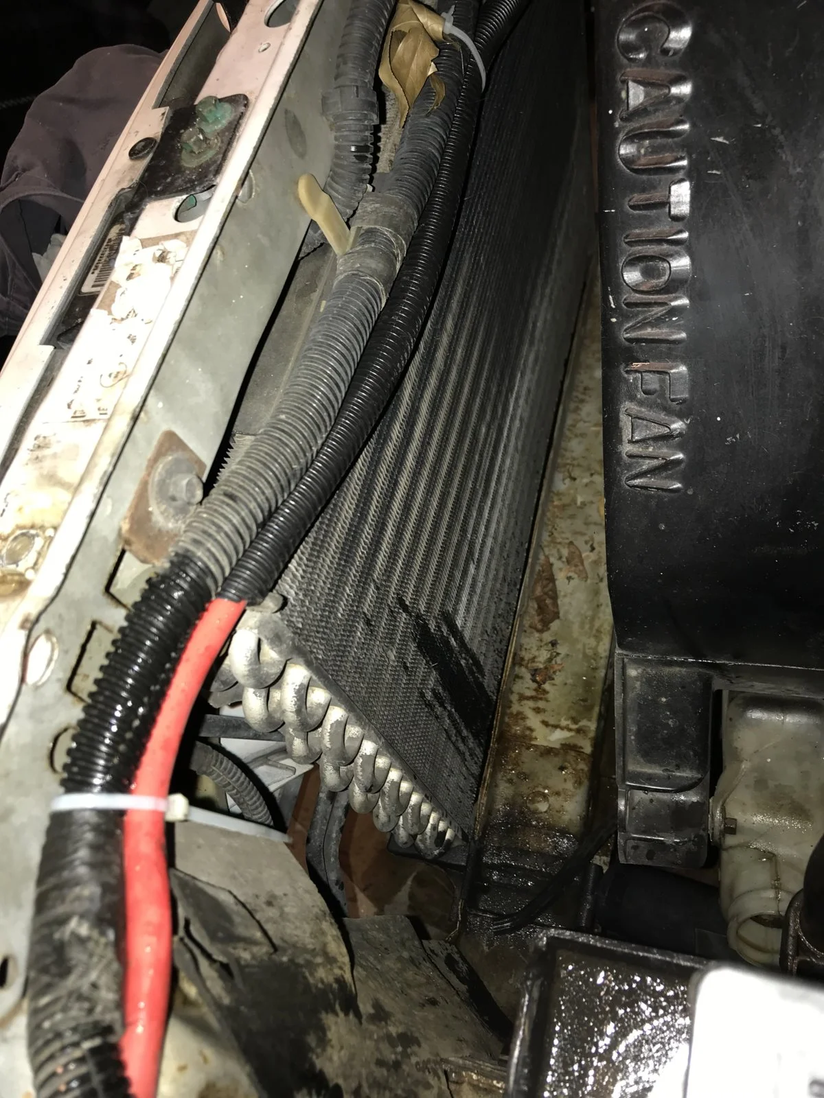

In the process of replacing radiator, water pump and thermostat.
This vehicle was an auto convert to 5-spd.
It seems I have 2 radiators. However, after taking out the standard one, the remaining one doesn’t seem to be connected to anything we can see.
Is this the auto trans radiator? If so is it in use? Should I leave it alone or remove it?
Pics
Mustang5L5
Mod Dude
Feb 18, 2001
43,260
17,945
224
Massachusetts
Aug 10, 2019
#96
  • Aug 10, 2019
  • #96
That's the AC condenser
Reactions: JAA
Thanks all. Yea, we did some additional reading. We were a little caught off guard, should have read a bit more before commenting. Thanks again.

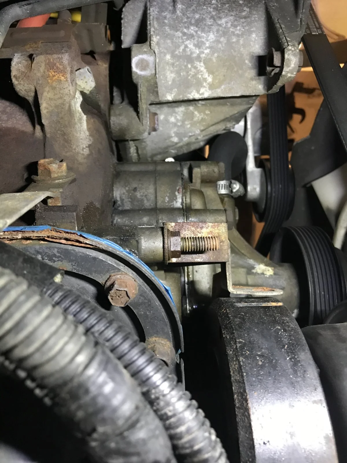

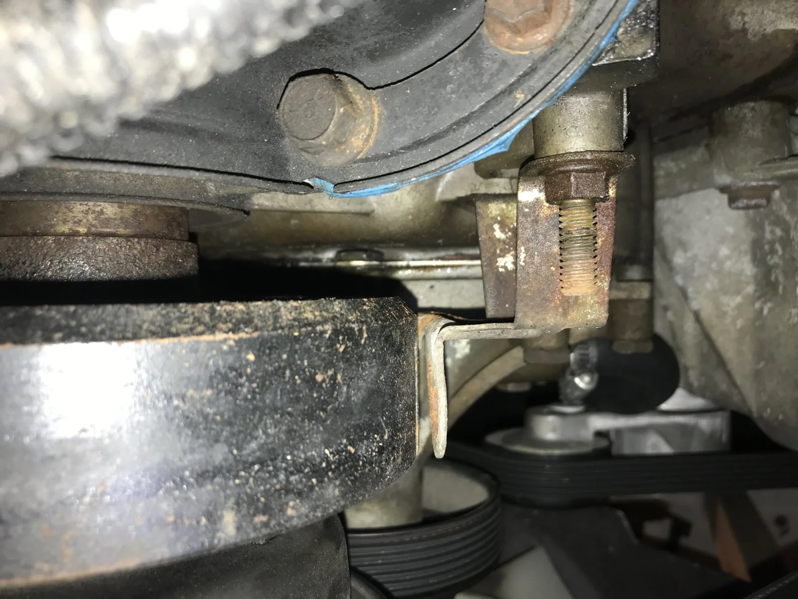

Fml - one broken bolt on the water pump. Snapped off at the thread start. Time to start reading how to tackle
PS - I did but all new bolts for it.
Pic
Reactions: General karthief
JAA
5 Year Member
Oct 2, 2018
674
110
63
Central MA
Aug 11, 2019
#100
  • Aug 11, 2019
  • #100

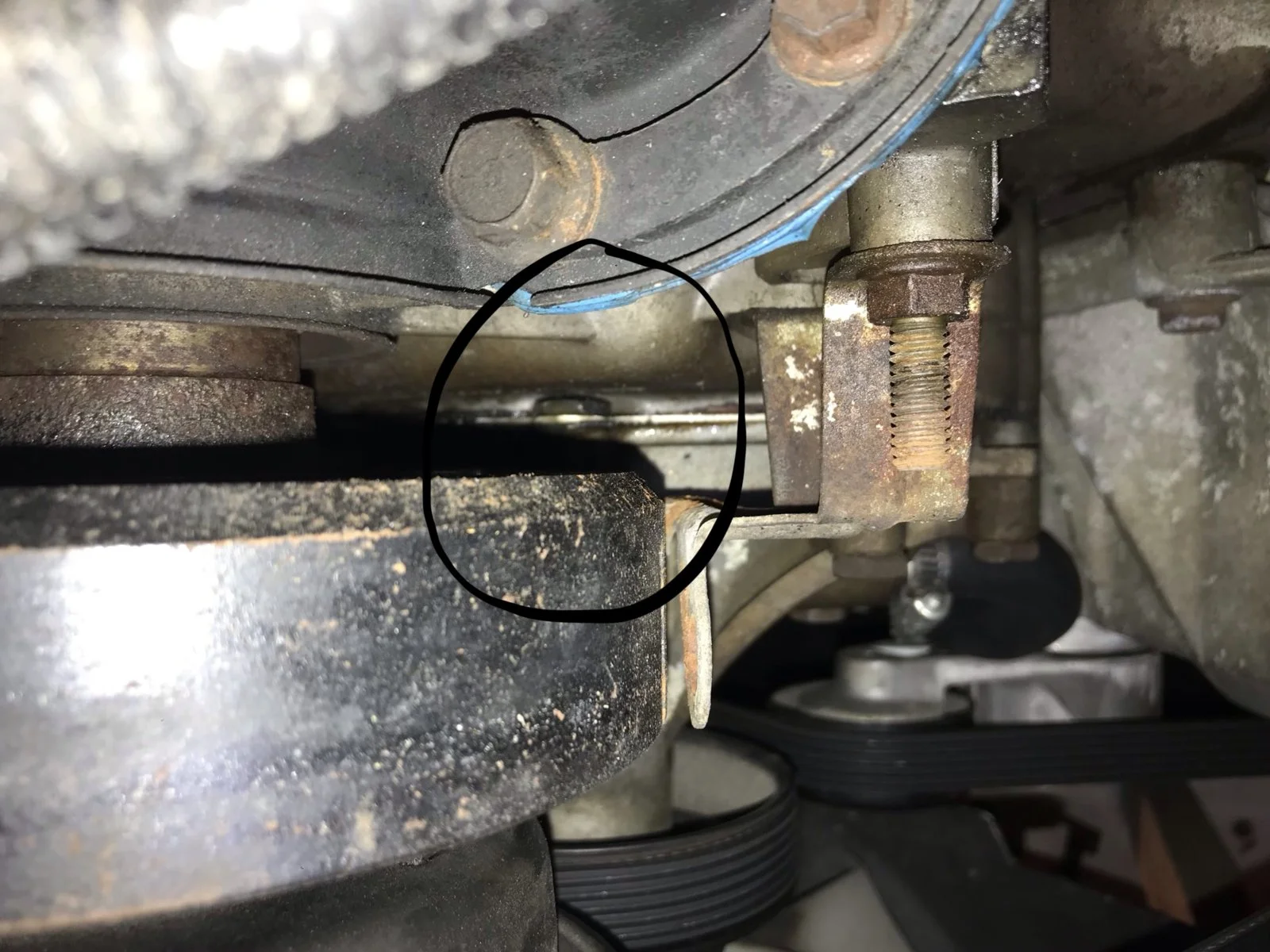

So it appears this prticular bolt thread broke off about 3/4 in timing cover and 1/4 in block. Can I even take the timing cover off now?
