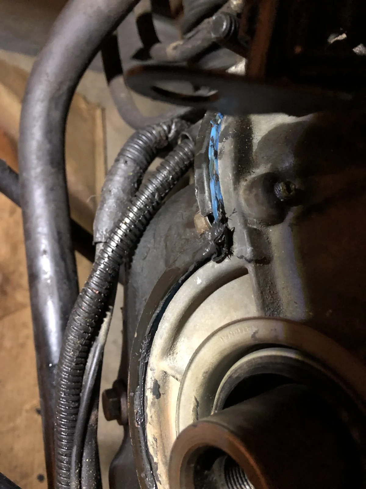

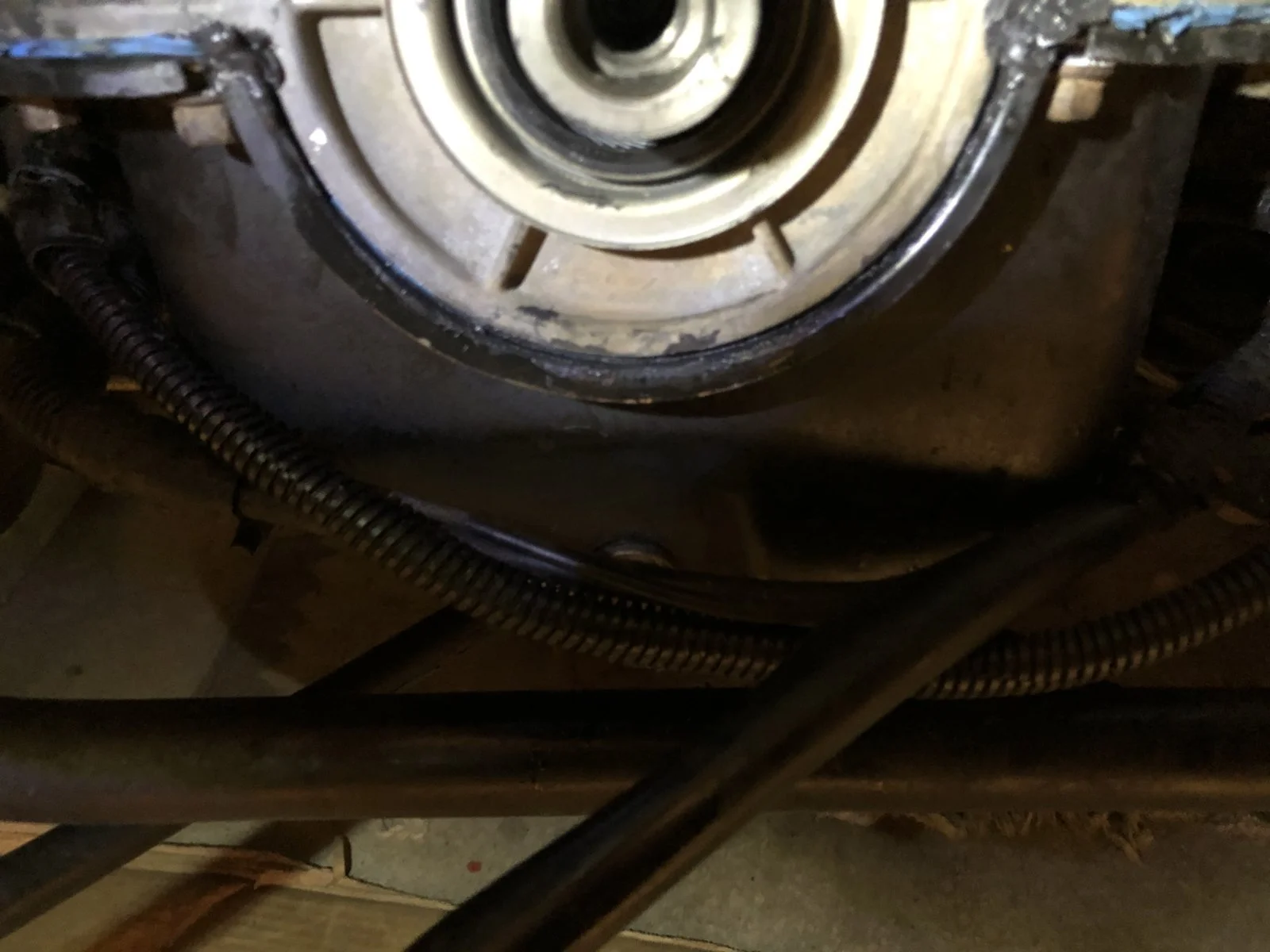

TOOLOW91 said:
Do not remove what’s left of the oil pain gasket . It will never not leak it’s one piece with metal in it . You’re flirting with disaster doing that . If it were me I would keep that half moon piece that broke off above . Use a liberal amount of grey rtv “ the right stuff on the half moon , cover , pan where the gasket it and put it together.
Every HB I have ever done I’ve been able to install with a half inch ratchet and it presses down the crank nice and easy . If you wanted to impact it at the end once it’s seated sure but torque wrench is best
Ok, so reuse the half moon with the liberal rtv, especially where the broken part is. K.
I have this JB weld ultimate black, is that good enough or go get the grey (where?)

I agree. Dont cut the gasket. I was just trying to think of a way to use the one new piece that goes under the timing chain housing. If the piece that came off during removal might still be good to use.
Reactions: JAA
Yea, it cleaned up pretty well. Looks like it fits reasonably.
TOOLOW91
20+ Year Stangneter
8,499
8,752
S.I.NY
Aug 24, 2019
#144
  • Aug 24, 2019
  • #144
Yeah grey or black usually does the trick
Reactions: JAA

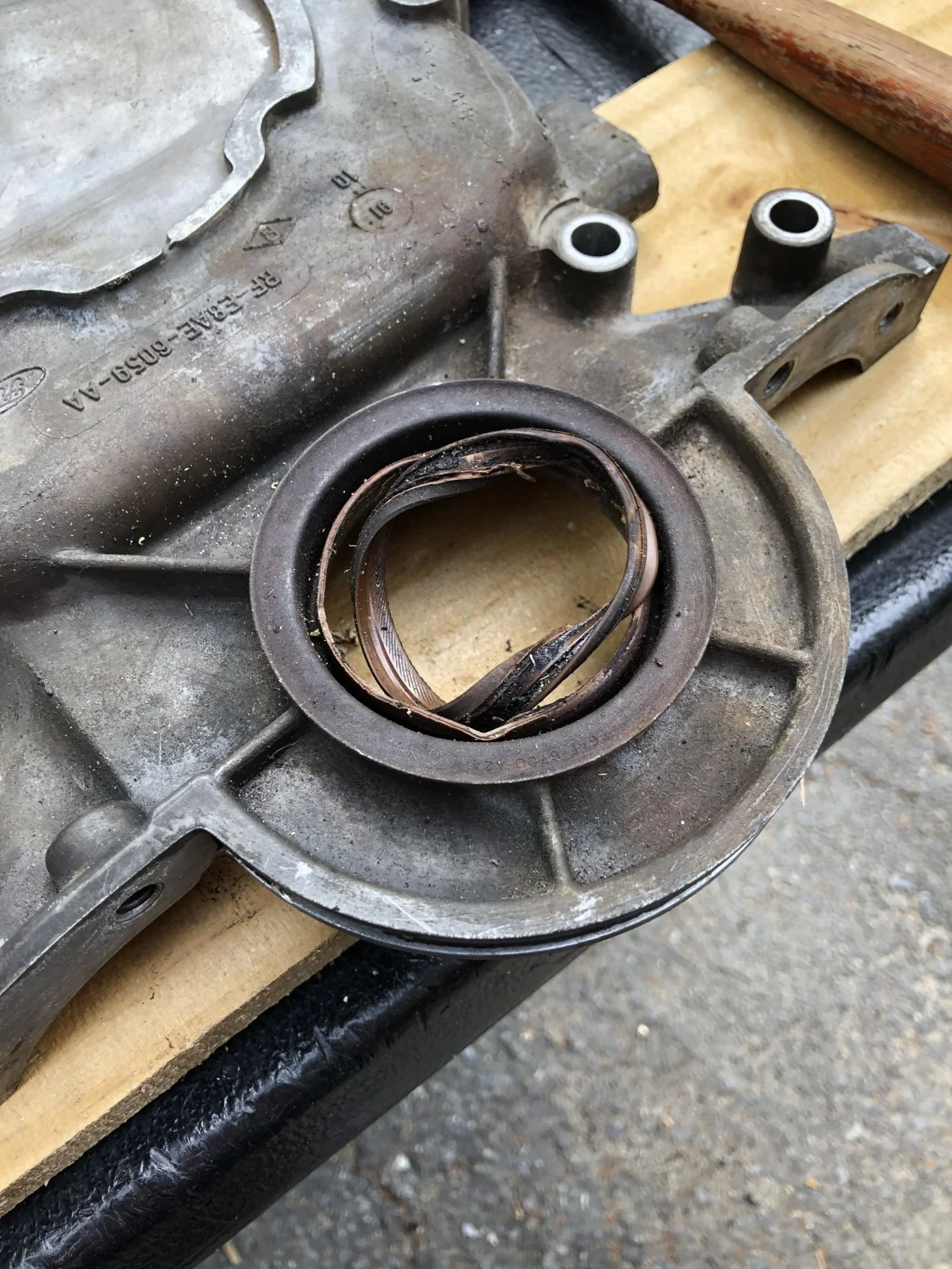

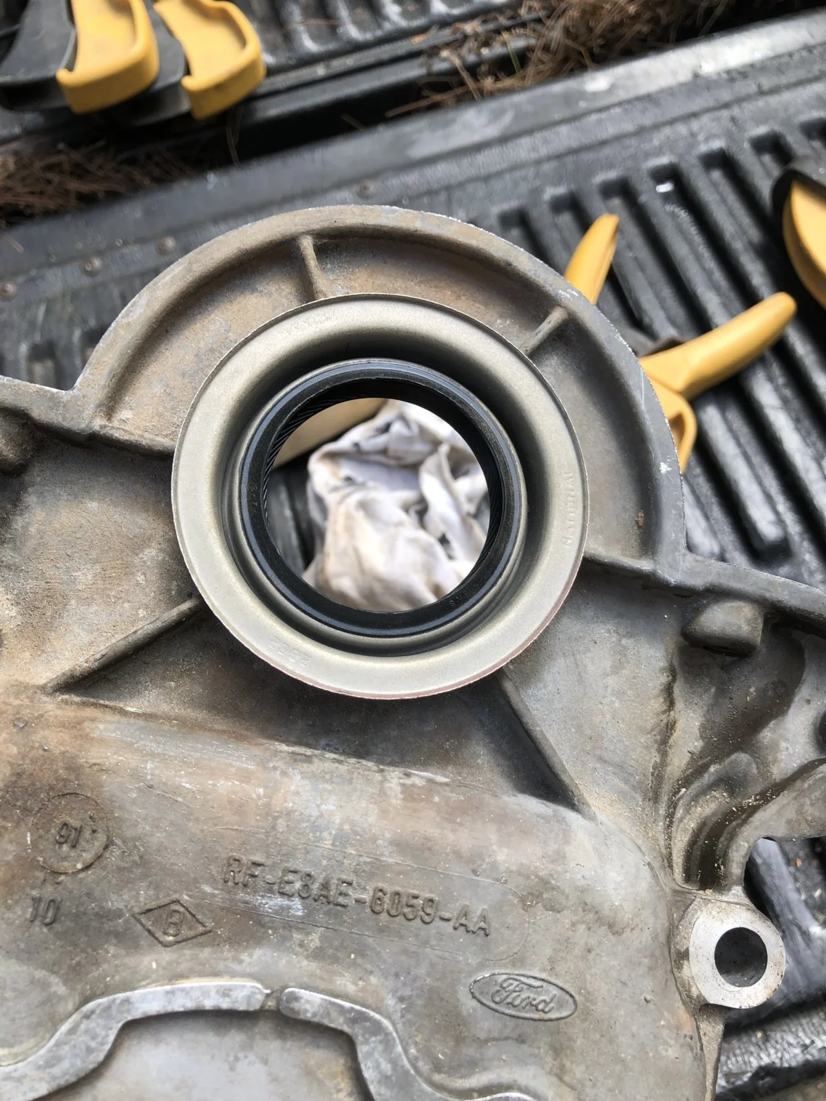

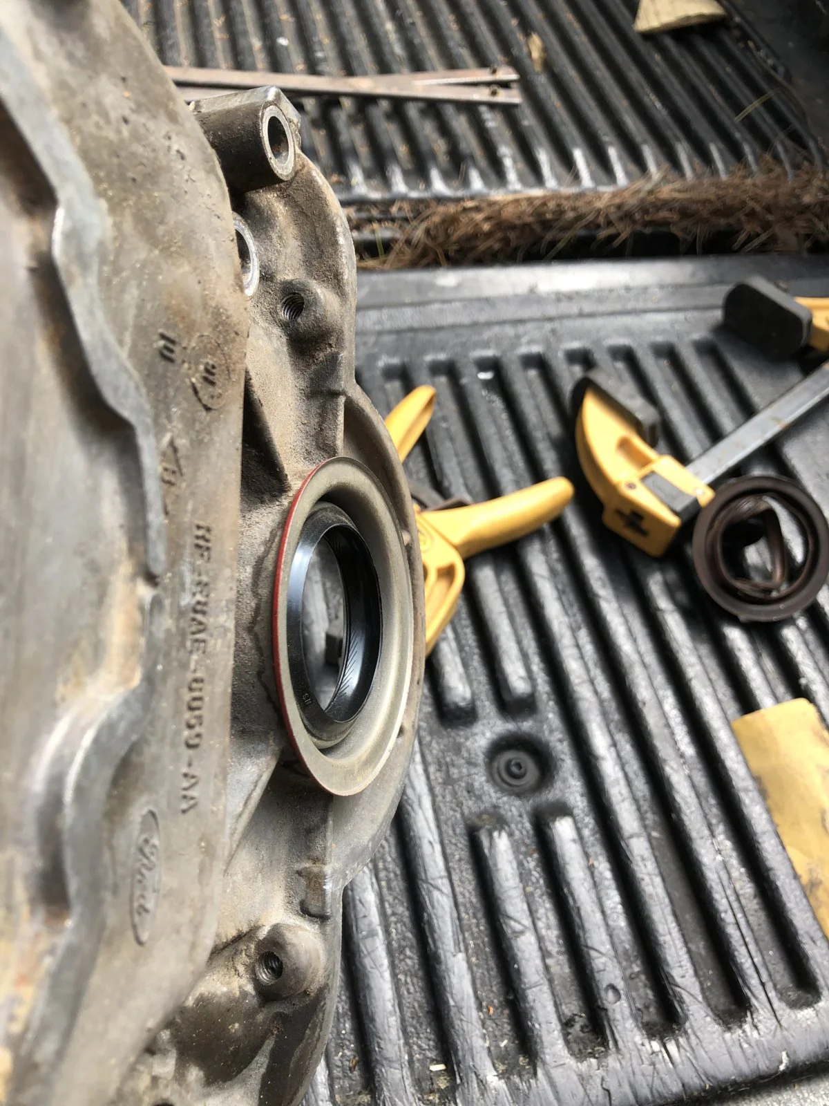

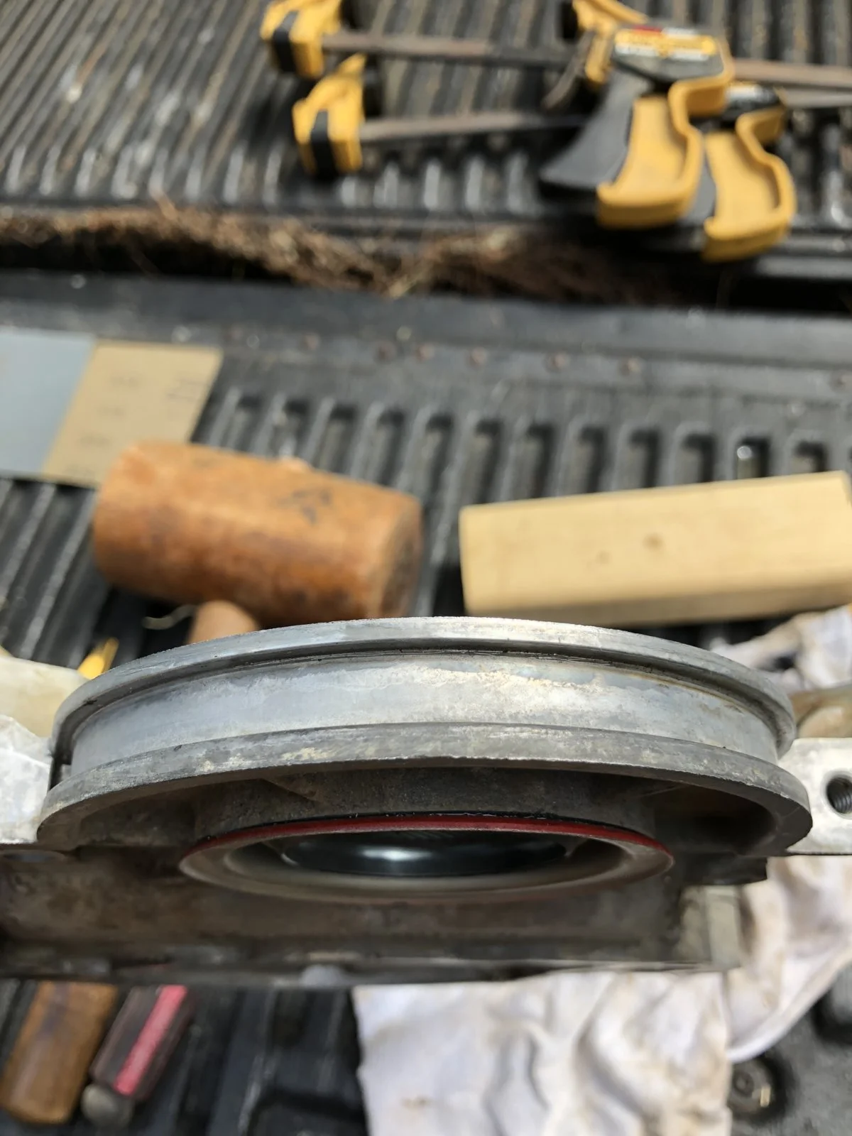

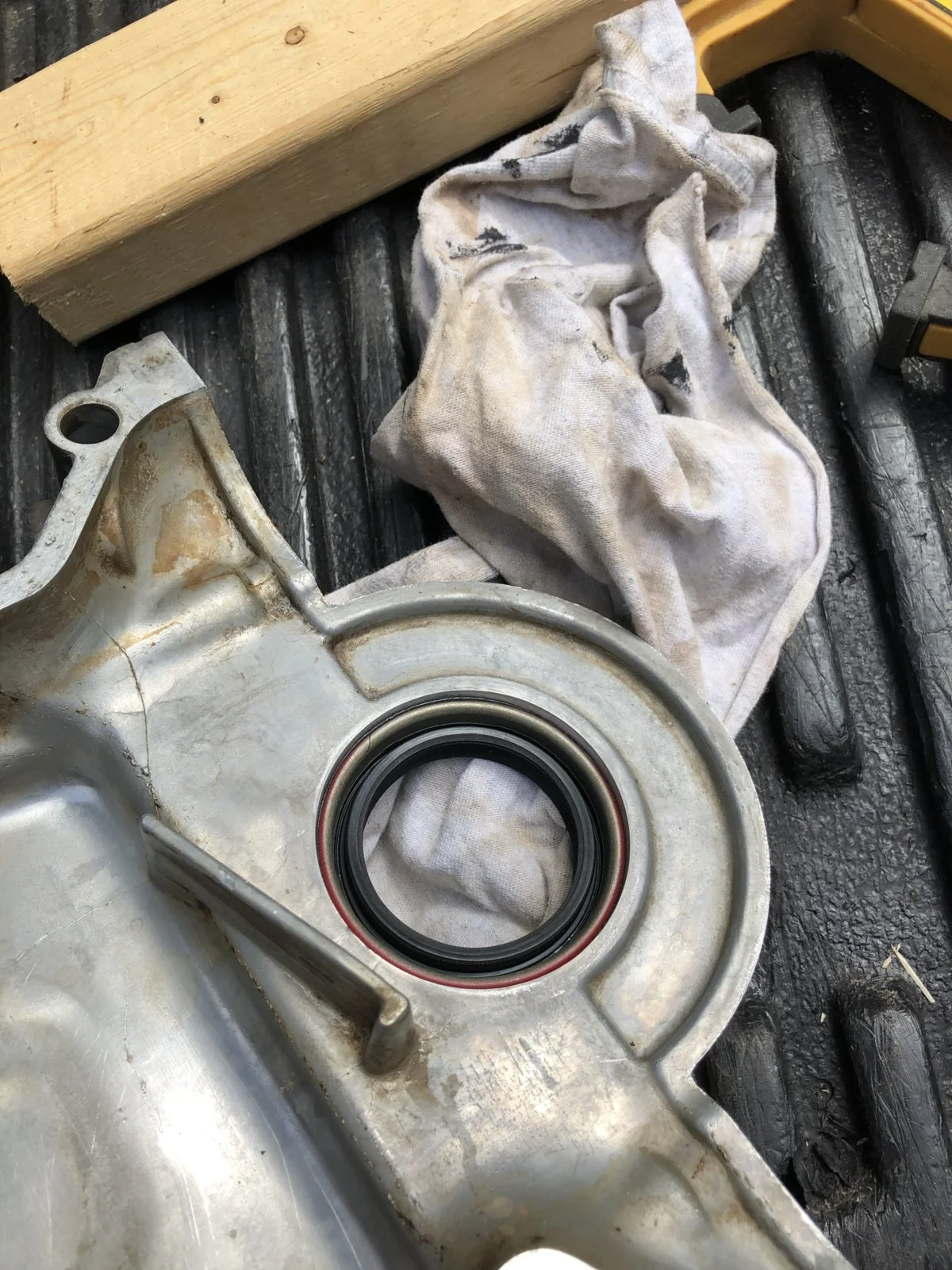

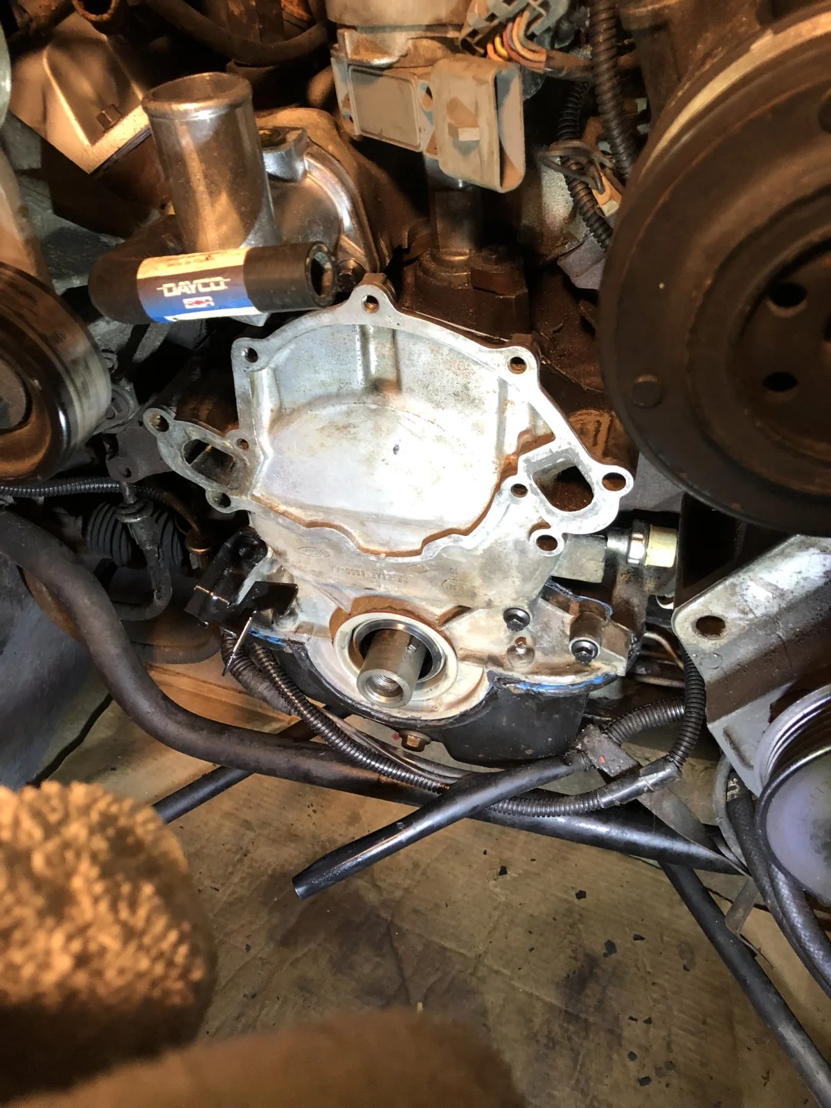

Old seal really doesn’t want to come out. Any advice?
JAA
5 Year Member
Oct 2, 2018
674
110
63
Central MA
Sep 1, 2019
#146
  • Sep 1, 2019
  • #146

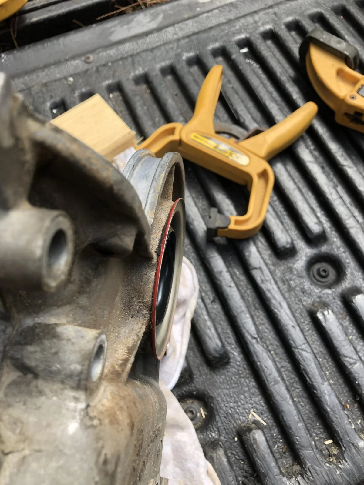

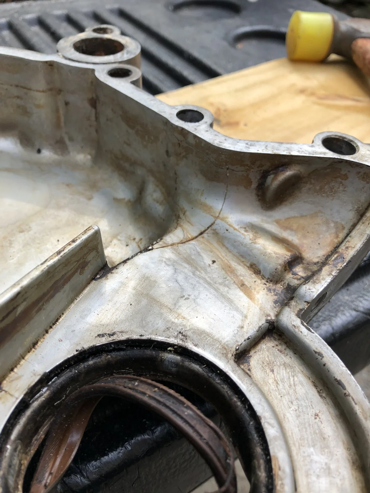

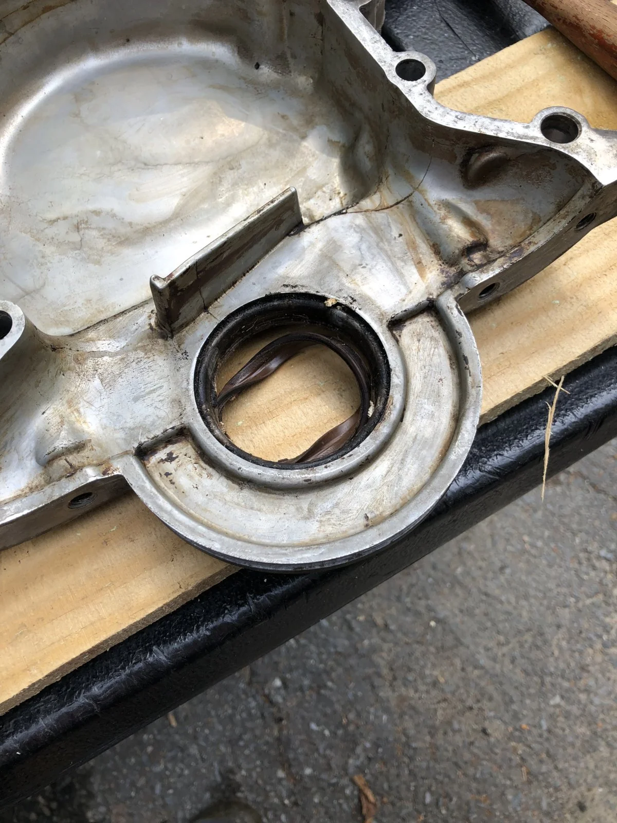

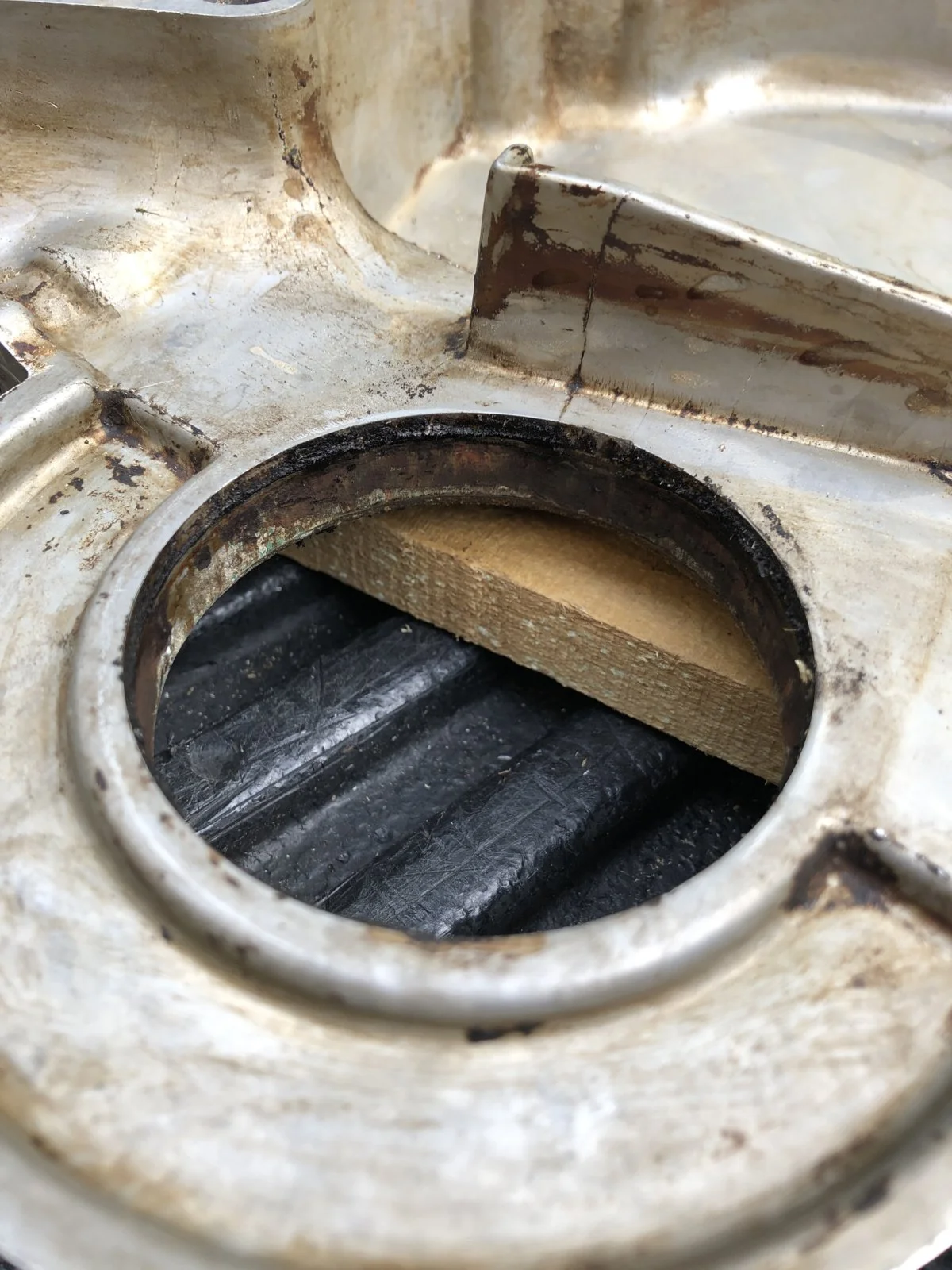

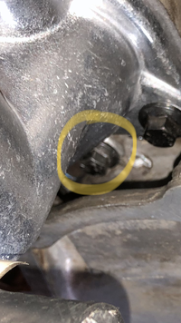

Is that a crack in the cover?
JAA
5 Year Member
Oct 2, 2018
674
110
63
Central MA
Sep 1, 2019
#147
  • Sep 1, 2019
  • #147

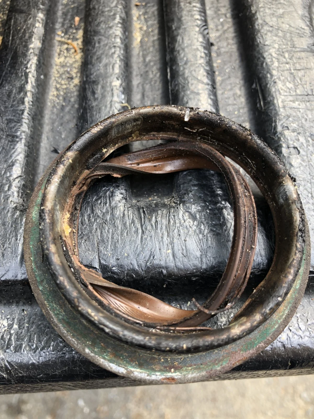

Screwdriver. That was nasty
JAA
5 Year Member
Oct 2, 2018
674
110
63
Central MA
Sep 1, 2019
#148
  • Sep 1, 2019
  • #148
Line seems to be part of casting, not a crack
So far so good
Reactions: Olivethefet and General karthief

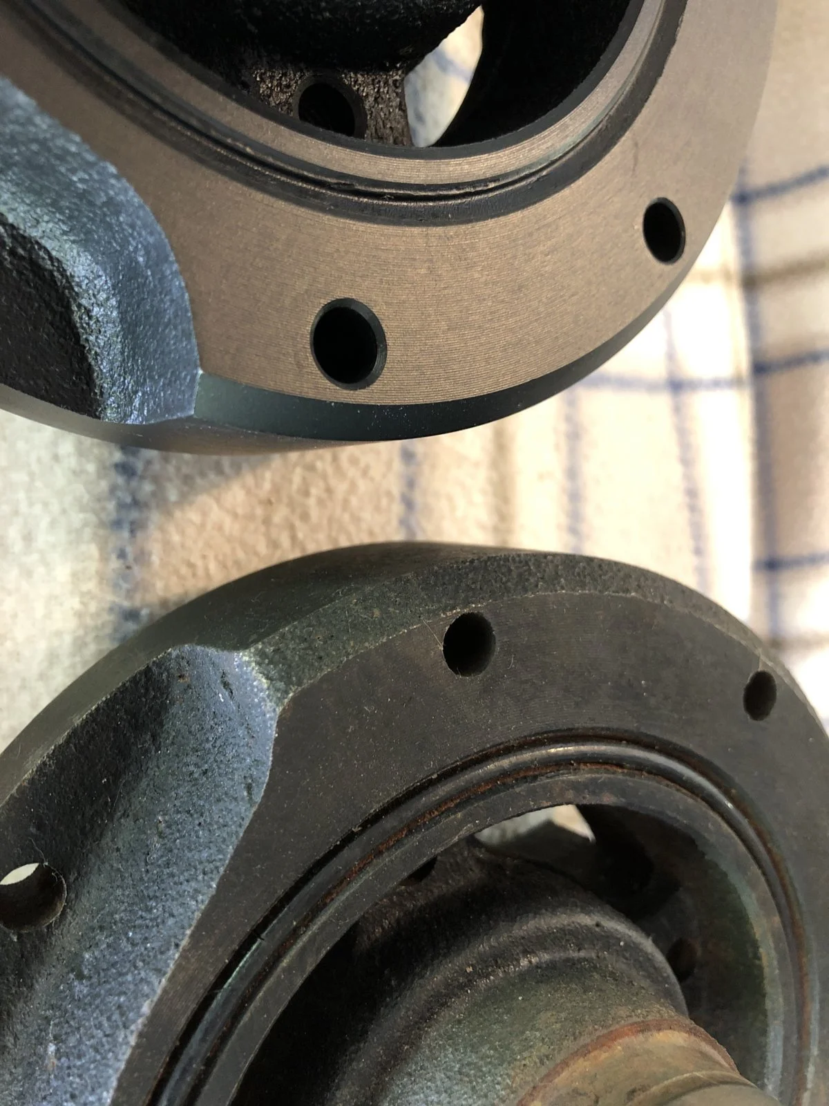

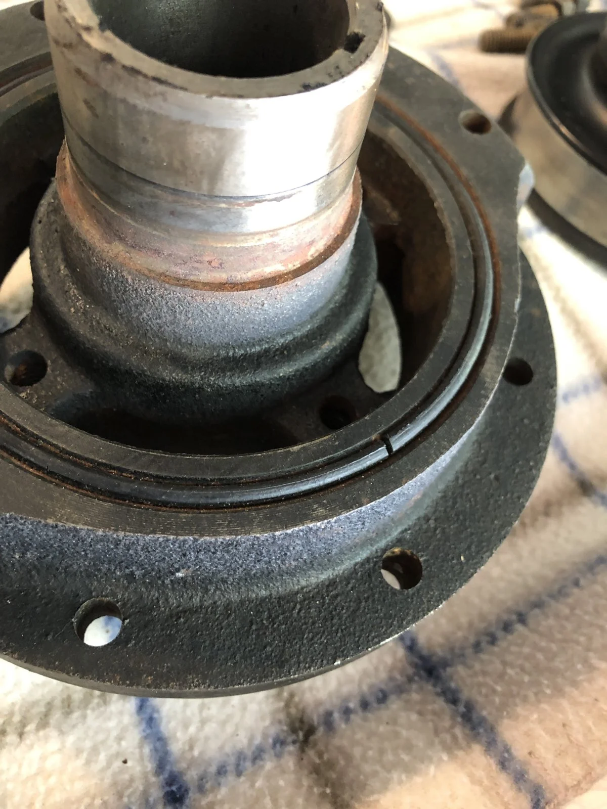

Is there supposed to be a gasket of sorts with the new power bond HB? Looks like the old one has one.

It looks right to me

I think it's fine. That gasket looking thing on the old one is just part of the HB. It doesn't seal anything. The new one is just made a little different.

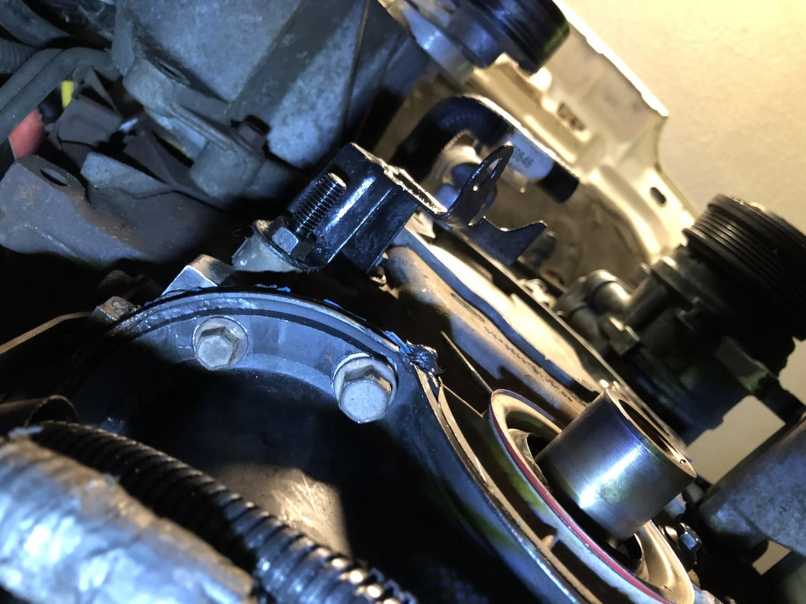

Alright, time to start.
TC, HB, then water pump. Lots of RTV, bolts 15 ft lbs, crank bolt 120lbs.

Next time don’t put thermostat on first
How does she look? #lietomeifneeded

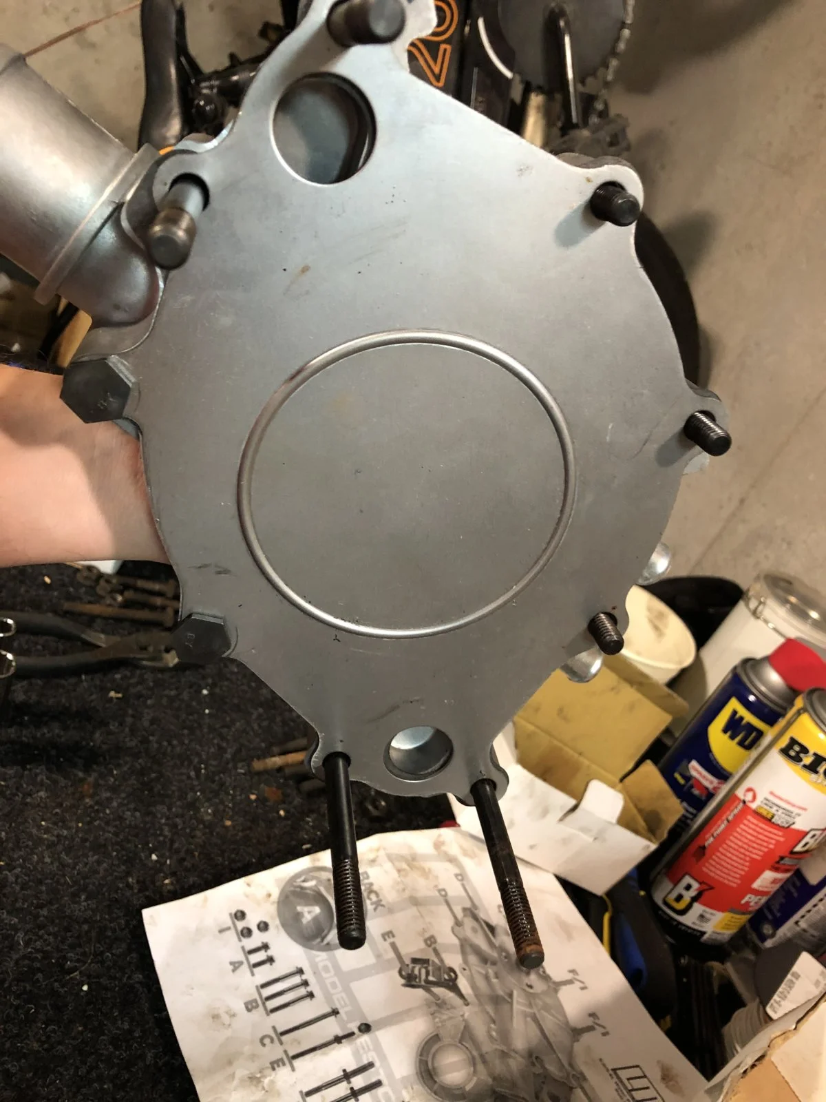

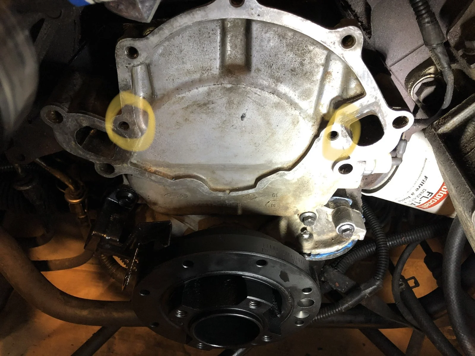

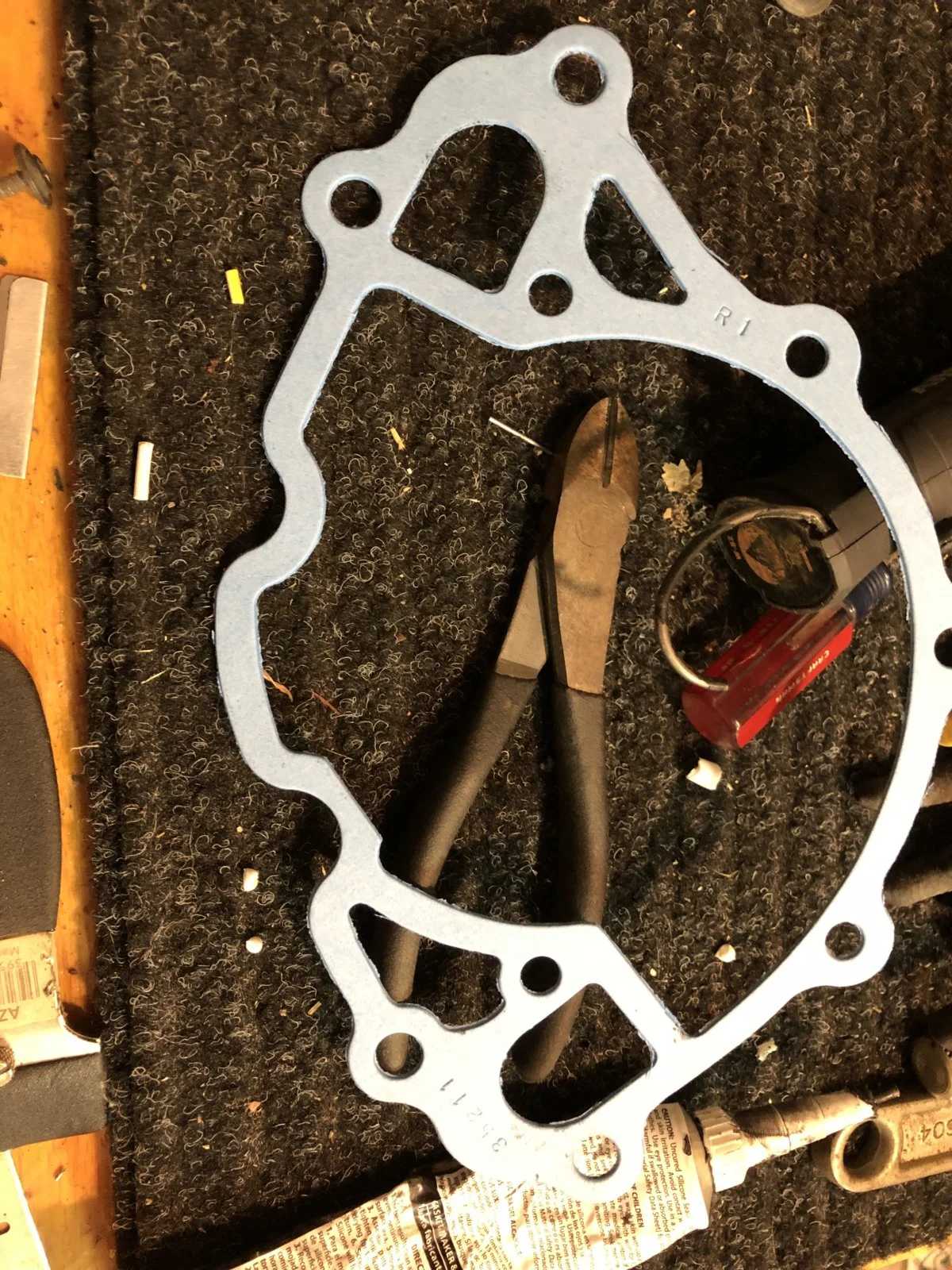

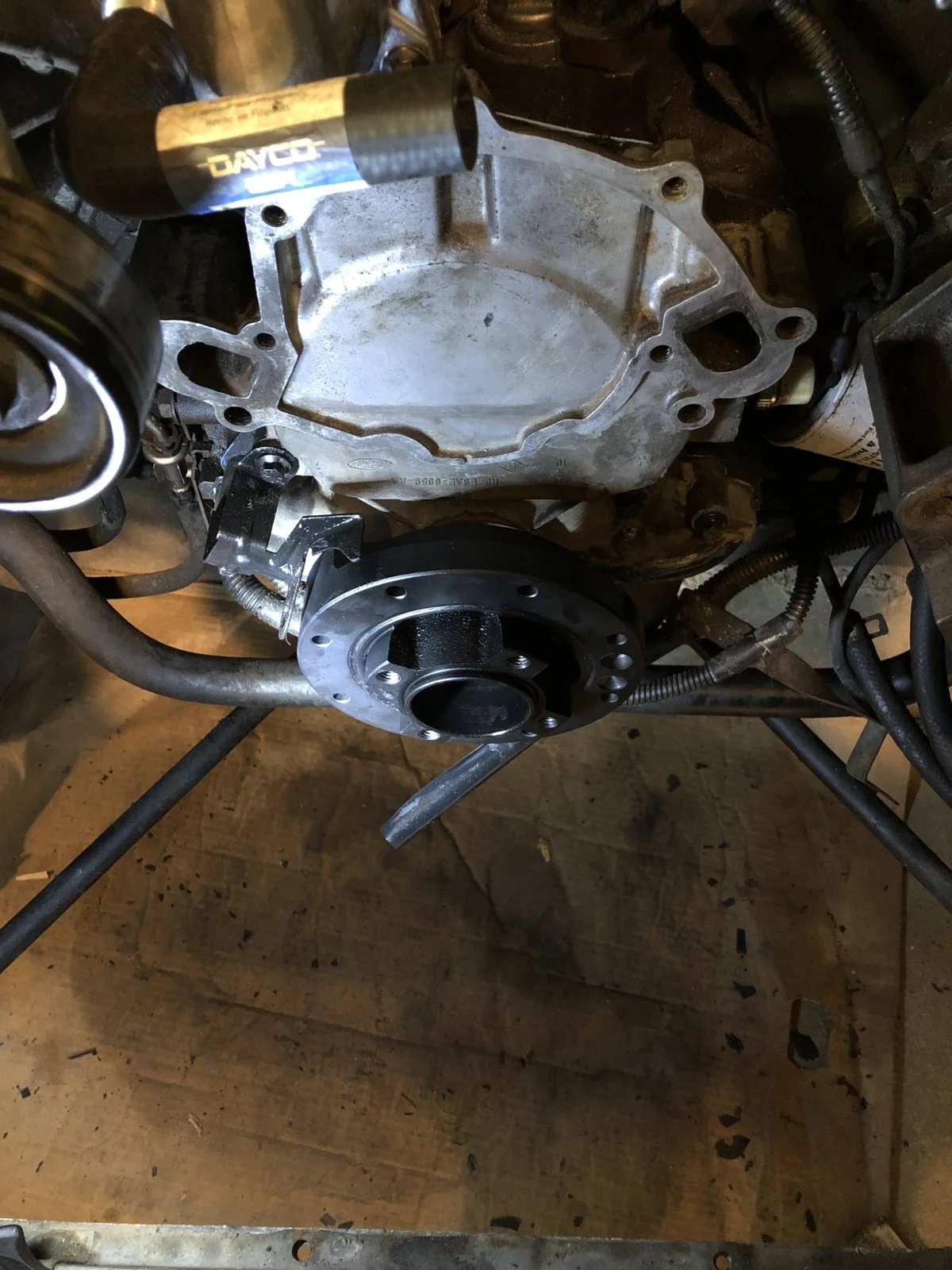

What are these holes for? They have spots on timing cover and water pump gasket, but nothing on water pump itself. I’m confused.

I just looked at mine. I only count 7 bolts attaching it to the TC. I dont think anything goes there.
