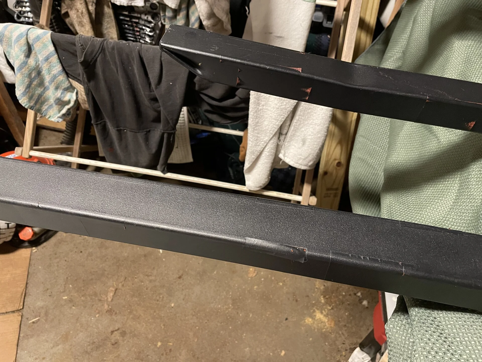

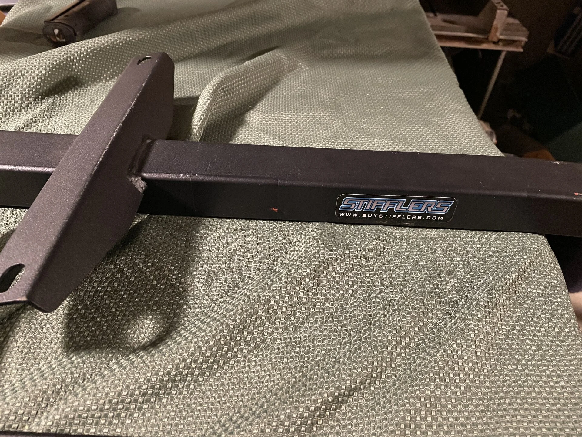

First upgrade will be boring. Dad bought these and brought them up as a gift. I was planning on going maximum motorsports, but who can complain about a dad’s gift?
I located a local performance shop. I’ll try to stop by tomorrow and ask them about the work.

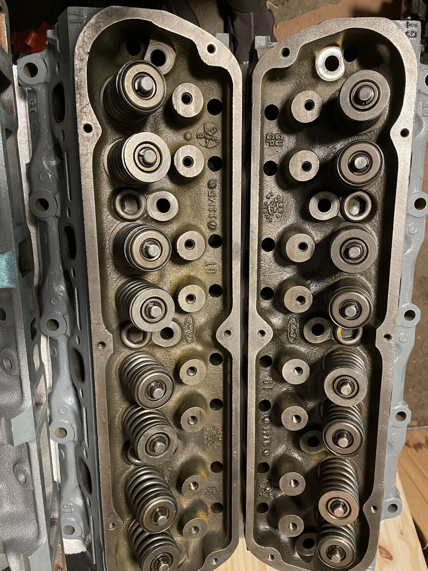

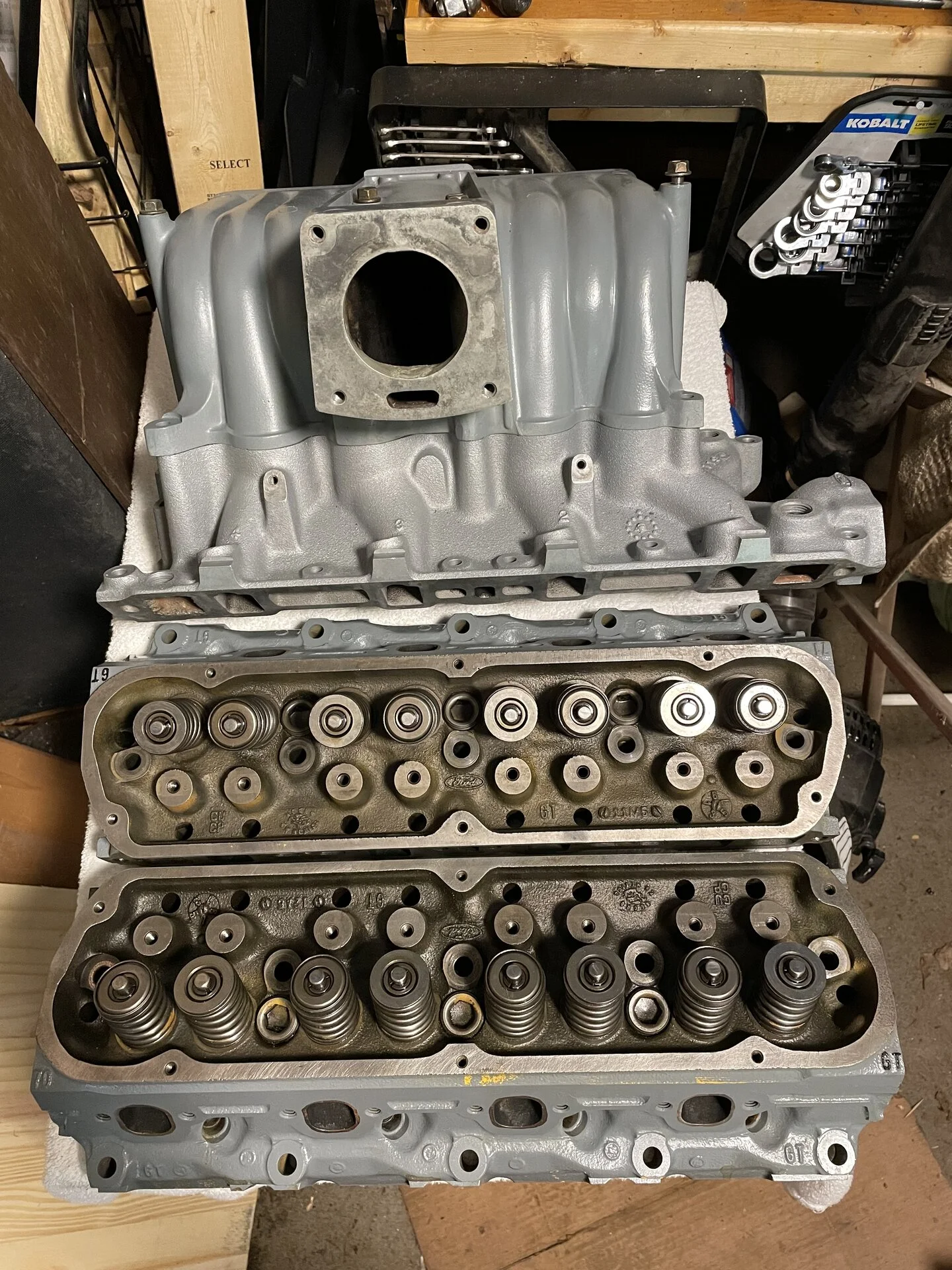

For the next upgrade, it’s trivia time:
Who can tell me the types of vehicles these are from?

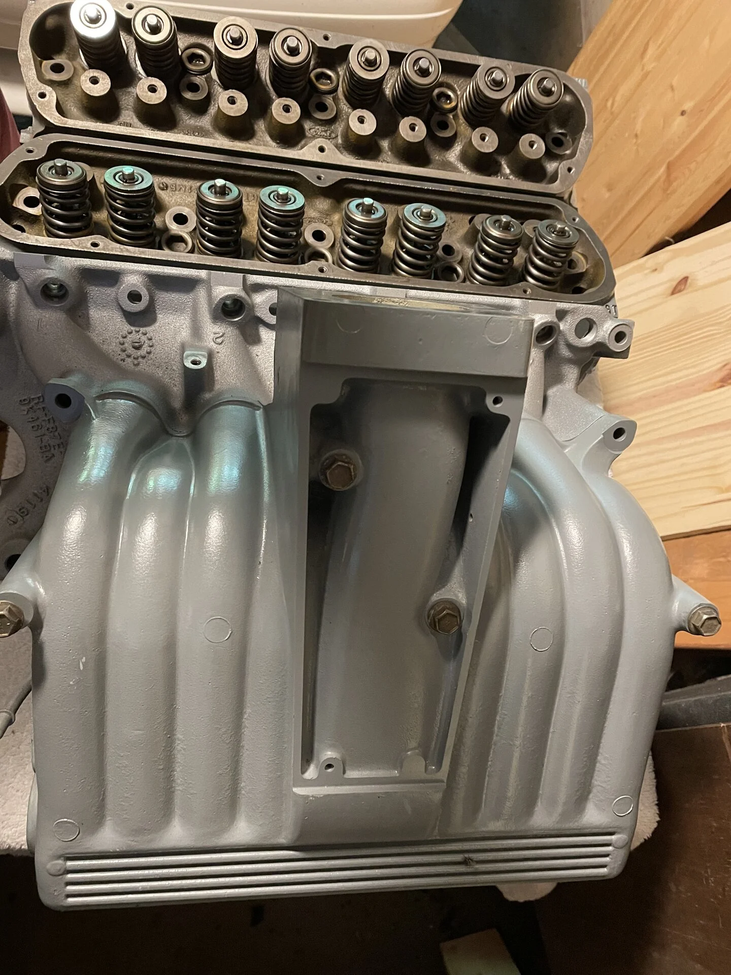

Early EGR style explorer intake. Circa 1996/1997.
the heads are standard GT40 heads. Flip them over and there might be a part number cast to the underside near the pushrod guides. F1ZE would indicate early 1996 explorer GT40 heads.
that casting number on the heads indicates 1995 manufacturing dates. One in Jan and the other Dec.

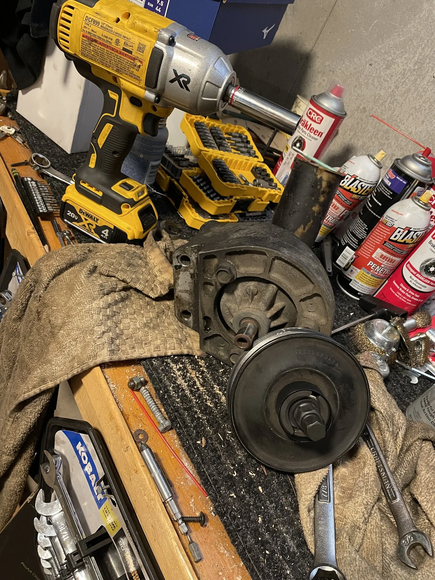

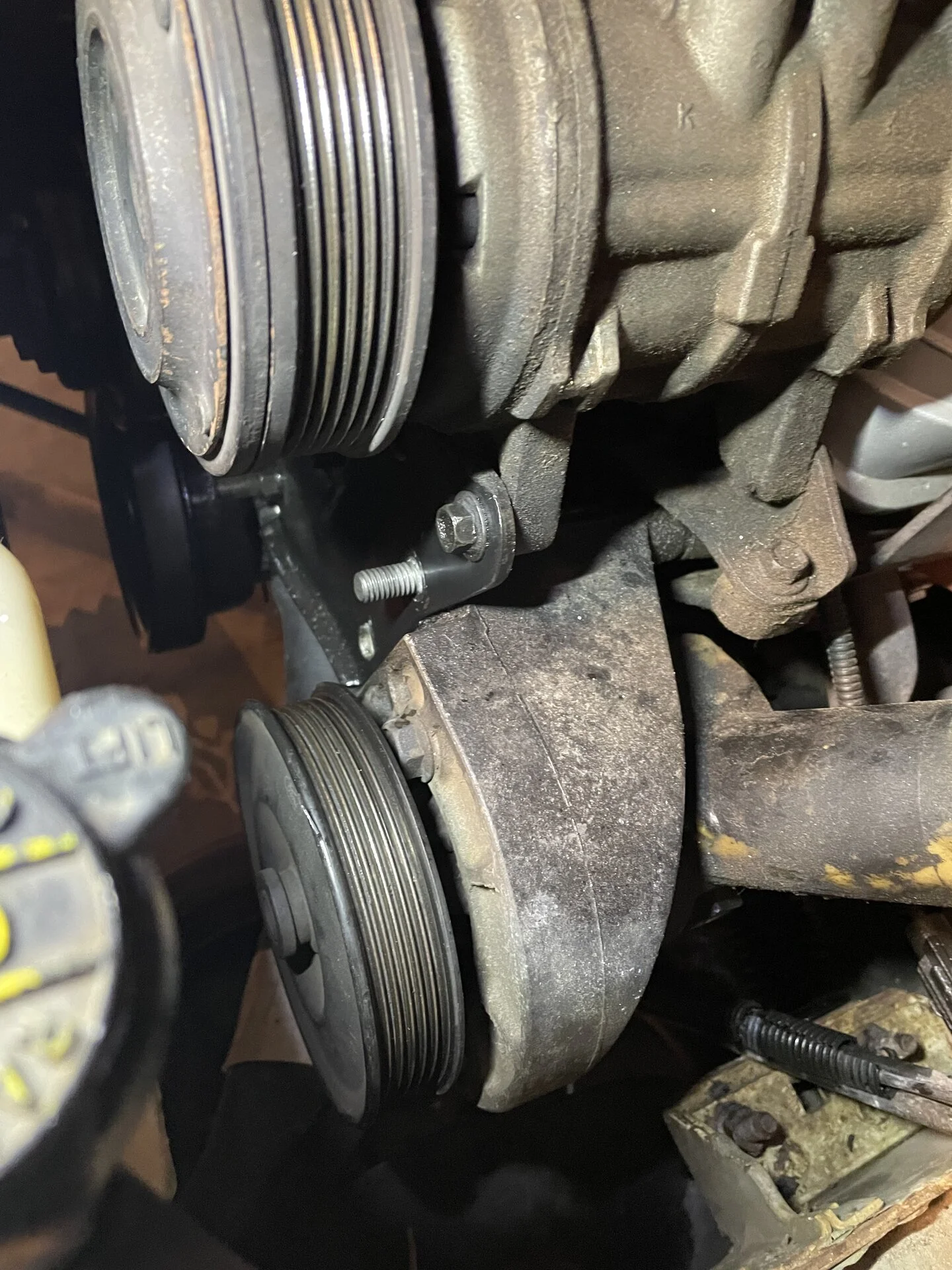

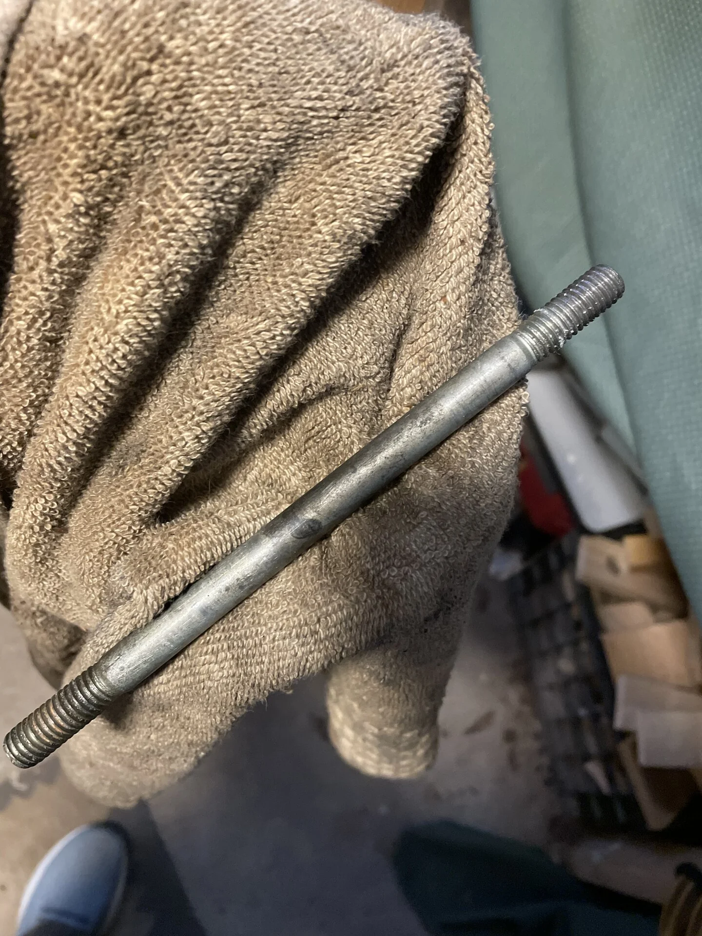

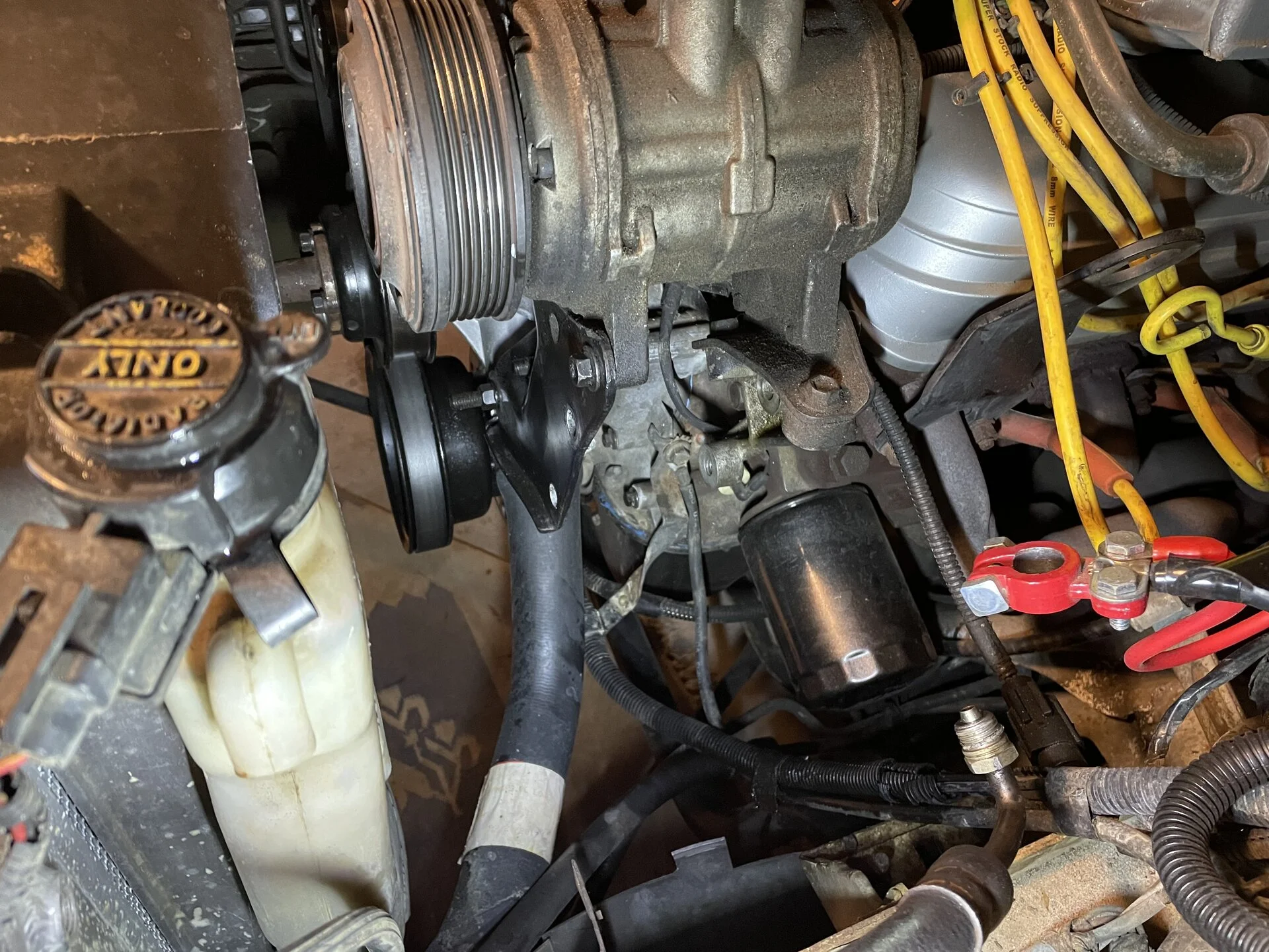

Long time no talk. It was a boring winter. I had hoped to get to the heads and TB this winter. That didn’t happen. It’s been. Cold spring here in Mass, though I decided to replace the Power steering pump.
Removal was reasonable except for the lines. The lines going into the cooler were ridiculous. I ended up leaving on the rack line and cutting the return line from the pump.

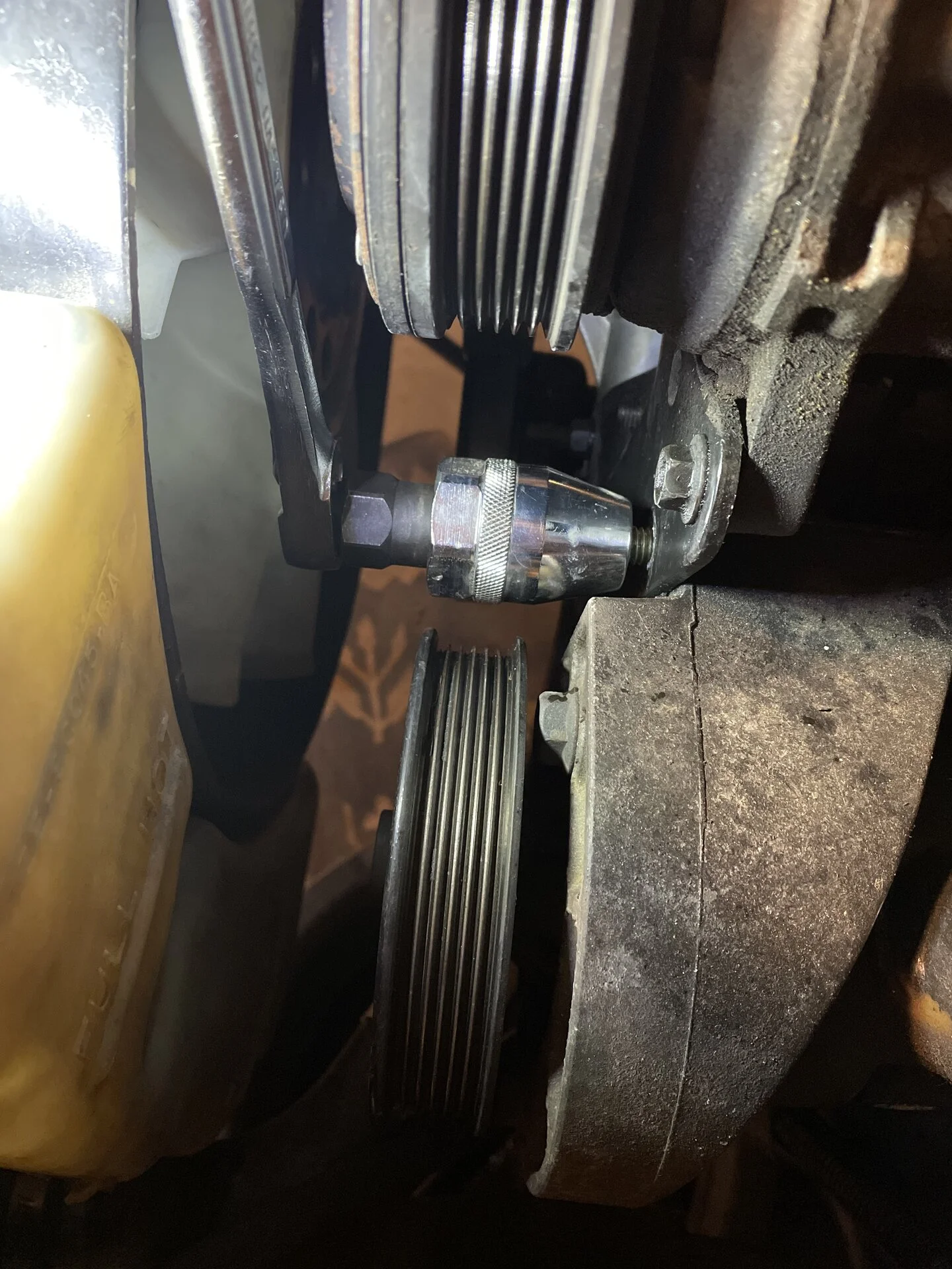

Also, removing the stud which hold the power steering pump was something I hadn’t done before. I tried the 2 nut, but apparently I need more practice. I ended up using one of my favorite bolt grippers (that I used for my broken water pump bolts).
Regardless, the pump is out. I ordered the replacement today (as well as the pump hoses).
I also added all for window motors as I’m tired of them not working. I know the quarters are a bitch, but that’s what is like.
Any advice for getting the power steering pump stud in properly torqued?

You don’t need to torque the stud. Get it in there at least 6 threads or so and then torque up the nut on the stud.
I agree, you don't want to bottom out the stud, makes it difficult to remove later.
