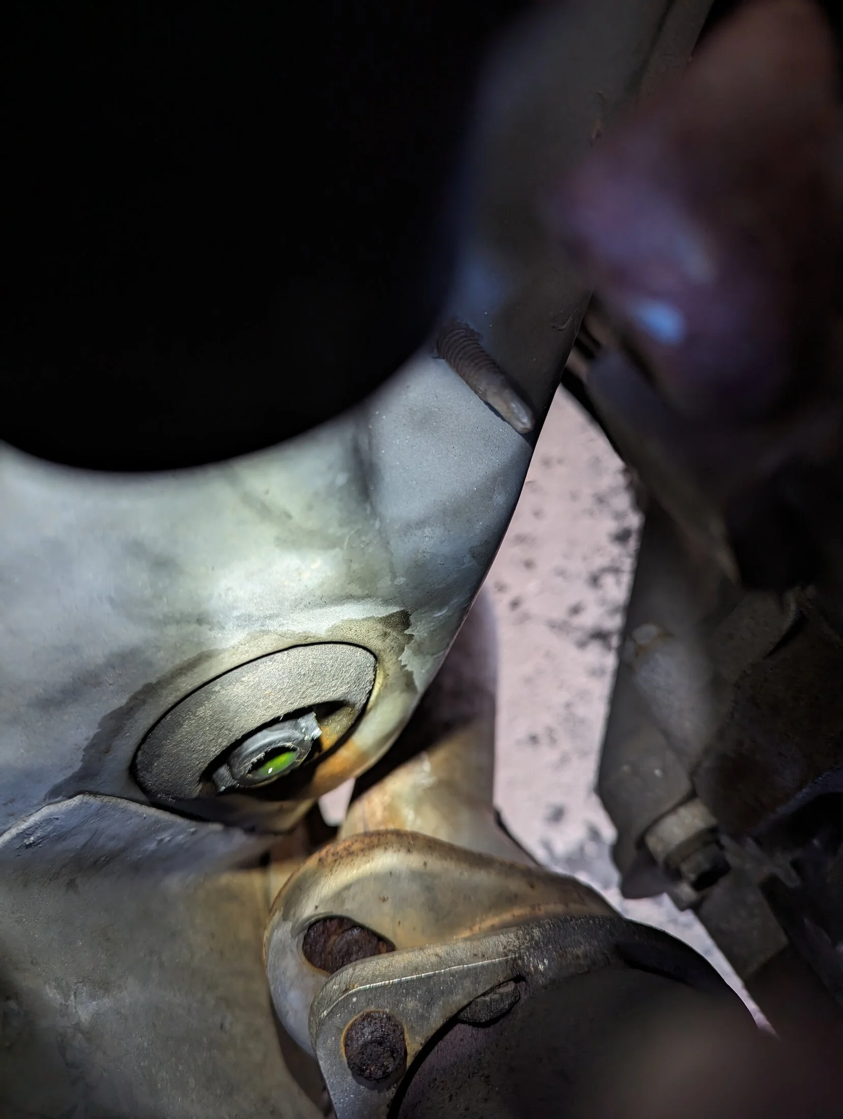

Is this drain hole on the firewall passenger side a drain for the heater box? You can see some coolant water in the hole and there's a trail under the car.

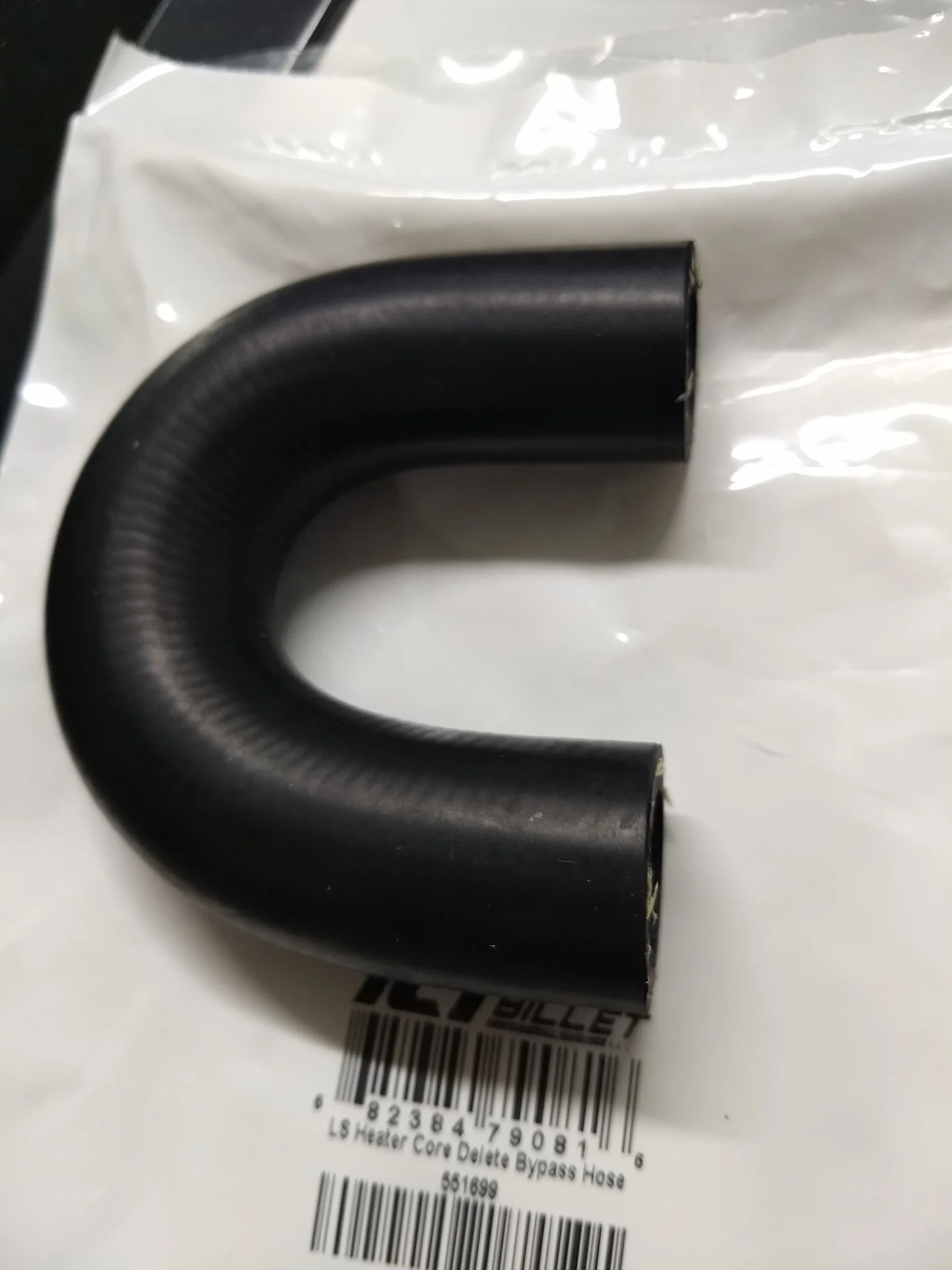

Thanks for that confirmation. It hasn't leaked on the floor at least. I think I'm going to by-pass it for now while I try to decide if I want to do gauges in the radio slot and a cupholder console, be a good time to do it all at once. I'm in Floriduh and it's not hardly necessary and not my daily anyway so no need to rush.

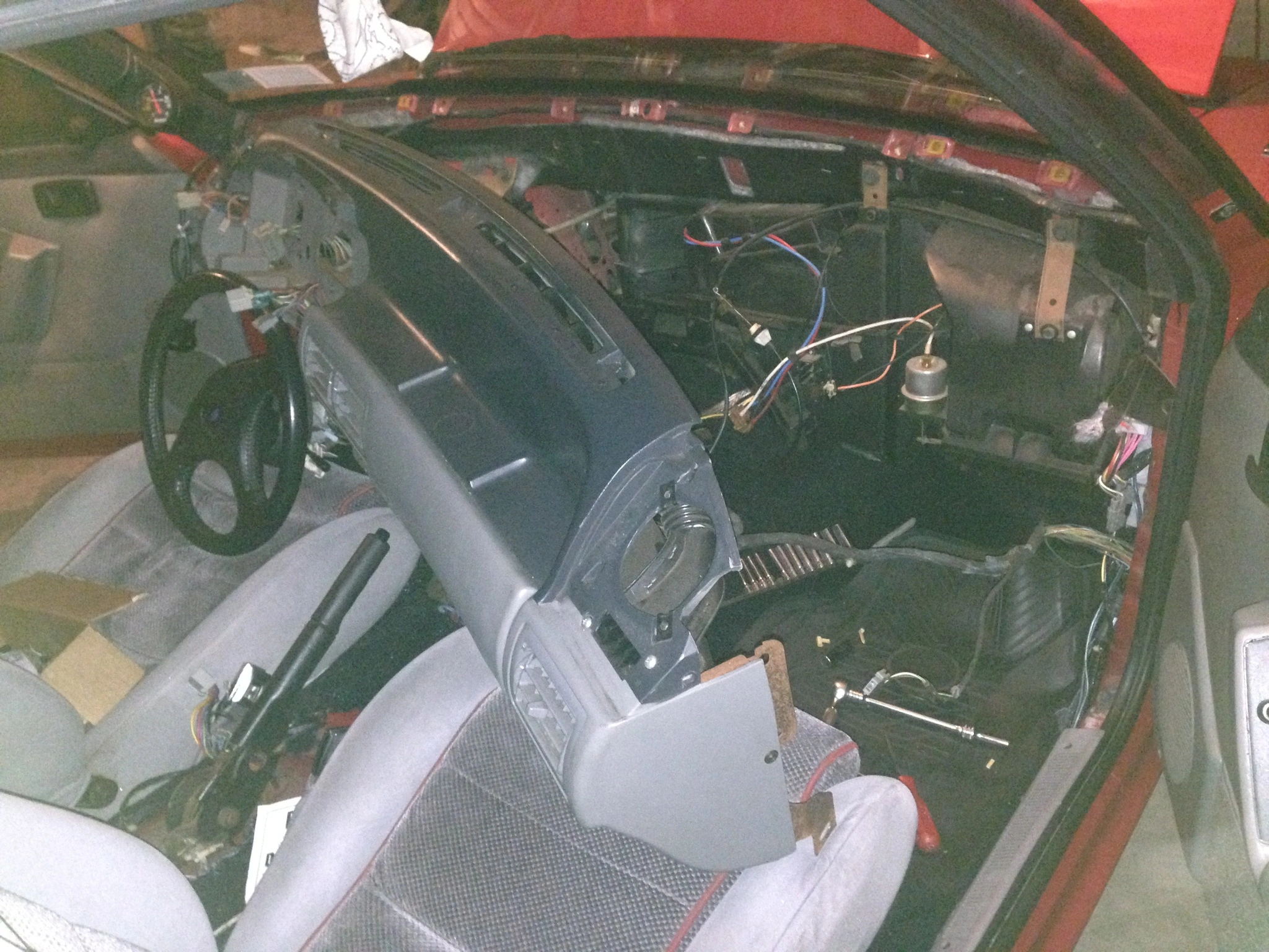

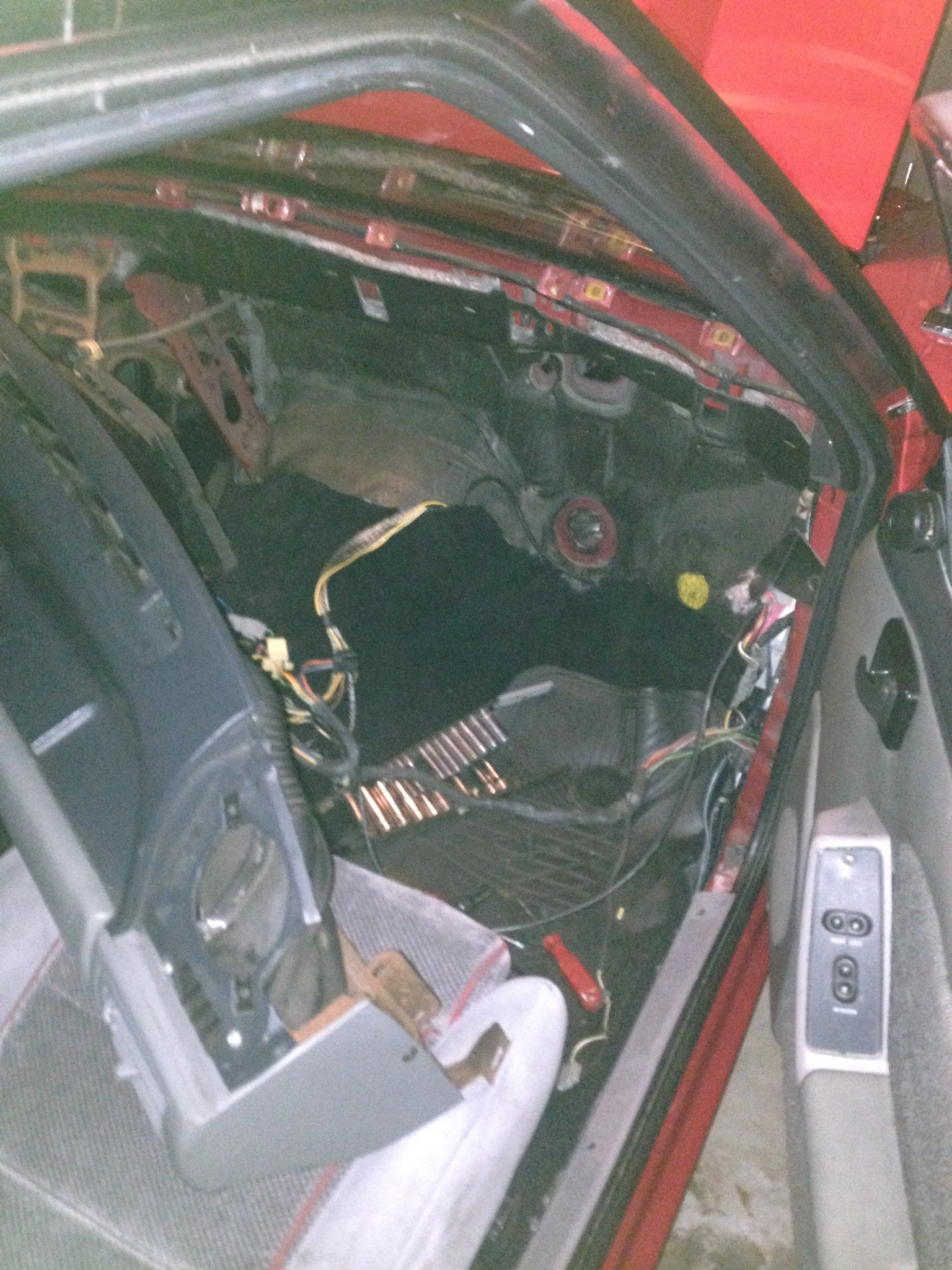

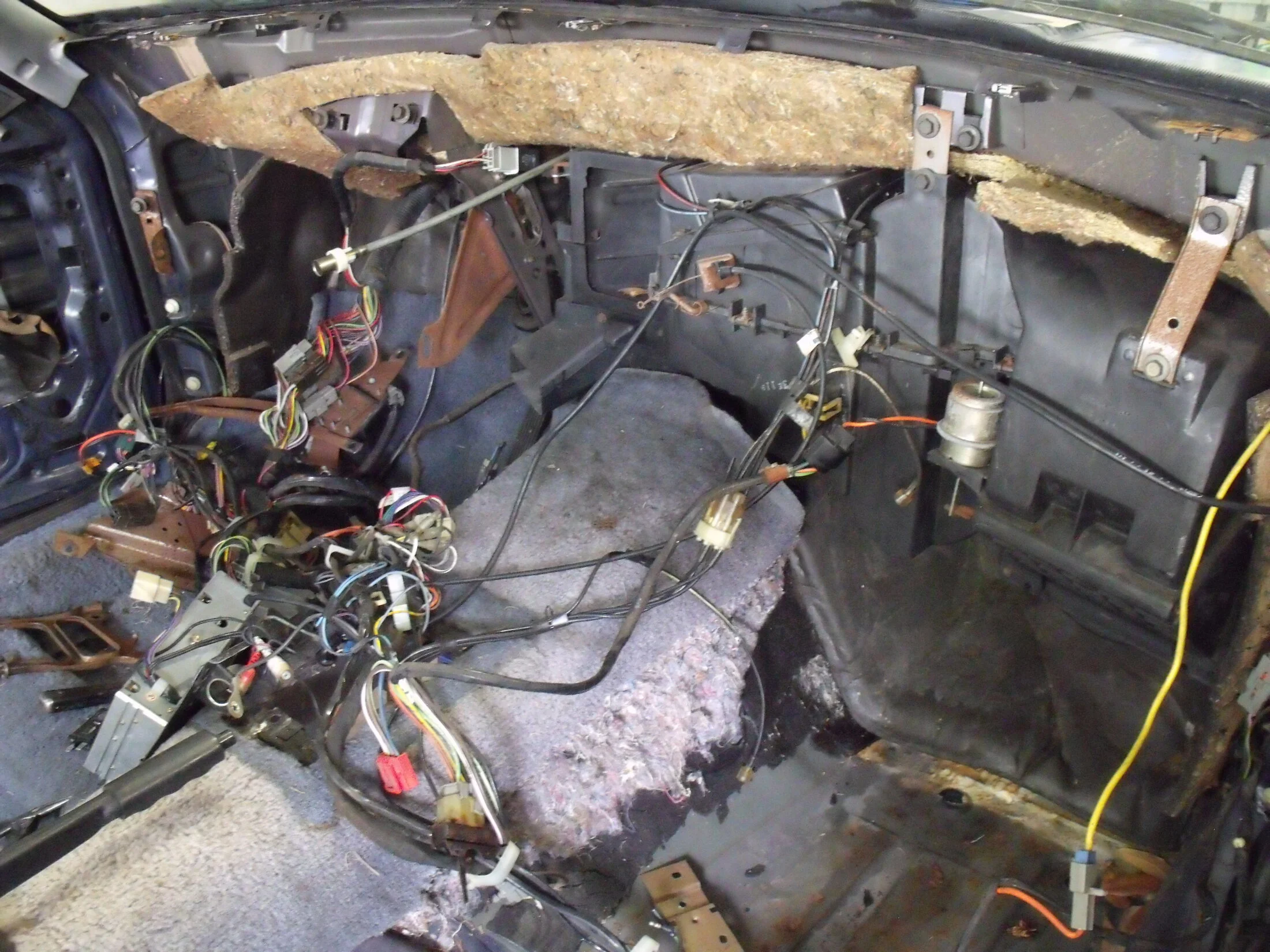

You don’t even need to pull the full dash.
Pull the console
Pull the column down . Unbolt one dash and then the dashboard pulls off the fire wall by the pass side . Doesn’t need to come out . I had the heater box out to do the evap , even that don’t have to come all the way out .
Pull the console
That's pretty much how I did mine...
