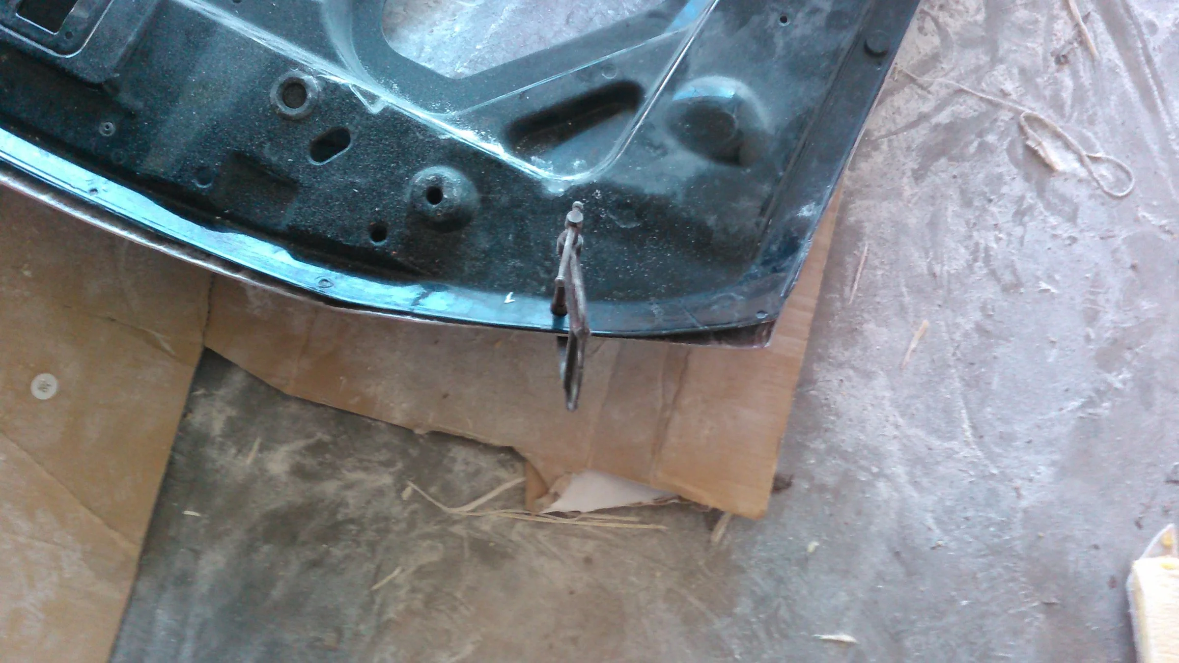

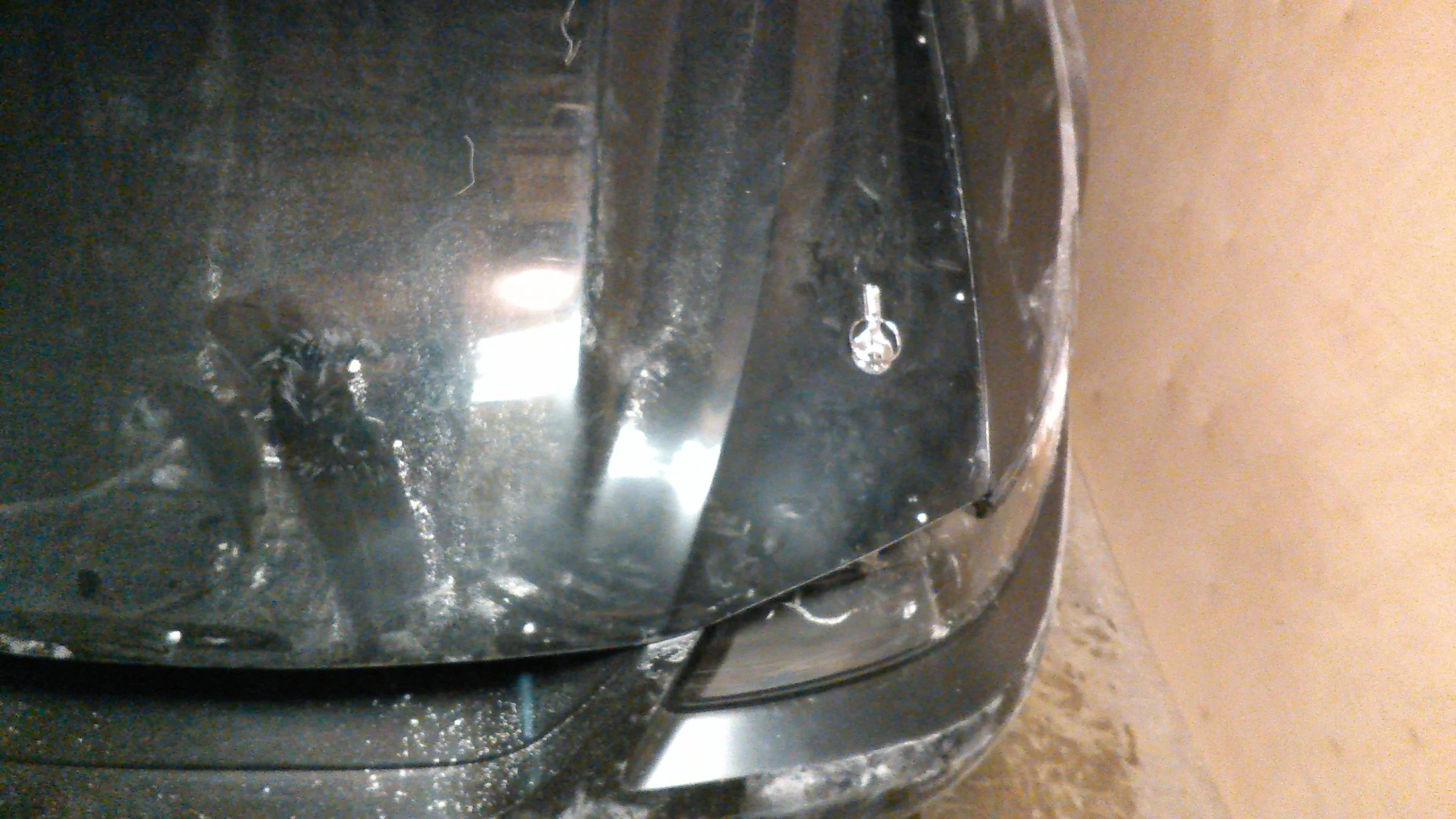

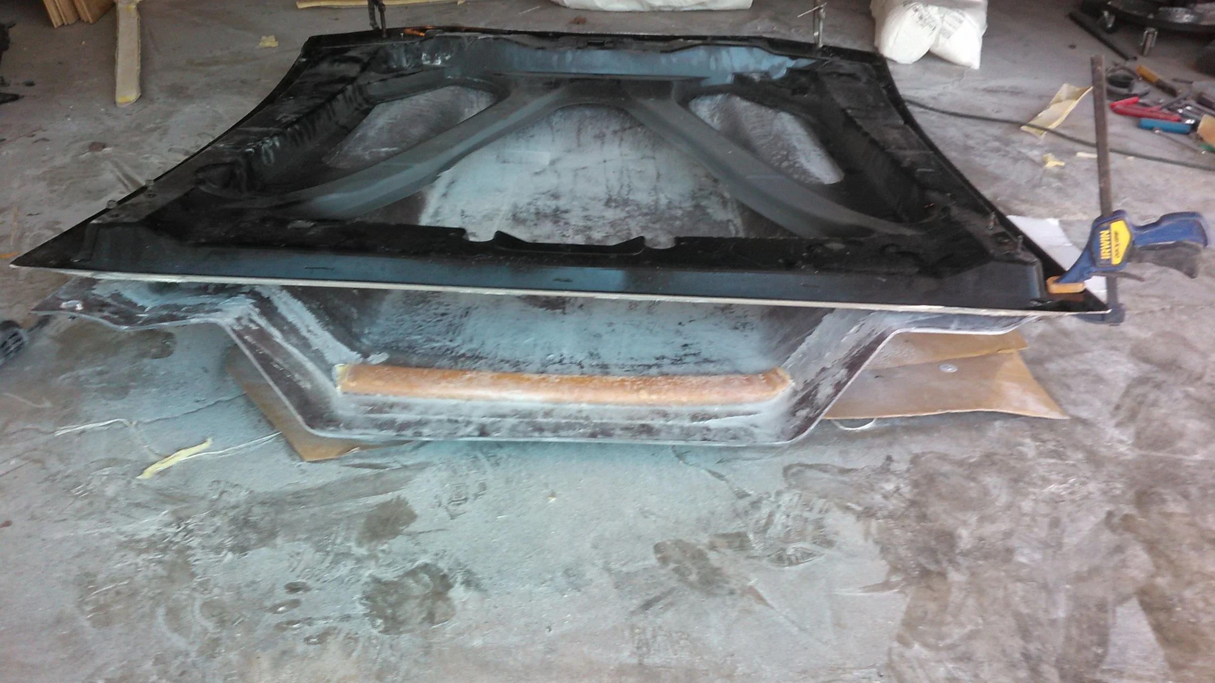

heres what i got i took my factory 03 gt hood and peeled the shell off of it. i currently have a 94-98 cowl hood on almost identical. so i cut the stiffeners out of it and im thinking i can glue this to my factory hood support that will give me the right curve ill have to nip a little off where fenders and lights line up with hood and fill in a little in the back. anybody got any ideas as to what i should try and glue it on with

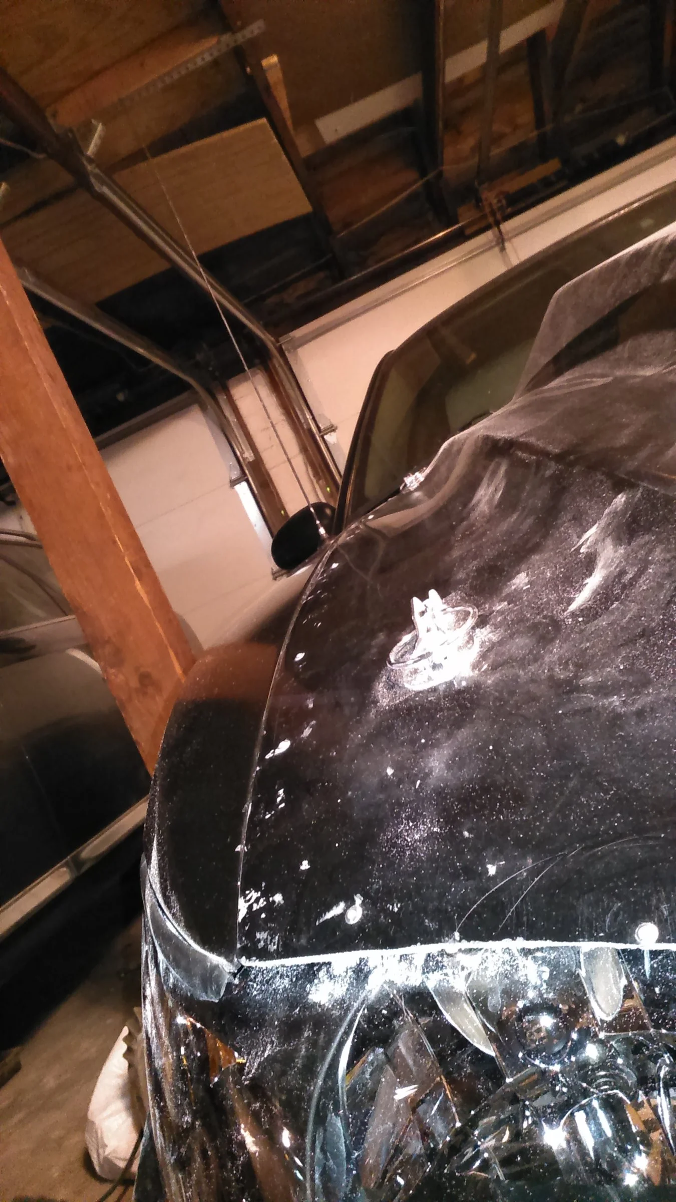

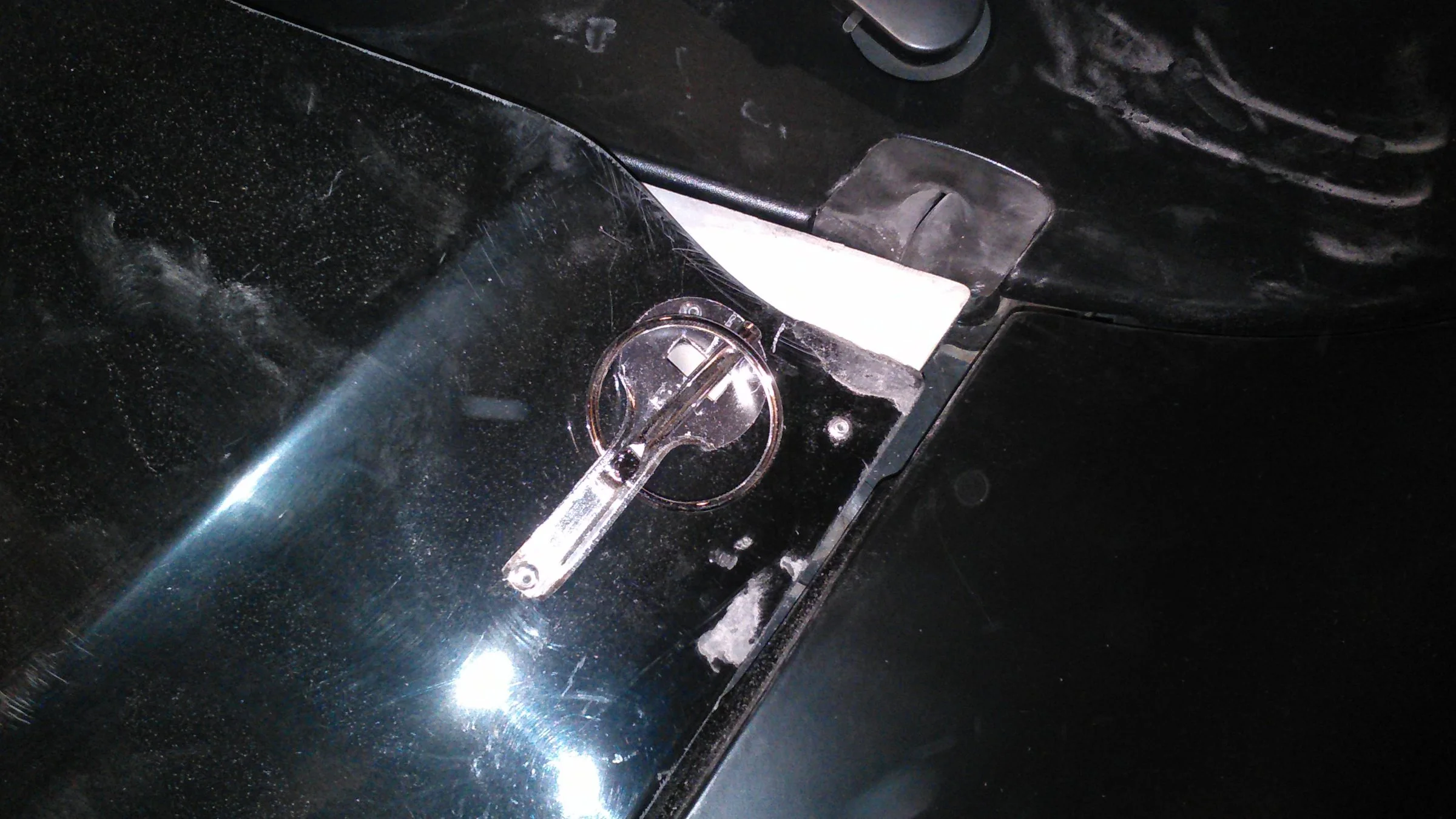

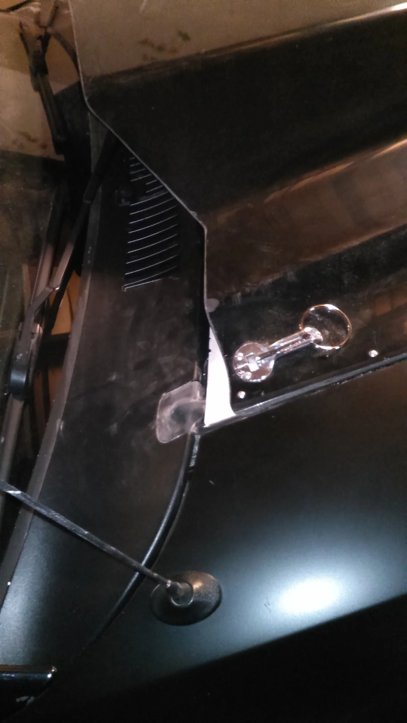

well me and the e lady worked vigorously tonight on the hood i got fiberglass panel adhesive and we winged it..... the end result was actually pretty decent... i still got to drill out rivets but figured rivets were best option until adhesive fully cures... body lines are spot on tho.
