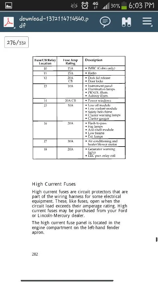

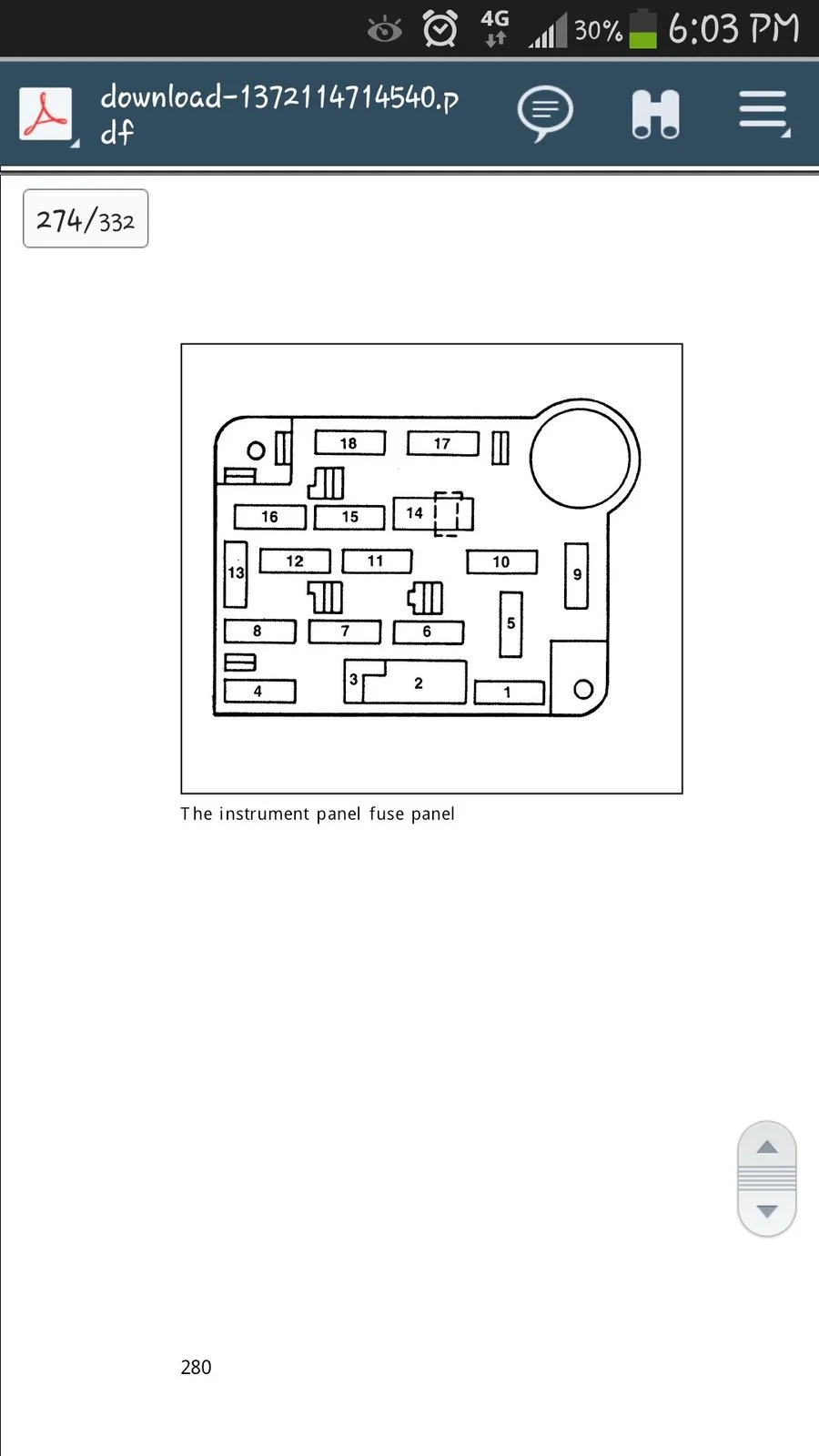

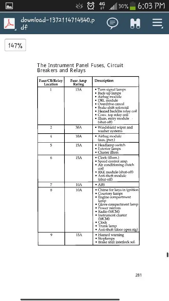

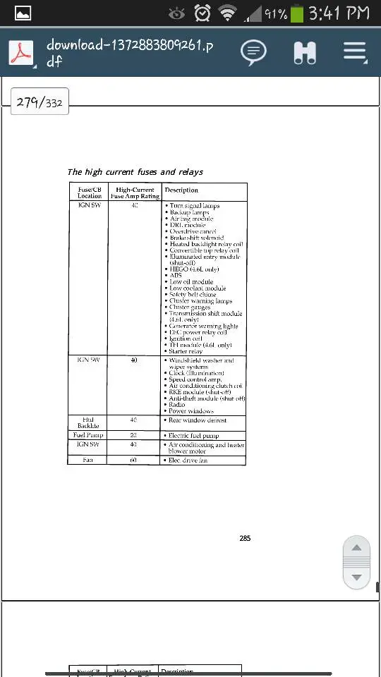

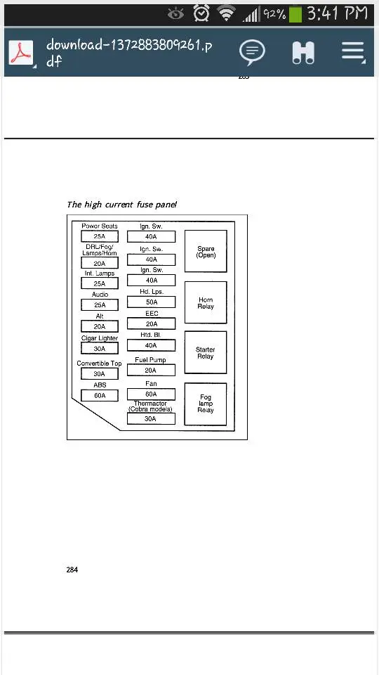

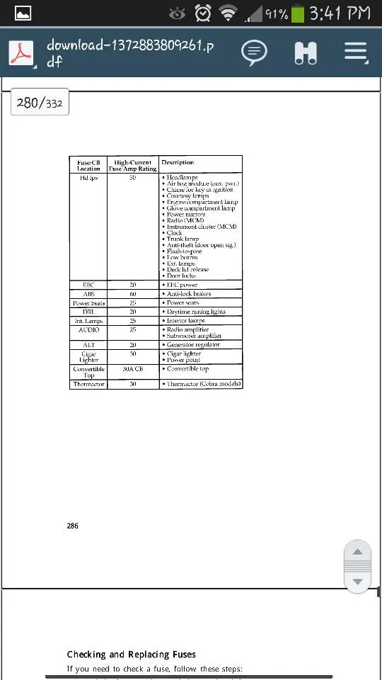

More than likely your fuse...
Sent from my SPH-L720 using Tapatalk 2
