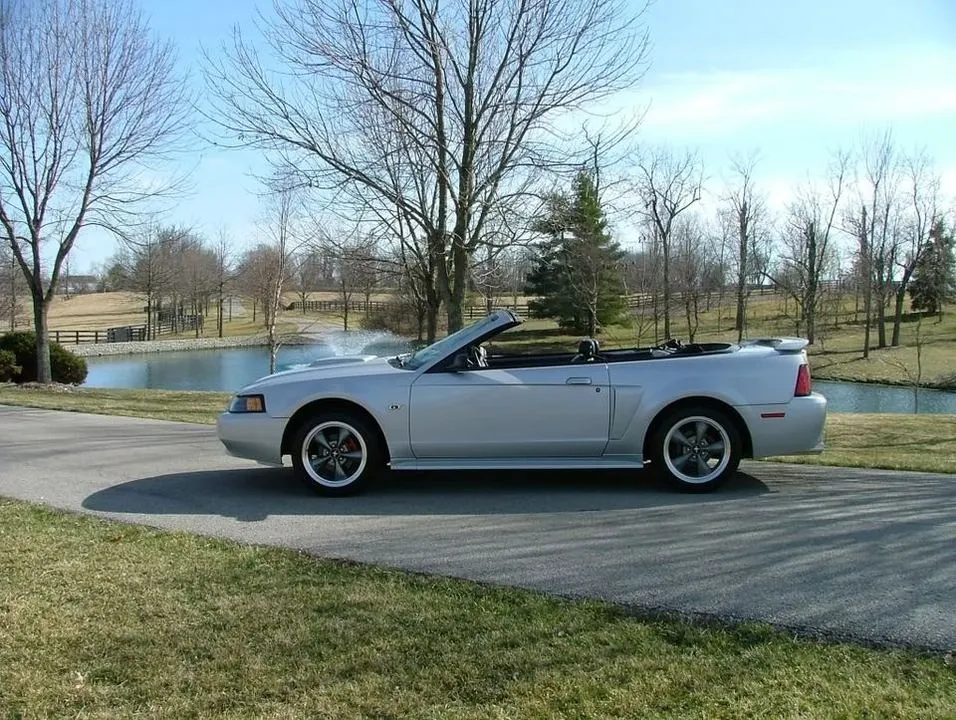

i sold my truck (88 s10) and bought something more reliable/economical. Its an 02 GT vert, and already has a magnaflow catback and a SCT handheld tuner. But it seemed like the 65 got put on the back burner, which i kinda figured it would.

Is it still winter there or did someone accidently drop a Napalm bomb there?
