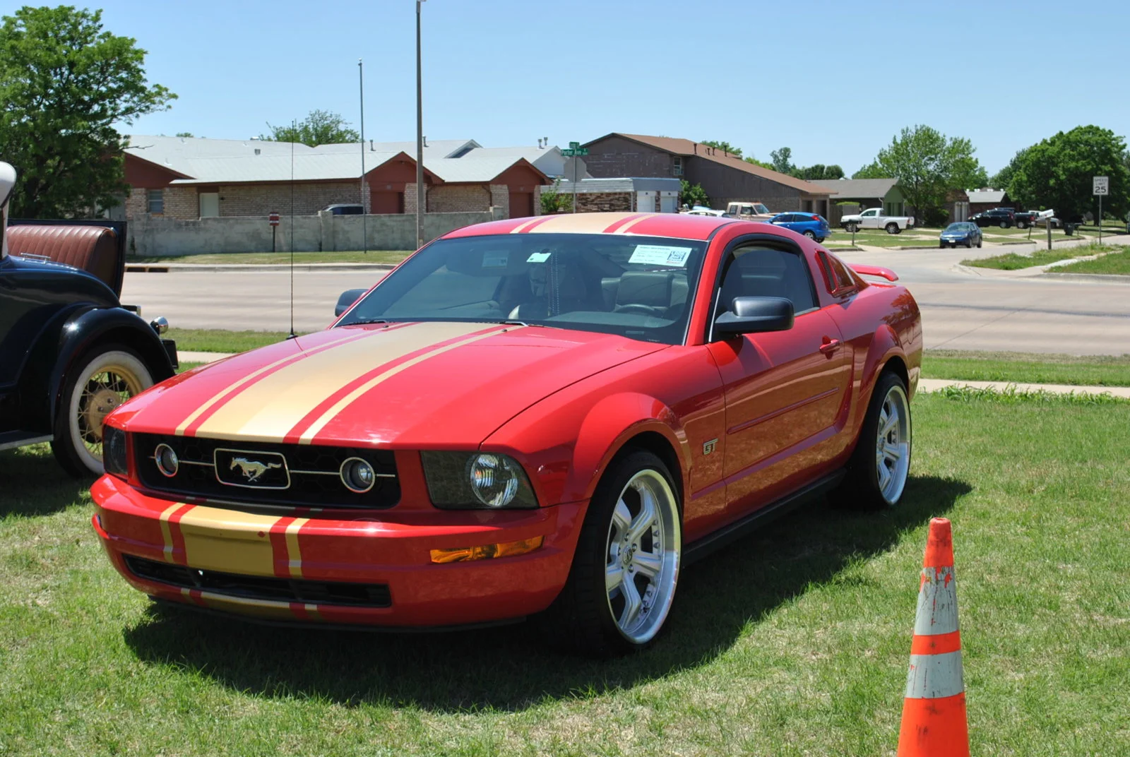

Pic of daughter's ride just because people like pics. Don't hate on the badge engineering, the original owner added all the GT bits...

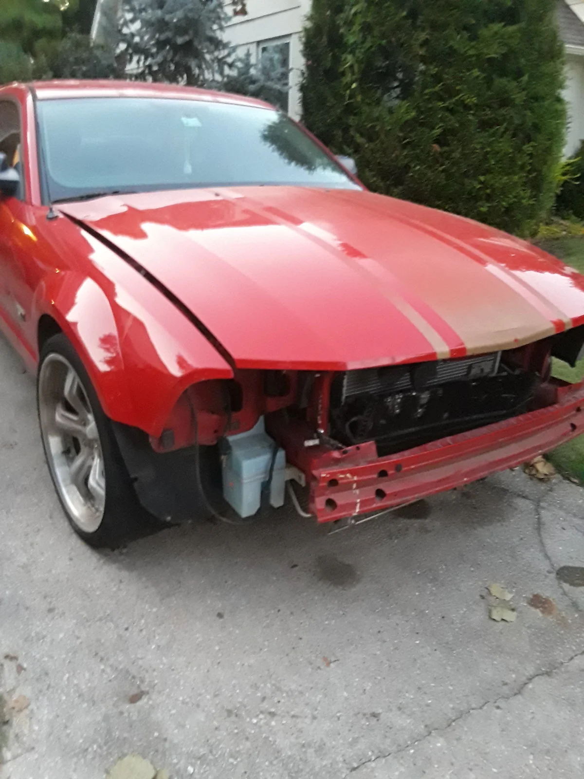

And since I have a before shot, here's a current pic. :( The hood is actually fully latched in this shot. You can see the new radiator in place - I haven't screwed it down yet so the condenser and trans cooler are still living la vida loca for the moment.
