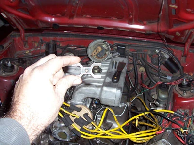

After a few cranks, and twisting the distributor around, we cranked it and the starter bogged down really hard and I heard a really loud pop and crunching and snapping. I got out of the car and slowly walked around. Sounded like a timing chain. I turned the crank by hand and the rotor didnt move.
So we figured time to pull it apart and see what went wrong. While we were fishing for wrenches, we found one of the guides for the lifters. We didnt think to double check Tony's work, because it was such a simple task. Lesson: There is no detail too small in a motor
It really sucks. What I think happened here is one or both of the lifters with no guide turned sideways and bound up the cam, snapping my timing chain, or breaking the cam itself. We decided to call it a night again, and tear it down later. There could be minimal damage from this (new cam, lifters) but I wont know till I pull it apart. There could be some serious damage and chunks in the oil pan.
