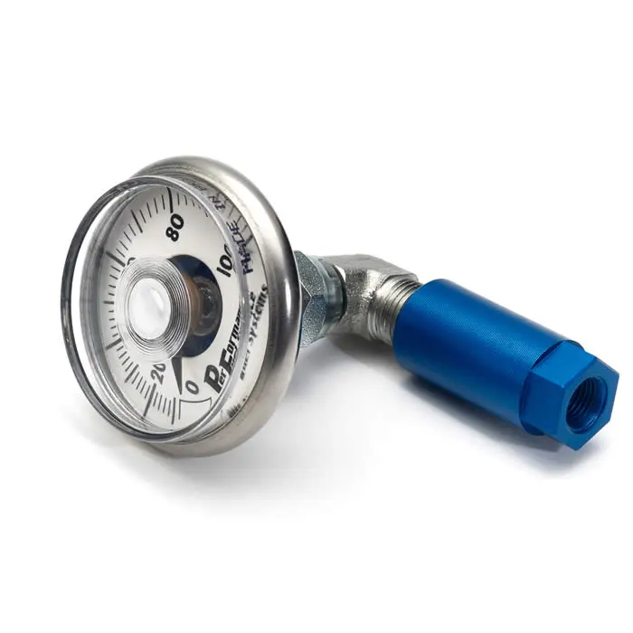

Yup that's the one and I've had a gauge on the shrader valve on my daily driver fox for over six years without any problems.
This gauge.
http://performancefuelsystems.com/products.htm
