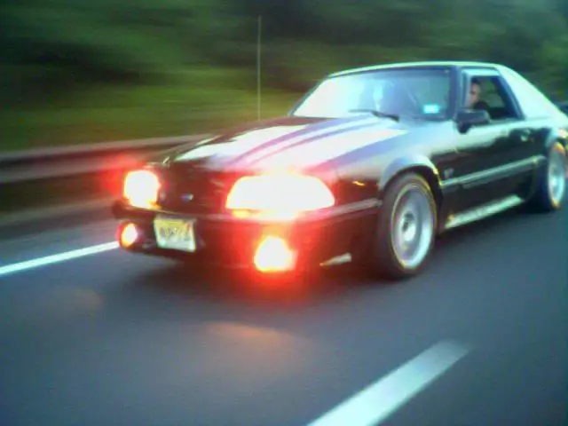

i got C springs under my car and heres a pretty good shot of her stance.
