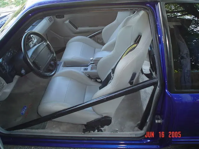

I bought a heavy piece of angle steel when mounting my APC racing seats.
I mounted them to the seat and then marked and drilled into the bracket from the slider then bolted everything up. It did take a little while to get it. But I like the outcome. They are solid as well.
Here is a pick of them mounted. I have more but have to find them.
