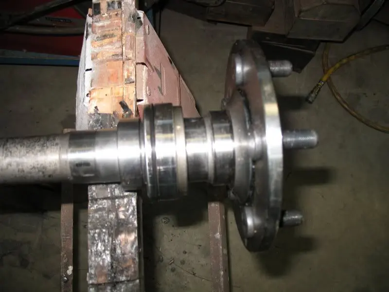

As mentioned, normally the axle seal is found inside the axle tube and its rubber sealing lip rides on the axle.
Aftermarket axles often come with special bearings that have O-rings for axle seals. They do not use the factory stuff and the axle is not machined for the rubber lips, as mentioned above. The O-ring fits in a receiver groove on the outside of the bearings diameter and that O-ring seals against the housing's bearing bore. It is highly probable that the axles/bearings may have been replaced when the spool was added.
Here is a picture of an aftermarket Moser axle with wheel bearing and O-ring seal that I have in my Mustang:

OK, that explains the O-ring seal. The bearing/axle I pictured was also a Moser, but it is a 33 spline unit which is larger in diameter under the bearing than the factory uses and thus requires the special bearing.
I am not familiar with the seals that you linked. I don't know what the sealing surface rides on to seal against the axle or where the seal would set in the housing.
I do know that the aftermarket bearing retainer (seen on the LH side of the pic I posted, against the bearing) is wider than the factory retainer and this would more than likely prevent me from using a factory type seal. Of course in my case the axle diameter is bigger there too so the seal wouldn't fit in the first place. The 31 spline axle might be larger there too. A call to Moser might clarify if the stock type stuff can be substituted.
The O-ring seal pictured does work, but the bore of the housing needs to be relatively perfect. I know that this doesn't help, but I sanded my bore until it was smooth of all imperfections prior to installing my axles, plus I lubed the O-ring. Some people use a hone to finish them and that might be a possibility in your case if the bores are indeed rough.
