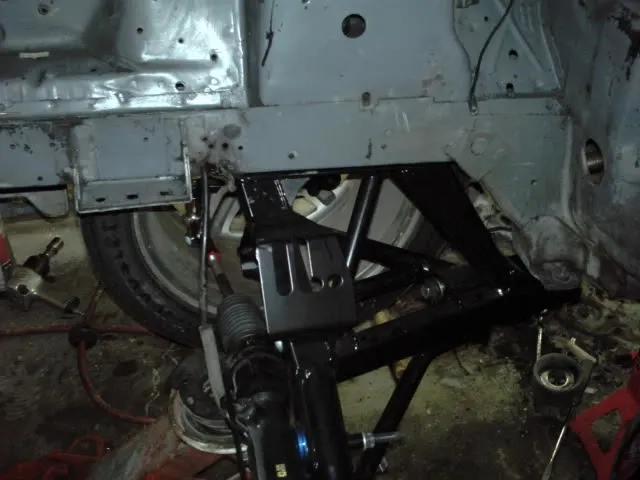

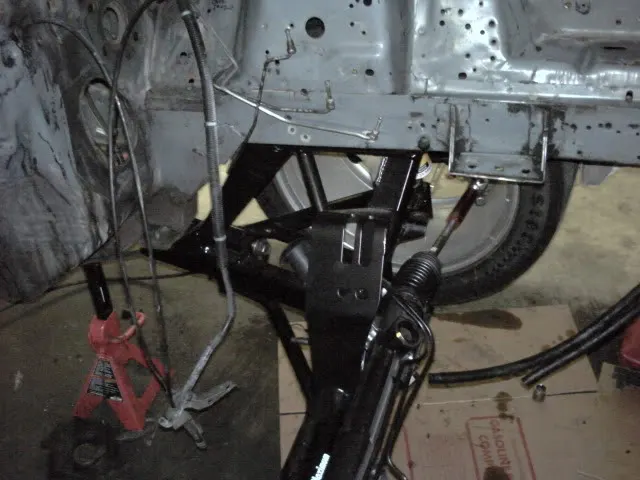

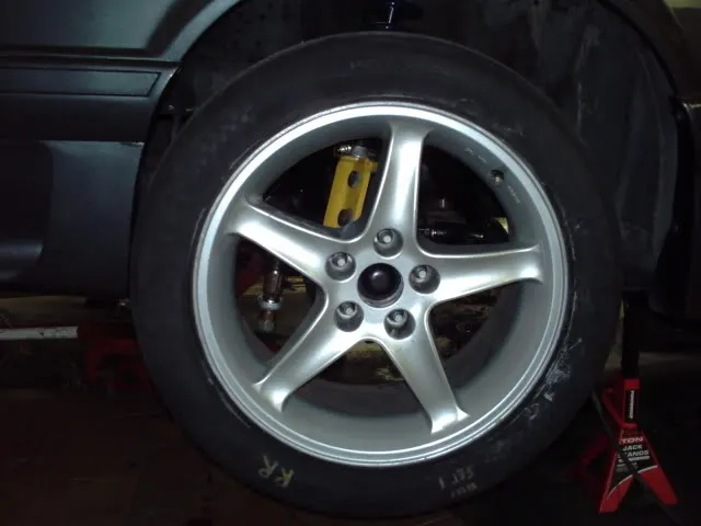

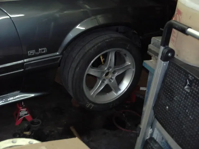

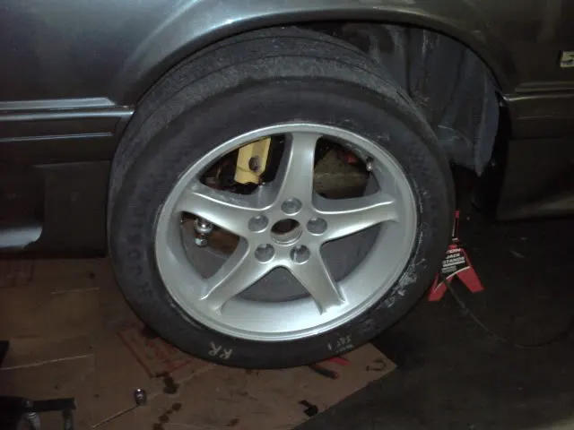

I just spent a straight 24 hours working on getting my car back togethor only to find that my front wheel have been moved forward like 3" due to the new MM k member its moved so far forward that the tires are touching the front bumper has anyone ever heard of this, i need to make sure i can at least roll this thing out of the shop by monday morning so i can start work, need help ASAP, pics have been inlcuded to show

are you running the forward offset control arms mms offers? I have seen this posted with those types of lower arms & 96^ spindels making the wheel offset extreme. alot of guys will run the stock qeometry tubular arms with 94/95 spindles or fox spindles. I see you have 95 cobra stuff so just curious about what control arms you got.

i know that MM will be glad to help, but thats not the issue, the car is at my business, i bring it into the bay to work on the weekends and if i cant get it out before monday its a serious problem cause i wont have any way to get it back on its own wheels, if its hitting this back on jack stand imagine how much its gonna rub on my fresh paint when i put it down with the cars weight

i went with the standard geometry fox arms, i was previously running some 95 spindles till i decided to install the k member so i got some 96's i was expecting the 1 inch forward but **** this i was over what i expected, maybe the sent me forward offset arms from the beginning

That's the only thing I could think of off the top of my head that would cause it to be so far forward, it would seem stock geometry arms wouldn't cause it to be that far forward so something is up. try searching corral under the general section or here, alot of info on k-member stuff/problems maybe something might help out. mms tech might be the other solution.

i already have some, but if its rubbing now whats happens when i put all the weight down, no bueno is what
