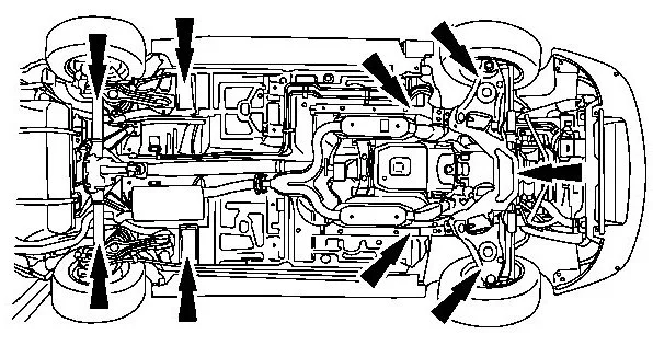

I do not have a problem jacking up my car :shrug:
http://www.stangpro.com/html/articles/jackingrails.htm

use the little knuckle buster/screw jack that came in the back of the car first. postion it a little off to the side on the jacking point right in front of the oil pan. that will let you raise it enough to get the big jack in there. my car sits very low in front, so i know exactly how you feel. this way is quick, and easy.
