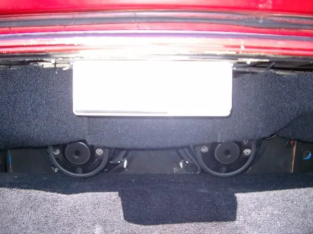

I have two free air 12s behind my seat. I have had this set up since the 80's and still have the ol' Rockford Punch 150 pushing them:nice:
Can't see the photo at the moment, I'll check it out at home though. I think my idea of sticking them behind the rear seat by cutting a hole in that metal sheet will work pretty well.
