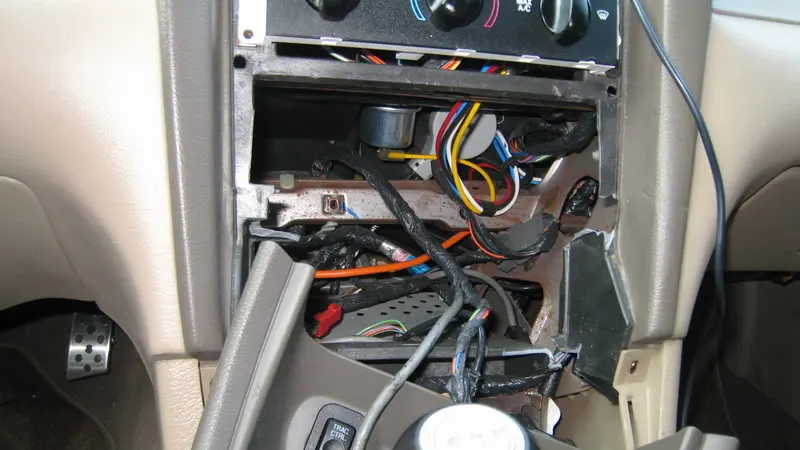

Don't make the same mistake I made: buy an alarm system for your car!
BEFORE: (gauges, Pioneer 7" flip Touchscreen w/iPod adapter)
AFTER: Everything...gone
LEARN FROM MY MISTAKES!! VIPER 5002! $300 installed! PROTECT YOUR PROPERTY!
