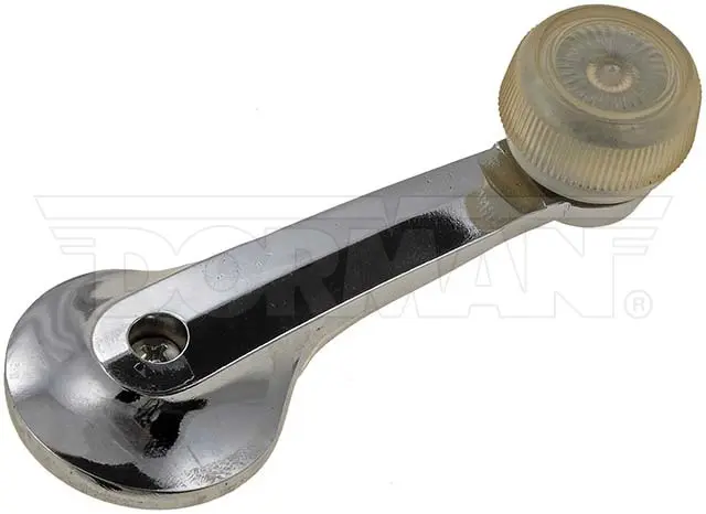

Here's the bad boy I used. At least I think it's the same - they might have had different revisions on them or something, but they look like this. :shrug:
Link

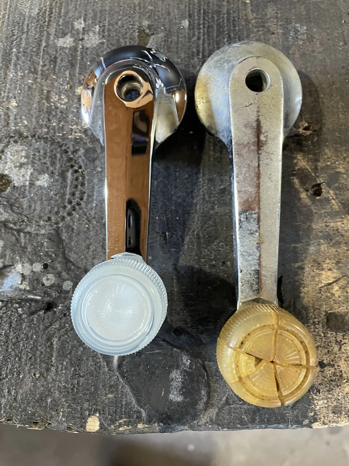

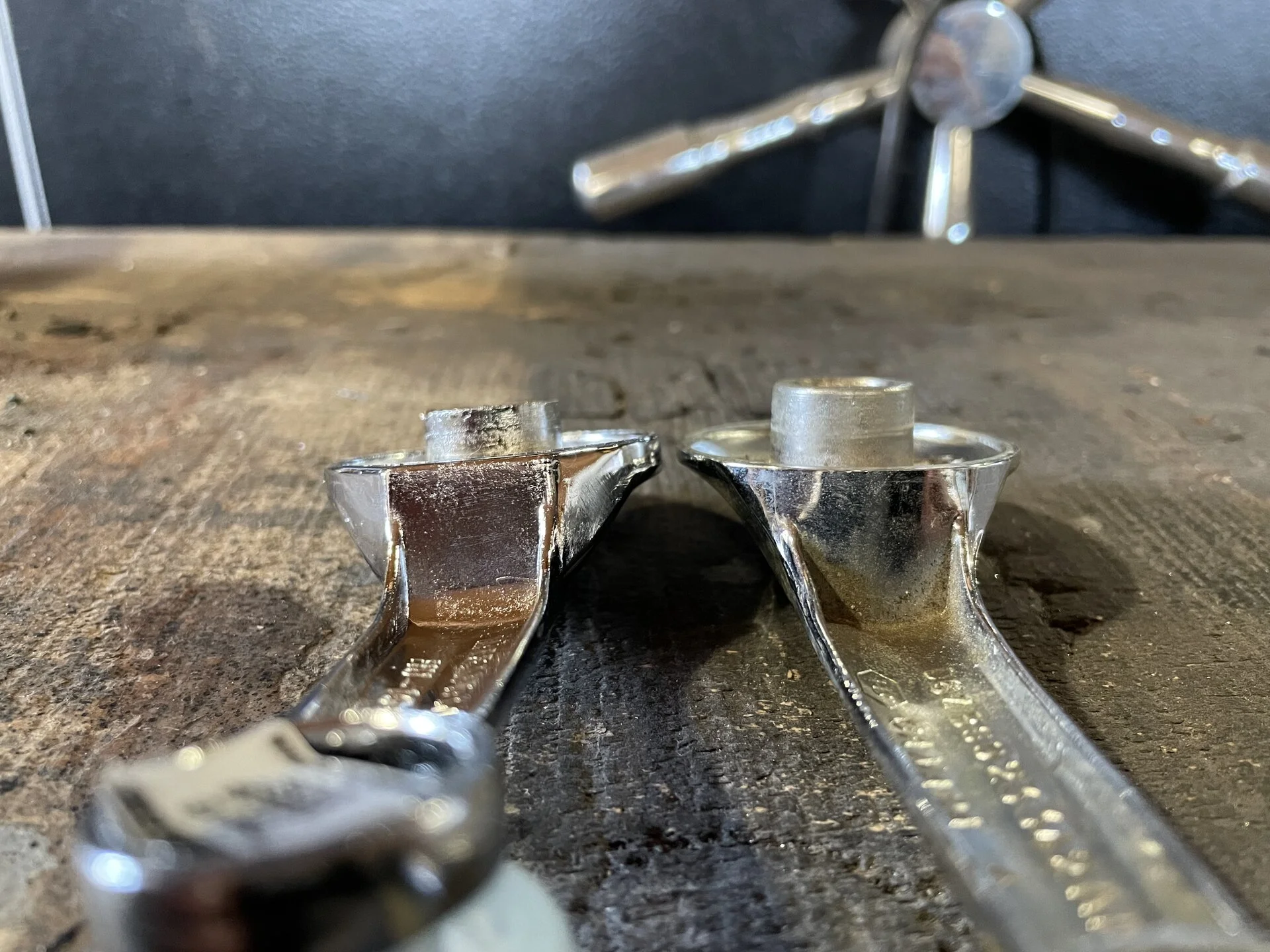

I did order two of the Dorman 76916 cranks. They are close and do work. But just in case anyone else is using this thread as a source for information, they are not exact. You will want to order both sides if you want them to match. I’ll use these for now but continue to look for an exact match to original. I have attached pictures to show the difference in them from original. The original is a bit longer and stands off the door more.

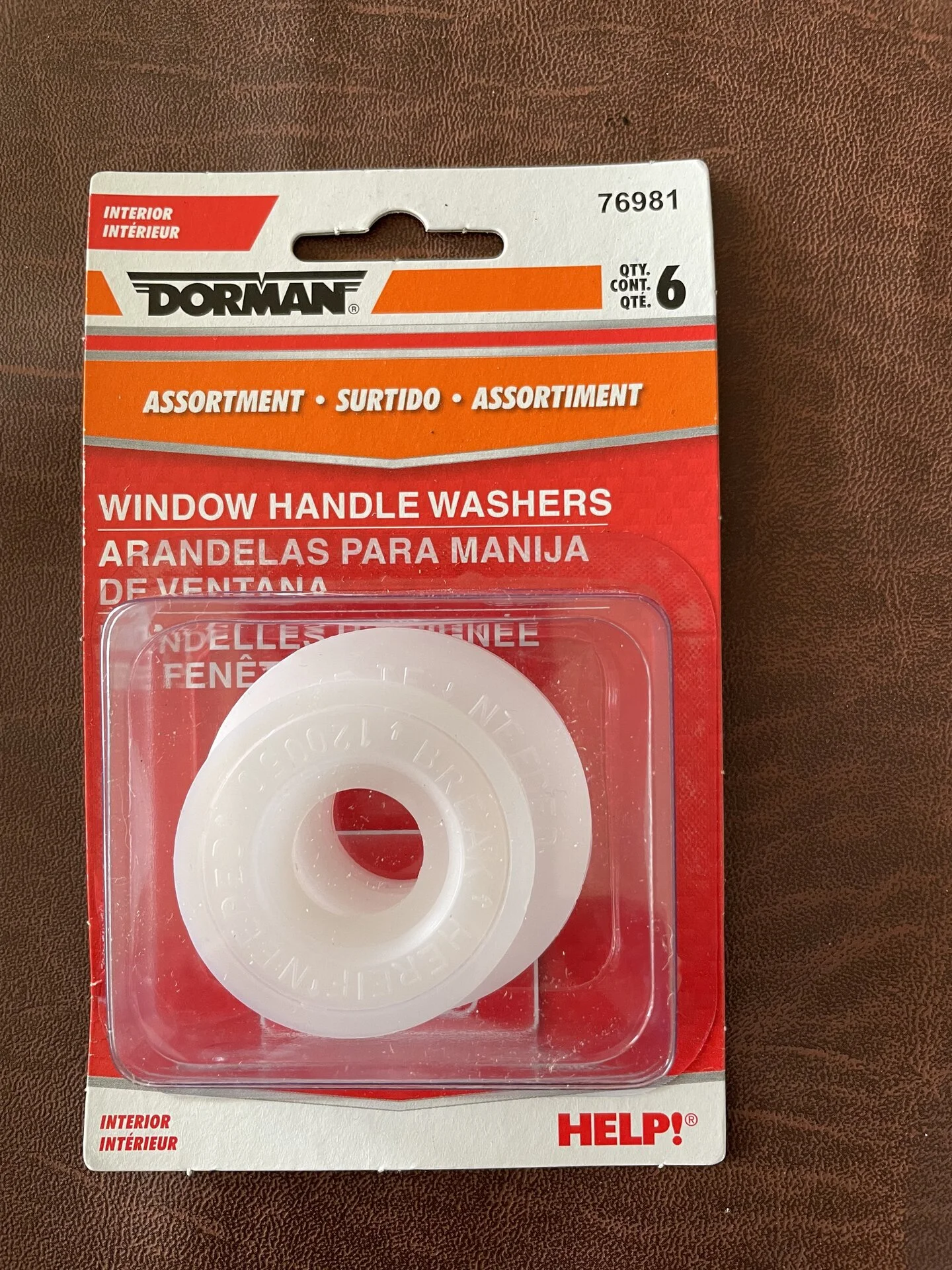

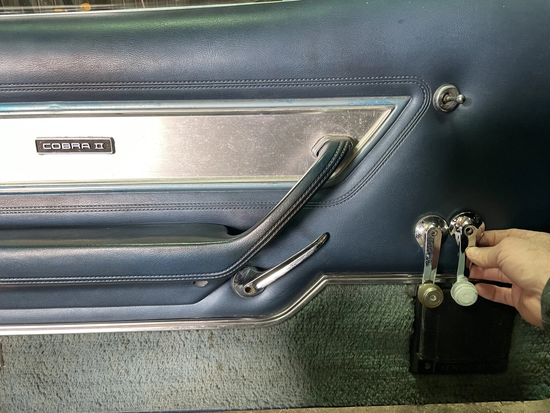

Funny thing. I pulled my 76 Cobra II out of storage today. I decided to compare the cranks on it. At some point in its life, somebody, most likely my Dad since it used to be his car, put these exact Dorman cranks on it. I never noticed before and had no complaints. So I’m sticking with them on this car as well. If you use these, you won’t be disappointed. They do give you slightly more clearance from the door handles as well. So that is a bonus. Side note, I found the Dorman plastic washers. They come in a assorted box of different sizes. Not as good as factory but they do work well.
