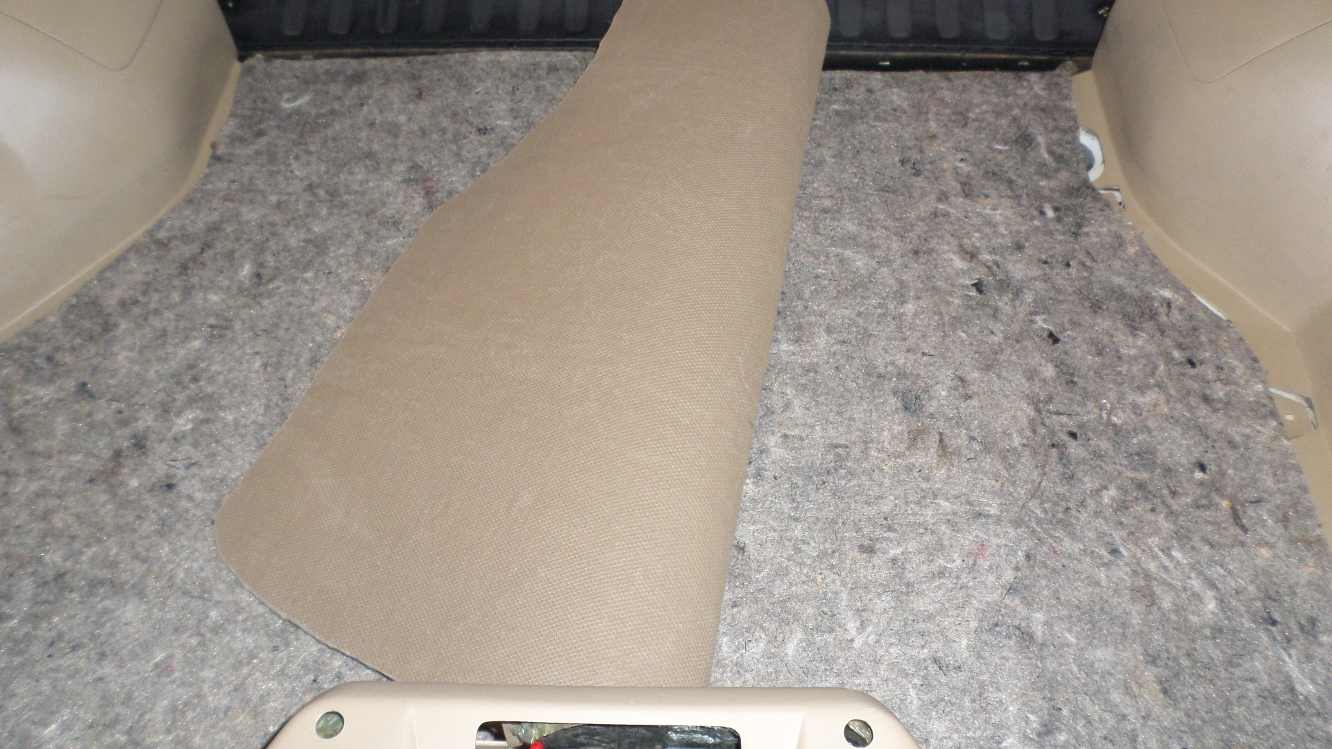

I was cleaning the interior of my '87 LX when I noticed that the jute felt padding in the hatch was looking kind of decrepit, so I thought I'd replace it with a modern Mohawk felt-and-latex rug pad, $22 for a 3x8' piece, more than enough to make two layers of padding.

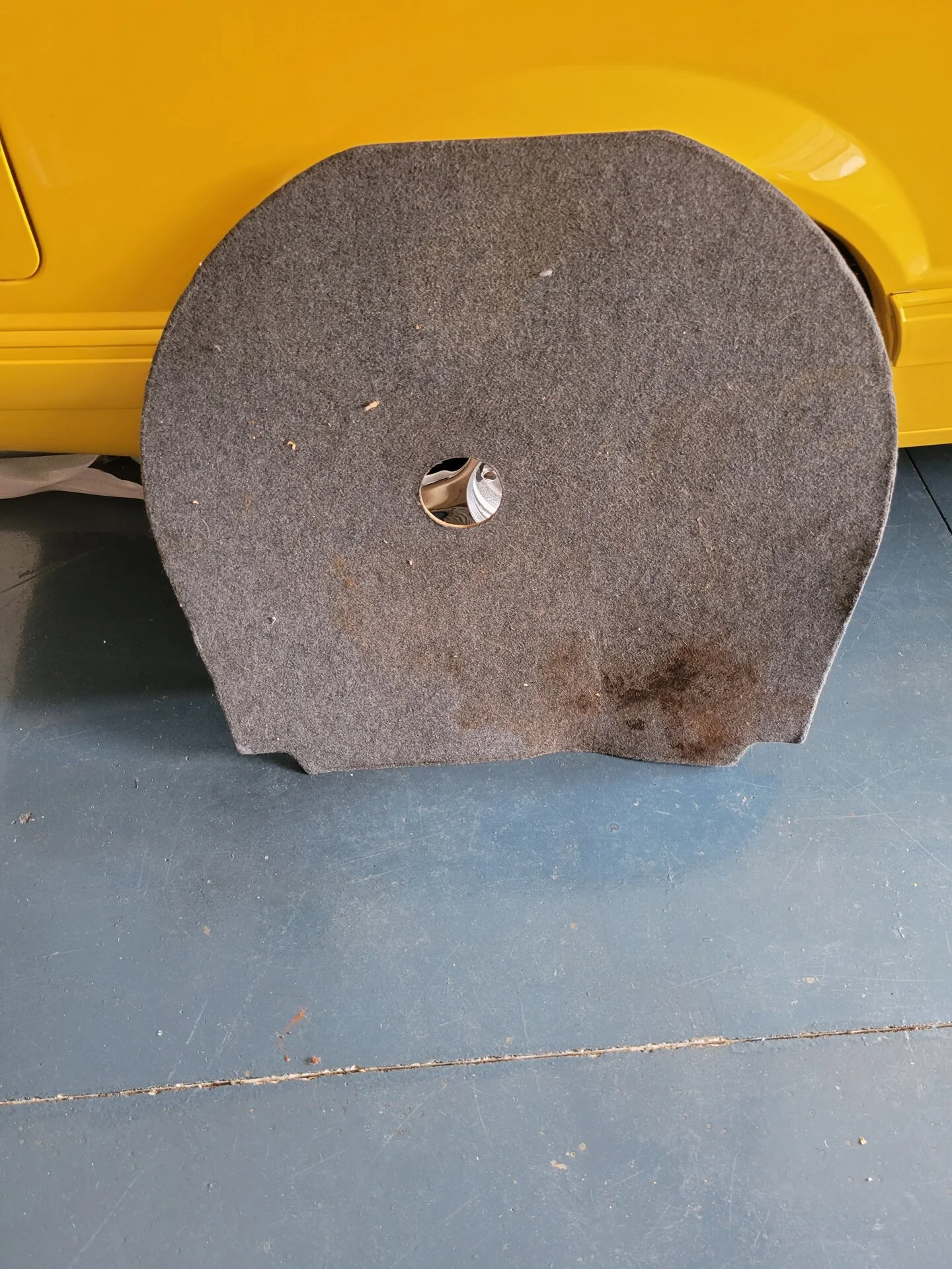

Right off the bat, I was staring at that shiatty fiberboard spare tire cover that I've always hated. I don't think I've ever carried anything heavier than an angel food cake back there, and still it was all bowed and made these "I'm very weak" cracking sounds just trying to lift it up with the felt padding on top of it. Time for that thing to go! But what to replace it with?

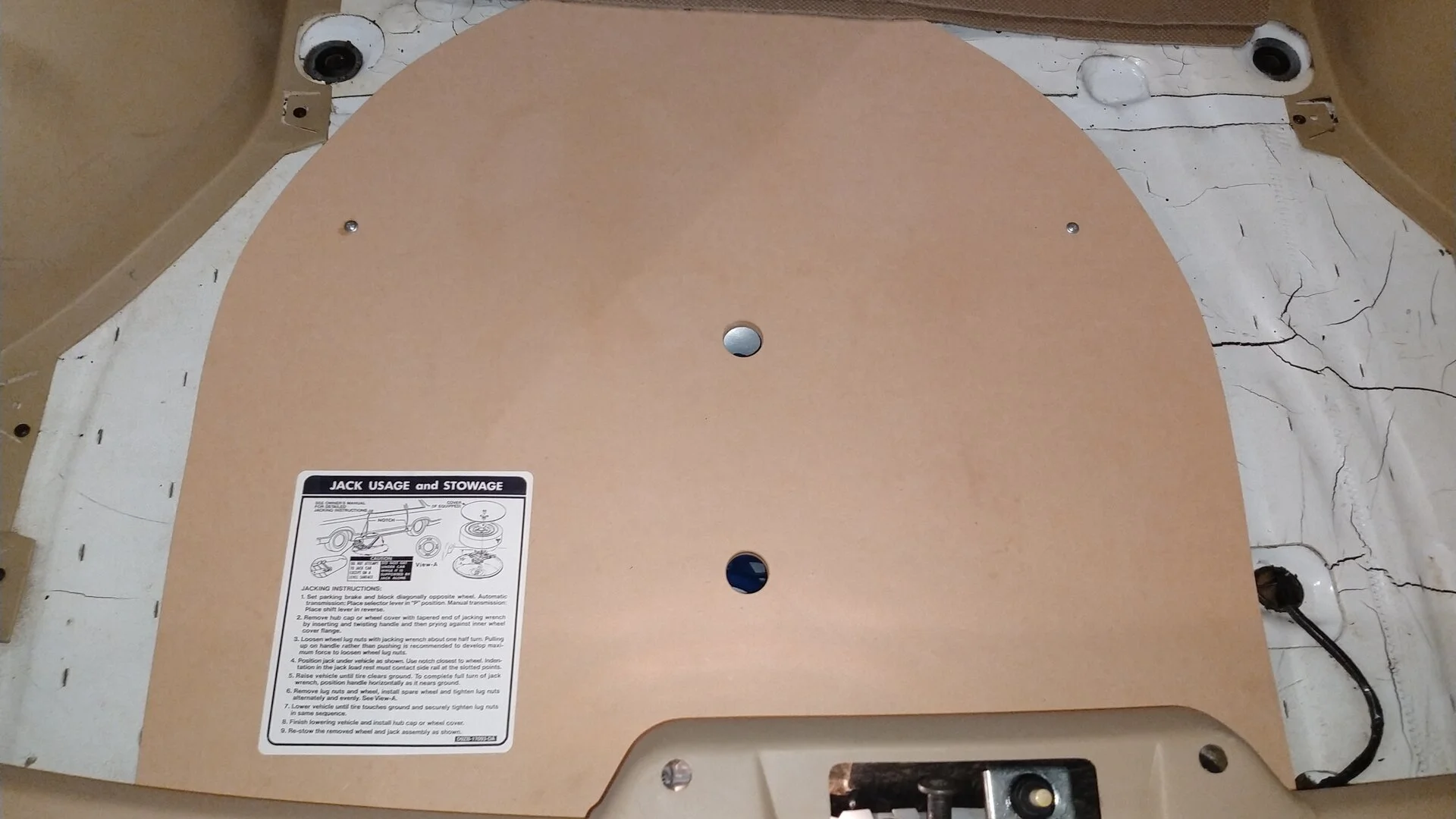

Fine, I thought, I'll just replace the fiberboard with plywood. But I just didn't like the idea of picking up the carpet and padding and seeing, well, plywood. I wanted a material that was smooth and finished-looking, like the original.
Seemed like the best idea was hardboard or Masonite. Like the original, it has one smooth, finished side and one textured side that provides a little bit of grip but won't damage the painted hatch floor. I figured 3/8" would be perfect...just strong enough but not too heavy.
Turns out, unless you work in a lumberyard...a big one...3/8" or thicker Masonite is very hard to find, unless you want to special order a whole skid of it and turn out Foxbody spare tire covers for a living.

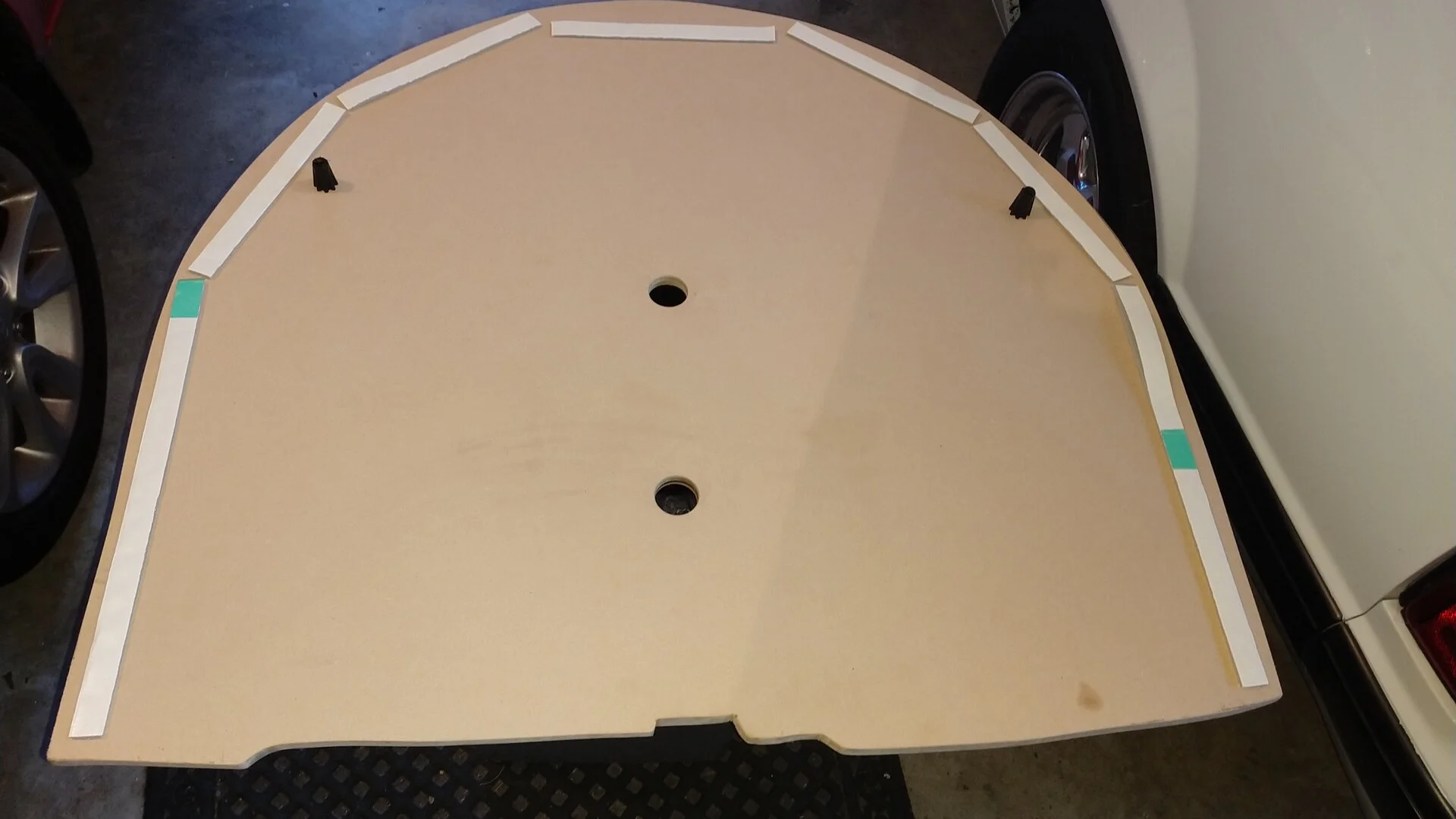

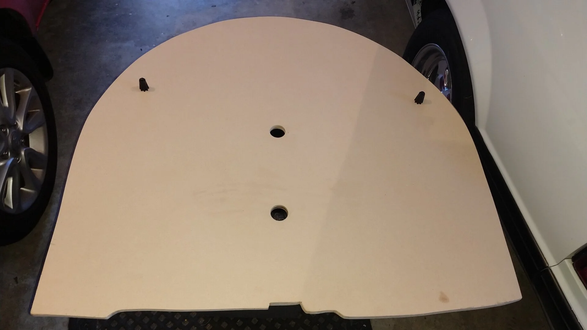

1/2" MDF looked like a pretty solid choice. Smooth and finished-looking, and plenty strong. But really heavy, and when you're leaning way over the hatch to pick that thing up by the side of the road, you don't want the extra weight. So I came up with a compromise; Ultra-Light MDF. Pricey at $30 for a 4x8 sheet, but otherwise, just what the doctor ordered. So I used the original board as a template, cut out a new one, and transferred the alignment pins over.
Since the MDF is smooth on both sides, I wanted something with a tiny bit of grip to protect the paint and hold the cover in place, so I picked up some Frost King 3/4 x 3/16" closed cell foam tape for the underside.

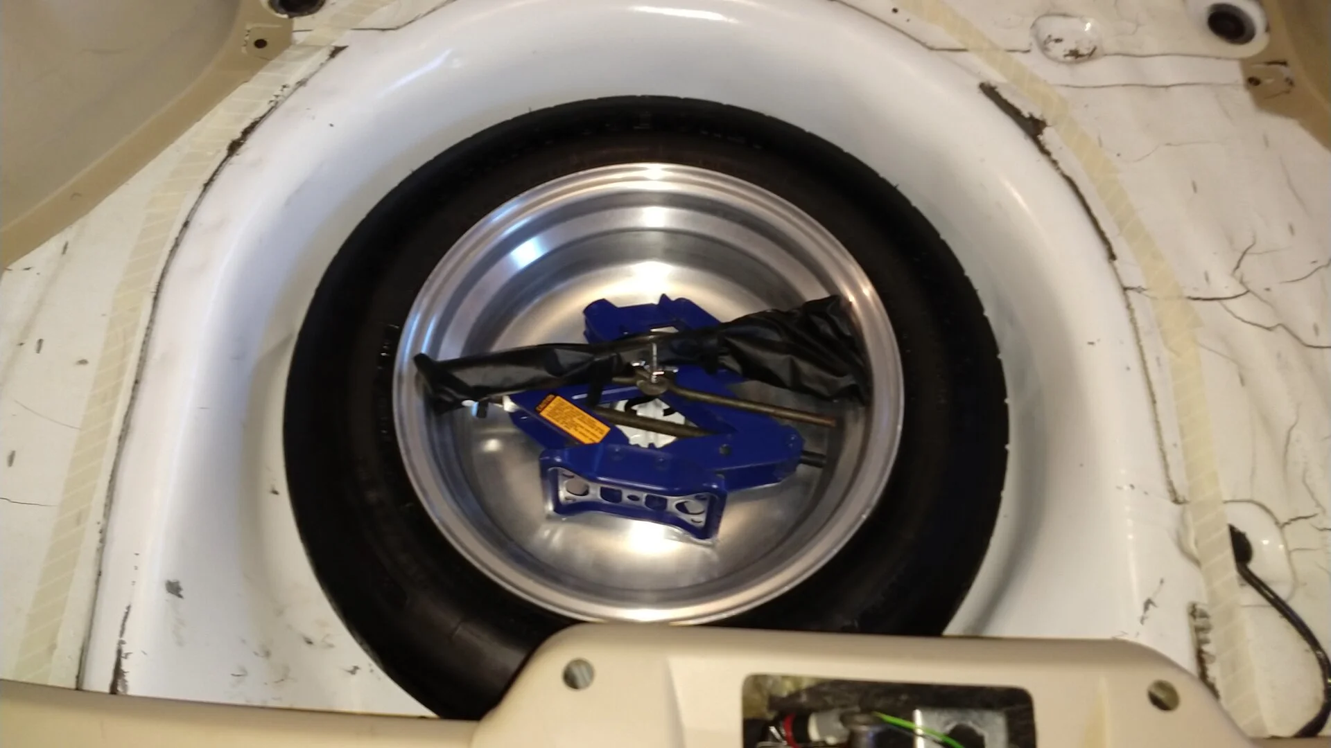

Now that I finally had gotten rid of that cover that's been irritating me since Reagan was President, I decided it was time to swap in an aluminum Cobra spare too.

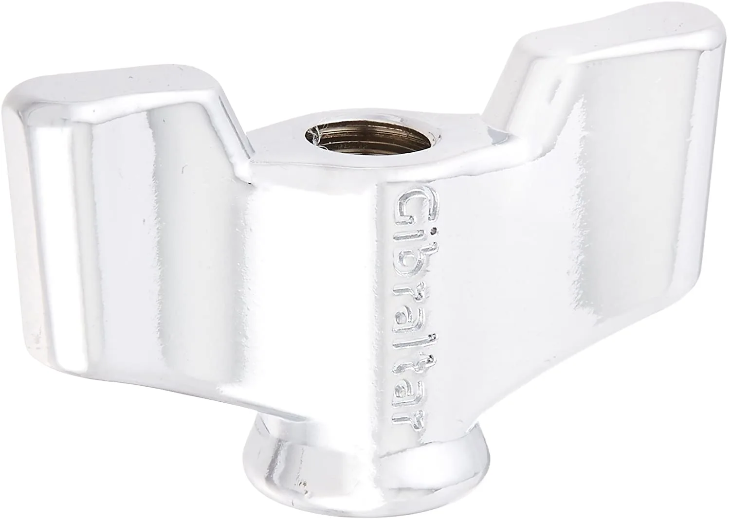

At some point in the past, the plastic spare tire wing nut had broken. I picked up a brand new one from Ford, and it was sitting there in the little blue and white bag. But that cheesy, plastic toy just didn't look right on top of that beautiful aluminum wheel. I decided that there had to be an all-metal wing nut I could use instead, that wouldn't dry out and crack like an old twig. I found a polished, all-metal Gibraltar SC-13P2 8mm wing nut meant for a drum set. Bonus: A set of two was cheaper than one Ford plastic wing nut.

You could custom fabricate a thin aluminum panel. Glue thin carpet to both sides leaving about an inch excess around the edges. Have a carpet shop sew embroider the edge all the way around. That is a fairly good option for a useable panel. Great idea about the wing nuts that have been a problem forever. I have fixed tens of these. I used to weld bolts to the square metal nut that is in the center of the broken plastic. Looks like hell but you can get the spare out
