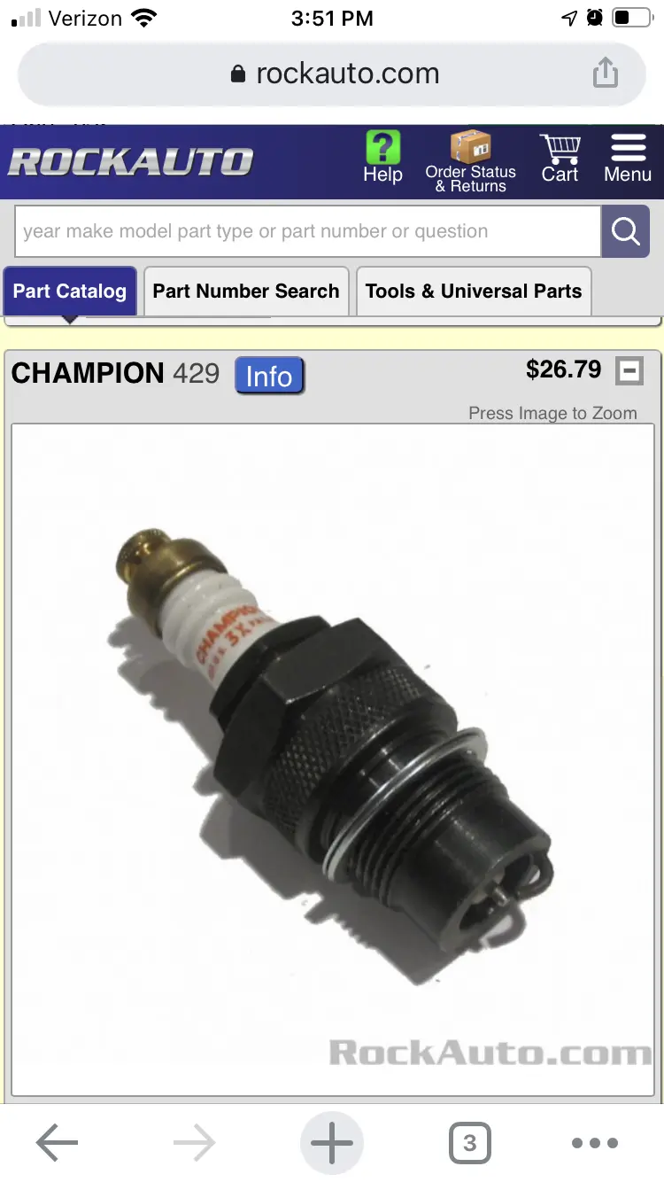

The model A pickup engine will not have the same spark plugs. You can still get several brands of plugs for the AA engine from Rock Auto!

There is not a bad copper plug on that list. NGK, ACDelco, Motorcraft, Denso, Champion are all OEM quality equipment. E-3 and Splitfire copper plugs are deals at that price.
The exotic tip plugs would be money better spent on an engine with a more tightly controlled A/F ratio. They run fine, but they will not last 100k miles without fouling in a car without precise tuning and electronic ignition.
