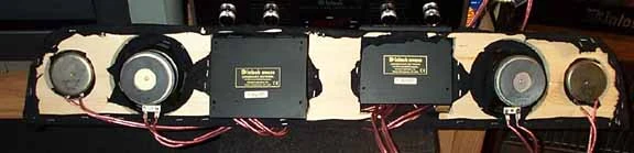

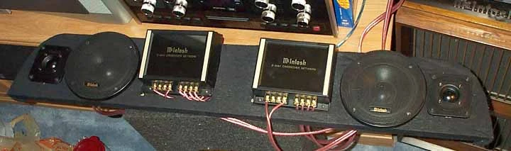

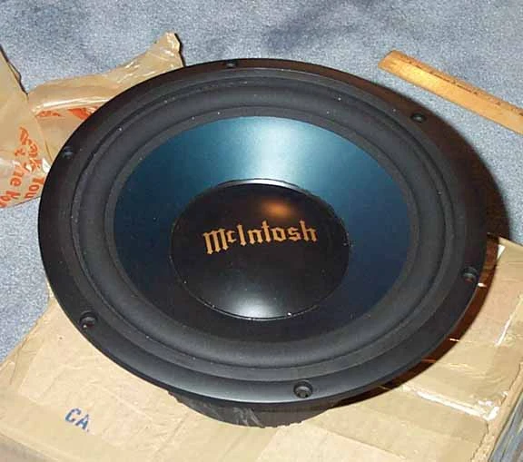

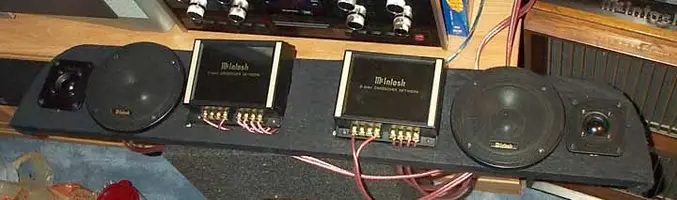

I ended up taking out the rear deck 5 3/4" x 8"s to put in component 5 1/4" mids, 1" tweeters, and crossovers. I built a shelf to lay on top of the existing deck; the bottom of the mids fit into the holes left by the 6 x 9's and the tweeters and crossovers either fit into the new 3/4" shelf or on top. Shelf is 6" x 38" and I used the existing grills to shape the ends of the shelf, then covered it with black fabric. Pics are from testing phase connected to home system. I sure CAN hear 'em now (lol)! Box to house 10" sub is being built by a carpenter customer of mine and will be done this week. Woofer element itself weighs 12 POUNDS! Oh yeah, and I still have to put on my new license plate holders! Front door speakers are done (and in use) except for minor tweaking - will finish tomorrow and post pics, weather permitting. Then the fresh 14-guage wiring, amps, head unit... hard part is done!
Please give me some input... might work for a few of you.

you sure are putting a lot of emphasis on the rear speakers....
how is that shelf fitting in.... does it just sit on top of the rear deck?
What kind of mids and highs are you running in the front...?
Don't want rears to over power the front...

OK--I just re read your post. Dude...why don't you mount everything from underneat so you have a stealth installation. My personal taste--I don't like seeing speaker grills and what not exposed in the cabin...unless absolutely necessary. Hide the crossovers and run some grill cloth over those speakers....if u want put those cool little Mcintosh badges on the outside....
Thats just me though....you've obviously spent some money on the equipment and effort into the install...might as well make it as custom as possible...

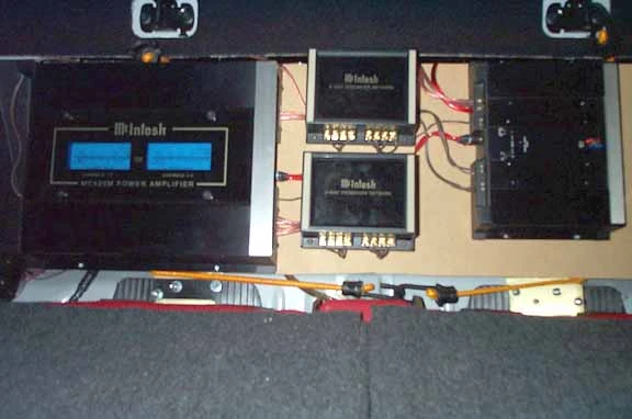

Thanks for input; plan A never works, anyway! So to answer questions... deck fit as planned, but didn't fit Mustang (lol). I assumed rear deck was flat, not actually so. Plan B: small mounts to sit over holes from stock speakers in rear, mids and tweeters only (grills over mids are for protection, but I don't mind flaunting the Mc logos and, besides, I'm in a rural area and nobody around here ever heard of Mc! lol). Crossovers will be underneath, mounted on a board with, yes, Mc amps. Bigger one to power fronts (50W continuous RMS X 2, remaining two channels bridged to 100W for, yes again, Mc 10" sub. Smaller Mc amp for rear deck speakers, 30W continuous RMS, so emphasis is really on the fronts and sub. I think I worked out a sweet mount for the amps and crossovers, will post pics as I progress. Head unit is, guess what, McIntosh! (still waiting on delivery). Sorry, but I AM obsessed! Front door speakers are McIntosh 5 1/4" coaxes with separate crossovers, so there IS at least some emphasis on the front. God, it's refreshing to hear from someone who's actually heard of McIntosh! My roomies and I at college 20-some years ago used to do the music for sorority parties with all Mc equipment.. it even made US nerds seem hot! LMAO. Total projected out-of-pocket expense: $1600 all Mc purchased used or online, my own labor expenses, total retail close to $4.5K. ....thanks for the input!

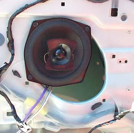

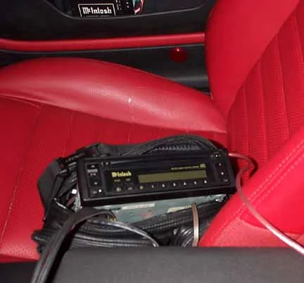

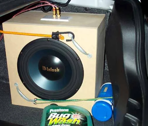

New plan as install is approaching completion (as if that'll ever happen)! LOL I'm not even close, as it turns out, to the original plan, and I don't think I can even remember what that was! Here's what's done: 1) 10" sub in sealed box in trunk, mounted to passenger side but movable 2) 5 1/4" coaxes in front doors, crossovers in compartments underneath front door armrests 3) 1-din head unit functioning in padded cd player carrier bag (PITA on front passenger seat or center console, to be replaced by 2-din unit in-dash - waiting on harnesses and dash kit) 4) new 6 1/2" mids in rear deck, tweeters yet to be positioned (still deciding where...) and mounted 5) new 4-channel x 50 wpc amp driving fronts and bridged for sub, temporary 30 wpc amp driving rears (to be replaced with second 4-channel x 50 to drive rears and possibly an additional set of tweeters - waiting on amp repair) mounted with rear crossovers to 3/4" MDF and hinged to swing up and latch for show with rear seatbacks folded down but also able to lay flat for concealment and better ventilation with seatbacks up (in and functional but needs some finishing touches) A couple of pics...
