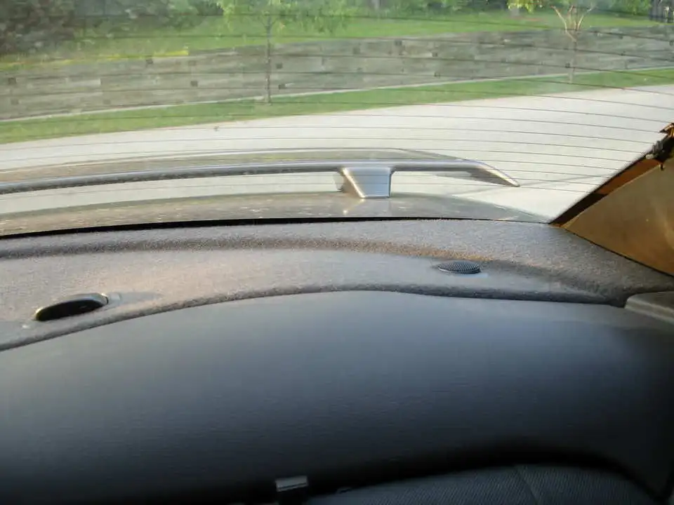

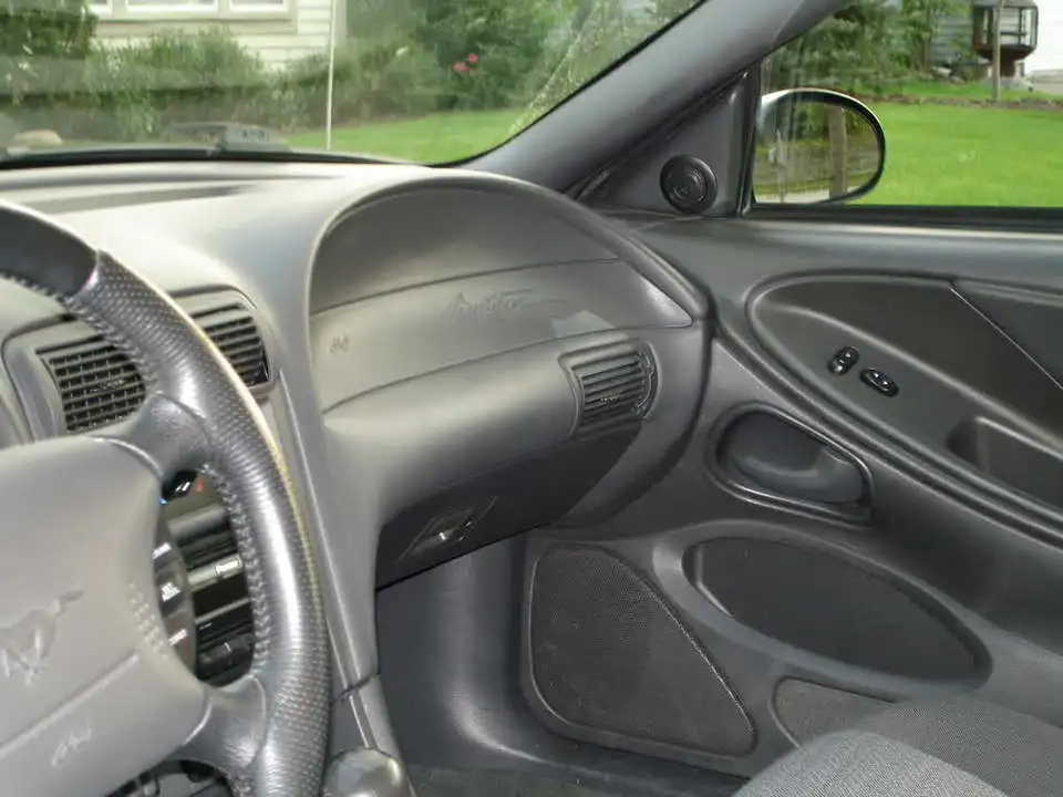

way to go ford for making a sound system that sucks balls. 8ohms is home audio territory. im glad i didnt have the mach460. i am using 2 pairs of 6.5" alpine type-r components in my car. i custom mounted the tweeters too. cut holes in the sail panels and the rear deck. it looks stock and you wouldnt know they were aftermarket unless i told you.
i know i have pics somewhere.
found them
