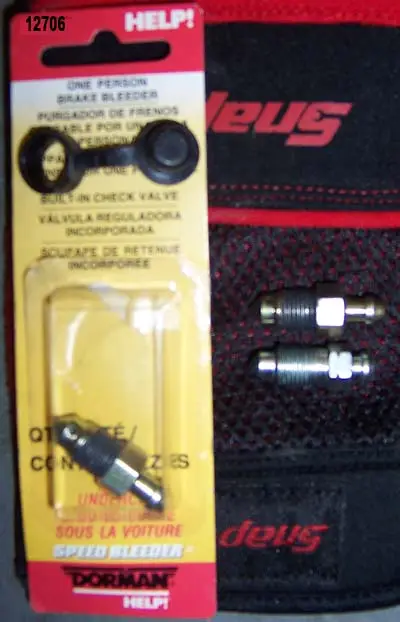

Here's a pic of the Speed Bleeders I used for the Baer brakes with PBR calipers. I retyped the part number in the pic (Help! number 12706) since the pic was fuzzy. The smaller silver valve and the black cap are stock PBR. The gold anodized valves are the Speed Bleeders. (Speed Bleeders are sending me some caps.) They look a little different, but the threads and below are the same. I haven't bled the brakes yet; still have to flare the hardlines. The front PBRs are 3-4 years old; the rears are new, same valves at all 4 corners. (BTW, I think the 33mm measurement is actually correct for these bleeders and not rounded up. I was surprised to see them look different than what I took off.)
(Edit: Also, I bought them at Carquest for about 12.50. The ones Advanced Auto ordered for me at 10.50 were open and dirty. I didn't accept them.)
