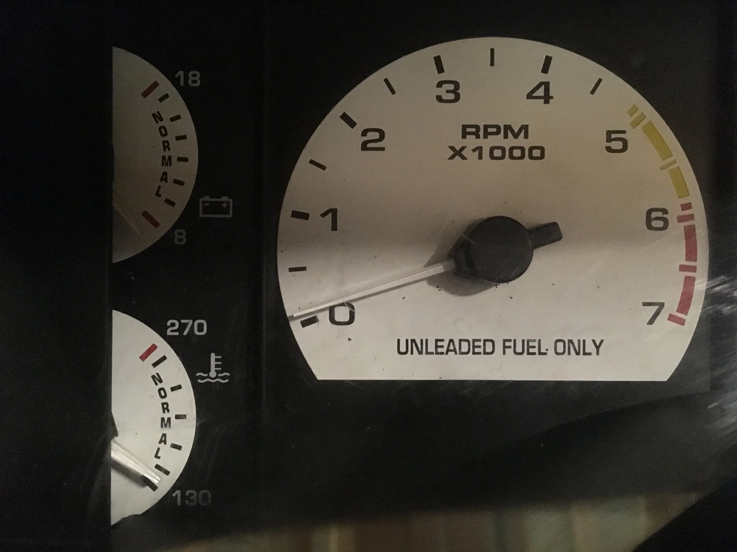

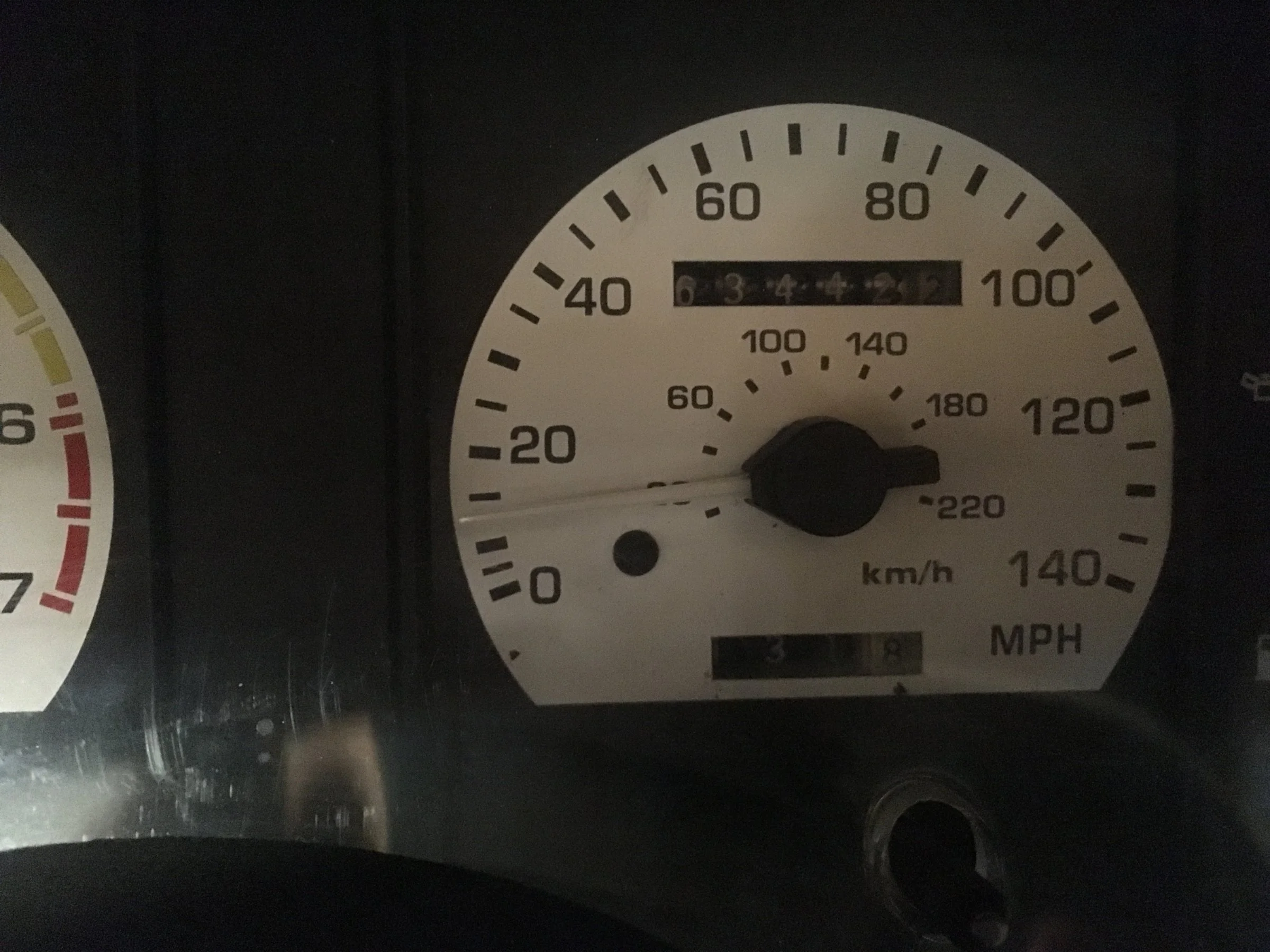

Someone added white faces on the inst cluster before I got the car. The speedometer needle is not at 0 when the car is not moving. How do I fix this? The tach is the same way but not as bad.
Don't reset the needle pointing at 0. See that tick mark on the guage face below 0MPH. Pull the needle stop out, reset the needle so it points at the tick mark, then lift it up and reinstall the needle stop pin.
I see. This way the needle rests against the stop with a small amount of pressure. Is that a correct assumption?
The speedometer scale in my '94 GT has no ZERO mark; it begins at 10 (mph), with the needle at rest there. Thus, any speed between zero and ten is guesswork. imp

I'm trying to reset the needles now. Got the bezel off and tried to pull the speedo and tach needles off. They're not coming off. I can even feel the shaft lifting up but they still wont pop off. Should they just come off easily? I wonder if the person who put these white faces on glued the needles on. I hope the heck not but I wouldn't be surprised considering all the other messed up stuff on this poor car! Do I just pull harder and harder? I'm worried I'll break something and wind up needing to replace the entire cluster.
Does the shaft come out too? I got the tach off but the shaft came with it. On the speedo, the counter weight came unglued from needle but the needle wont budge off, with or without the shaft
I tried prying up with a fork. The fork tines bent and the needle won't come off. No way should it take this much force to get it off. Something must be wrong. I think whoever put these white faces on here glued the needles back on. I might be shopping for a replacement cluster. Damn!
