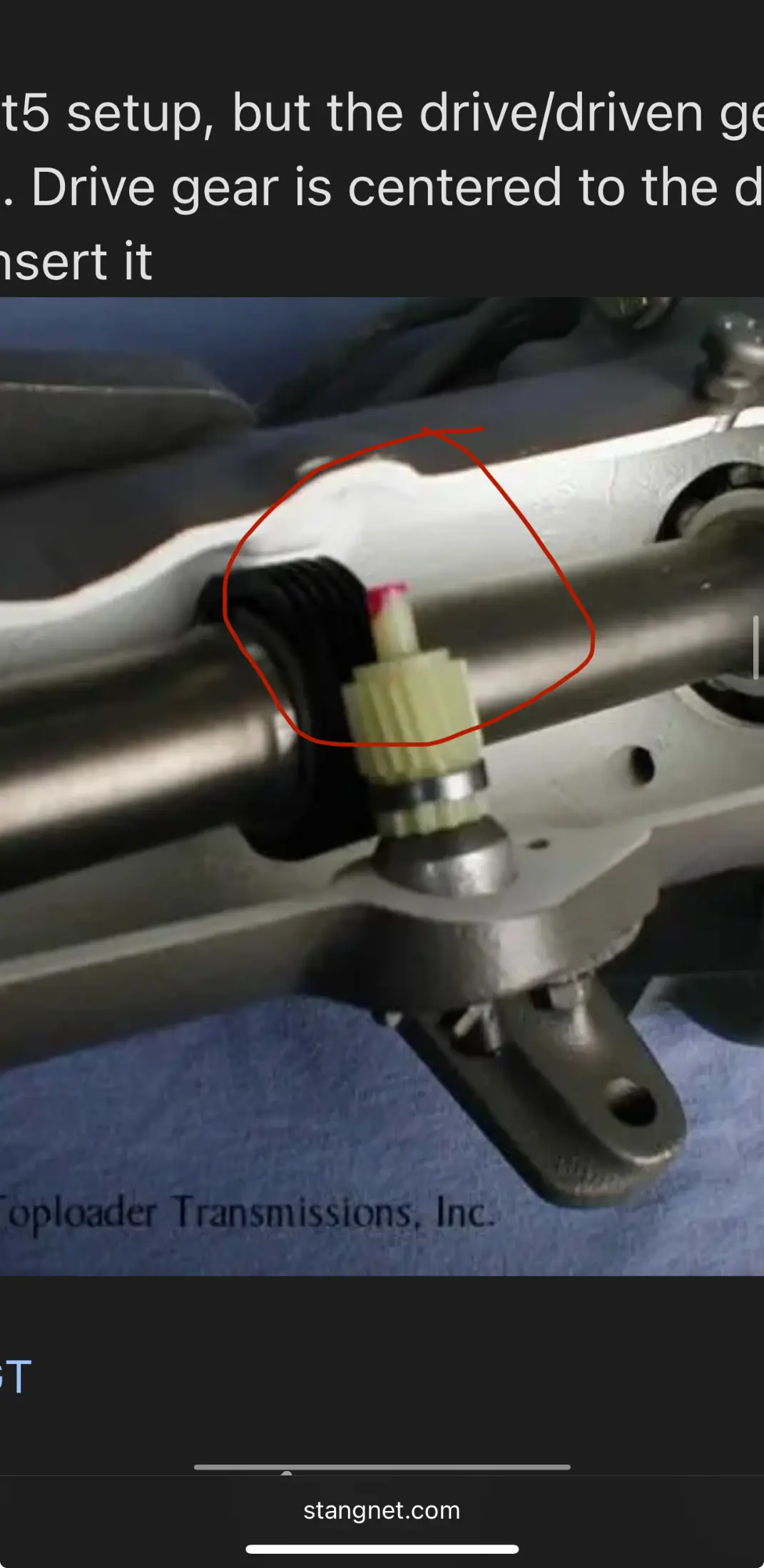

So I’ll unbolt the Speedo cable from the trans and spin it to see if the cables good. I’ll also peek through the hole in the tail housing to see if the tail shaft gear is still centered in the hole.
Only thing I’m wondering, do I attach the drill to the nub on the end of the Speedo cable gear that I circled in the pic? And which way do I spin it clockwise?
Drill counter clockwise on the end of the cable while someone watches the speedo, dont go full boogie with the drill, increase rpm slowly. Pull the cable out of the speed sensor and chuck the cable end not the gear. If it spins troubles in the gears. If it doesnt troubles in the cable or Speedo head. some Fresh gears can get chewed up fast with some gear combos and even slip in on speed sensor so check that by hand with a little heat, the shaft gears can also walk down the main shaft if the clips screwed up. Best to test the head unit with a drill if any bouncing issues too.
