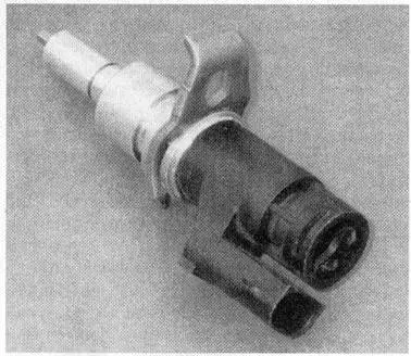

I just bought an 87 GT. Car ran good, changed the oil pressure sending unit, coolant temp sensor, Oil, Air Filter, Speedo cable, Now the car has a terrible lope and runs like crap. Also the speedo cable already quit working how does that thing connect to the speedo gear besides that clip that holds the gear in, Did I do something wrong?
besides the thin metal clip that holds the speed sensor to the cable, there is a large clip that bolts onto the tranny and holds the speed sensor assembly and cable in place.
in the picture it is the bracket attatched to the speed sensor.

I would say that its ur VSS sensor, or what's it called. that picture above is it. it tells the computer to not drop a certain amount of revs if you have the clutch in while cruising down the road. my was loose after i changed my speedo gear and it had a hanging idle. just make sure its all the way in.
