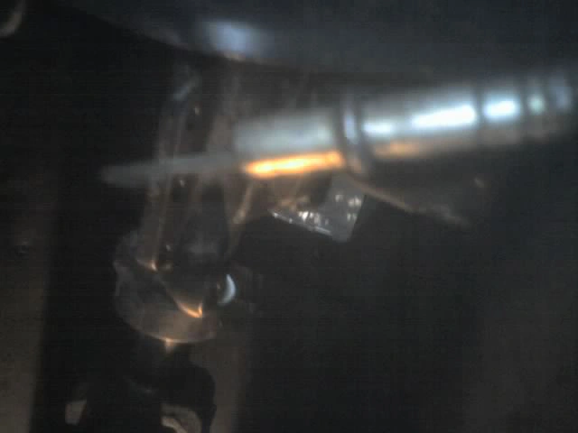

its deffinatly not a new tranny, its the same one that i took out of the car before, also its the same cable.
The cable is the same as it was the day i removed the tranny, this is the way it came out, no gear or anything, i can only assume its still inside the "connecter" piece... it dosent look as your tranny has the connecter im talking about, here are some pics

The cable in your picture is the cable for cars with a VSS sensor. The VSS sensor is for cars with factory stock Mass Air or cruse control.
Speedo cable housing assembly with cruse control
The VSS sensor looks like this:
The speedo gear mounts on the small metal end on the RH side.
The cable pushes into the wiring connector side of the VSS sensor and snaps into place. A spring clip holds it in place: do not remove the spring clip to remove or install the cable. Considerable effort may be requred to remove & re-install the cable. It is made more difficult by the fact you are on your back in a restricted space.
For non Speed Density and cars without the cruse control, the cable looks like this:
Speedo cable housing assembly without cruse control:
This mounts directly on the trans and is secured in place with a stamped steel forklike bracket & bolt.

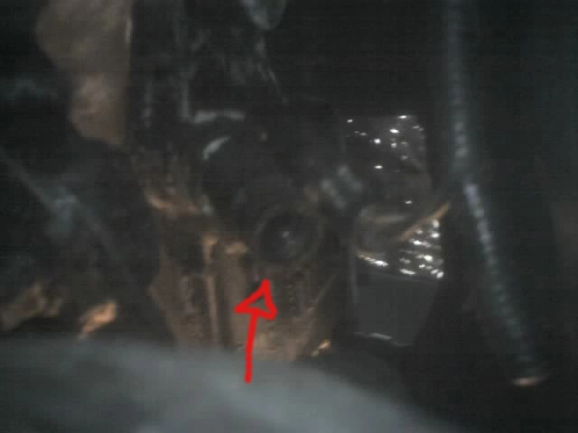

So it seems that i left the VSS sensor on the car (it has cruise control and mass air factory), and took the cable out of the spring clip... so ill have a hard time getting it back in...
But all i really need to do is just push hard enough to get past it, right?

It looks like the picture that you took of your VSS didnt have the clip in it that holds the cable in??
JenkinsBS
Apr 16, 2002
1,001
39
Washington
Sep 10, 2006
  • Sep 10, 2006
well look at that
yah i just checked under the car and there is no clip there!
Ill be going to a dealership tomorrow to see if they have one. Would Shucks or Autozone have those you think?
