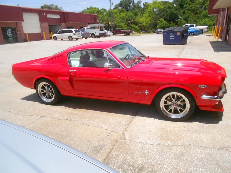

Spi Viper Red 1965 Mustang Painted 9 Years Ago

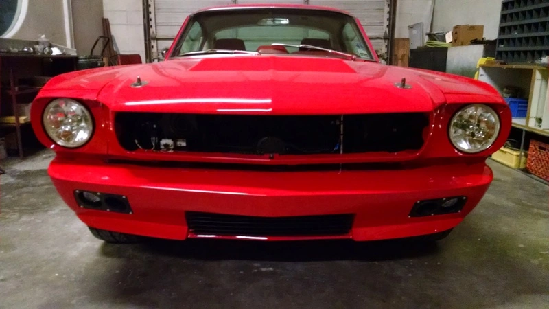

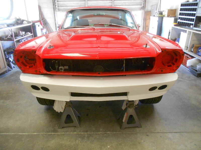

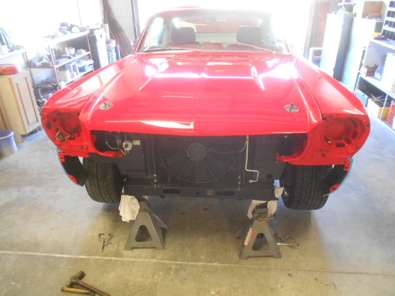

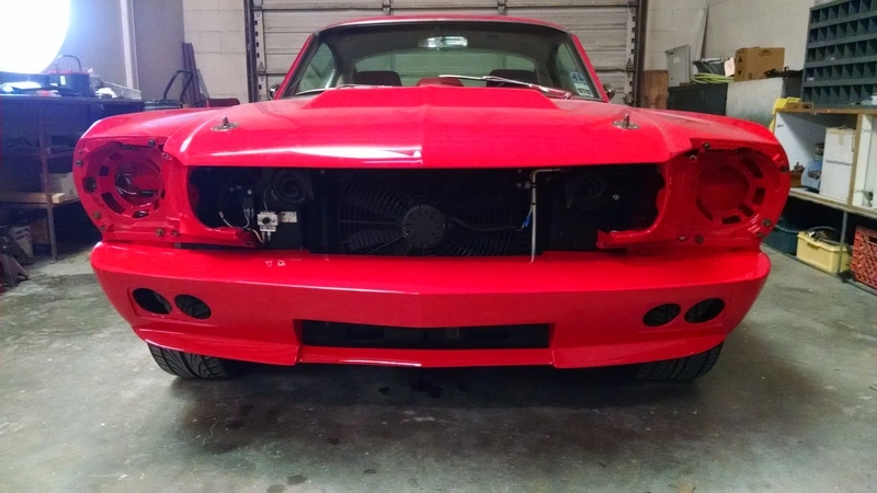

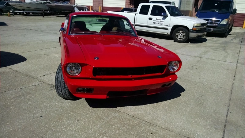

We are going to be changing the front nose and getting rid of the large spoiler

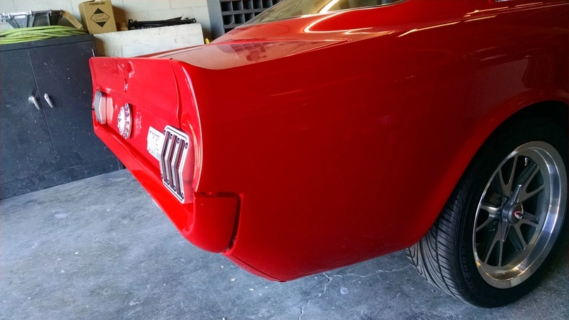

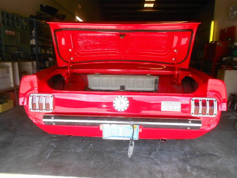

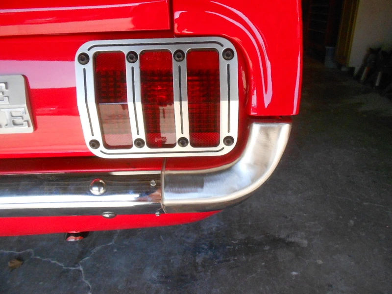

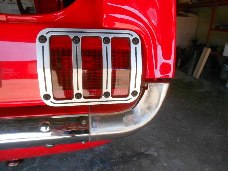

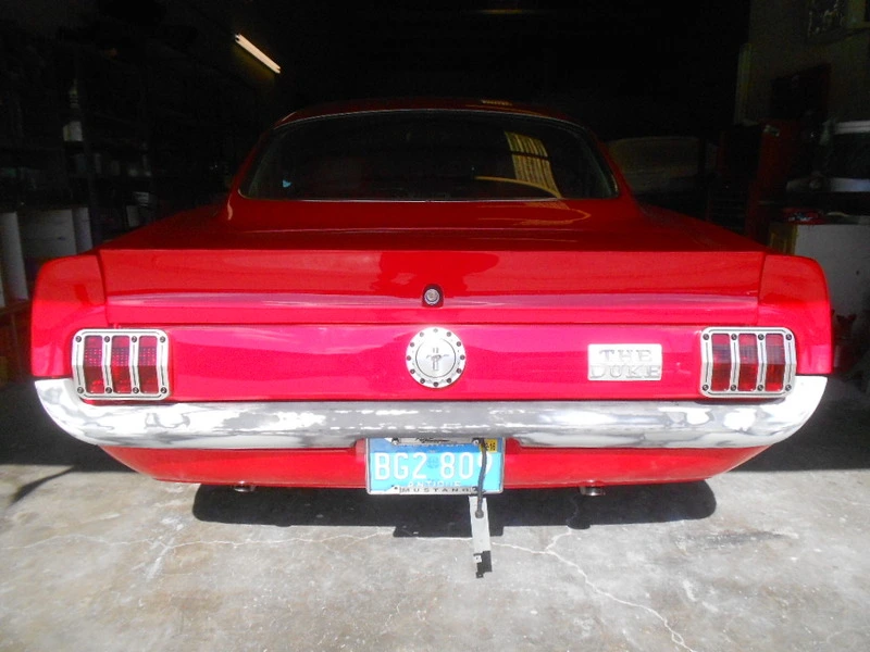

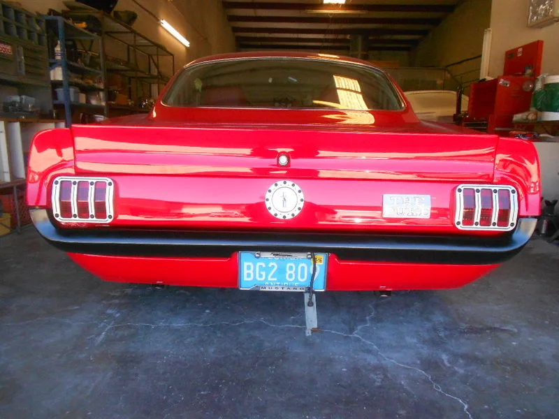

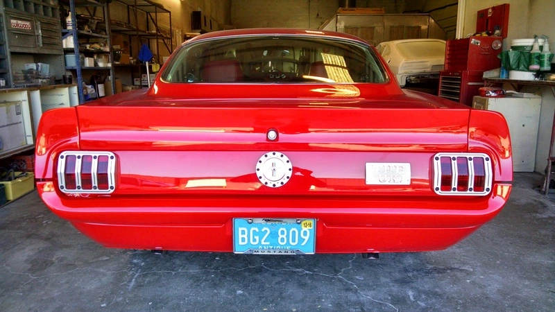

We will also modify the rear bumper to get a better fit and paint body color.

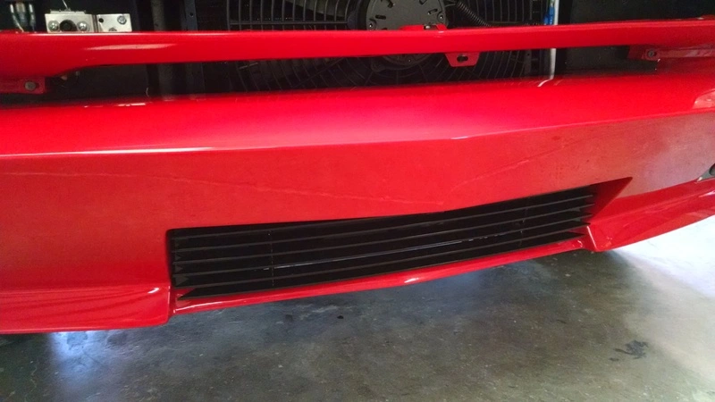

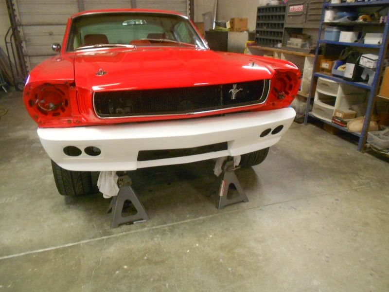

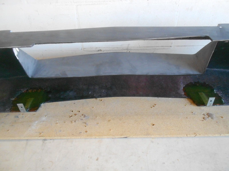

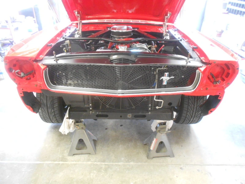

This is the first test fit of the customer supplied Stangaholics front apron. I had to do a lot of fiberglass grinding to clear the electric fan. It still needs to go down on the right side and up on the drivers side.

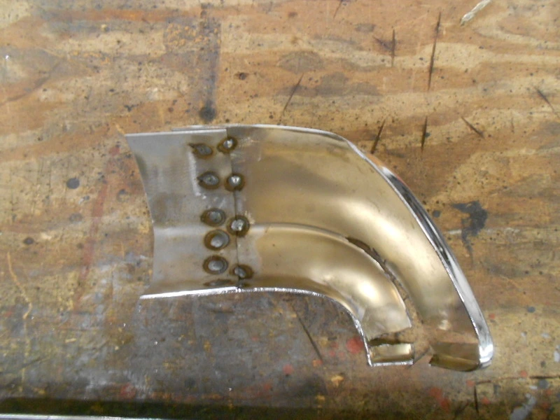

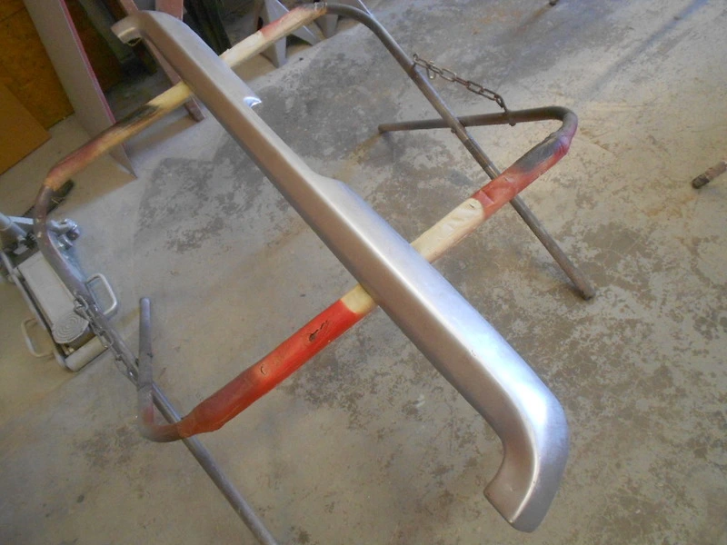

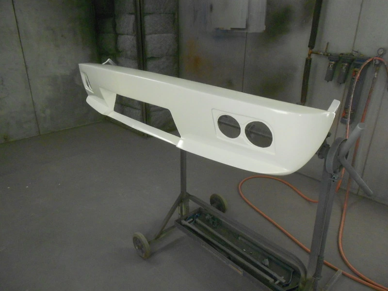

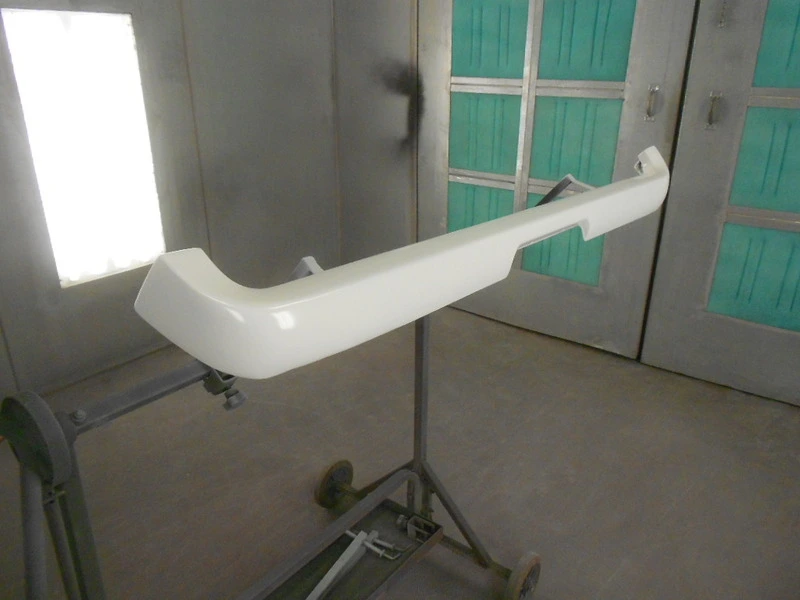

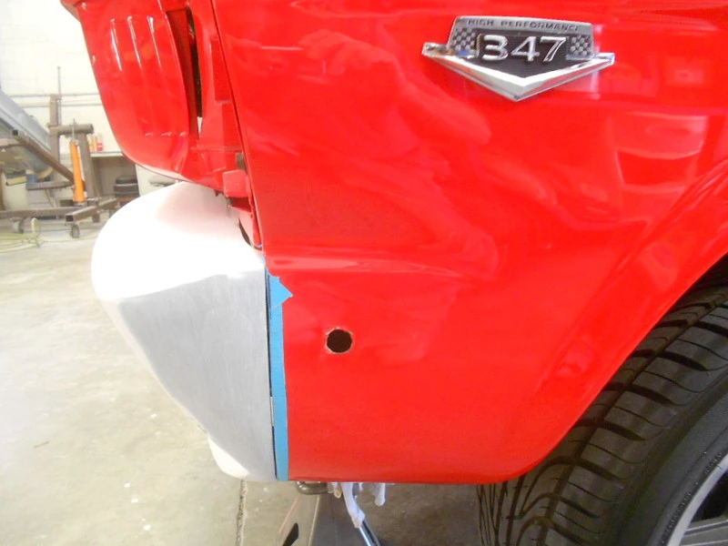

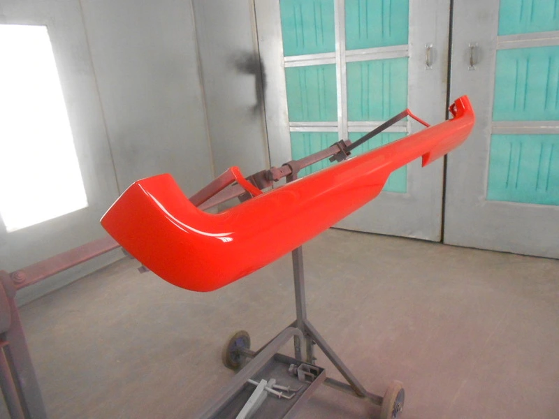

Brian cut the ends off the bumper and lined up the center
Since the bumper was narrow we had an old bumper that he cut out a section and welded to the back

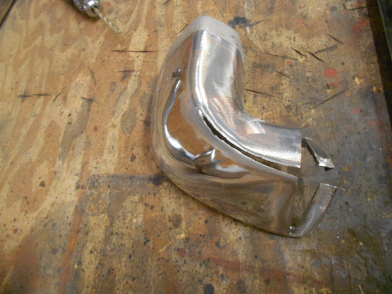

Reshaping the end
Now he can screw it together to test fit
After a lot of welding and grinding

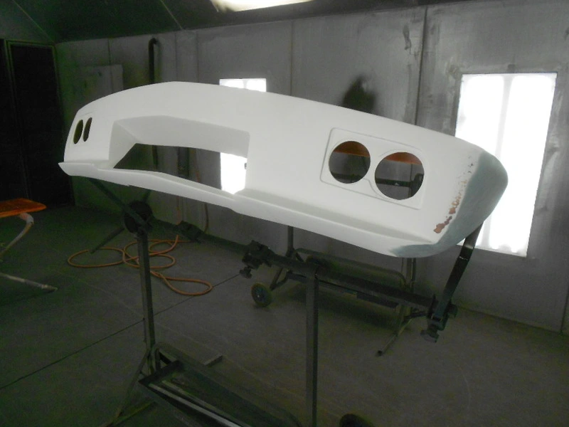

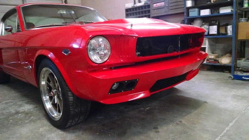

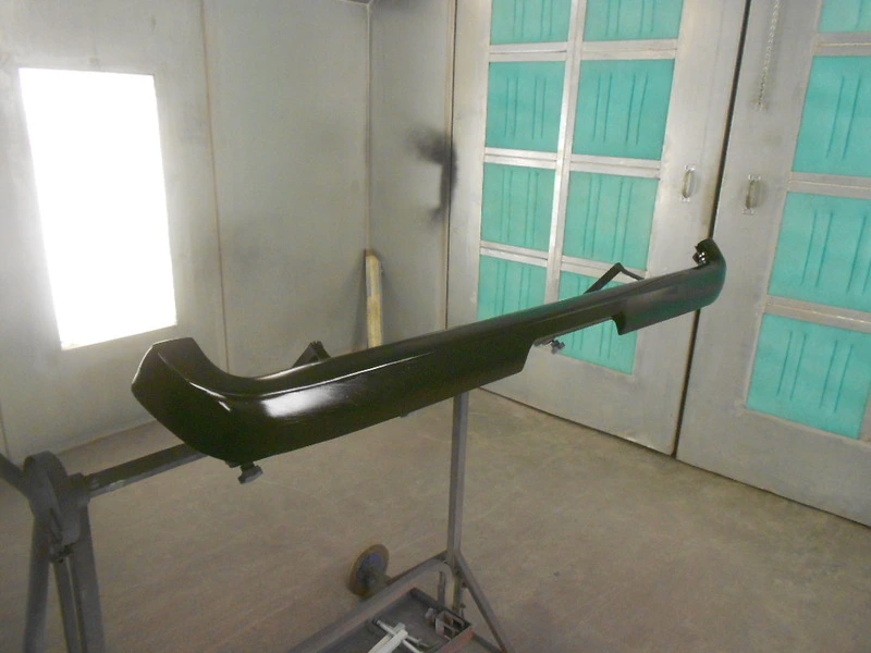

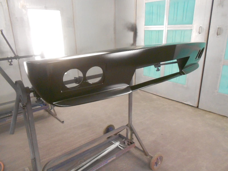

Epoxy primed. Next week I will do a little bodywork
