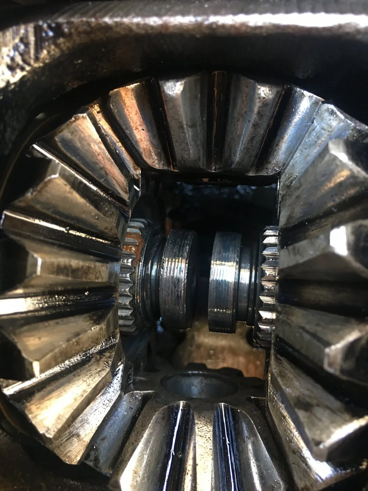

They seem to be a bit worn, and since I’m changing the gears to 3.73 I figured why not a complete overhaul. I will take a pic of them, maybe you can tell me what you think? The clutches I’m pretty sure need to be changed when I spin one side and put a screwdriver in between the wheel studs on the other wheel I can still turn it by hand. Thanks again!

Right on! I ended up having to get a whole new carrier...the spider gears were chewed apart and all the tabs off the clutch pack were broken off so there was major wear inside that diff.
