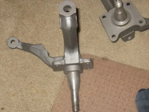

Does this look correct?
I wonder what these are? THis is the casting number from a set I was looking at???
C3DA3108J.
That Drivers sides spindle C3DA 3108 is a 6 cylinder spindle. View the nut on the spindle, will be same size as trhe nut on your Mustang now.
The C5DA are larger, taking the A 2, and A 6 Bearings.
Dan @ Chockostang

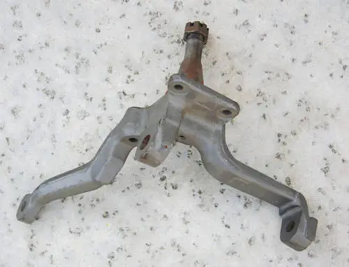

Well, that makes sense. I need to look at the diameter at the end of the shaft. Here is another pic, definately looks like this spindle has a larger nut on the end, so must be a v8 spindle. No casting number though. DO you have any suggestions on the best places to find V8 spindles? I don't think anyone recasts them?
The one in the picture above is C5DA-3107B, so it is a V8 spindle.
I know you can beadblast the majority of the spindle to clean it up before painting, but what about the actual polished area that the bearing goes on? Steel wool?
That is a C5DA Spindle. Polish with steel wool, a wire bush, whatever, check for and imperfections on bearing surfaces, if any use emory cloth, polish out till bearing slides on freely.
