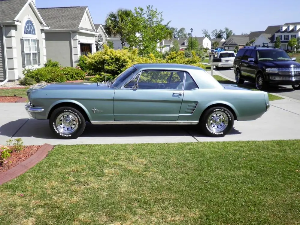

Yes, but when I bought my car the guy had just put a new set of tires on it. And the car has the bullet hole steel 14" wheels. I wasn't crazy about the wheels at first, but they cleaned up nice. I bought 2 matching 5 lug wheels for the back when I did the rear end and have 5 lug rear/ 4 lug fronts lol! So when I do the discs I just need 2 more 14" 5 lug wheels. I bought crager wheels from summit (bullet hole) and they are only $60 bucks a piece plus I always get $20 dollar off $100 dollar purchases from them. So, long story short I have 4 new wheels and tires and I have < $250 bucks in them. A nice set of torque thrust II's, which I may buy down the road in say 15" with tires would probably run about $1200 bucks give or take.
Makes sense. And I think the wheels look good with that paint color.
I appreciate that! I didn't think I would like them, but they have grown on me. They are cheap too, and now I have Crager centers for them so it kind of adds the retro flavor a little. Crager has been around for a long time. I'll probably get something different eventually, but they work good for now.
