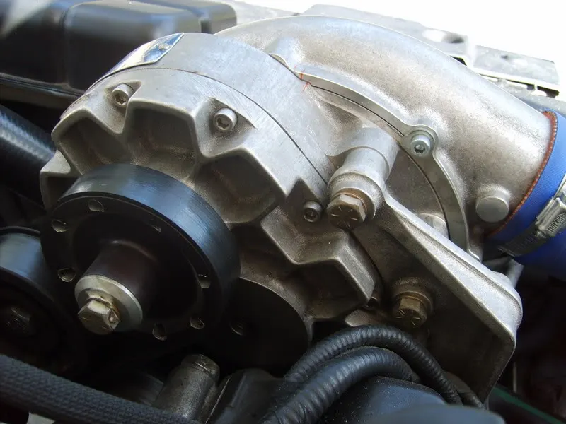

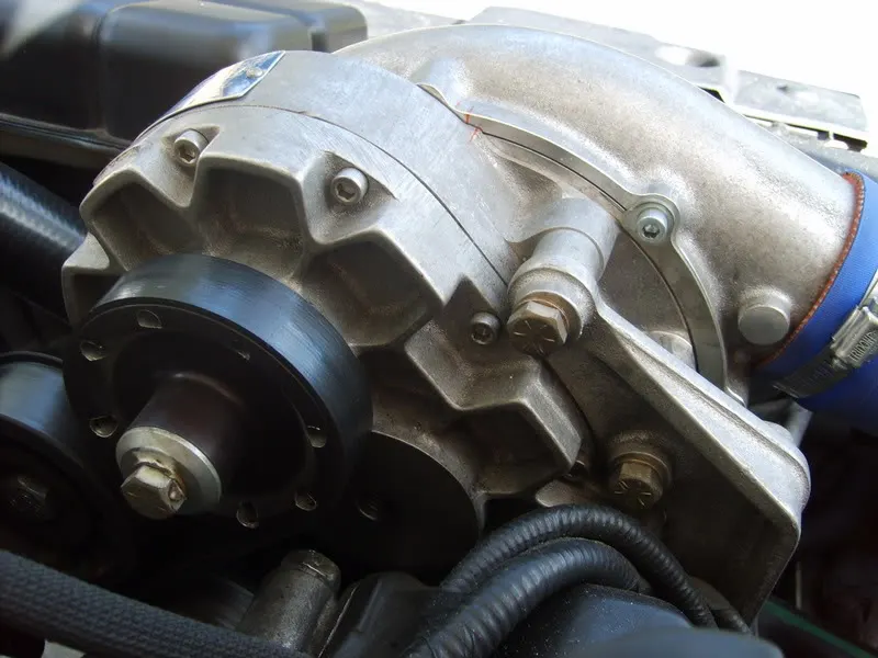

Also, if you're any good with a drill press, you can vent that pulley and reduce the belt slippage a LOT. The holes are 5/16" You want to drill them so that the holes intersect the bottom grooves in the pulley, but not to far out where they totally remove the upper grove material.
Looky:
