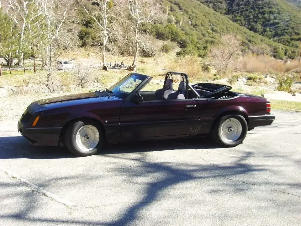

My car and setup:
Mustang 86 - Mach1 Springs
Have fun! That's my advice. I decide my choices mainly from an engineering point of view (and handling in my case). If you're more concerned about looks, then ignore my advice above. :)

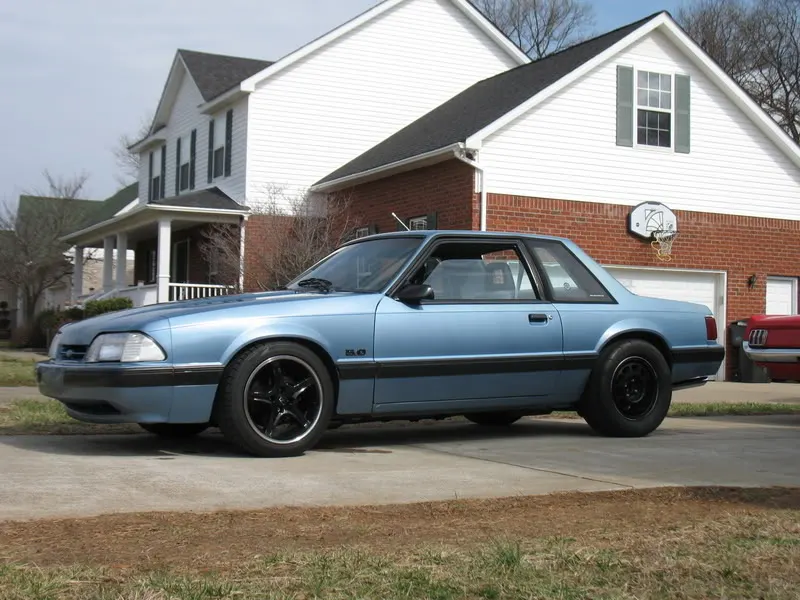

LEAVE EM! Not only does it look badass, but it rides nice and if you dont take the sway bar out, it handles nearly identical to the tired V8 springs I had before. Hell, even without the sway bar it handles JUST FINE. Then again Im used to drivin a 66 mustang and a 77 F100 so what do i know :rlaugh:

66, good looking car, but, that's an extremely misleading post. By no means do 4cyl springs act anything like worn out stock springs. Lets be realistic, you like the drag setup, considering you are using smaller rims in the back than in the front, likely for more straight line traction, so you can let more air out of the rear tires.
It's a well known fact that 4 banger springs act exactly like drag springs, the sway bar changes very little.
KT, do a few searches, and you'll see people here that swap to them for better 60ft times, but make no mistake, they completely ruin the handling of the car.

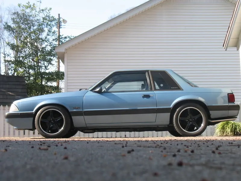

Thanks for the compliments!!! But maybe the picture was misleading, thats my drag set-up...heres how it looks every day im not at the track (daily driver).
But the post most certainly wasnt...or at least wasnt meant to be misleading. In fact, its pretty staight forward. If you want it low and not ride stiff, the 4 banger springs are FINE. With the sway bar attached, it felt NO different than with the V8 springs I had before. Now, with the sway bar removed, totally different story, but like i said, it still doesnt handle as bad as my 66 Mustang and nowhere near as bad as my 77 F100 :rlaugh: Sayin the sway bar changes very little, and this is from personal experience so it may vary, isnt true at all. I notice a BIG difference in not only the handling but also the amount of lift the front end gets when I punch it all the way to the fact that the front tires will rub fender turning into the driveway without it installed. With it, its nice and tight, no rubbing and handles really well.
NOW...if you want an all out handler, get some lowering springs and thicker sway bars etc. If you just want it low/mean but still ride awesome and handle just as good as before, keep the 4 banger springs in there. If you want to be able to launch better at the track or just like a little bit better weight transfer all around, again...keep the 4 banger springs.
Take the above advice as you please, do not discredit anyone else's advice for its all valid, but im just tellin you how it actually is on my personal car from my personal experiences.
