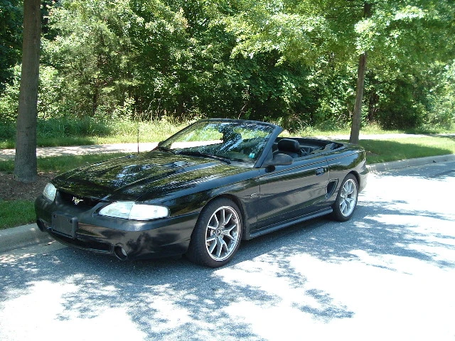

i have bbk uca/lca and i am happy with them, very little hop. $300 at summitracing. i also have intrax springs, about a 2" drop. i love the look and the ride is still ok (ie-not too stiff). here is how it looks:
