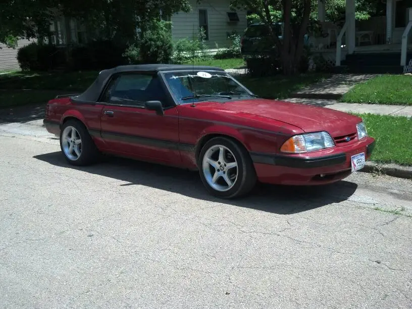

I put the "b" springs on my 2.3t swapped with v8 suspension. Didn't notice a rake at all. I have SVE lca's.
