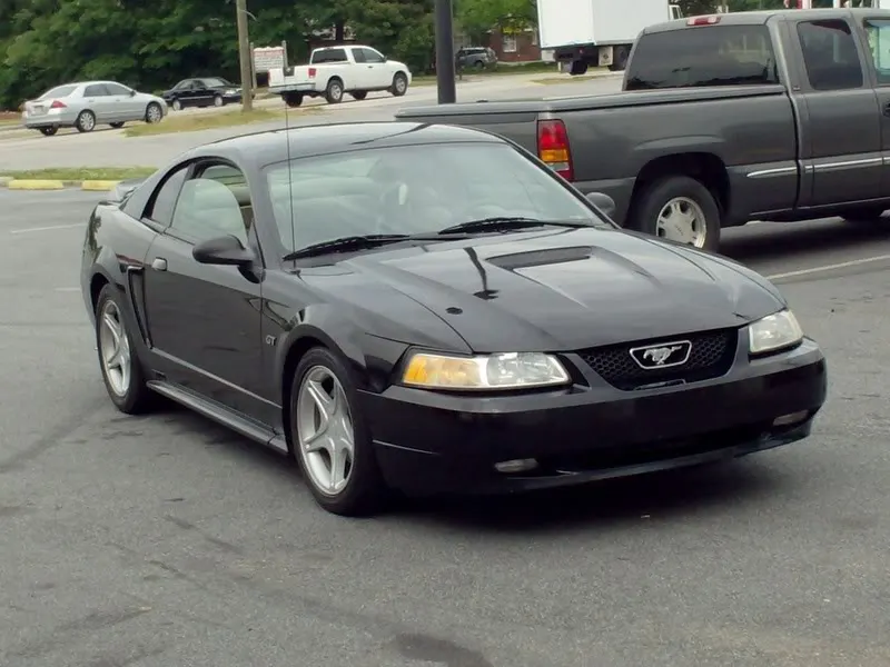

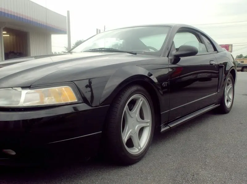

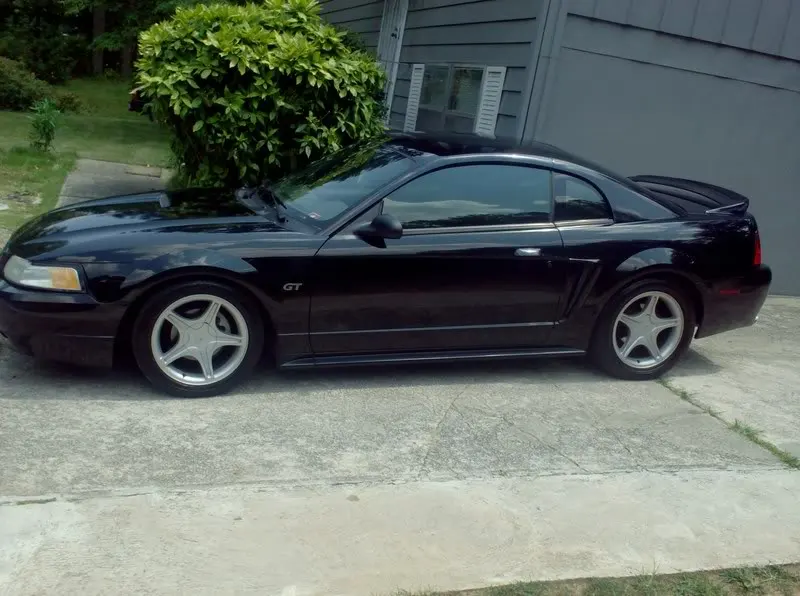

  • Jul 7, 2008
5.4ever said:
Im in the same boat, but want 2 in. drop. Come on yall lets see them pics..
..I can help ya' out. 2" drop is the only way to go, everyone with these rediculous 1.2 and isht drops that i know in person hate that they wasted their money and know what they want to do the next time around

JBauer, is that a 2" drop on your coupe? H&R Super Sports?

I installed eibach prolines for a coupe in mine. they have a slightly different spring rate(softer) than the ones for a conv. plus I wanted an extra 1/4" or so more drop than what the conv spring's spec's were. I like them and would not want to go lower,rub some speedbumps on trans crossmember now
No, sportlines

Jbauer said:
No, sportlines
i have sportlines and my ride isnt that low. although i still have my isolaters

Yea, take the isolators out. IMHO, NO KIT, none at all is low enough to make the SN95 look nice, unless it's sportlines w/o Isolators.
