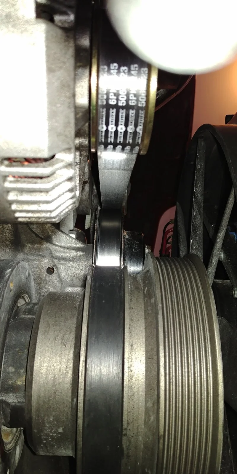

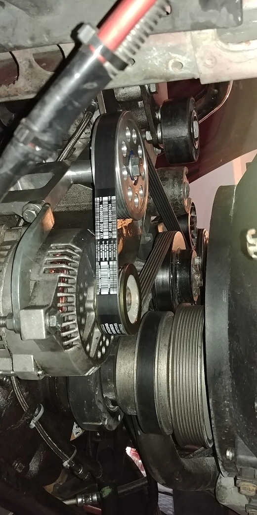

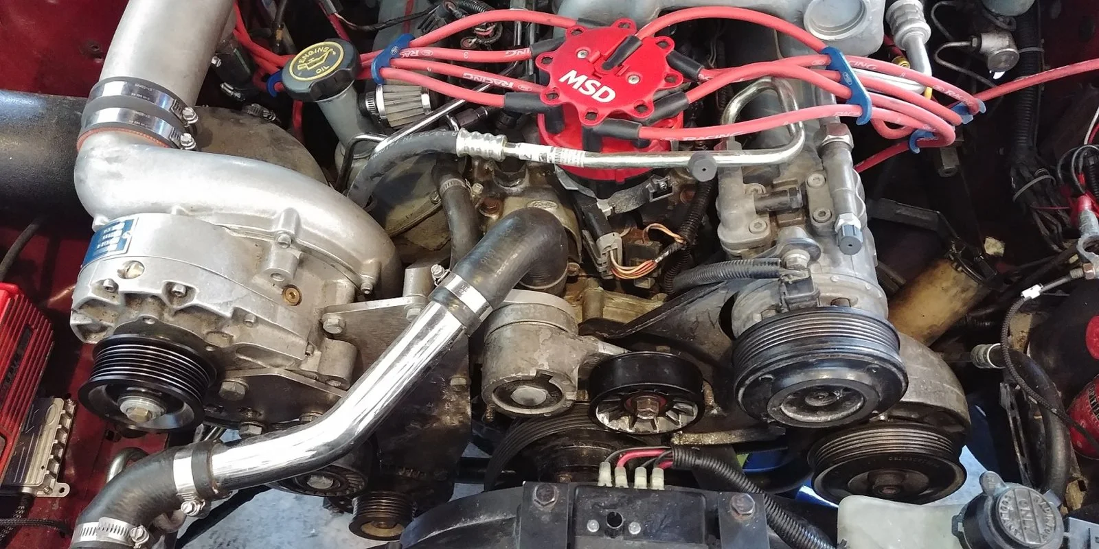

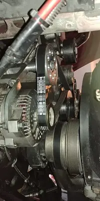

Hey guys, I own a modified 1992 5.0 Vortech Supercharged Notch.
I did not install the supercharger.
I'm having a squeaking belt issue.

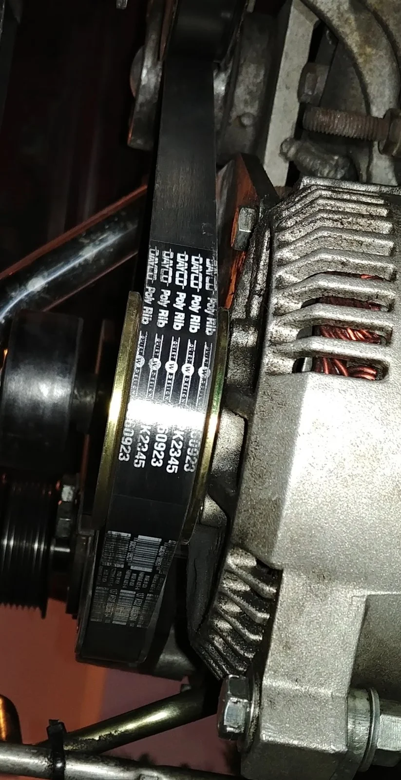

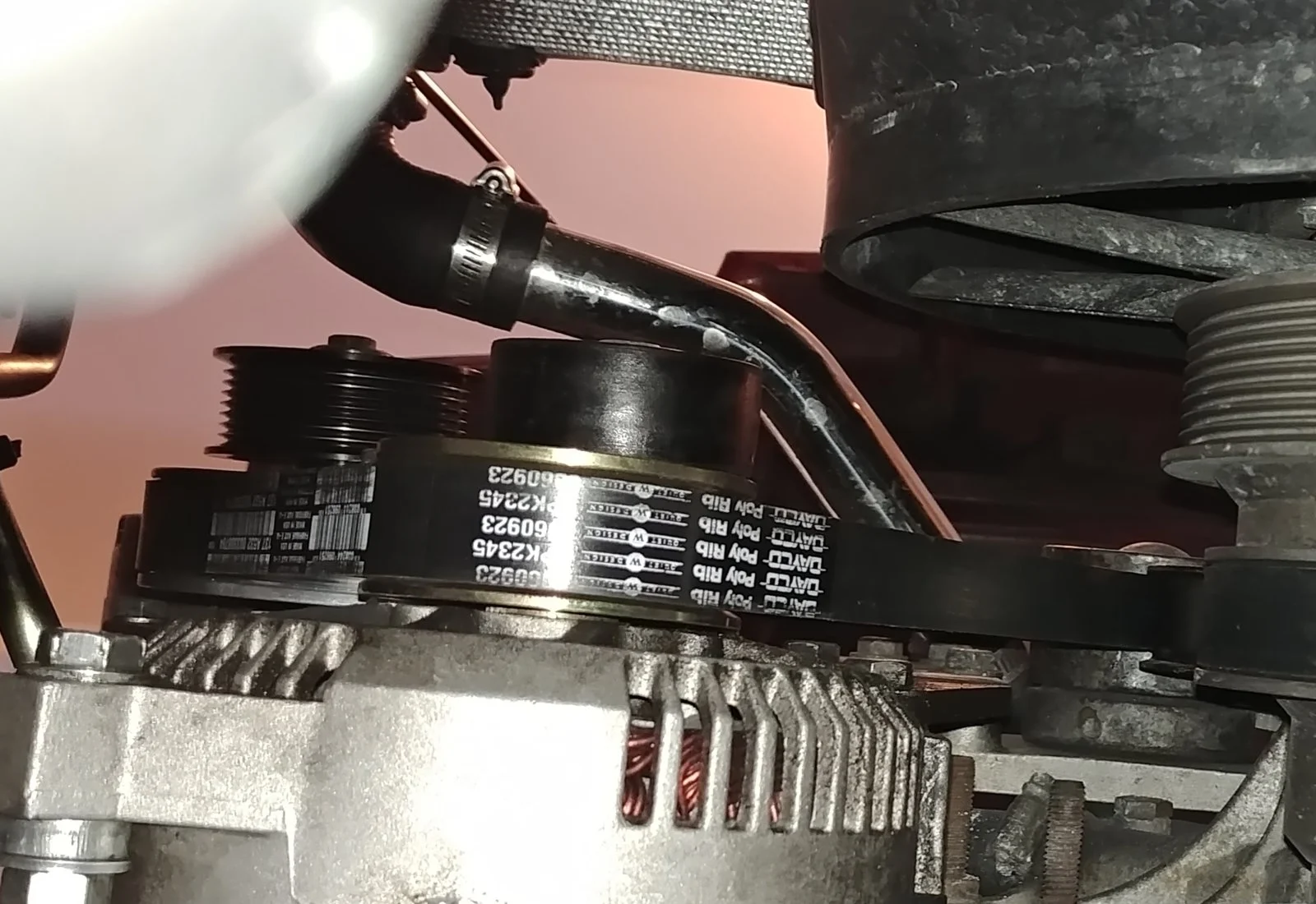

Under some investigation I found that the aftermarket 130a alternator is pushed forward / not aligned properly with the rest of the cars pulleys. And the belt is rubbing on the crank pully and smog delete pully.
I just replaced that smog pump pully because the bearing in it was going out and thought that might have been related to my squeaking belt.
After looking at the pictures what would you do to try and remedy this? I'm thinking taking it part and see if anything is bent/shimmed/loose?
Appreciate any input.
Thank you! 20180528_161627.webp 20180528_161432.webp 20180528_161258.webp 20180528_161456.webp 20180528_155919.webp
Some of the older alternators had a shim behind the pulley, don't know if the 3Gs do or not. If there is, pull it out and check for clearance.
If you had the clearance to moved the pulley closer to the alternator and there's no shim, you could find somebody with a lathe and have some material removed in the hub or somehow shim the brackets back to get it aligned.
Sometimes it's a real pain to get things aligned properly.

A laser isn't a bad idea. Problem is is different pullies have a different measurement from the front edge to say the first rib. If you have a good longer straight edge, you could put it on the crank pully and swing it around to each pully and get a measurement for each one to something like each first rib. It can be a real pain but I've managed to get them aligned on all my builds no matter how weird the setup.

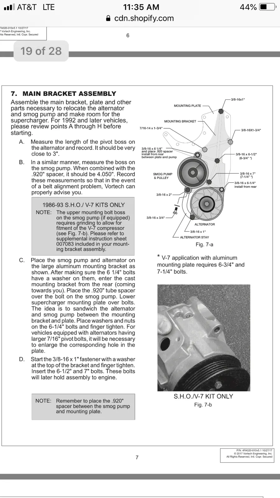

Check the Vortech directions . There’s a shim that goes in between the brackets and that can cause your alignment issue .
Now If someone put a fox pulley on that and used a washer to keep the pulley off the body then that’s the next issue . 94-95 had there own specific alt pulley that Is the same diameter as the original fox pulley . 96 and up was bigger .
