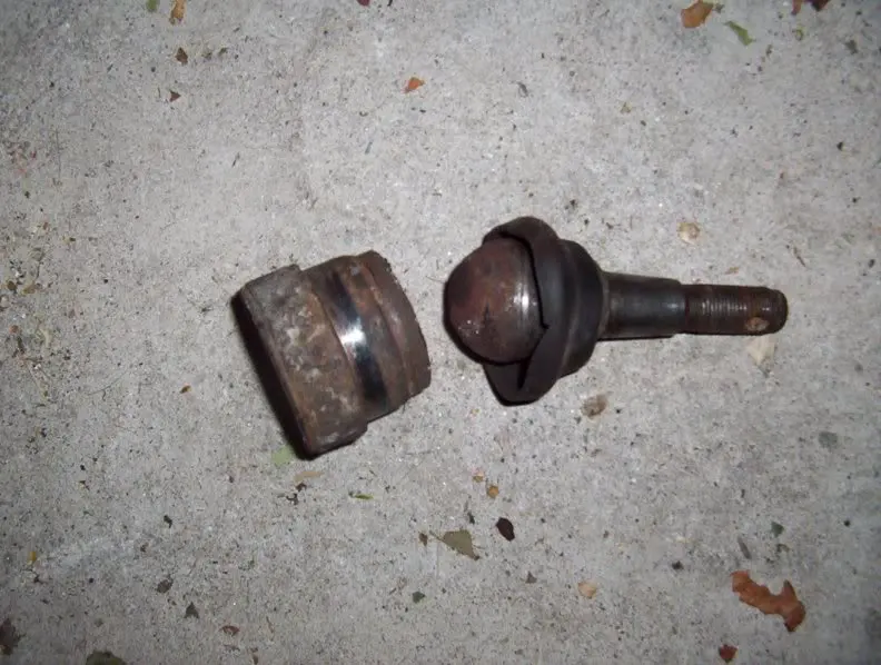

i had the exact same problem, it was the ball joints. you wanna know how i found out it was that? look at this pic, imagine turning into a parking lot and hearing the noise get worse then park the car, turn the steering wheel and see your front end hit the ground, no joke i had to get my dad and my buddy to lift the car up so i could get a jack under it. i ended up shanging it in the parking lot
