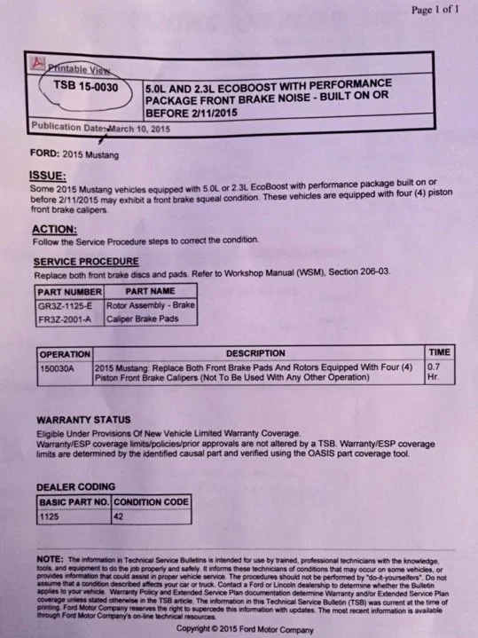

I have had my 2015 Premium Eco Boost since January now, and it has somewhere around 5000k on it now. I thought the squealing brake issue would go away on it's own, but alas it is still around. It only does it on soft breaking scenarios, but it is REALLY loud. I took it to the dealer to take a look at it but they said that everything was good and gave it a clean and sent me on my way. STILL SQUEAKS!!!! Anyone know a remedy for this?? Thanks
