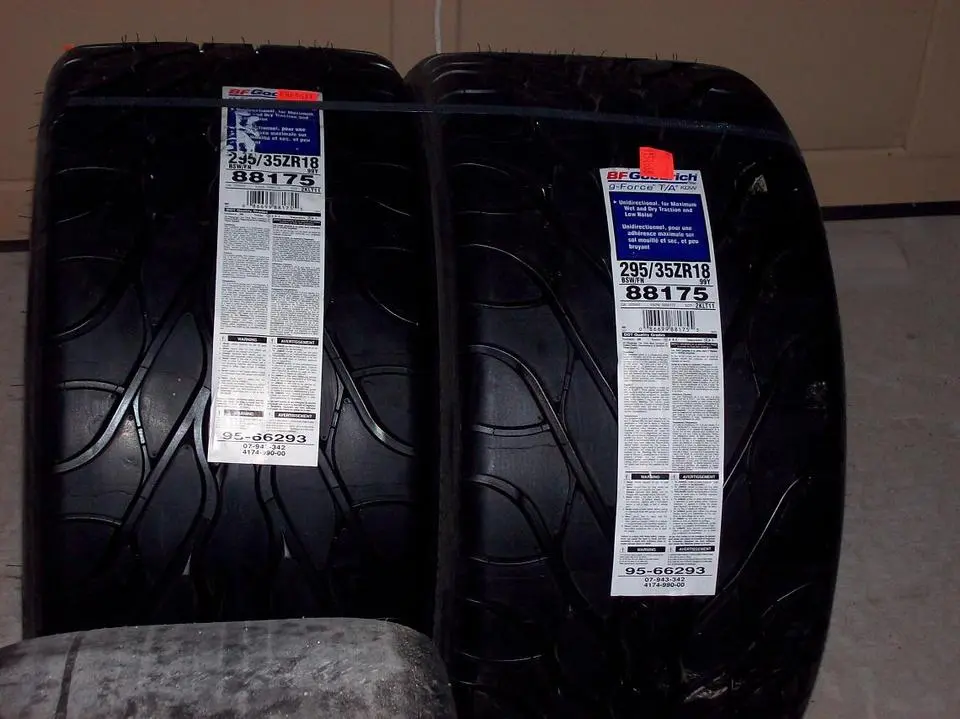

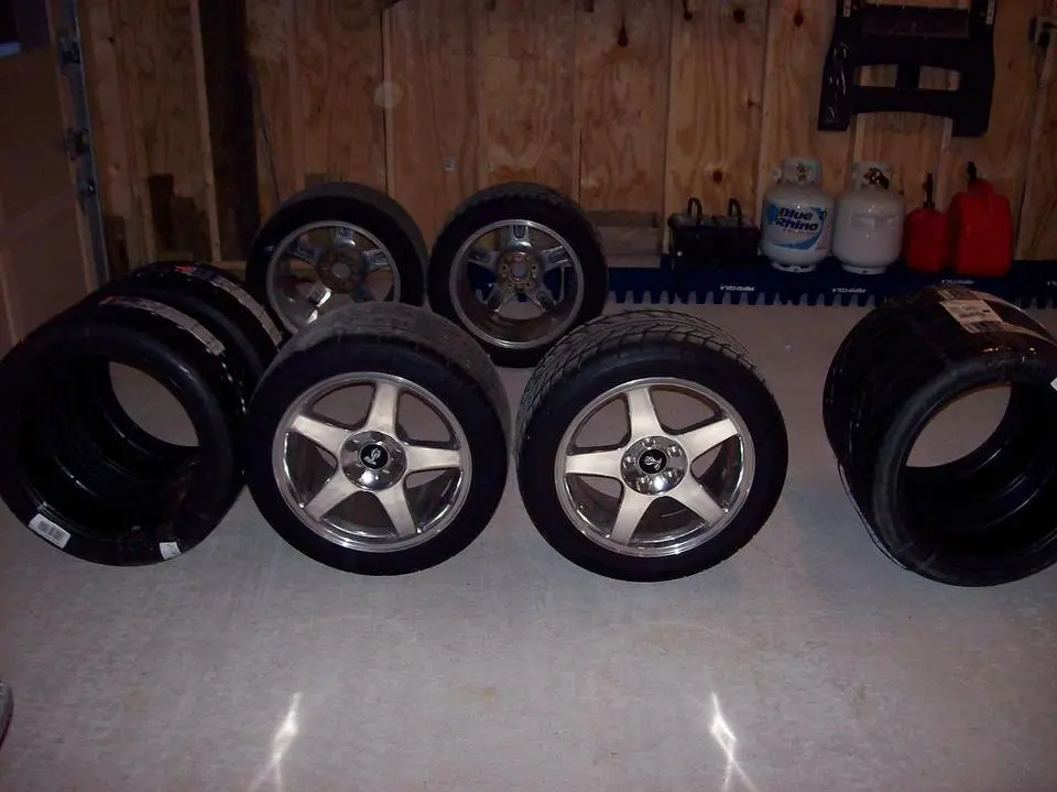

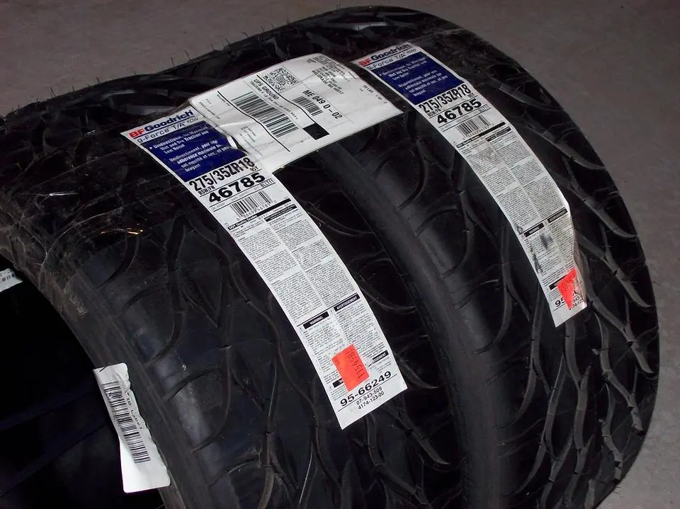

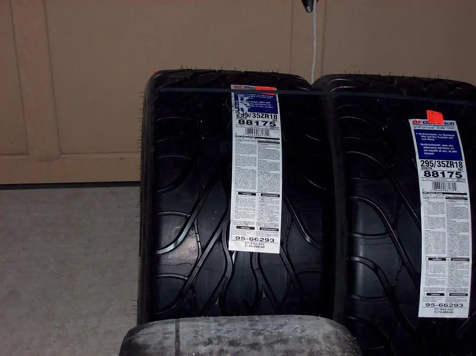

New tires are in guys. I am taking them to get mounted today:D It does not look like it here because of the angle, but the BFG 295's are actually just as wide as my Nitto 315's

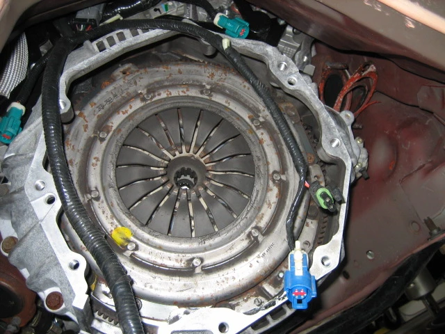

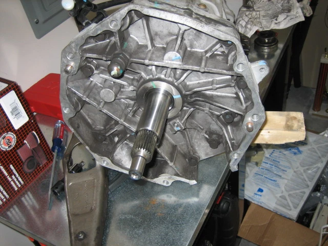

Well the Clutch is swaped, and the input shaft / TOB sleeve is in. Tried like hell to get the trans back in, but that thing is a beast! I will get it in tomorrow. I was just too damn tired to keep struggling with it by myself. Pics:
Drive shaft out
Prochamber on the floor
Trans on the bench
look closely and you can see the stock TOB sleeve warped
Stock clutch ready to come out.
