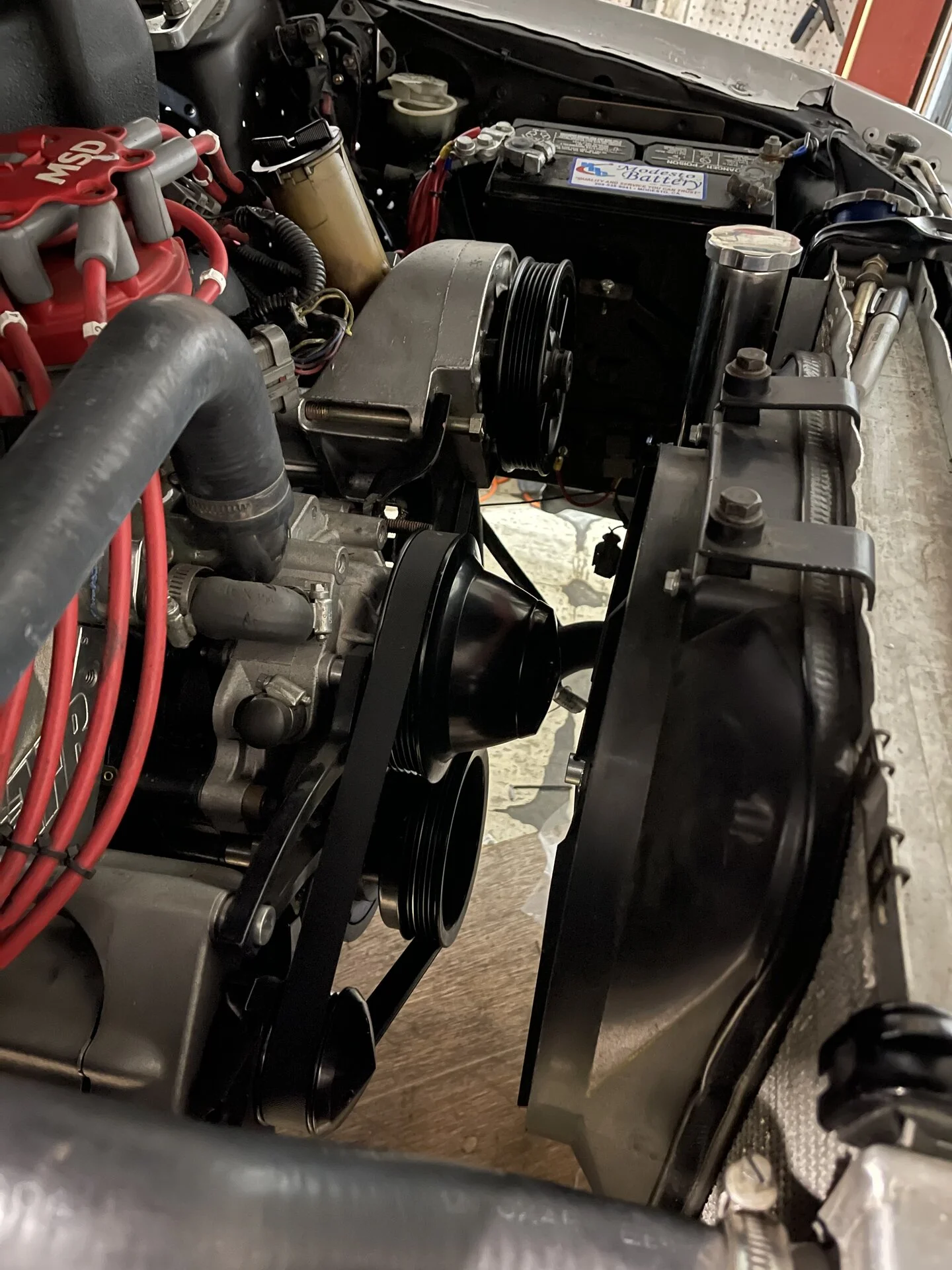

As you can see in the photos, I tried to mount the power steering pump with bracket. But my pulley is too far forward and doesn’t line up with the rest of the pulley. So I’m looking for an alternative.
I think anyway you do this is gonna be expensive. The pulley setup is shorter than a fox setup, which is why you have the misalignment issues. You either need to convert back to full fox accessories or run a custom pS setup. What timing cover is on the car? Curious if they swapped to the correct timing cover or just use the existing.

I’m not too sure about the timing cover. I don’t mind switching back to Foxbody accessories if need be. Which would include timing cover and water pump correct? I have the ac delete Foxbody bracket and ps pump bracket. Would that work? Or would I need more parts? Looks to me that this car is running March performance pulleys.

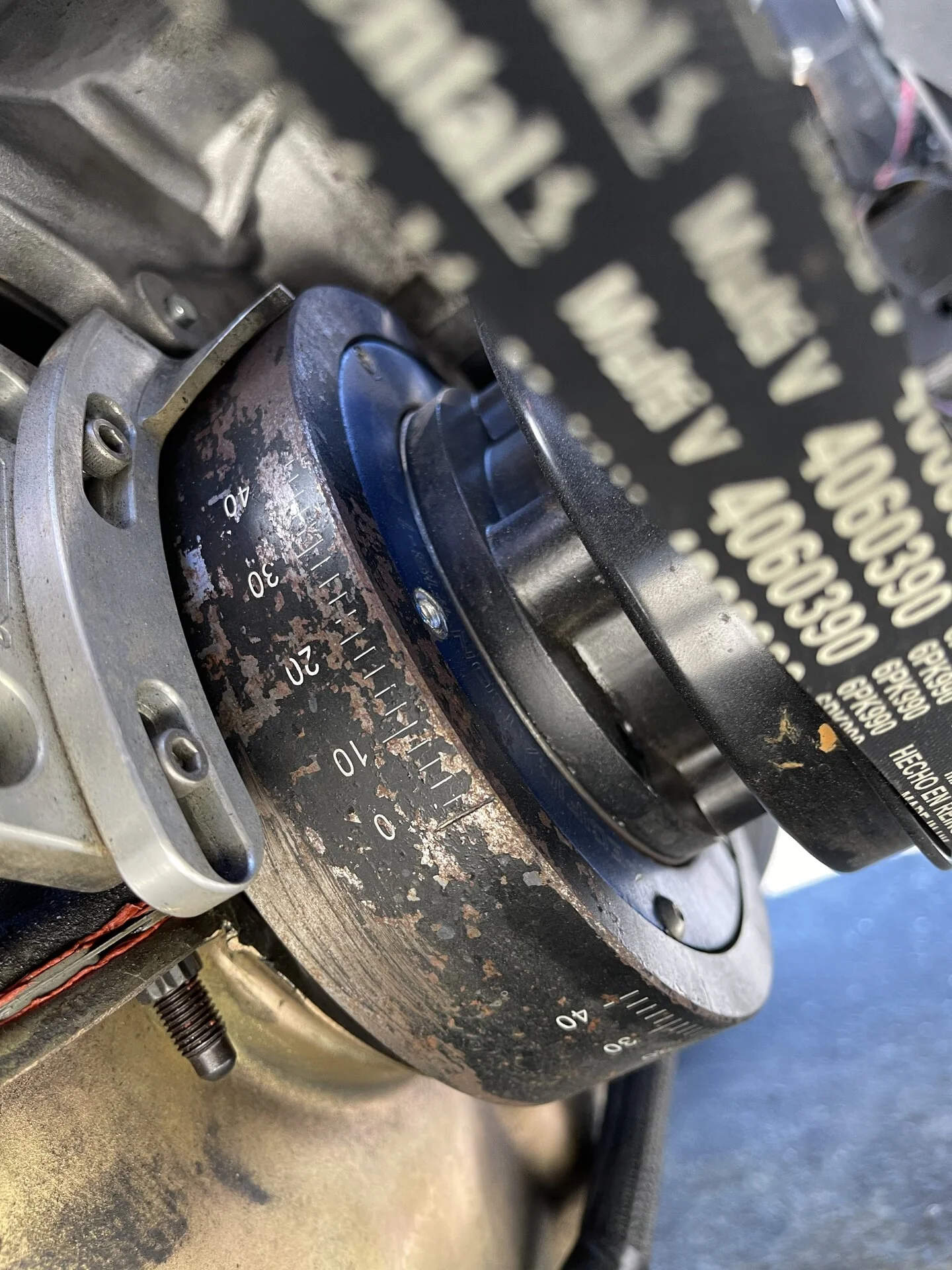

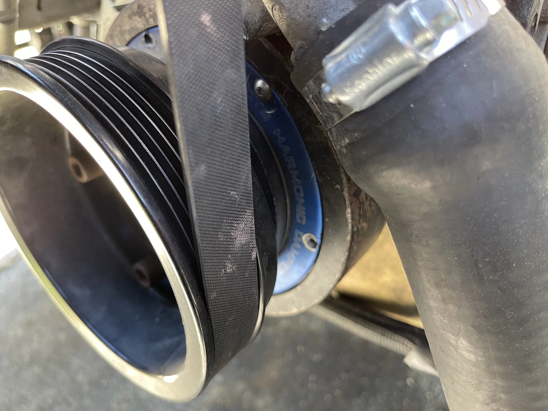

What’s up guys, these are the best photos I can take of the harmonic balancer. As I was using my phone and taking a photo from the top. What do you guys think?

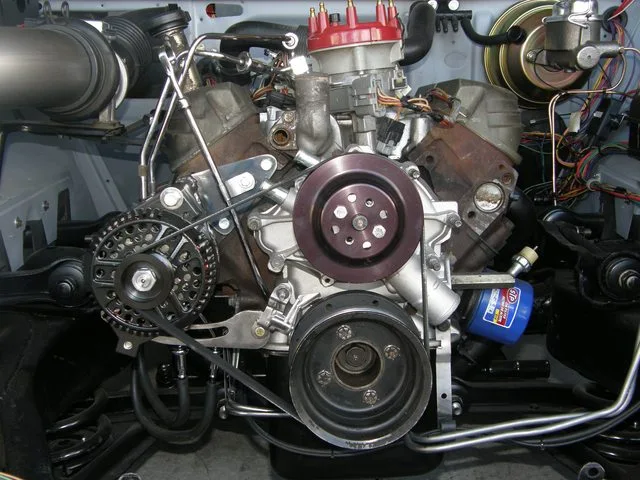

On a side note, if you need the accessories.....I have them. On my '93 I removed the reverse rotation w/p, timing cover, smog pump, p/s, a/c, alt and all the brackets. I replaced them with a '70 timing cover, standard rotation w/p and 130a alt. I went from this.....
To this. LMK.

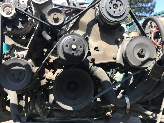

Check your local salvage yards for an early 80s Crown Vic or Grand Marquis with a 302. They were serpentine, standard rotation water pump, with power steering.
That's what I robbed the pulleys off of for my Mustang II when I switched it over to serpentine.

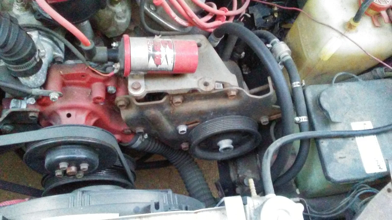

Unfortunately the only picture I can find is from after I took the belt off when the 45-year-old steering rack puked all it's fluid, but you can see what it'd look like.
In your case, you might need a different bracket as well, you'll have to measure.
Well, If I decided to switch to fox everything, what size spacer would I need for the balancer. I found it is a Professional Products 90006# balancer. From what I can see on the photo I took, it looks like it’s running a spacer already though.
That balanver is missing some screws on it. You'll want to address that before you have a failure at RPM with it.

You can reuse that balancer, but you'll want to address the missing hardware. I can see two screws missing on it in your pic. I believe you can reused that spacer.
