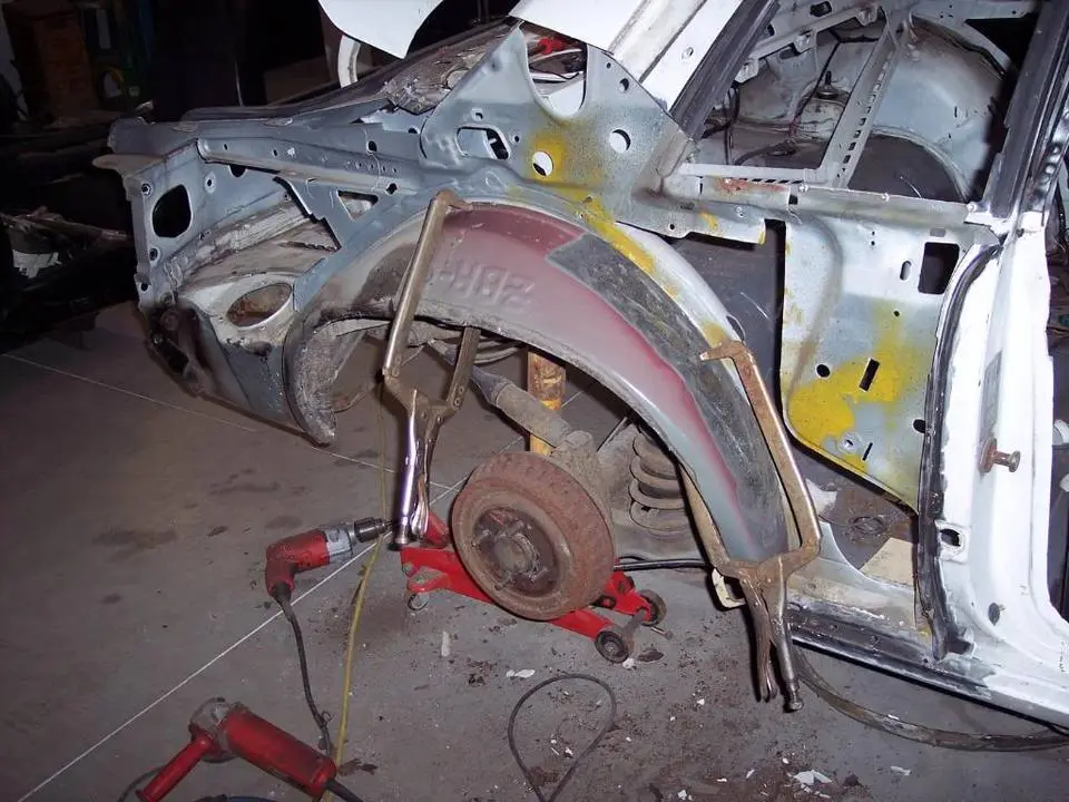

Started the 84 t-top coupe

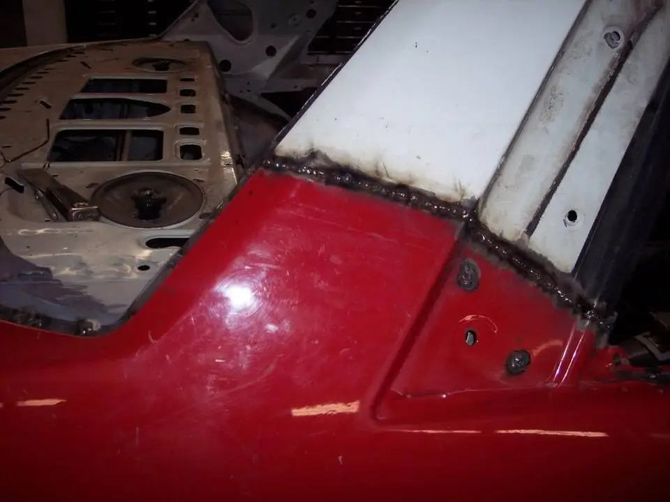

a little more progress, one step forward and alot back...

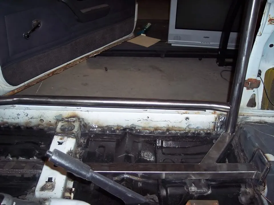

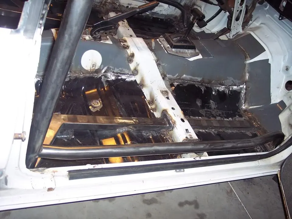

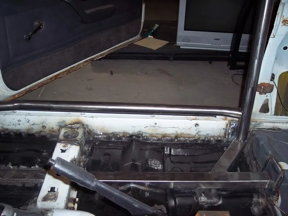

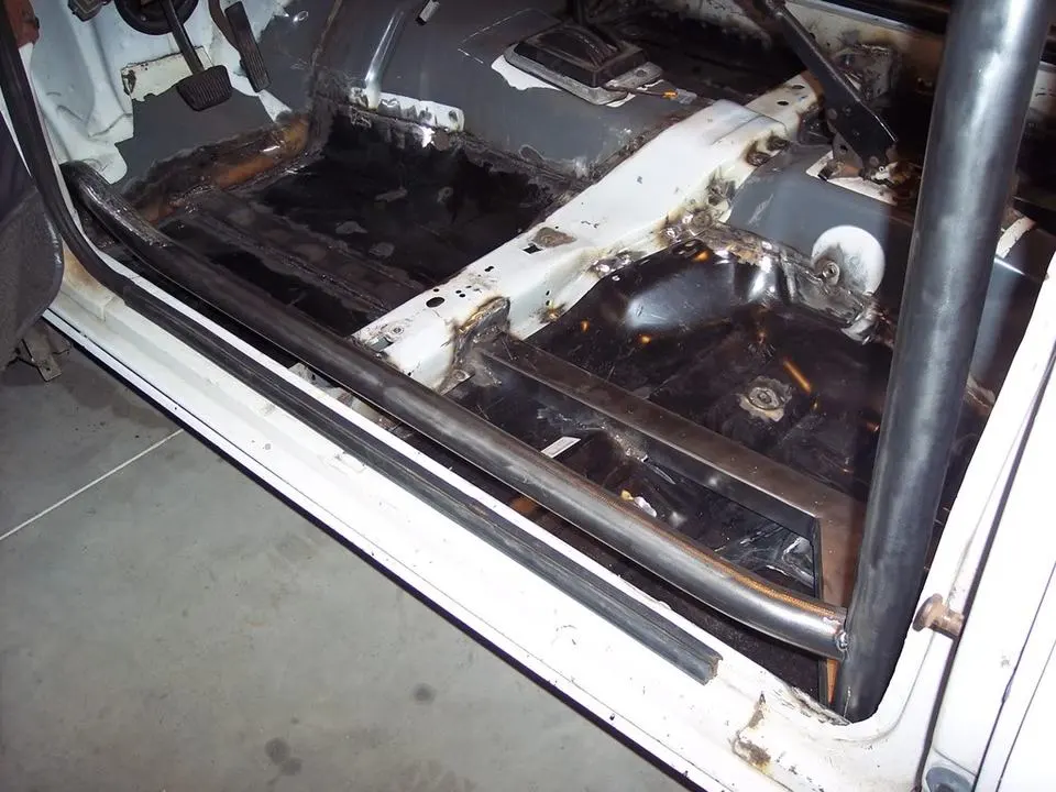

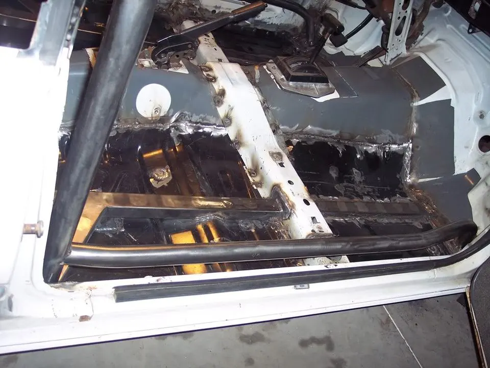

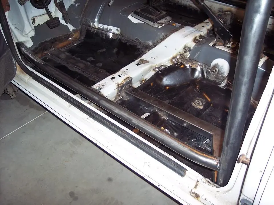

Got the forward supports fabbed and tack welded in for the street cage...

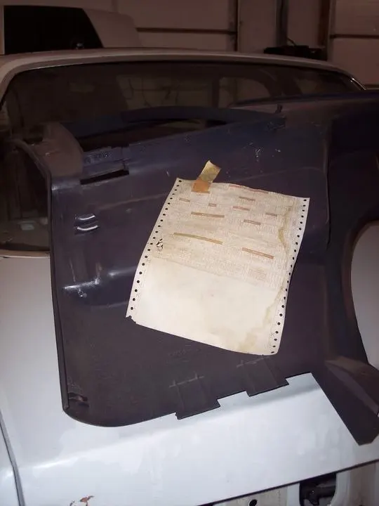

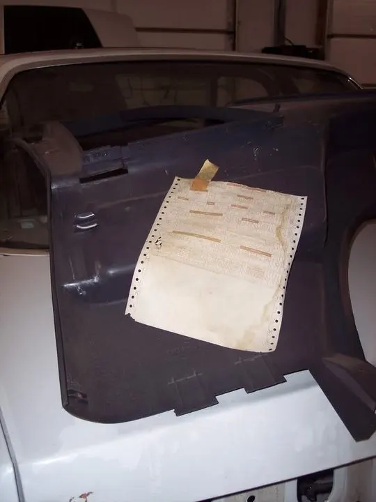

found the build sheet that was pretty cool

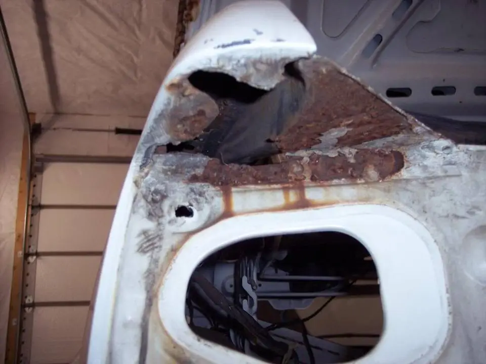

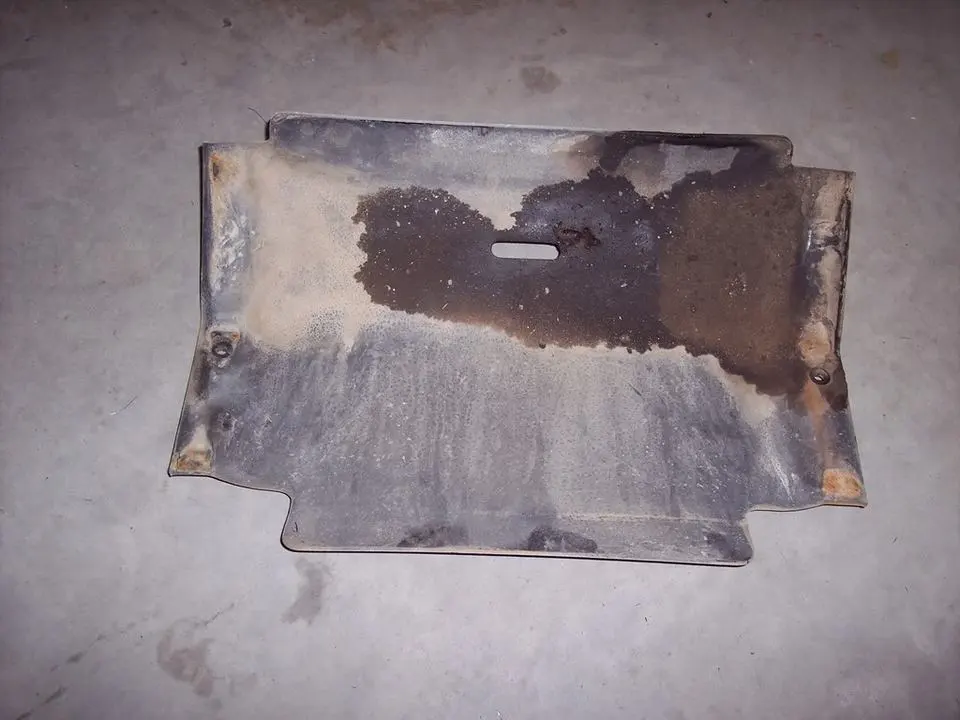

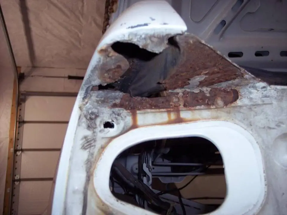

rear bumper support will need a replacement as well as fuel tank(that was gonna be custom anyhoo)

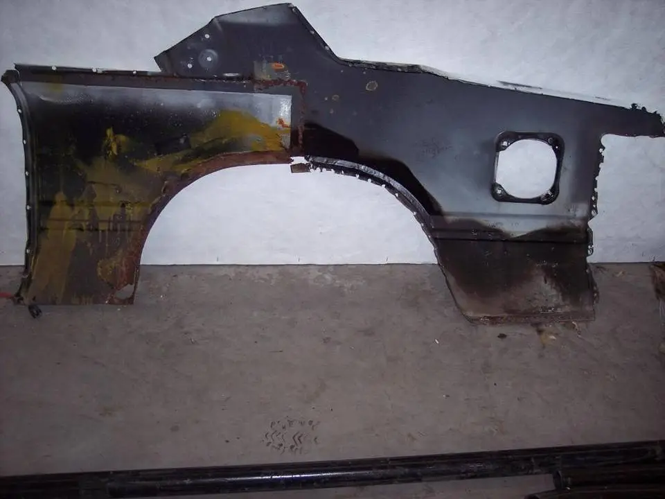

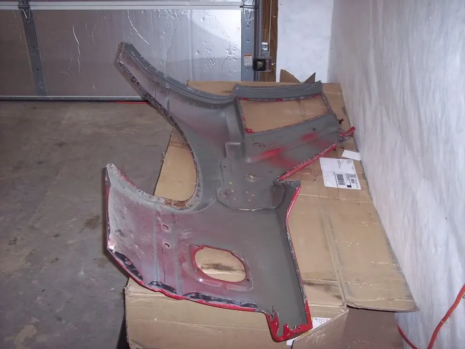

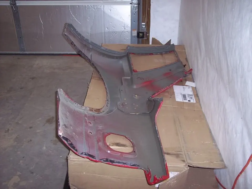

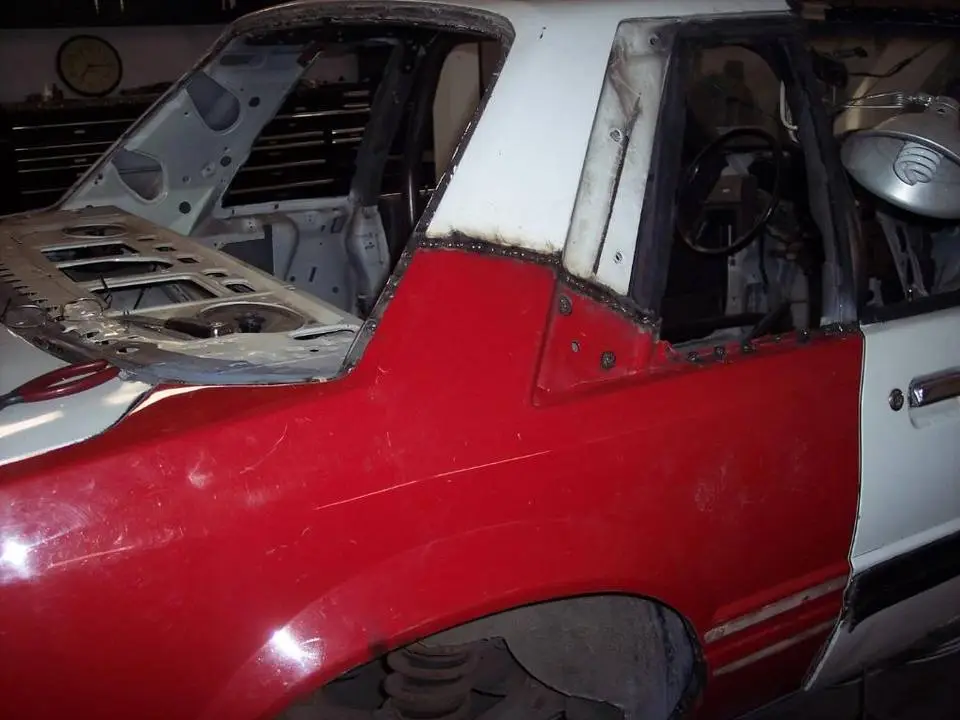

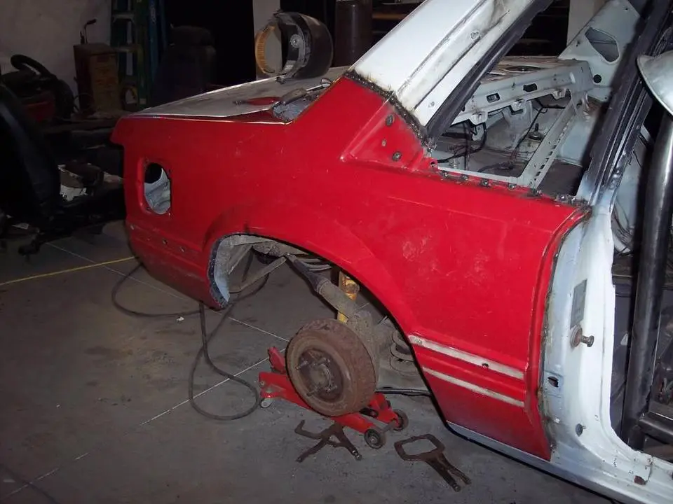

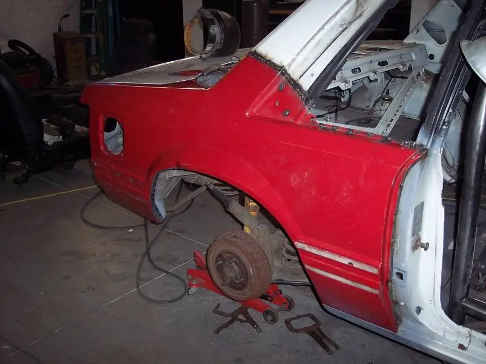

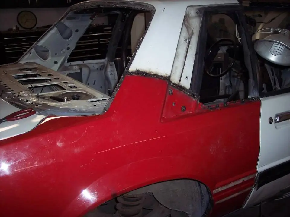

Got replacement quarter outer skin off donor quarter

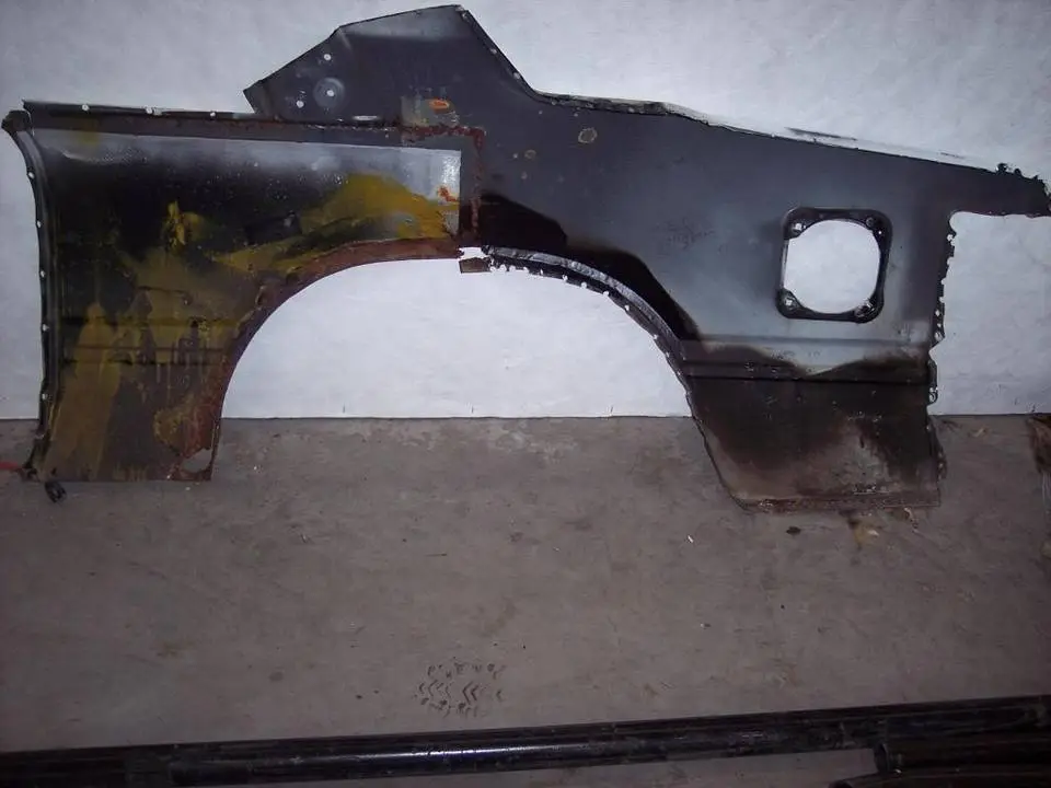

Got replacement quarter skin off and ready to go
Just for the recordthiswas all Julie's idea, God knows I'd do anything for her, this will be a real testament to that. She knows how to pick em doesn't she!:lol:

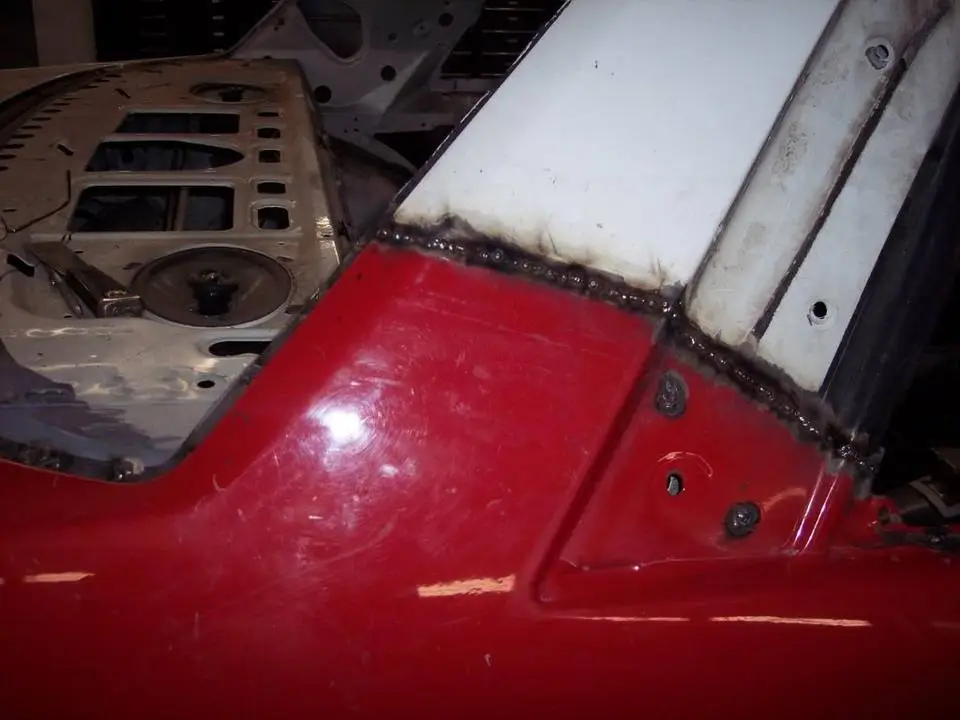

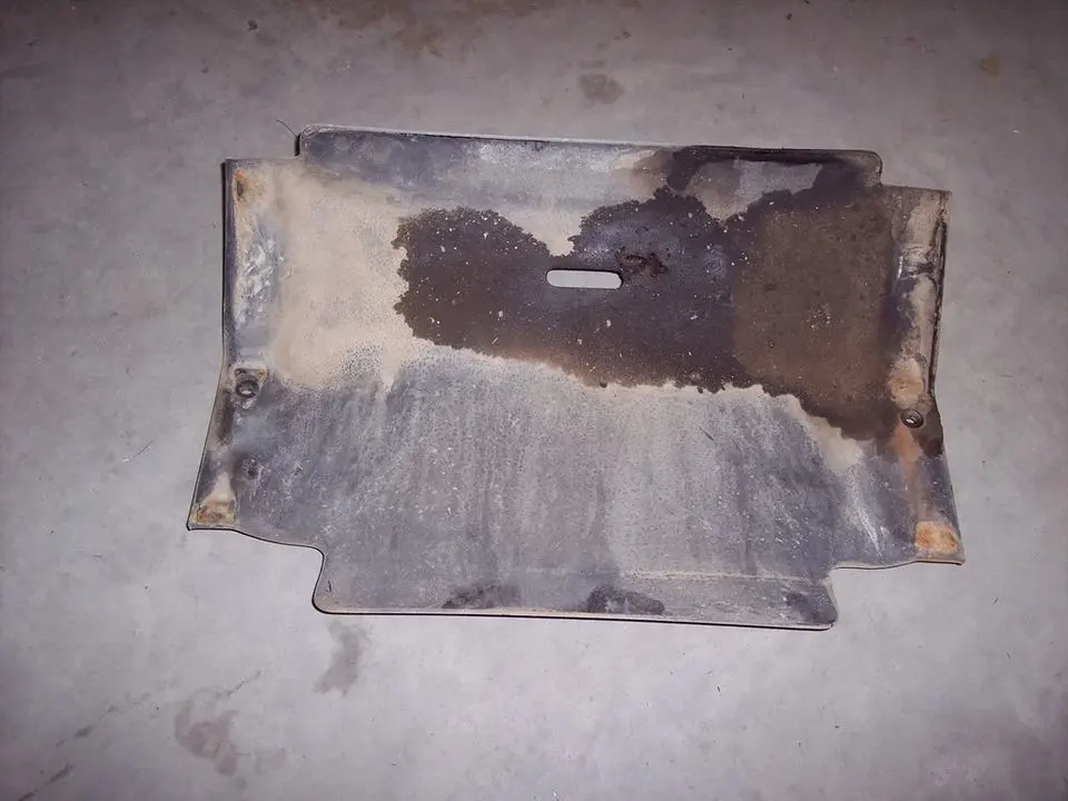

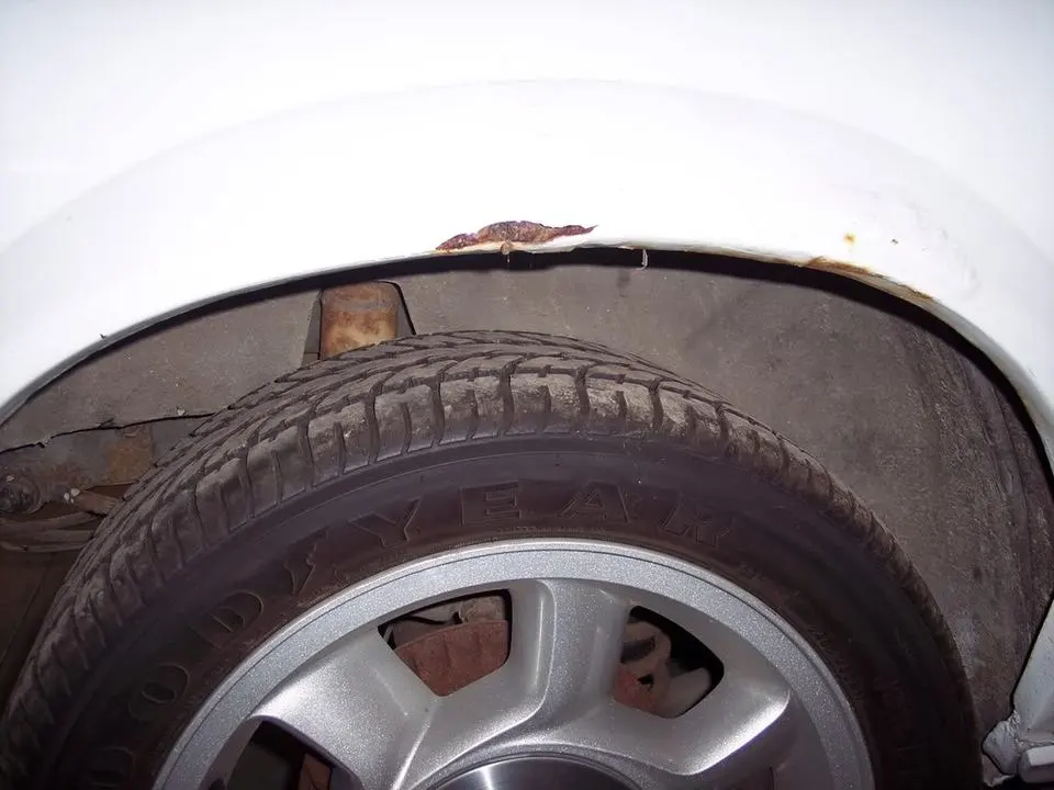

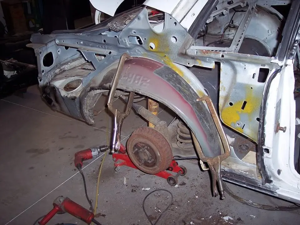

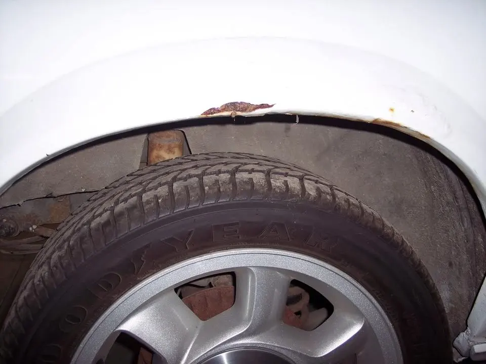

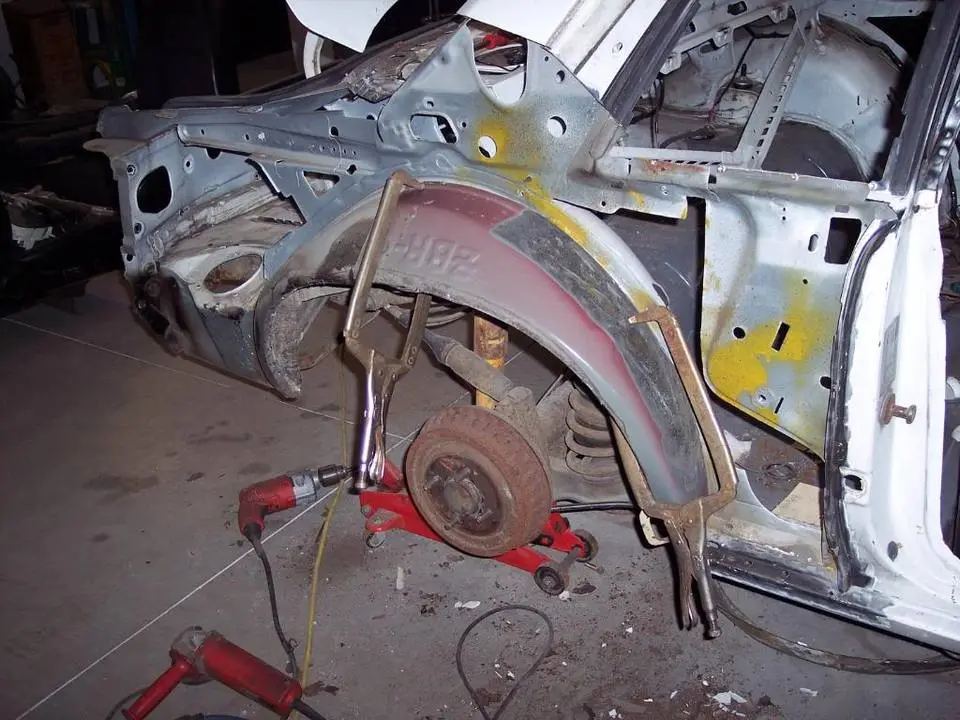

More updates, this is good, having this thread, It forces me to make a photo journal. Hope I'm not boring everyone. Found a couple more bad spots
Got the bad quarter cut out
It had been repaired there..

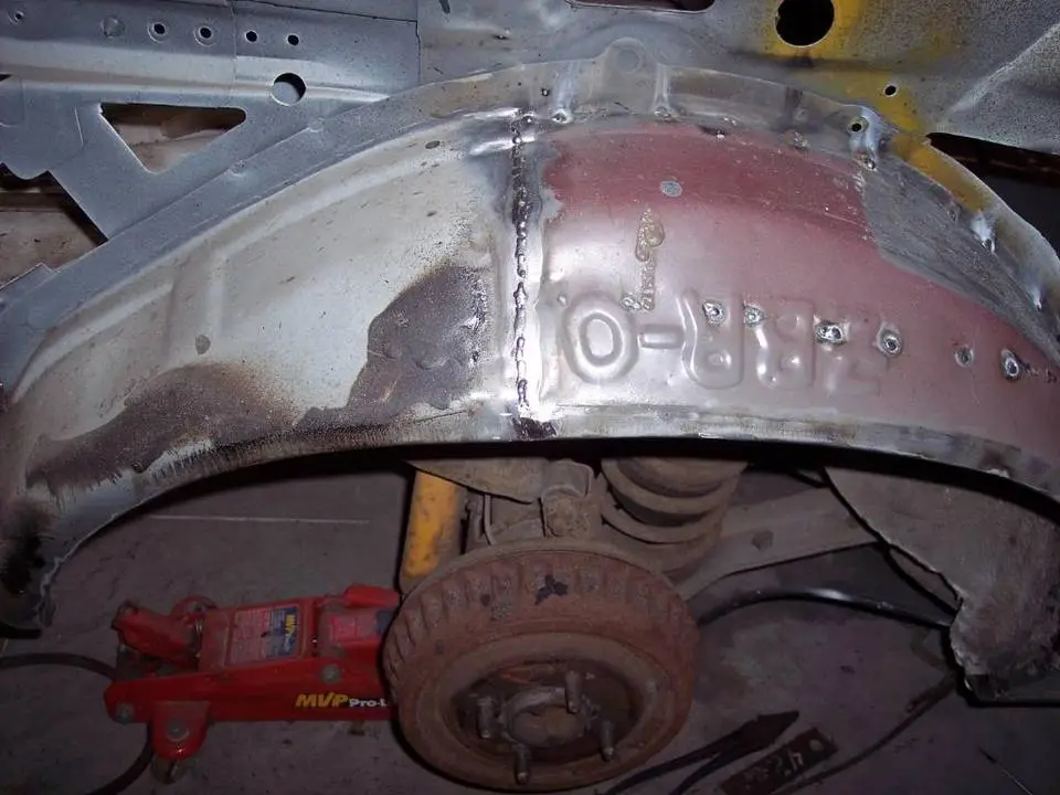

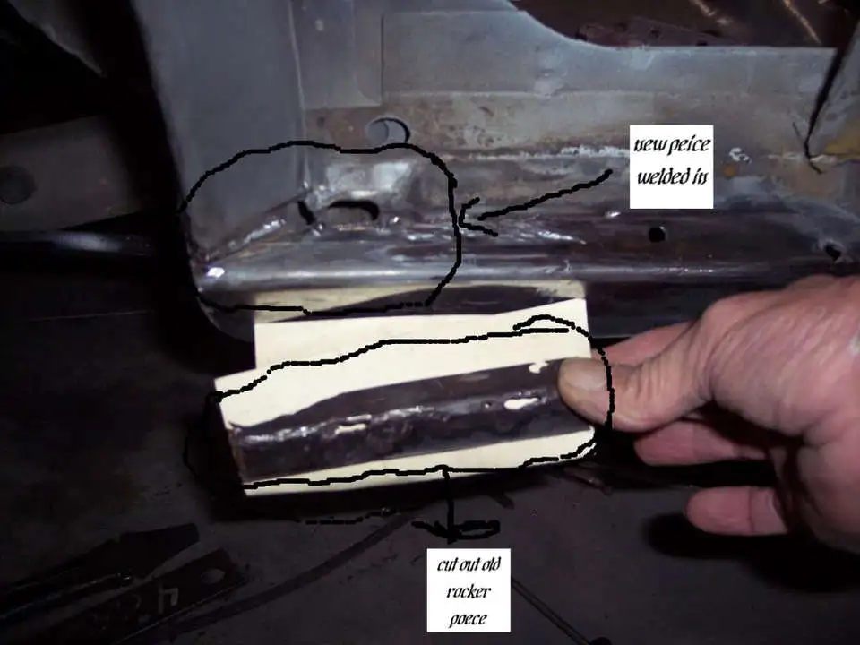

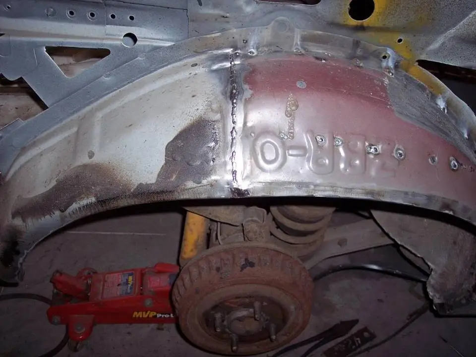

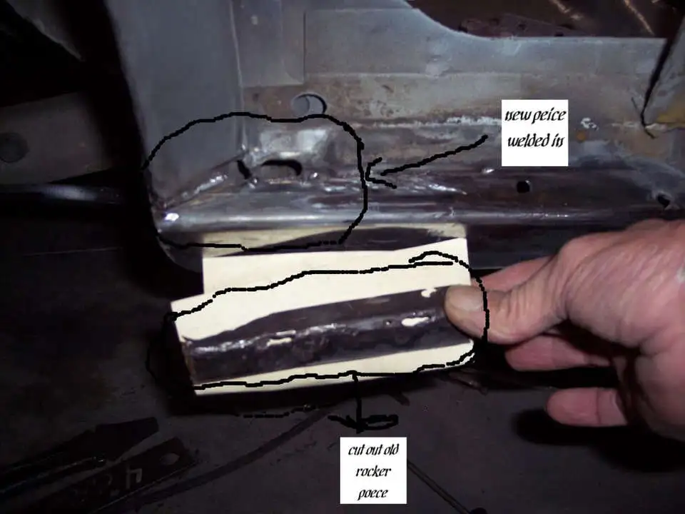

Replaced bad piece on wheel house and got it welded in.

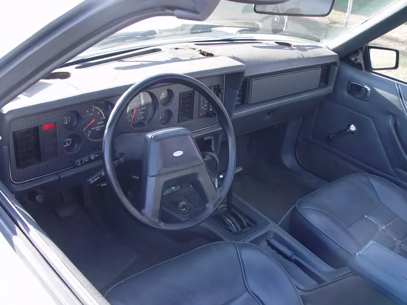

Coast2Coastang - We will retain all of the foureyed ques that we can especially the front end. Oh yea and for sure the star trek steering wheel is a keeper.:lol:
