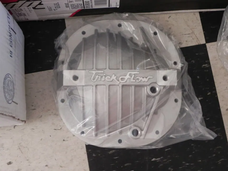

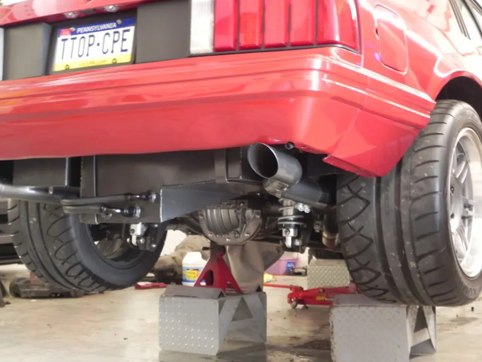

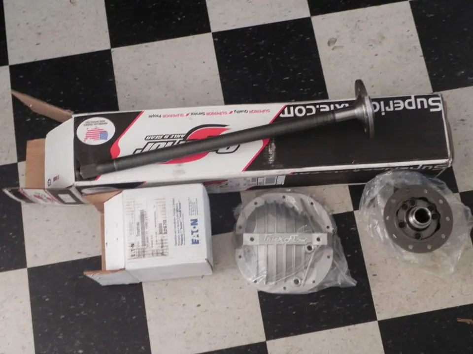

Well after putting a couple hundred miles on the car it is evident that my used stock rearend is not gonna last. That FB auto hits pretty hard, started making bad noises. Decided to try the Eaton True Trac with Superior 31 spline axels. Powdercoated the dif cover in Gunmetal Chrome to match the rest of the under carriage parts.

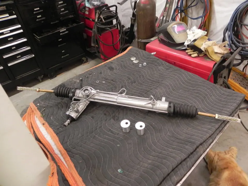

Really wanted to upgrade the steering rack from the stock one. This one is a quick ratio. it will get painted to match the rest of the engine bay.

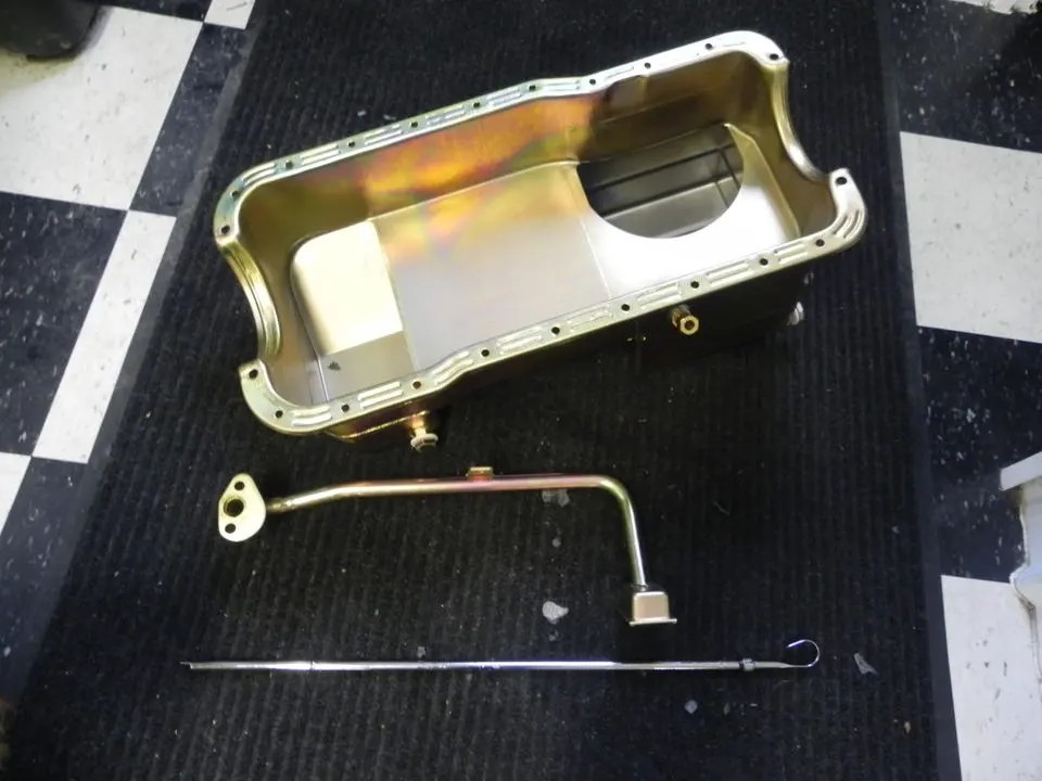

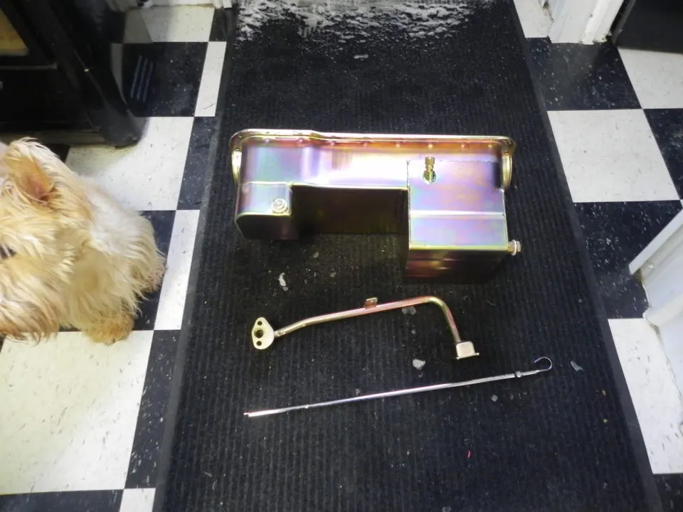

Also needed to upgrade oil pans, DSS recomends a deep sump tank, so you won't suck her dry, we did this on the 93 right away, don't know why i didn't do it on this one. got a screamin deal from CFR Performance, included the pickup and the stick, this will get powdercoated to match the engine

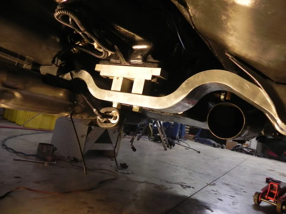

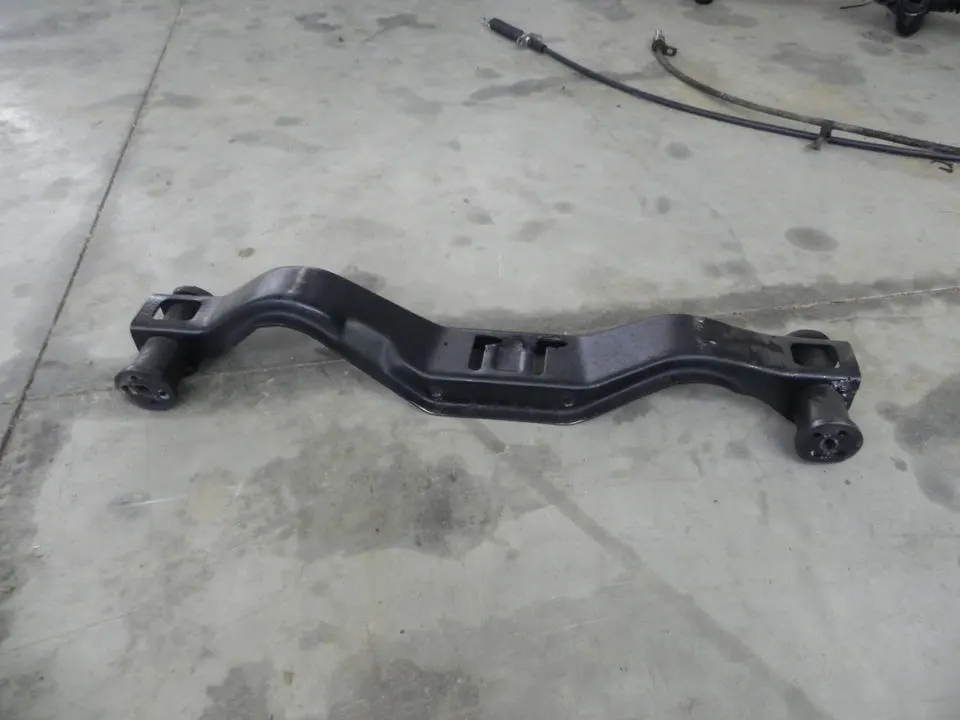

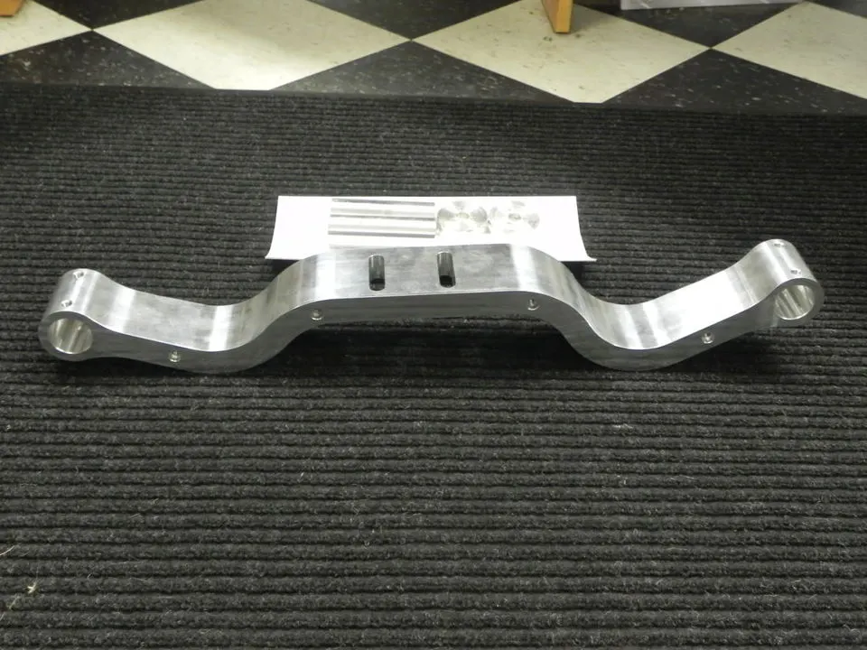

New crossmember is another area, and new bushings. This is Summit brand with Steeda offset bushings. Fabbed my own tranny mounts, this also allows me to get a little better clearance with exhaust. this will bet podercoated as well.
Old ...
tranny mounted, mock up.

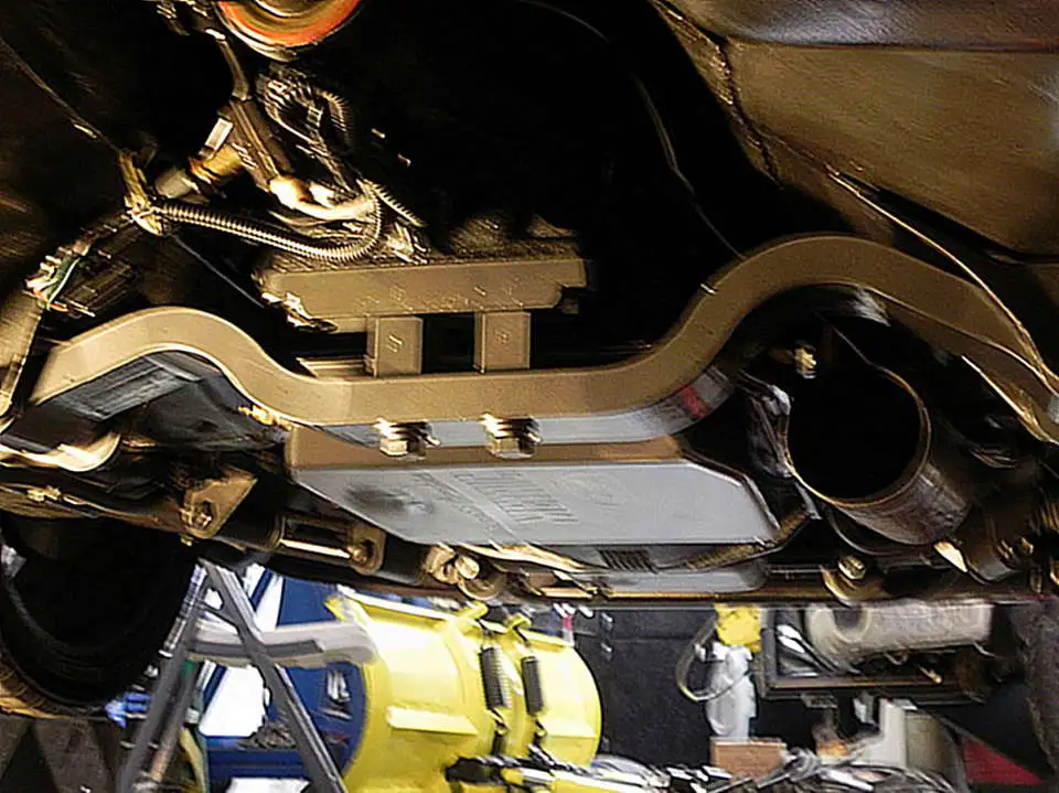

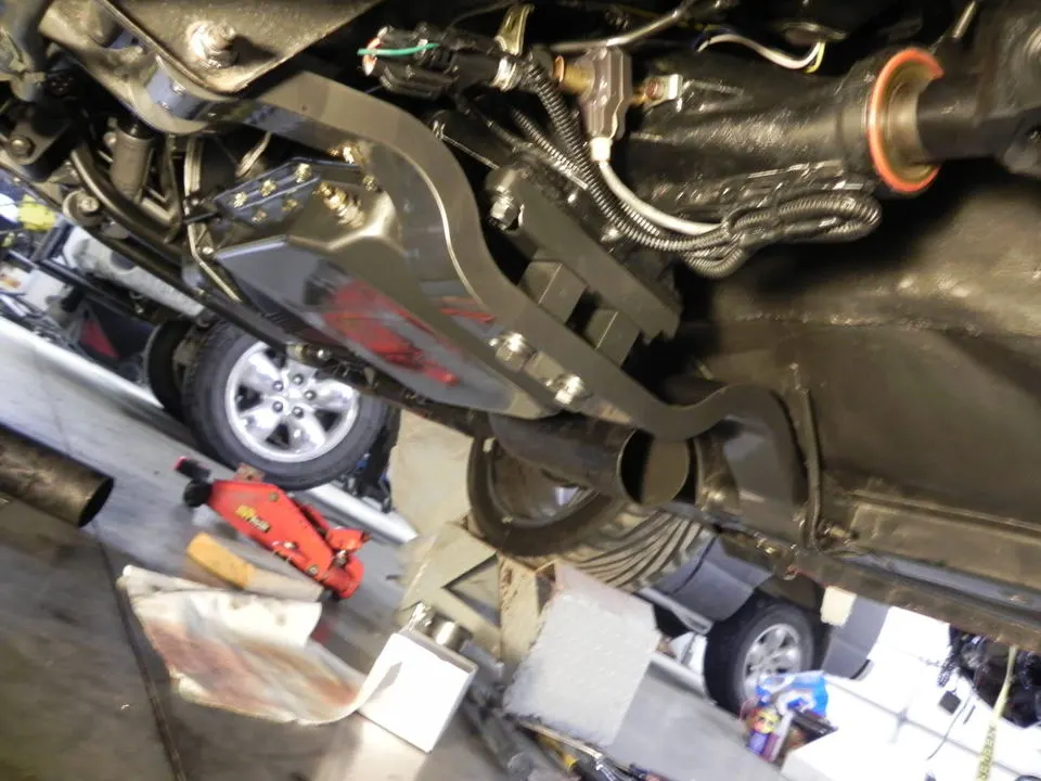

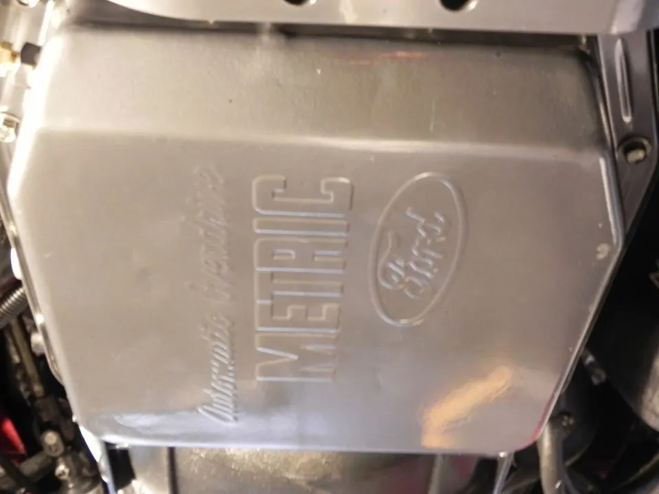

Got the stuff in powder and installed, decided to powdercoat the tranny pan as well, it just came black from Freddy Brown

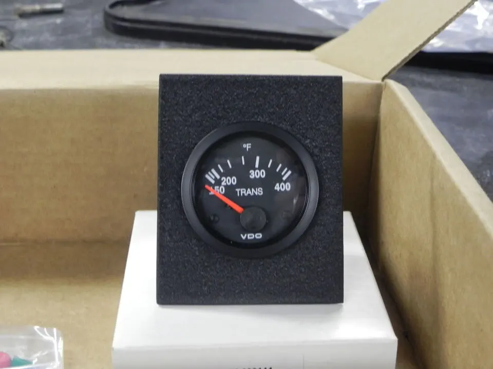

I'm going to run a tranny temp gauge now, makes me bothered just relying that the fans are adequate, this way I'll know for sure
