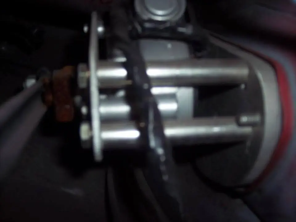

sscobra said:
Ok, gotta ask. So where is the wiper motor going(I thought you might just be deleting it)? Please show some pics. Nice build.
It is hidden in the cowl, I fabbed up a bracket to move it back in on the firewall here's a pic. I'll PM you on more.

Thats awesome, I'm also extremely impressed with the amount of rust you fixed on this thing. Thats why i got rid of my 89 and got the ttop car. I wish i had known you can hide the wiper motor, thats very ingenious! keep em coming!!!!
Thanks for taking the time to get a pic. I went out and check mine out today. Did you have to modify the arm that is attached to the motor or did you just make a bracket, bolt it to it, and attatch the mechanisms? What is the relation of the two wiper "control arms"? Thanks so much for the help.

sscobra said:
Yes, I made a new arm that attaches to the motor. The arm that runs the wipers has to be bent.

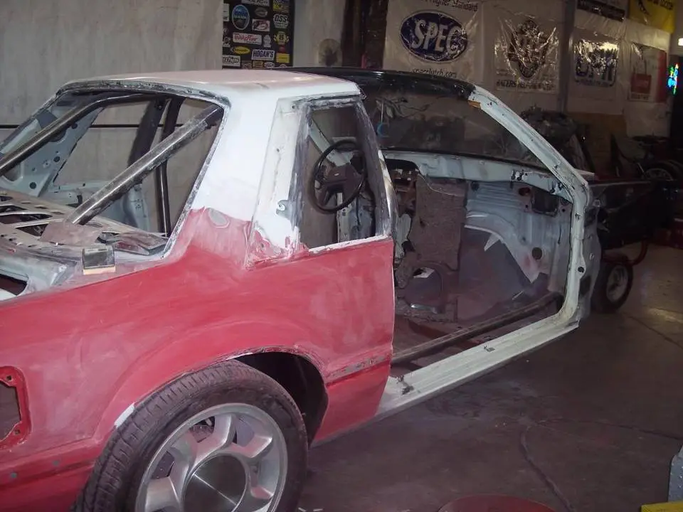

Started on the bodywork, there's lots of it. Got the doors off and getting ready to cut the tops off the donor doors for the t-top.

Crazy how you made the seam where the new and old quarter line up look so seamless..

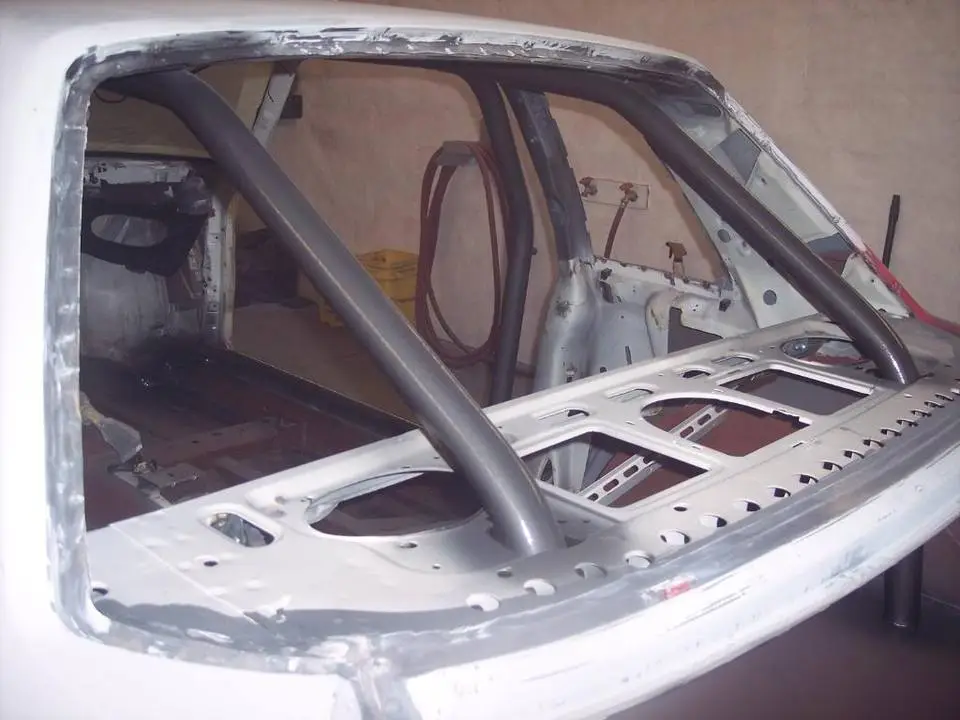

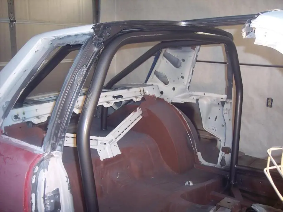

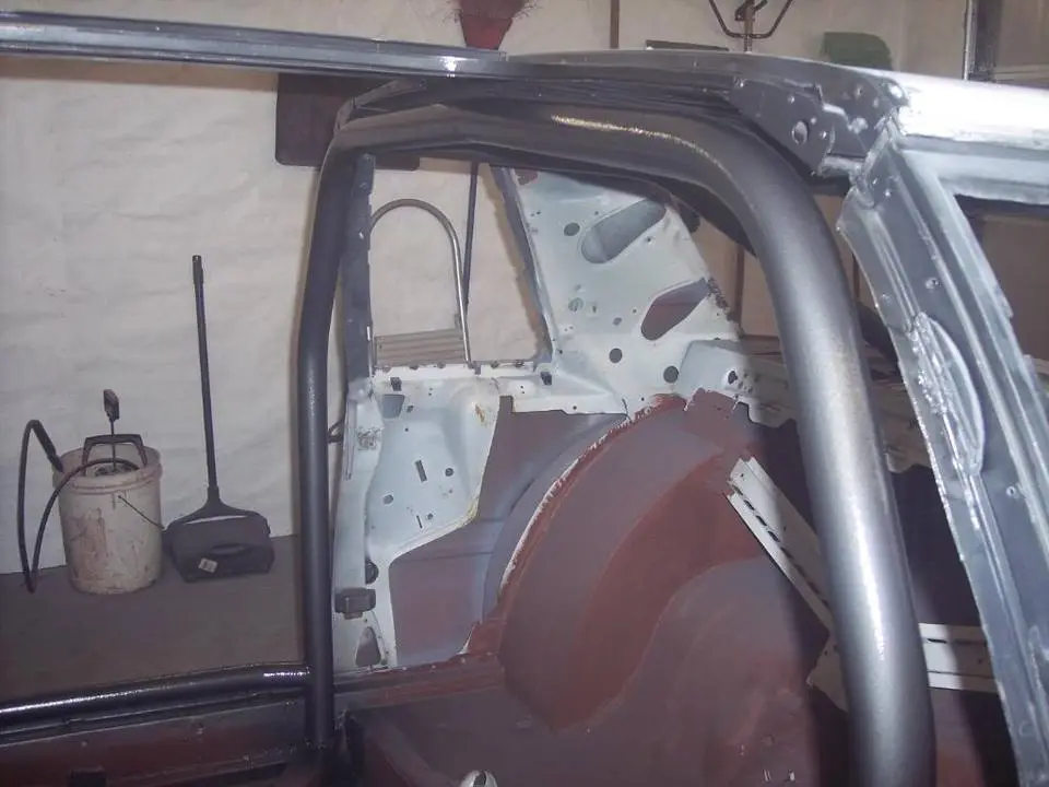

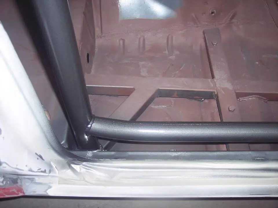

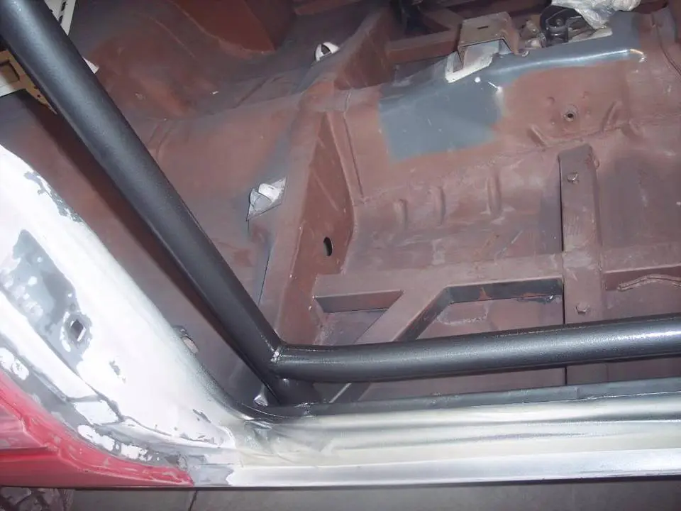

Was able to get the street cage shot with that hammered rustoleum, wish the pics showed the hammered texture better, but it looks really cool.

sick. is that stuff rattle can?

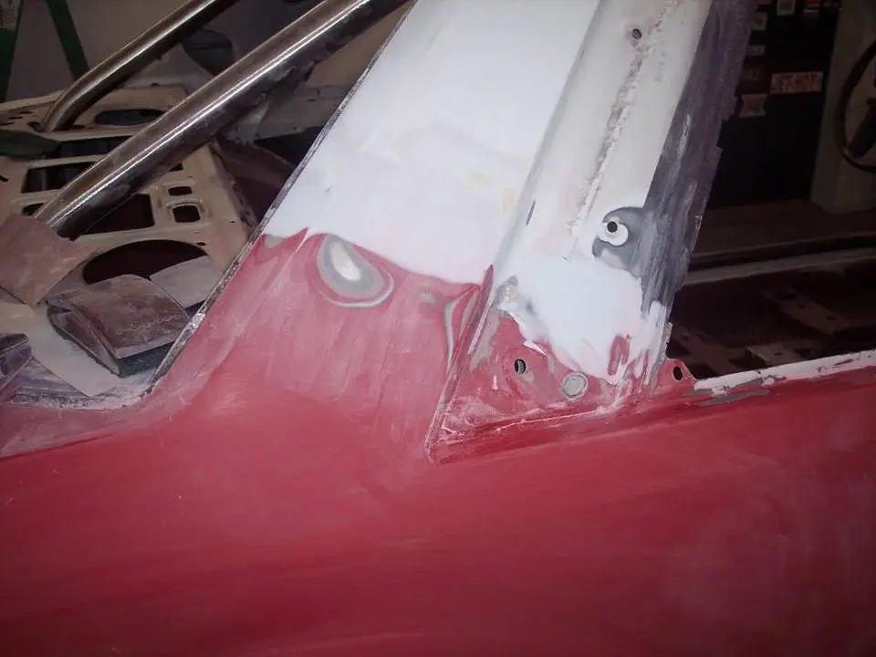

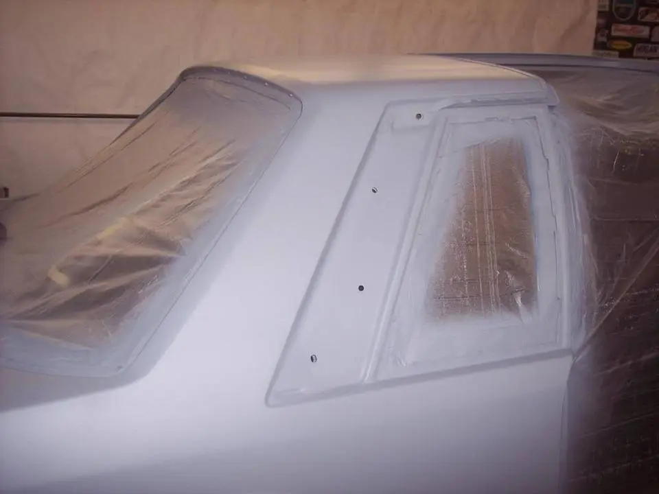

Got to see if my rear quarter splice was sucessful I'm happy.
